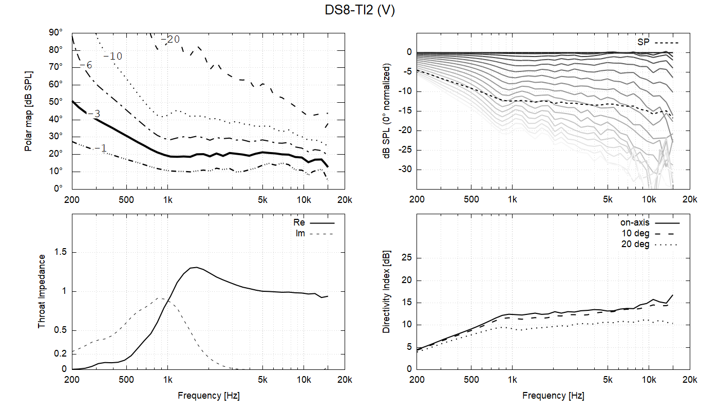

Of course it adds some diffraction but this is actually what we gan get this way: https://www.diyaudio.com/community/...-design-the-easy-way-ath4.338806/post-7056696
Could it be improved further? Sure it could. Is it already good enough? That's the question. I tend to think so.

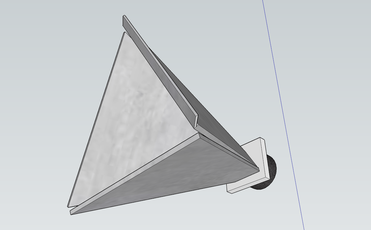

I think an asymmetric would be better yes. But perhaps its not as easy as just how few...
So perhaps the lest, uneven numer of sides?
3?
Inspired by recommendations for boxes with sides in an irrational ratio, we could try an irrational number close to 3, maybe π... Oh wait...
Jokes aside, Marcel's latest work looks very feasible to cut sides from a polystyrene foam slab with a simple hot wire cutter.

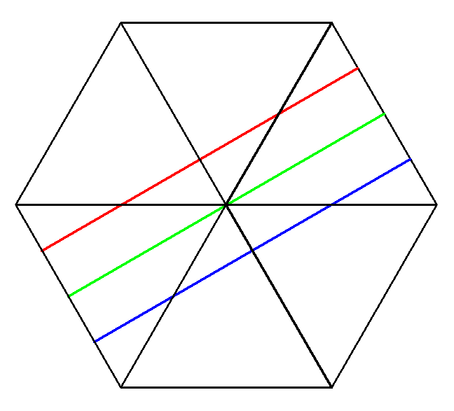

I have to admit I still have no clue what are you trying to illustrate with these pictures 🙂
Well, flat boards don't seem to work well. You would really have to bend them (OSSE works fine). And then perhaps no mouth rollback would be necessary, who knows.
- BTW, isn't such triangle more symmetric than a rectangle, after all? 🙂

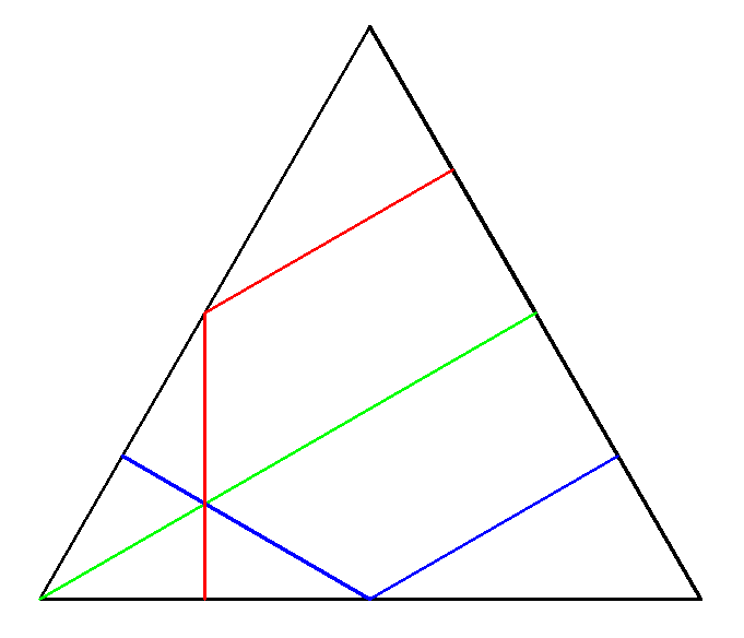

I also have great difficulties in understanding what AllenB is trying to show us btwy.
I think what people are trying to get at, (but the language is elusive) is path length.Guys, are we not talking about 3 dimensional symmetry, a completely different kettle of fish all together than 2D symmetry? I also have great difficulties in understanding what AllenB is trying to show us btwy. A horn, like the one Mabat has shown can of course be highly asymmetrical throughout even with rectangle for a mouth.
In a round horn, the path length is the same in all radial directions.
In an oval horn, there is gentle change in path length.
In a square horn there is more sudden change.
The JBL M2 has little or no change in path length if I understand correctly but is square.

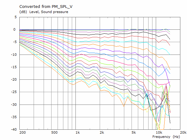

The data MBAT shows for the response of a square horn is not intuitive.
You would intuitively expect odd effects from lower compression ratios and distance to the throat in the corners (for instance), but I don't know if this is a reality or not. If it did turn out to have a measurable effect of significance (say at high SPL?) Then a 8 petal version would presumably be less affected.
In SketchUp, draw one third accurately, then use the 'rotate' tool and copy paste it.Terrible drawing with attempt to rollback 🙂
YouTube using the rotate tool.👍

Which makes the timing of the reflection back to the throat from the mouth edge all the same (at all angles)...I think what people are trying to get at, (but the language is elusive) is path length.
Timing will vary in this case, so even without a roll back it will look prettier than the round horn (with the same edge termination).In an oval horn, there is gentle change in path length.
A square horn will have variable timing of the reflection from the mouth edge back to the throat. Making it smeared out in time and less severe.In a square horn there is more sudden change.
