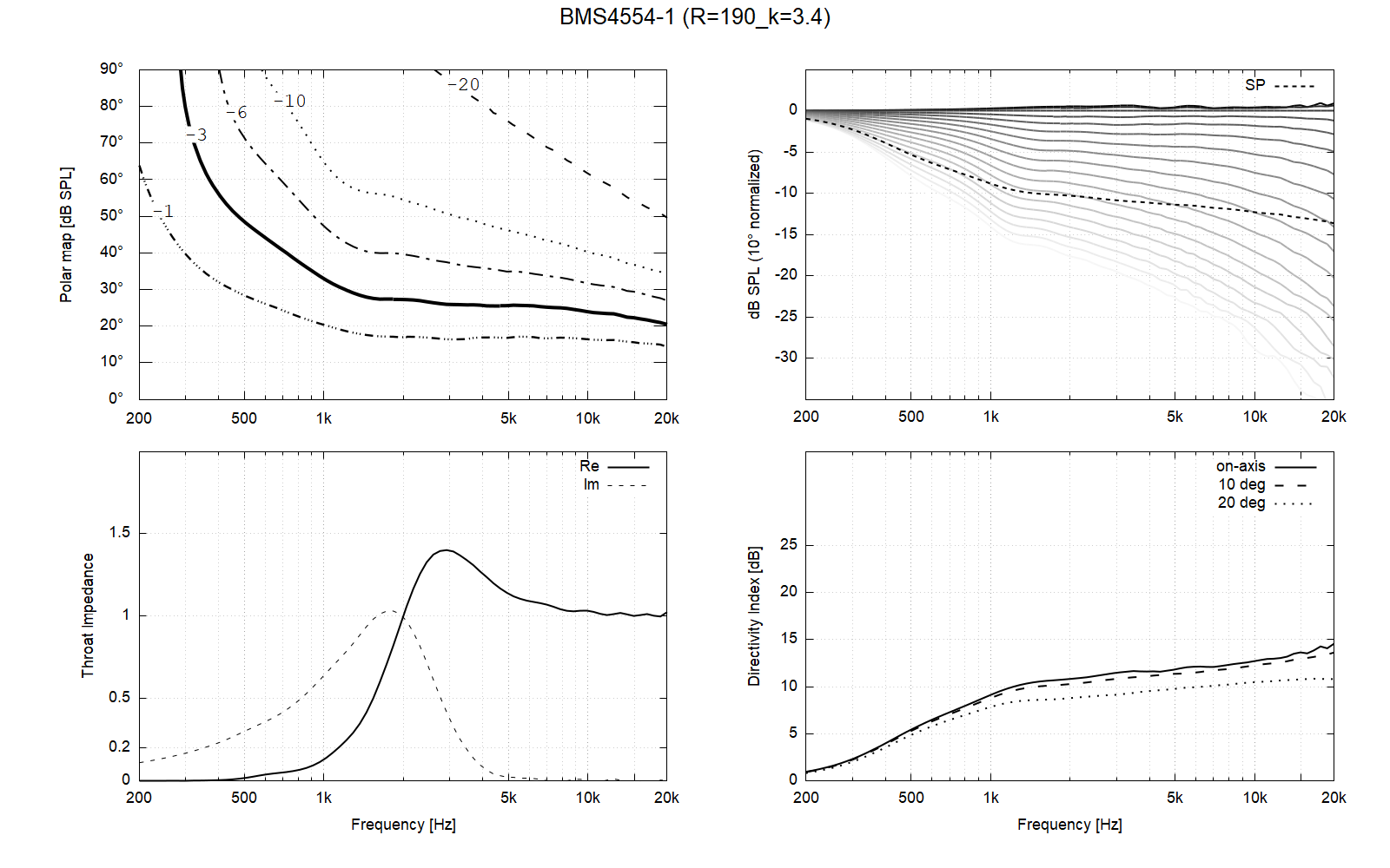

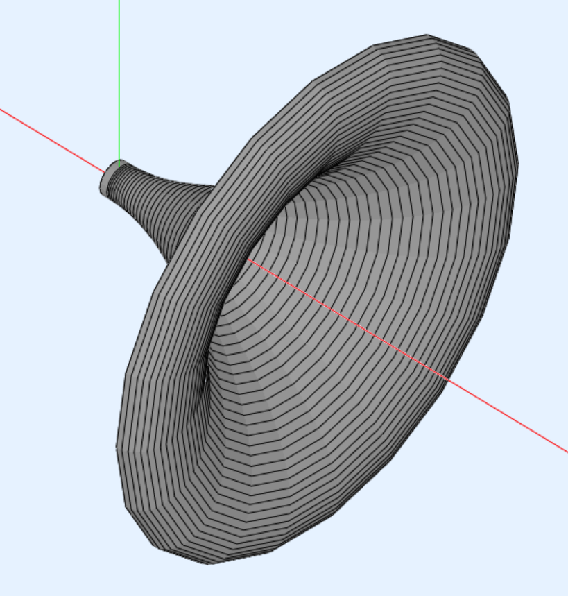

For a while I returned to a free standing R-OSSE, needing a horn for BMS 4554 1.4" driver.
It's including a throat adapter (making the driver exit section a part of the profile), i.e. starting at 16 mm diameter. It's still hard to beat.
(⌀380 x 190 mm, including 43mm adapter)
Solved in circular symmetry mode:

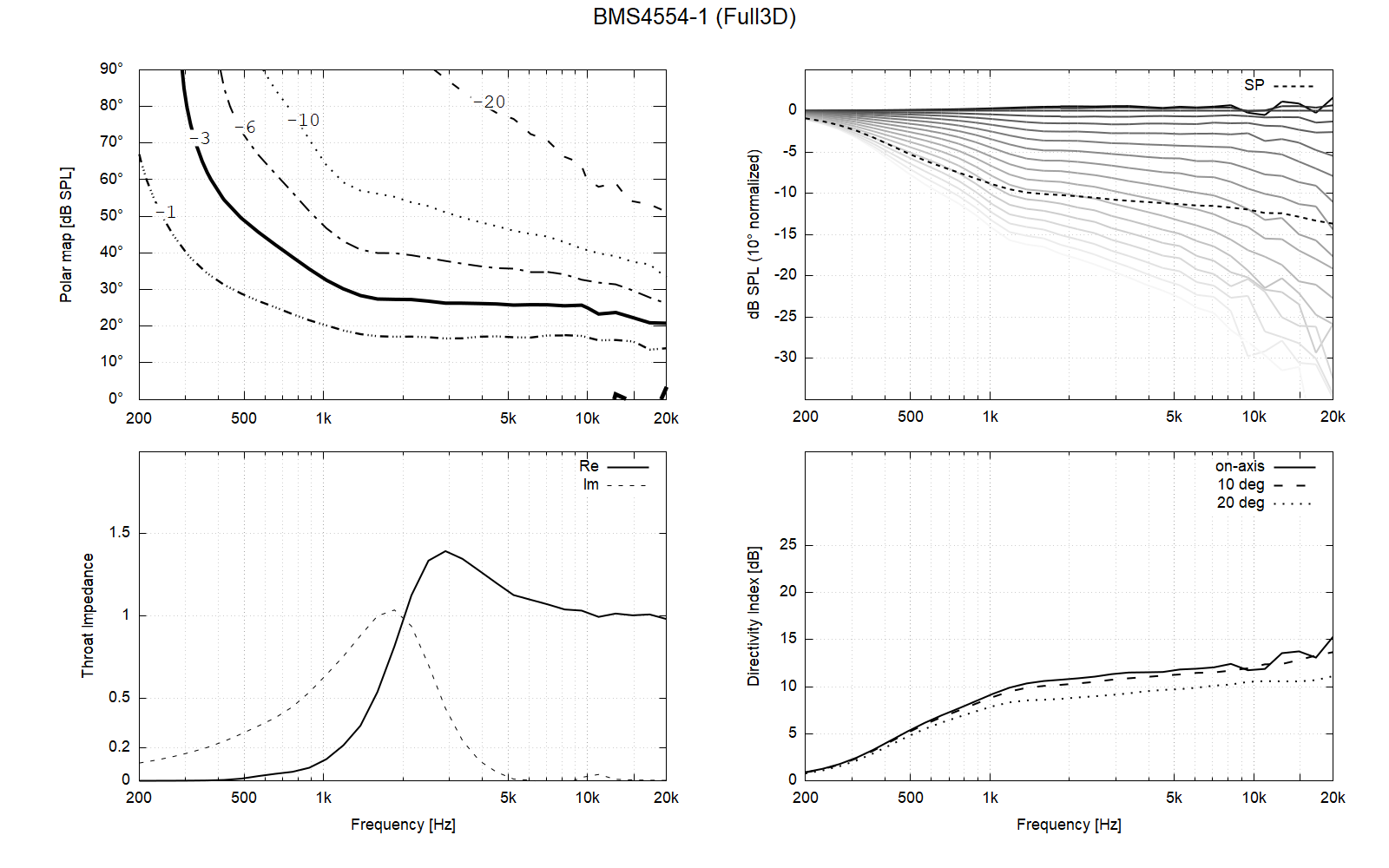

Solved as a general 3D mesh - I wanted to know how worse it would be, not much:
BTW, the formulas in the paper are now finally all correct, hopefully (should be, as I implemented a new code based on that and it works).

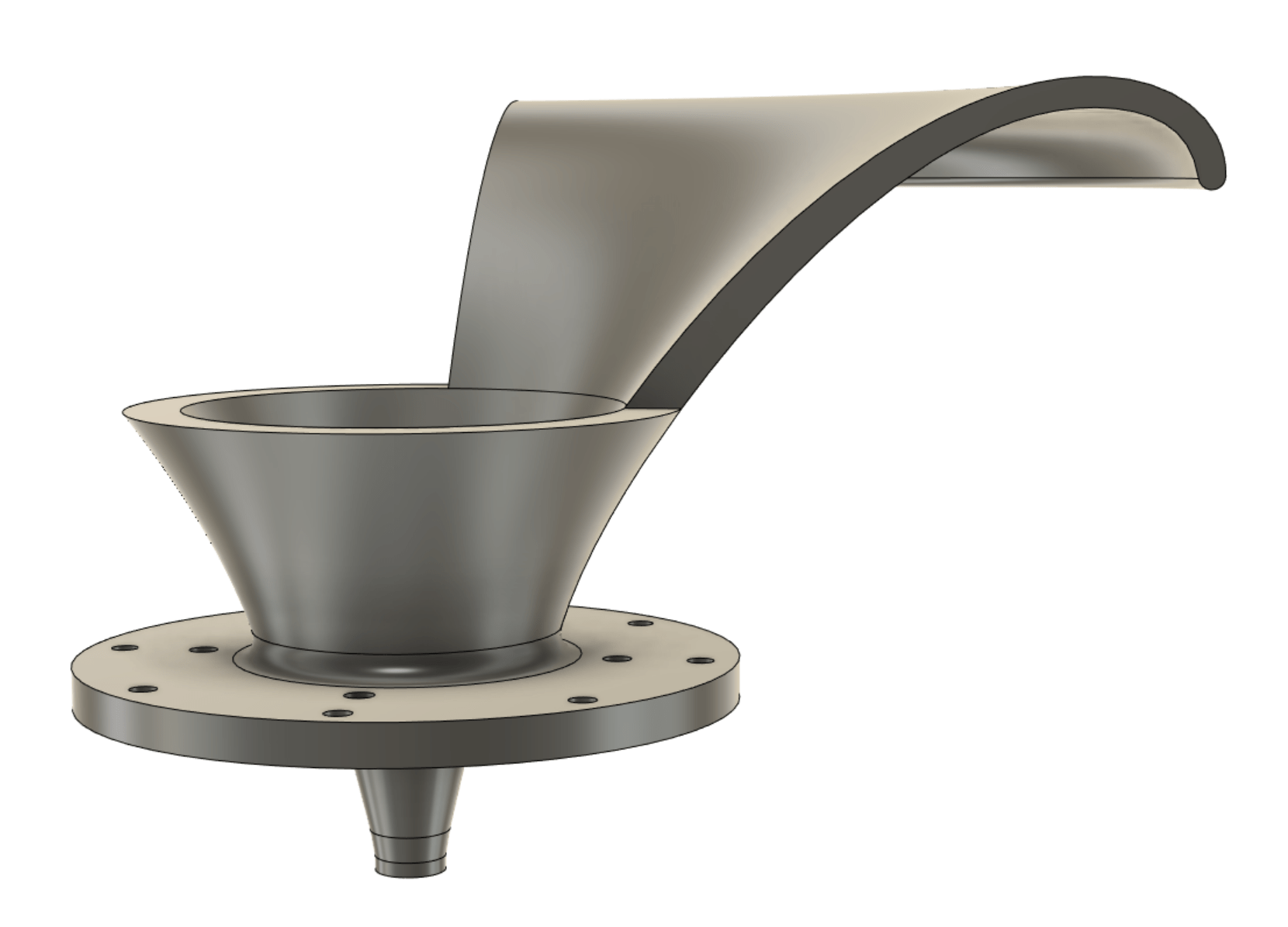

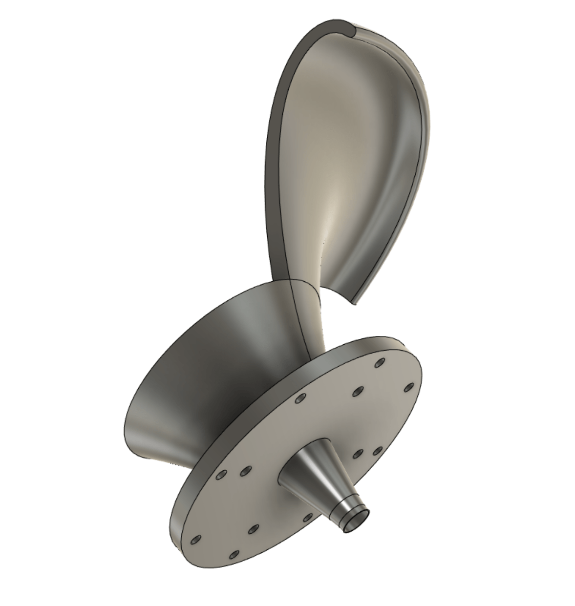

...preparing prints for the BMS 4554 horn mentioned above - this is the idea:

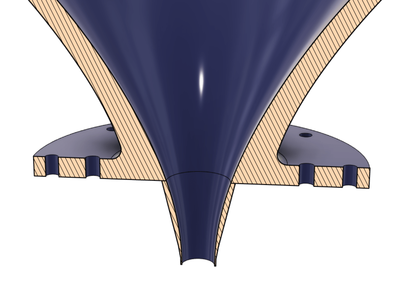

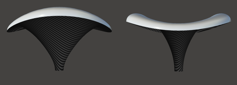

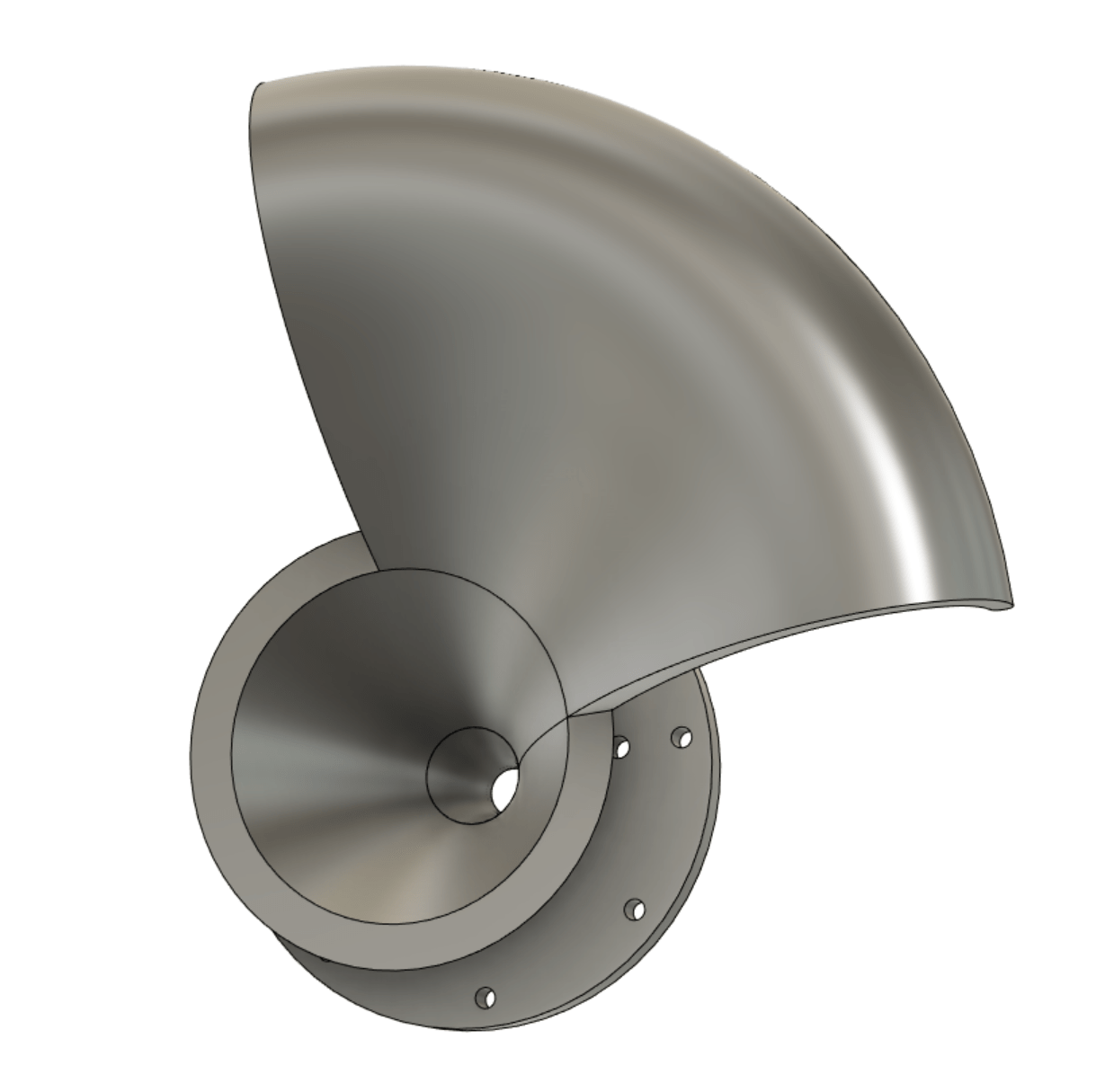

Perhaps a better illustration. I mentioned this idea a long time ago. So finally, some implementation (it's in the printing now) -
Sure, the screen removed. BMS 4555 would be even better but 4554 is what I have. My next candidate is FANE CD131. What's needed is as large exit angle as possible with as small phase plug exit diameter as possible. This way two things can be improved - 1) extending smooth directivity control at HF, 2) eliminating a reflection otherwise caused by wavefront mismatch at the driver/WG interface. Well, at least in theory.
Advantage being you have pattern control up to 20khz with a larger diaphragm driver?Perhaps a better illustration. I mentioned this idea a long time ago. So finally, some implementation (it's in the printing now) -
that is only possible way to make it, otherwise there is no room for adapter. When you suggest that couple years ago I tried to design it for several CDs but no space if want to implement the best curves which are opening quite fastWhat's needed is as large exit angle as possible with as small phase plug exit diameter as possible.
I suppose the k is quite high and coverage angle on lower side in your design to allow CD exit implementation.
Btw graphs looking excellent
Sure, not all drivers are equally suitable for this.

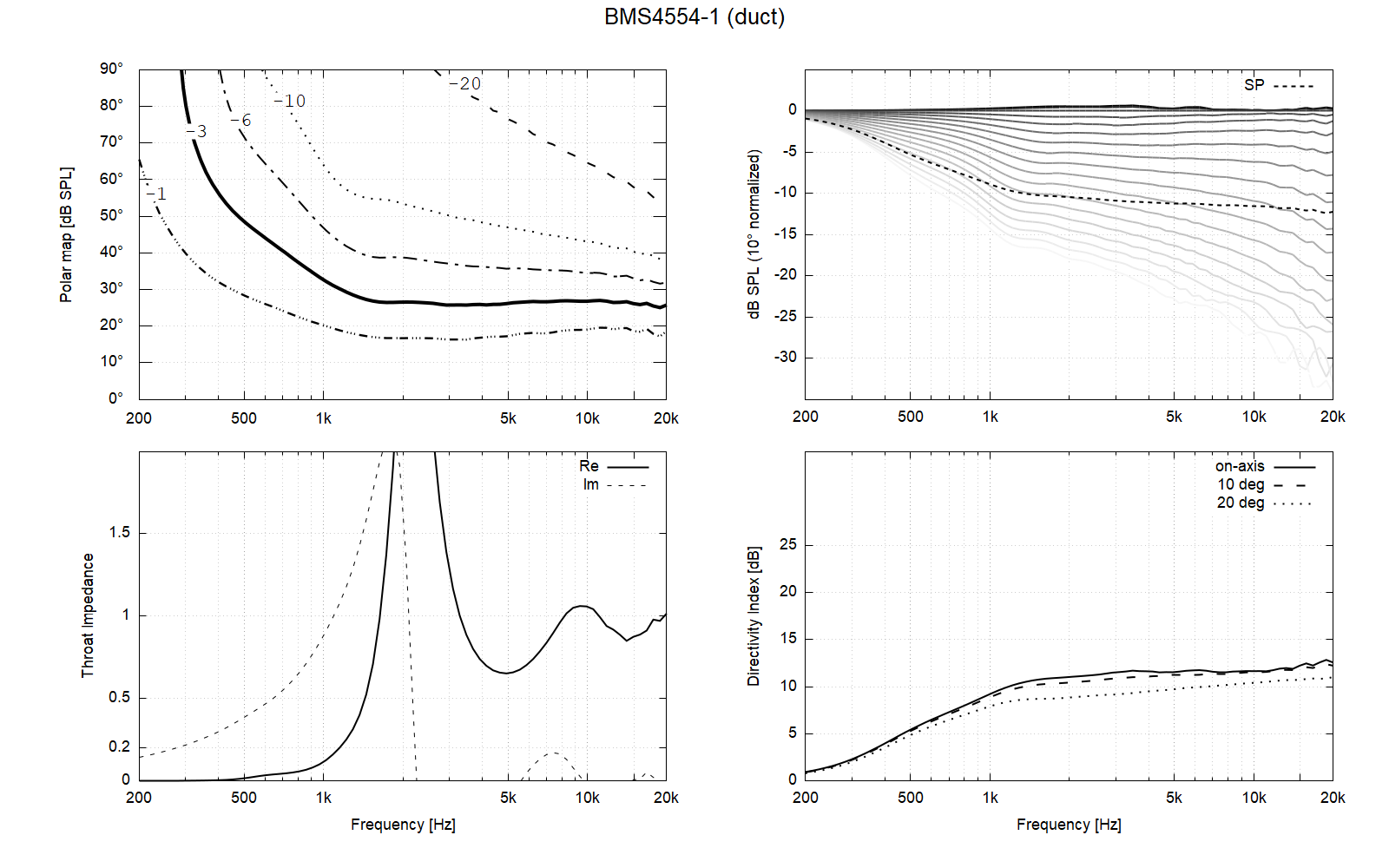

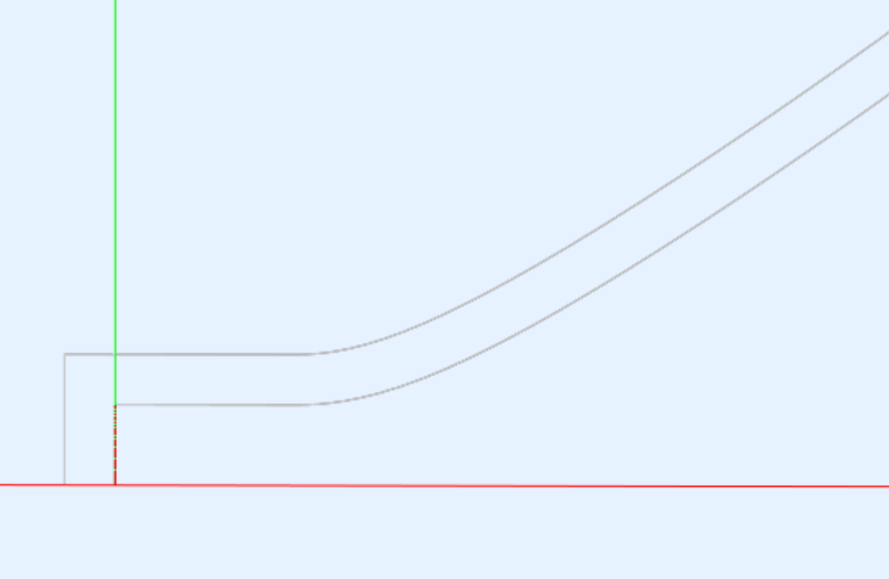

- If a really constant DI up to 20 kHz is the priority (for me it isn't), it's always possible to start with a short straight duct section, allowing a faster opening afterwards. This won't have any negative effect on polar response but will add some reflection that will need to be corrected via EQ.

...not exactly flat but close (k=1.5). This would fit into the BMS 4554.Anyway, it should be possible if anyone wanted to try.
