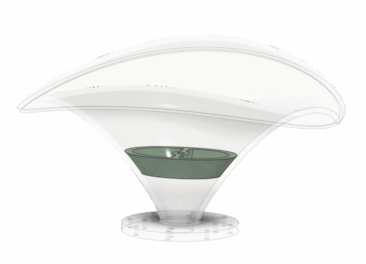

... and here is an other one ;-)

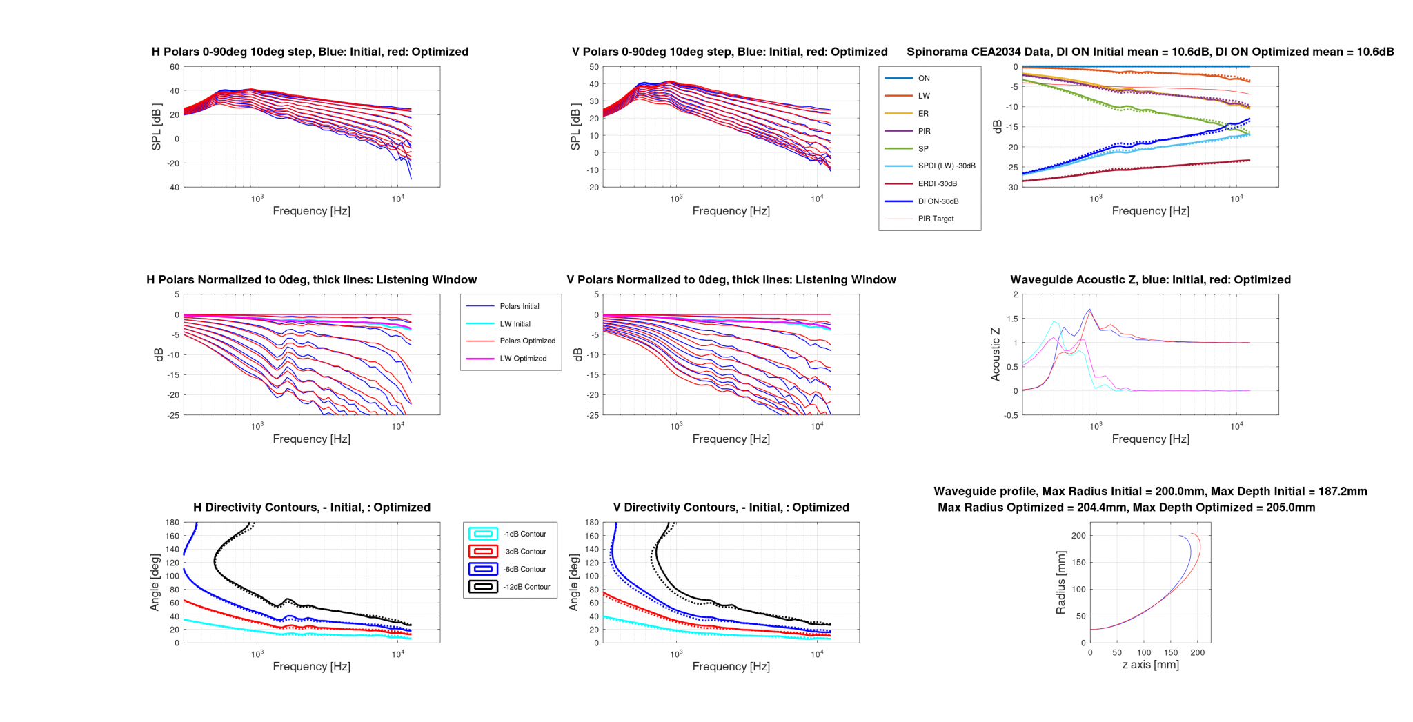

I gave that one a try too.
Code:
R-OSSE = {
  R  = 204.4463 ; [mm]
  r0 = 25 ; [mm]
  a0 = 0 ; [deg]
  a  = 33.3064 ; [deg]
  k  = 2.5606 + 3.2955*sin(1*p)^5.0417; []
  r  = 0.28838 ; []
  b  = 0.11572 ; []
  m  = 0.86488 ; []
  q  = 5.8055 ; []
Note: the dynamic range of the normalized polars is 30dB vs 45dB
Again, trying to find solutions in the vicinity (size and coverage) of the starting point.
I am curious, what the expected advantages of the asymmetrical profile?
-C-C for X0ver in not one of them (still circular mouth)
-Smoothness does not seem to be as good both from simulation POW and from the direct comparison showed by @Dkalsi
-On-axis smoothness by breaking the symmetry? But smoothness ON can be made rather aceptable through optimization.
-Different H and V coverage angles but at the expense of the “constant” characteristic
Despite the limited depth, this one should facilitate a crossover between roughly 500 and 700 Hz, depending on the driver.

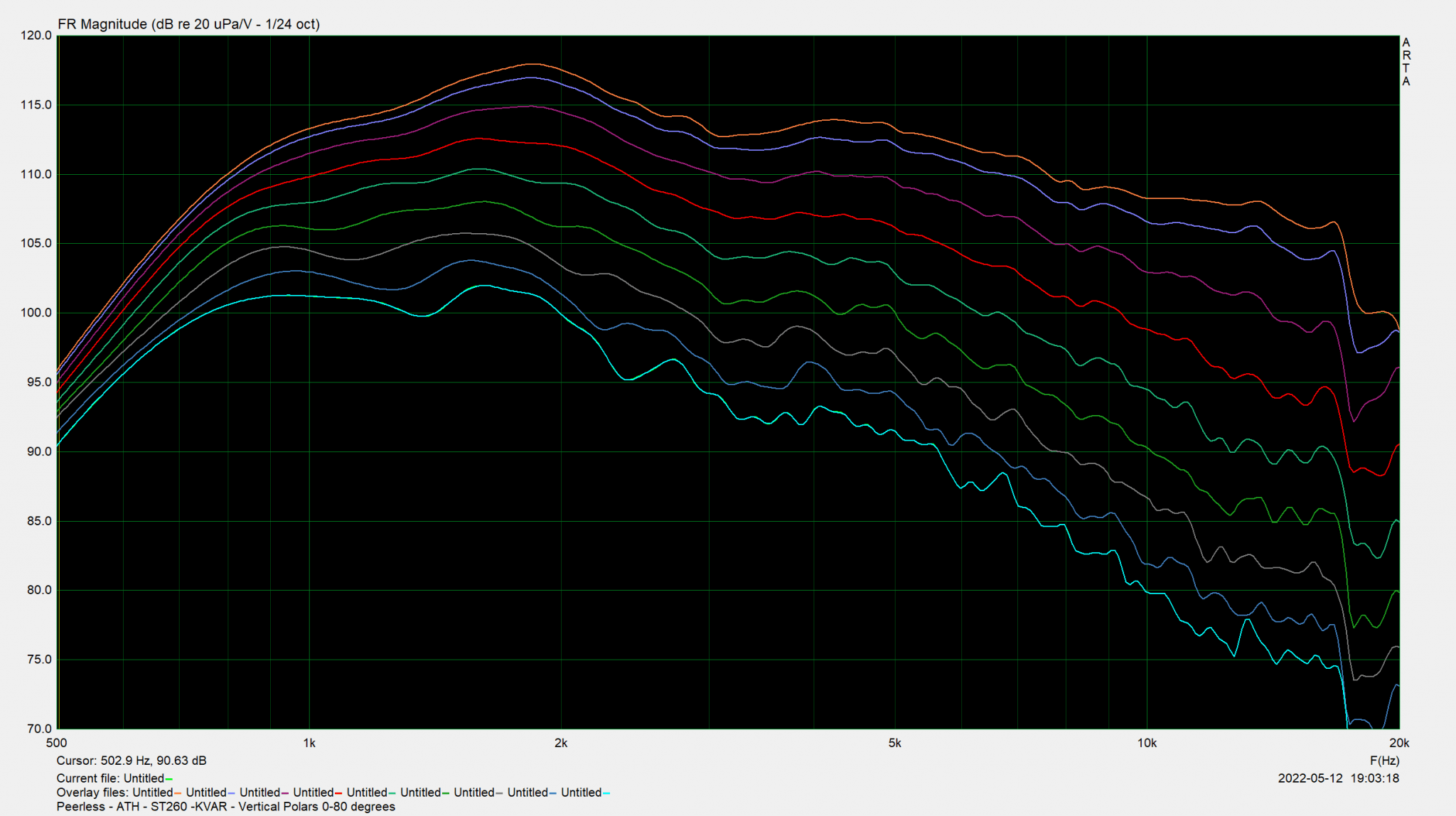

If helpful to anyone, here are vertical polars (out to 80 degrees) of the ST260-KVAR utilizing the Peerless DFM-2535R00. I didn't save these results but can go back and remeasure if necessary.

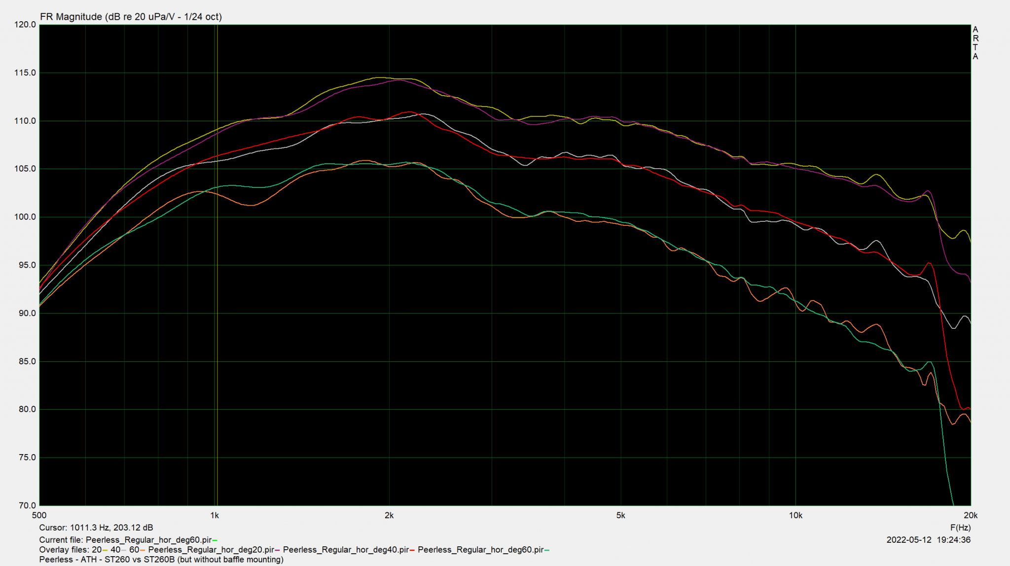

And here is the horizontal polar (20-40-60) comparison of the ST260 vs ST260B (again utilizing the Peerless DFM-2535R00).
The ST260B was not baffle mounted (as it should have been). I'm only sharing these measurements to highlight the improved smoothness the rollback contributes to the design. I'm sure, if the ST260B was baffle mounted into a cabinet with large roundovers, it would have similar results to the ST260 measurements.
The ST260B appeals to me because it allows one to utilize the volume behind the horn for the LF driver.
Thanks. What strikes me the most is the difference above 16 kHz. Hard to comprehend why is that. The ST260 is more "textbook" but clearly worse. Is that the same driver (i.e. the same piece)?
Yes - the exact same part. If there is something suspect, I wonder if it has to do with the less than ideal print of the ST260 (because it's two pieces that are merely taped together). The ST260B was 100% successful print job and was printed as one piece (i.e., no glue-ups/tapes).
Also - I think Peerless DFM-2535R00 itself exhibits a drop-off above 16Khz per its spec sheet. Thus, I'm inclined to believe the ST260 remains "textbook", but perhaps the unmounted ST260B is adding (noise?) something above 16Khz.

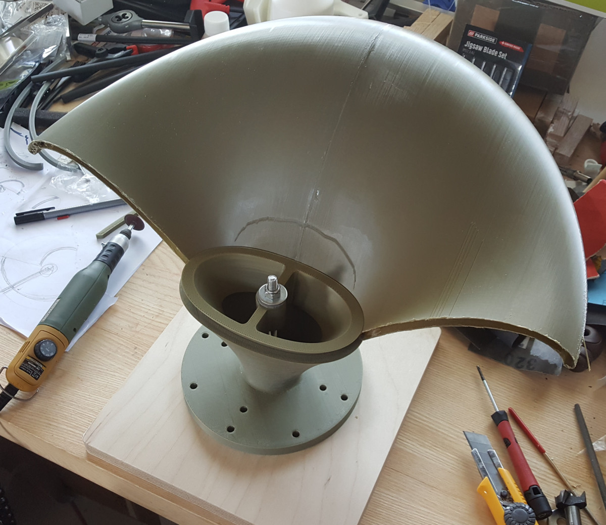

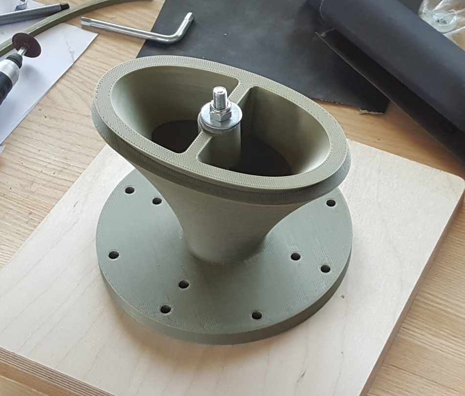

mabat - what did you mix the brass powder with to make it stick to the ST260 that you painted?
I used XTC-3D but it makes quite viscous and fast setting mixture, not very comfortable to work with on larger surfaces. I still want to try some other resins as I really like the finish.
