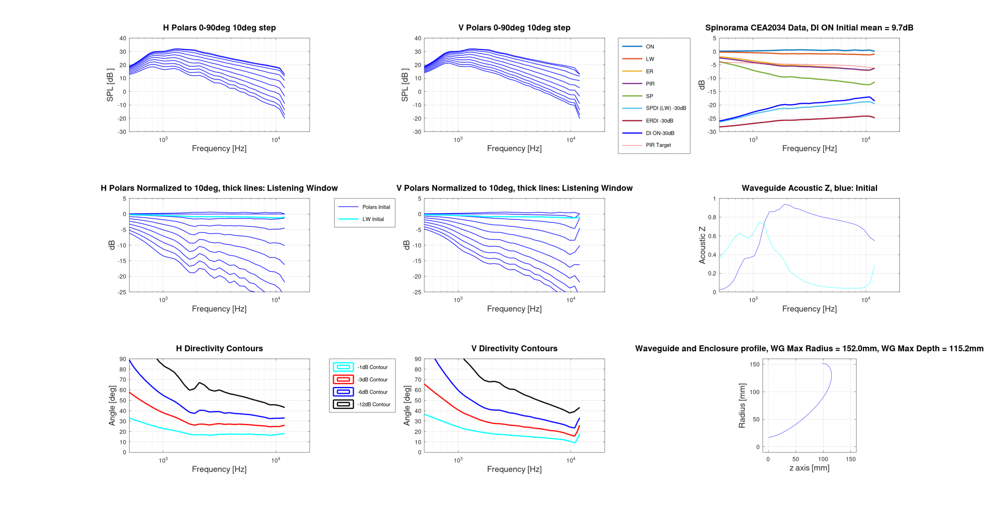

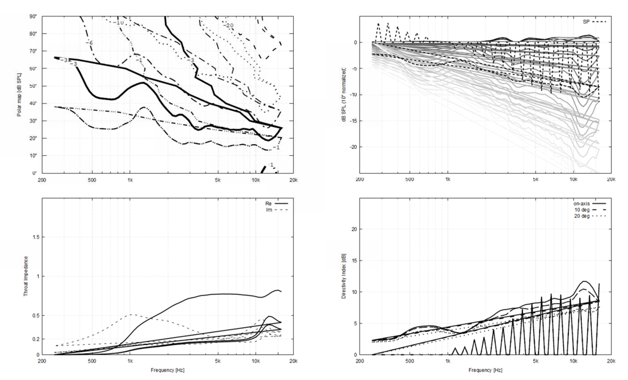

Does anyone know why my reports do this?
The traces are doubled and there's this weird zig zag pattern.
I have ATH installed on three machines and they all do this.
Here's the config file that produced this:

Here is what I got.Does anyone know why my reports do this?

There are 3 fields for the impedance it might be the issue?
What tweeter did you model?

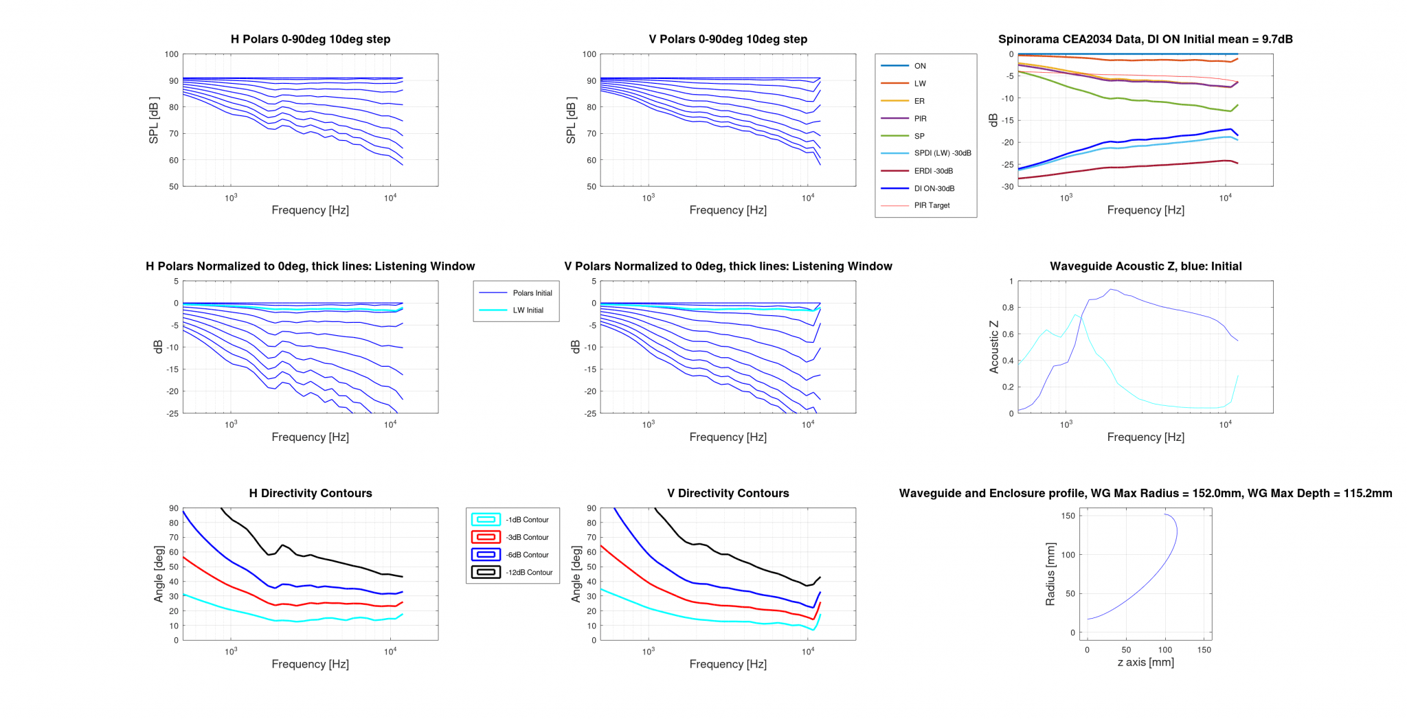

You shouldn't do that, i.e. to normalize both H and V independently to any other angle than 0 deg. You can do that on paper but it's physically impossible and can lead to misleading results.Probably what you were looking for (normalized to 10deg)
- What could be done instead is to normalize e.g. the horizontals to 10 deg and apply the same "EQ" on the verticals.

I agree, thats why I didn't use 10deg so far fpr assim. devices, I did it just because it was specified 10deg in the script...You shouldn't do that, i.e. to normalize both H and V independently to any other angle than 0 deg. You can do that on paper but it's physically impossible and can lead to misleading results.
thats also why I buy into anything other than 0deg in general
Maybe LW could work
For round devices normalizing to whatever off-axis angle is completely valid of course. On-axis (0 deg) is seldom the best curve to choose but for an asymmetric device that's the only reasonable option (besides the approach I mentioned but that's more than just a normalization).

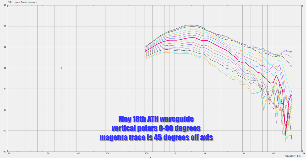

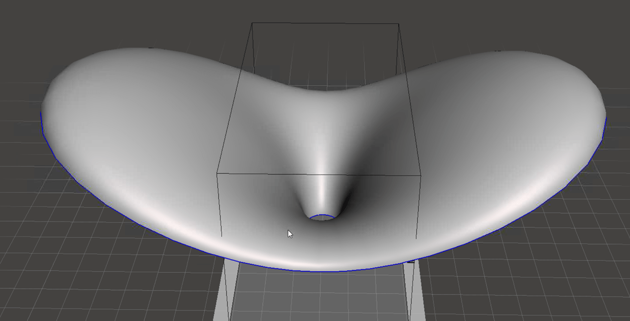

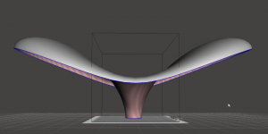

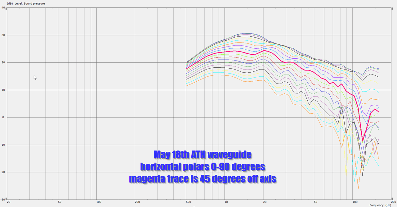

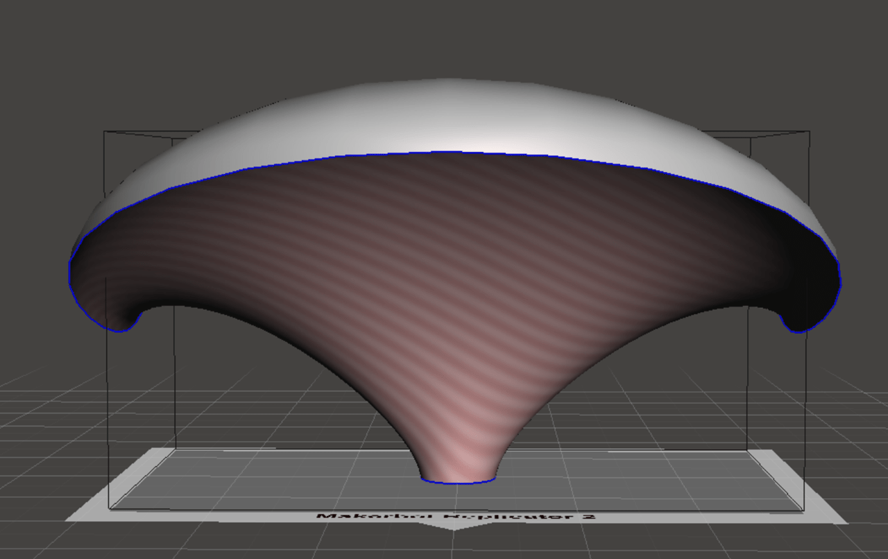

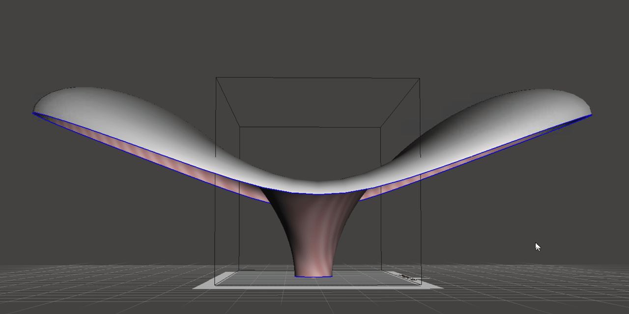

I took some of the R-OSSE designs that Mabat created, and messed around with them, yielding the attached results.
One of the interesting/unexpected results was that horizontal directivity was narrower than vertical directivity, even though the angle of the waveguide is larger. I think that's due to diffraction, basically the horizontal dimension is a small fraction of the vertical dimension.
Because the horizontal dimension is smaller, I think the wavefront is transitioning from a state where it's radiating into 90 degrees, then 180 degrees, then 360 degrees, as frequencies get lower. This has the effect of "shading" the output on the horizontal axis.

Here's the configuration file:
R-OSSE = {
R = 150 + 100 * abs(sin(p))^2 ; [mm]
r0 = 17 ; [mm]
a0 = 15 ; [deg]
a = 45 ; [deg]
k = 1.6226 + 6*abs(sin(p))^2.1429; []

Yeah, the somewhat narrowed horizontal directivity caught my attention already in the measurements Dkalsi showed. That was ST260-KVAR vs ST260 which are both about the same size (i.e. ~260 mm). That's definitely an interesting outcome -
https://www.diyaudio.com/community/...-design-the-easy-way-ath4.338806/post-7015019

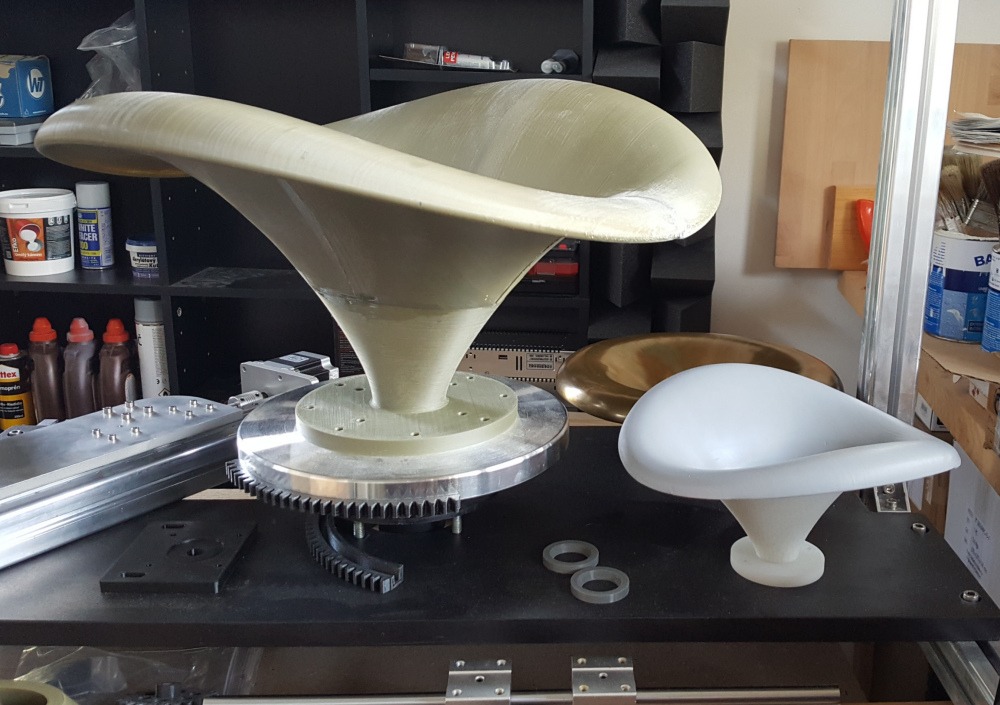

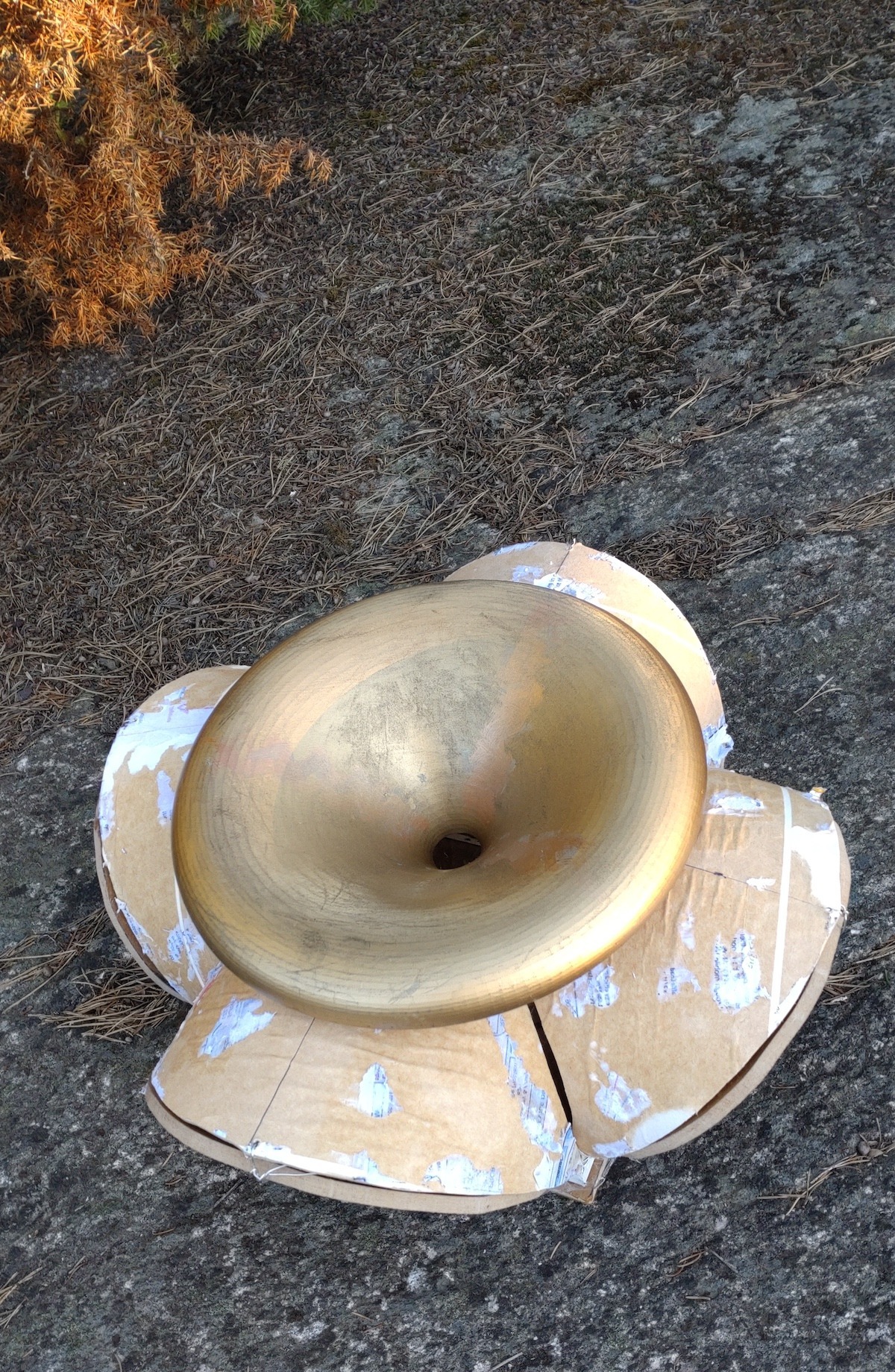

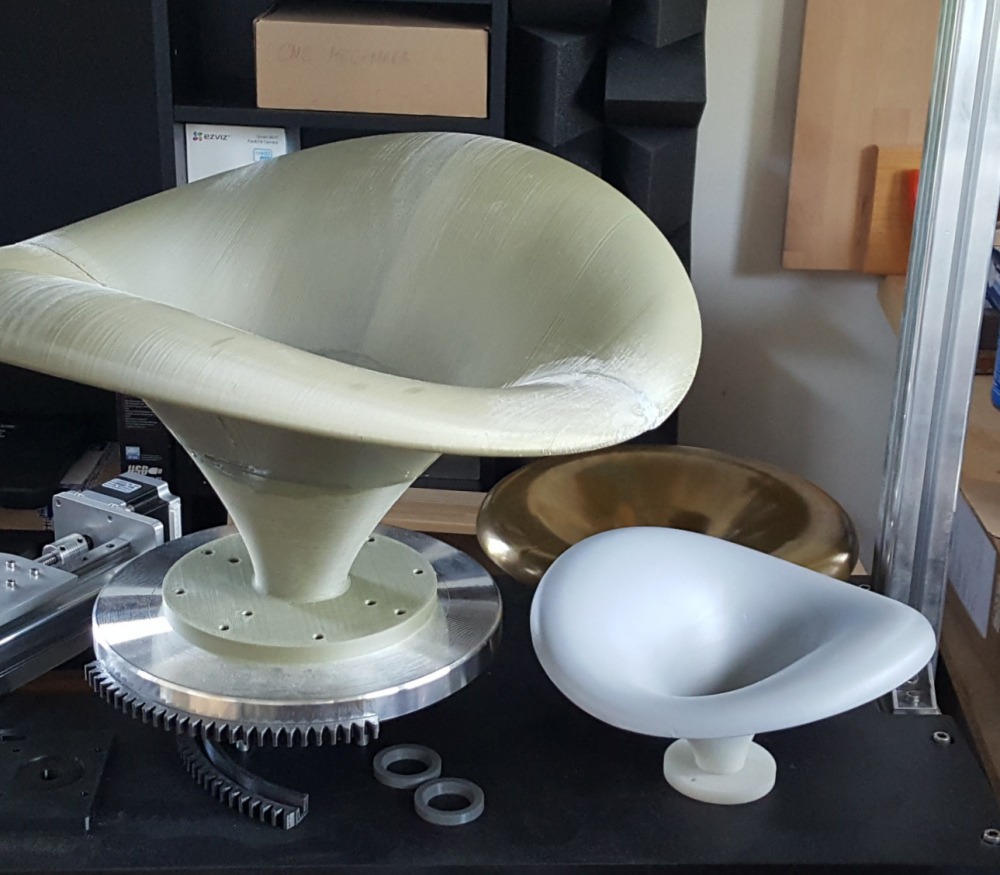

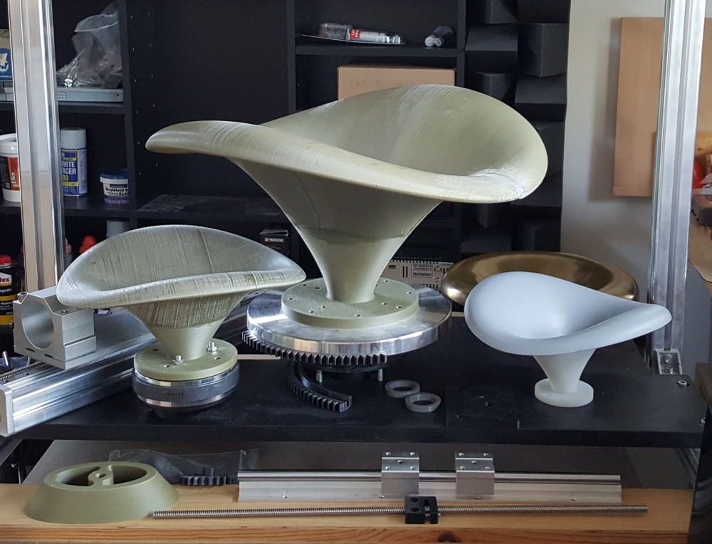

These are the ST260 (brass at the back), 1.4" KVAR (the big one) and its 1:2 scale model in grey.
The ST260 is the old petal construction (quite laborous), the KVAR is assembled from 5 pieces (base + 4 petals, pretty easy) and the small one is made from just two pieces (throat +mouth).

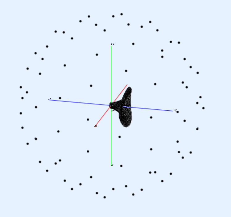

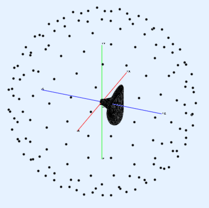

Finally working on a full-3D report. In a general case we need to calculate the radiated power properly -
Here's an equally-spaced sampled sphere (100 a 200 points).
