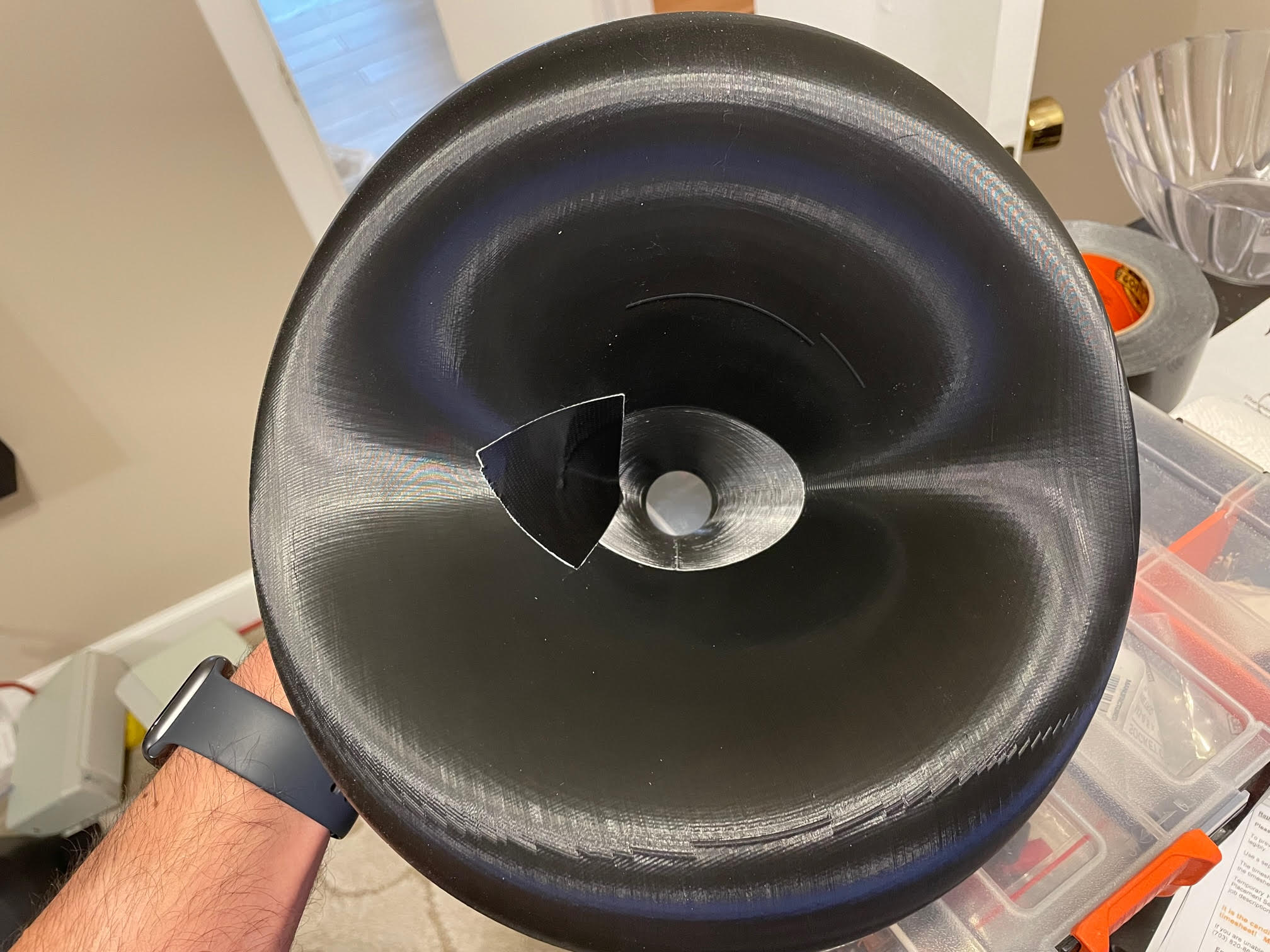

1" version for those brave enough to try it (STLs) - https://at-horns.eu/ext/ST260-KVAR-2022-4.zip
View attachment 1049970 View attachment 1049971 View attachment 1049972
- From the right angle it looks like an ear. A coincidence? I don't think so 😀 (a joke).

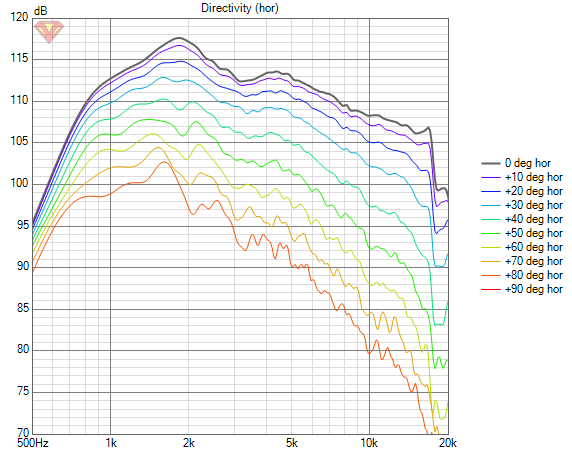

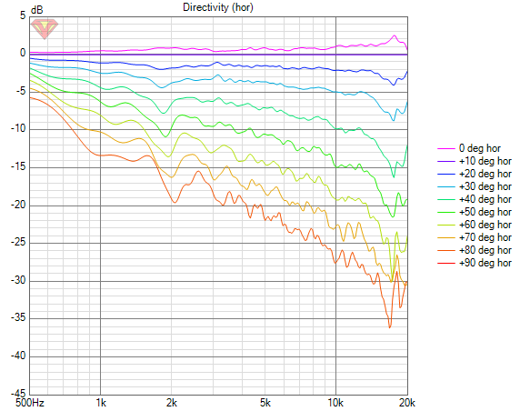

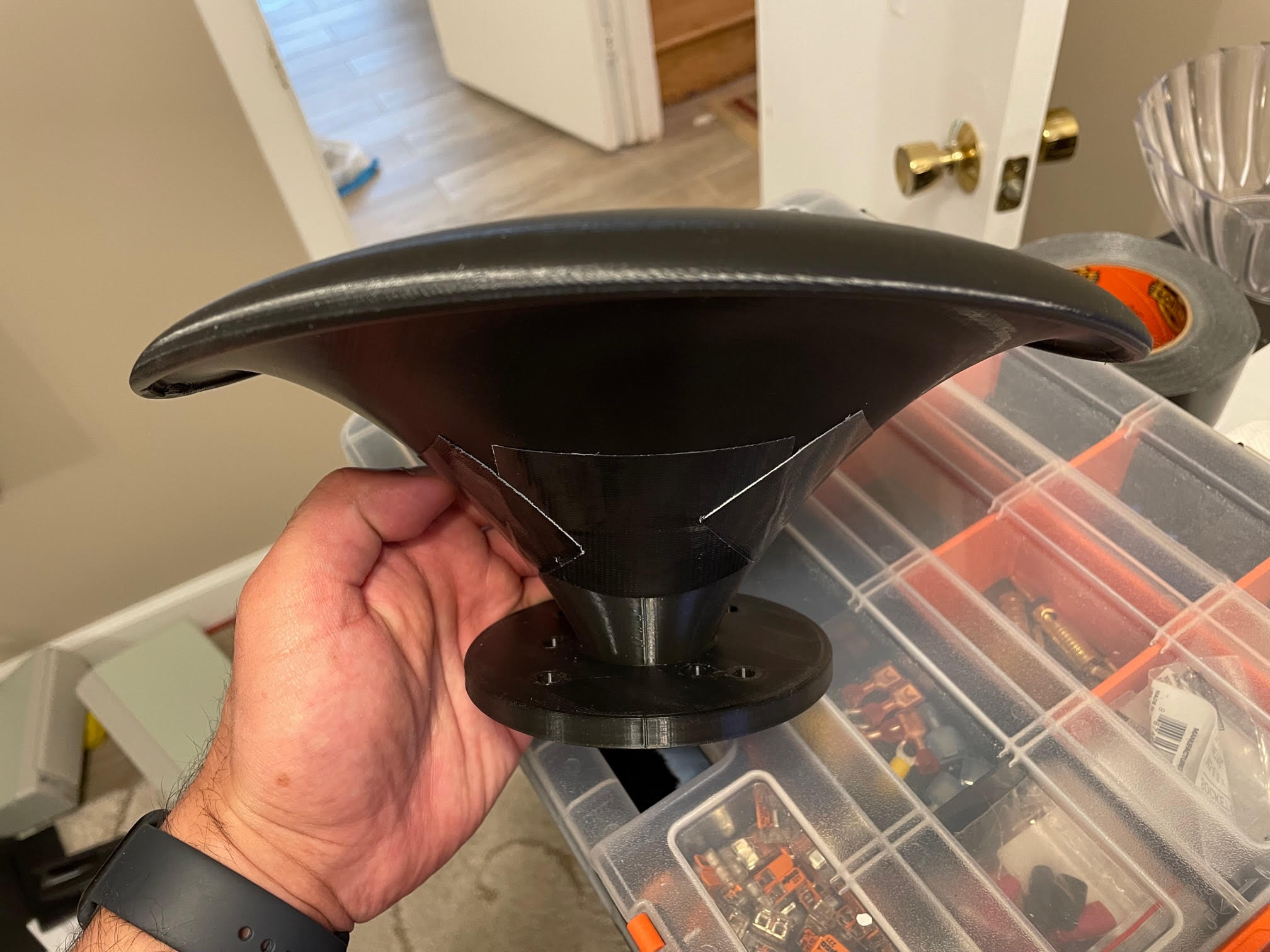

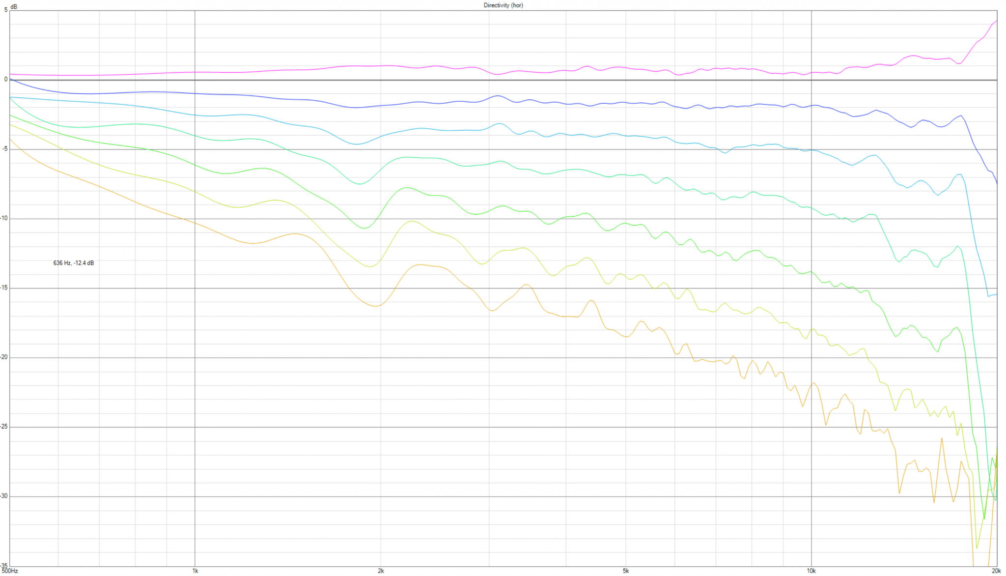

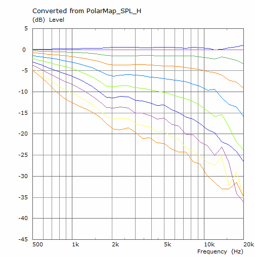

Here are horizontal polars utilizing the horn above with the Peerless DFM02535R00-02 (including normalized at 10 deg)
The print wasn't perfect, and I've attached the pieces with just duct tape. I might have also faulted on the placement of the horn+driver combo at the correct rotational axis - so please take these measurements with a grain of salt. Think of these as worst-case scenario 🙂.

These are the two data sets (measured and simulated) merged into one image:
That's pretty impressive correlation - especially considering this was just a tapped-up horn. The dip at 1.8Khz - 1.9Khz is a little more pronounced in my measurement - but again - it could come from less-than-ideal attachment of the two parts (and/or not placing the horn on the exact point of rotation).

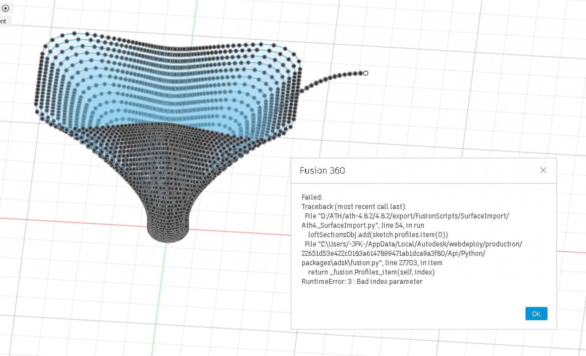

I have try F360, but got this error, any idea ?
I have seen this error several times but never figured out the cause. I would do it manually - import only the splines (there are scripts for that as well) and do the rest via the Fusion tools (surface/loft) step by step. That way you have the full control - can select a subset of the curves, add rails, etc.
BTW, I think you have a way too many curves there - that can only cause problems.
I also saw a recommendation to disable the command history in Fusion.
This does work sometimes as Fusion will loft things in Direct Modelling that it refuses to do otherwise. You enter it by selecting Do not capture design history.
Fusion is very picky about rails they must intersect each profile/slice precisely. Unless you need them to keep the shape accurate the loft may work better without them.

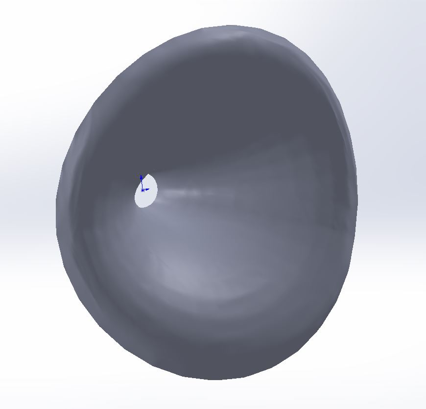

Did any tutorial as been made for Fusion from point cloud ?
Point clouds are too hard to work with. Try my Solidworks Excel macro as that provides the same functionality as mabat's script.
https://www.diyaudio.com/community/...-design-the-easy-way-ath4.338806/post-6358858
Instructions in the post below the link above.

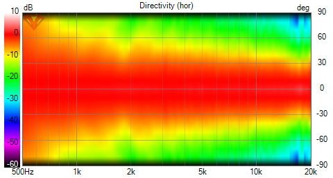

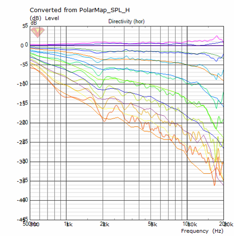

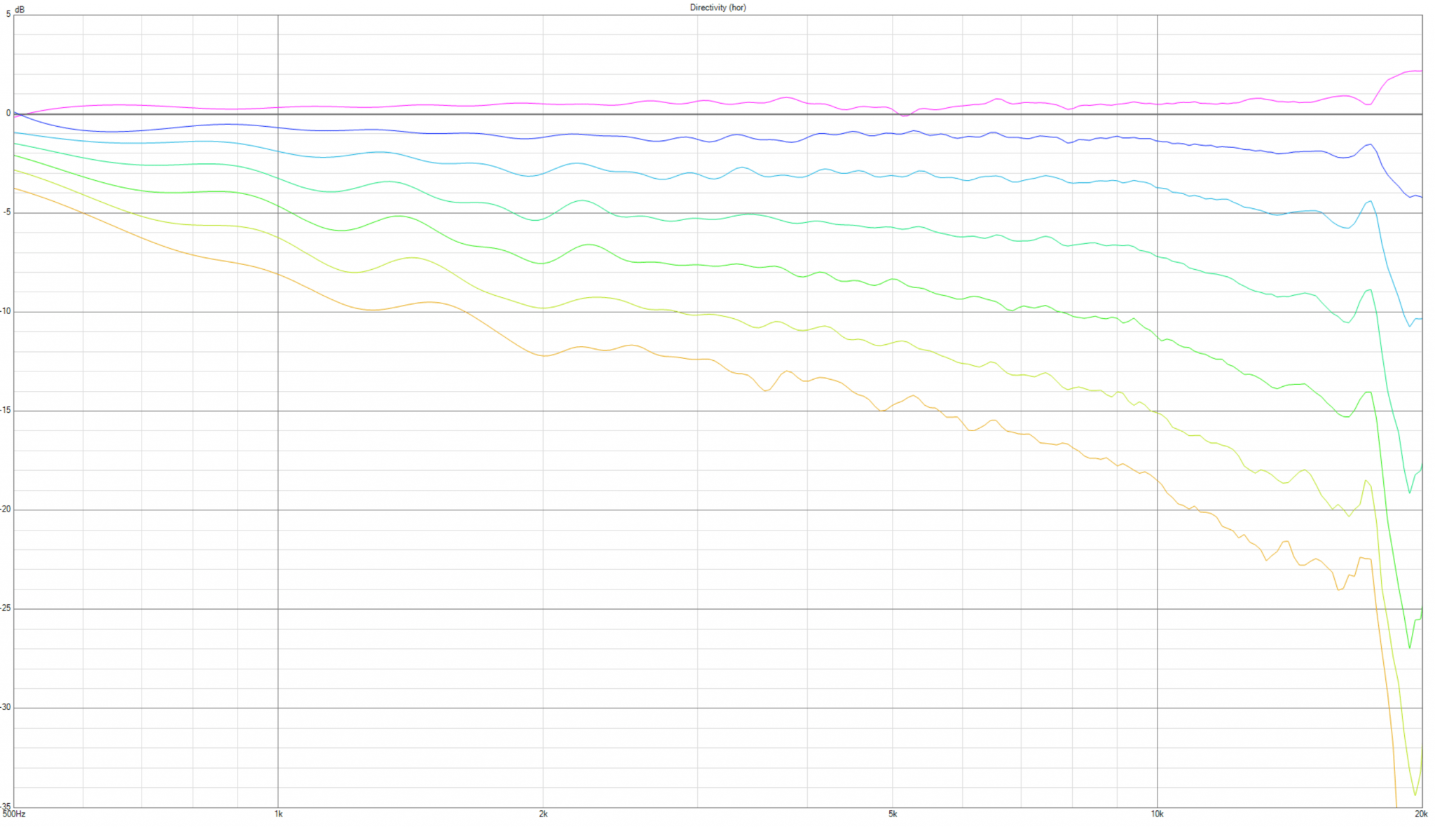

Here are horizontal polar measurements of the ST260 vs ST260-KVAR (same driver, the Peerless DFM-2535, and at the same distance).
Normalized to 10 degrees. I should have included labels, but the ST260 is the smoother one. So impressed with the results.
