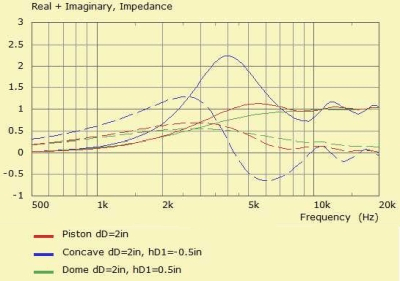

Forgive me from copy & pasting an abridged version of a previous explanation. There's some good content on this in the ABEC3 / AKABAK3 help file, which includes the example plot shown.Since already mentioning:
-Real part of throat impedance is 0 unloaded or no more coupling???
- What does the imaginary part tell us?
The vibrating diaphragm of a loudspeaker changes the pressure of the air via displacement, which creates a reactionary force that exerts itself back onto the diaphragm, proportional to the velocity
of the surface. The ratio of this mechanical force to the surface velocity is called the radiation impedance, as defined by
Z_MR = f / u_n
Where f is the force and u_n is the surface velocity normal to the surface boundary. The result is a complex number. The real part represents the resistance (R_A) from the propagating sound waves. The imaginary part consists of the reactance (X_A) from the additional mass created by the air cycling close to the surface.
This reactance creates a phase difference between the pressure and velocity of the surface, which accelerates the diaphragm’s mass rather than making sound - in effect, reducing the available output.
Acoustic impedance is the complex ratio of pressure p, averaged over a one-dimensional surface area S, to the volume velocity U through the surface. The volume velocity can be found by the multiplying particle velocity u at each pressure measurement point by the radiating surface area.
Z_a = p / U = p / uS
It can be helpful to consider the acoustic impedance concerning the characteristic or specific acoustic impedance of air. The value obtained is normalised, which allows easier comparison between data sets.
Z_s = ρc
The mechanical radiation impedance Z_MR has a relation to the acoustic domain by the equation
Z_AR = p / U_n
Where p represents the sound pressure, and U_n is the normal volume velocity across the surface.
It is important to note that this radiation impedance is affected not by the material properties but by the geometry of the surface and the surrounding environment. The shape and size of the diaphragm radius (a) relative to the length of the sound wave, represented by the complex wavenumber (k), dictates the shape of the wavefront.
When ka becomes large, the radiated wavefront becomes planar, showing a high value for R_A, which equates to a high output efficiency. If ka < 1, the reactance X_A dominates, and the sound output is reduced.
The resistive part of the acoustic impedance R_A finds its electrical analogy in a component that converts energy to heat. Since power is only dissipated in resistive electrical components,
the load for a voltage, force or pressure should be purely resistive to ensure maximum energy transfer. The higher the real part of acoustic impedance Z_A value, the greater the acoustic pressure
output.
Conversely, the higher the value of the imaginary part X_A, the greater the acoustic mass, which reduces output and may cause resonance. A negative value for X_A represents an acoustic
stiffness.
The red curve is of a flat circular piston, the blue of a concave shape such as a typical loudspeaker cone, and the green of a convex shape or familiar dome source. All three curves become asymptotic at high frequencies, corresponding to plane wave propagation. This is represented by the ratio of the specific impedance of air to the area S of the radiating surface.
The real part of the radiation impedance becomes close to zero at very low frequencies, indicating little to no sound pressure output.
As the wavelength becomes close to the radiator’s dimensions, the radiation impedance for each source begins to deviate. The shape of the curves depends on the geometry and surface vibration of the diaphragm and the environment.
The analytical piston source’s resistance (solid line) rises steeply, without much overshoot, while the reactance (dashed line) is mass-like over the whole passband. The dome shape, equivalent to a soft dome tweeter, is similar to the piston but has a smoother transition to higher frequencies within the resistive part.
The concave-shaped diaphragm, representing a cone speaker, features an apparent overshoot in resistance, which indicates a resonance where the output will be most substantial.
The imaginary part also exhibits negative-valued regions, representing a spring-like stiffness caused by the cone cavity.
This relationship indicates that an increase in the depth of the diaphragm produces an acoustic impedance which begins to approach the behaviour of a horn.
Eventually, the shape would become a straight duct, and pronounced ripples in the radiation impedance would correspond to the standing waves within the pipe.
If the real part of the radiation impedance is low or close to zero, and the imaginary part is high, we can expect resonant behaviour because the diaphragm mass becomes poorly damped.
While a coaxial diaphragm or similar might have sufficient output alone in this region to get a suitable SPL, it may not be a particularly pleasant sound - typical design guidelines suggest using a high pass filter (electrical or acoustic) to roll-off the response before the natural LF resonance of a compression driver.

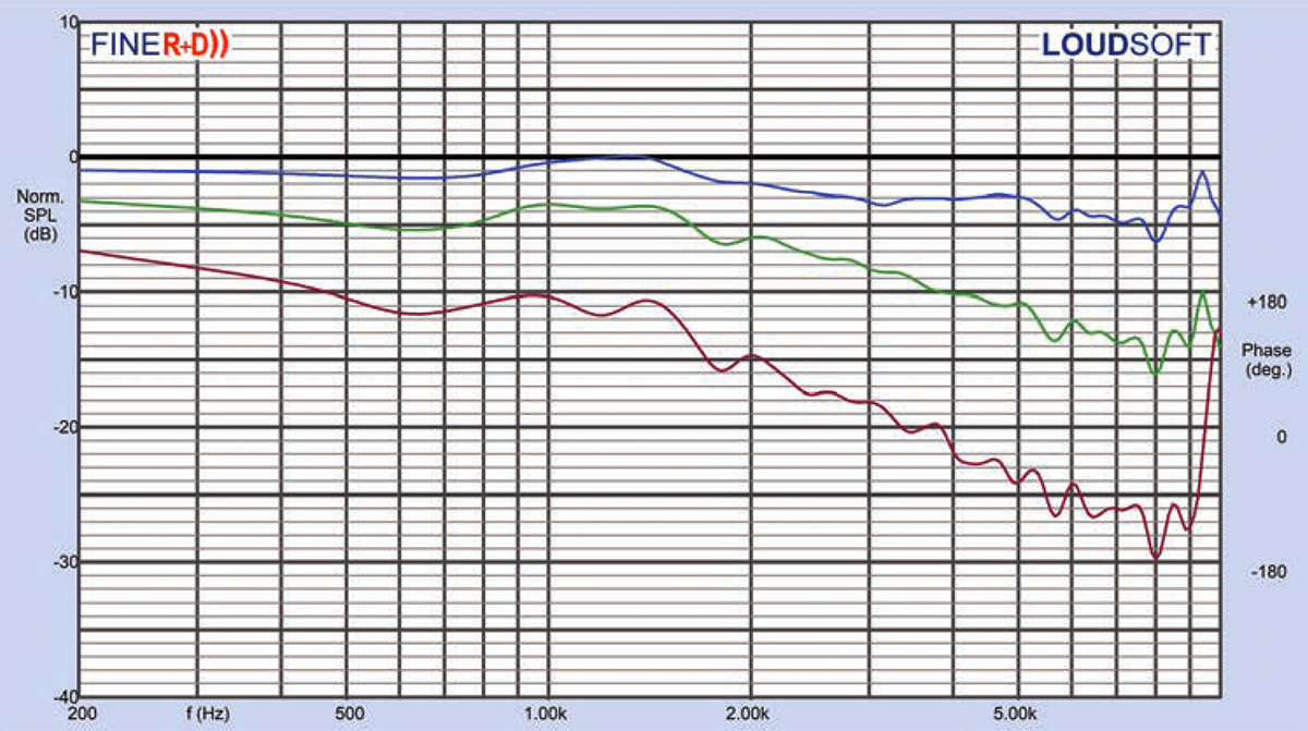

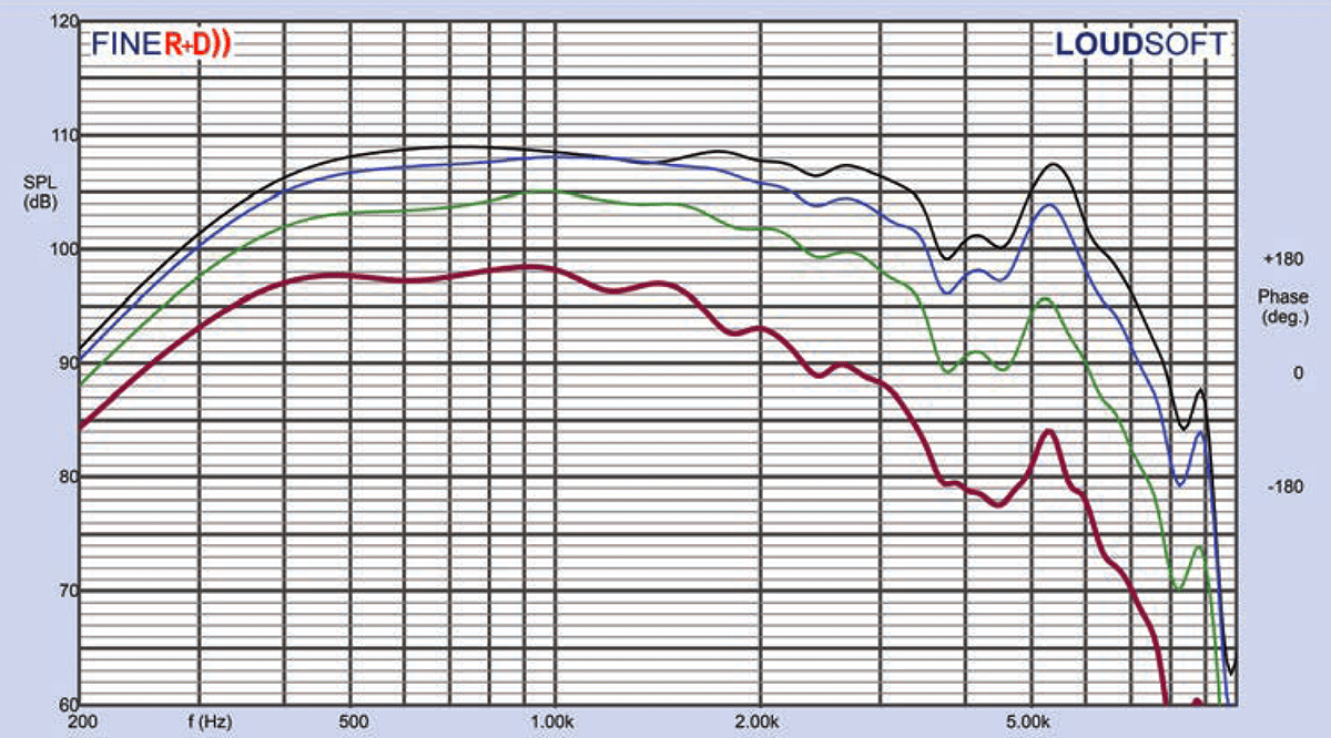

Moving back to horns or waveguides, the loss of resistive loading can be an indicator of resonance or 'horn honk' as I mentioned previously.
A good example of that can be seen on the early prototype horn that B&C sent out with the best performing midrange coaxial CD source:
https://audioxpress.com/article/tes...igh-power-coaxial-compression-driver-and-horn
This is a horn of 444.5mm in length, and an elliptical mouth of 597mm x 444.5mm. I think it should be possible to generate in Ath if someone is keen to see the radiation impedance.
While I understand the reasoning, it's a shame there's no polar data for the horn shown in this article. What we do see however is the off-axis response for the MF element, with normalised:
The frequency response looks good down to 400Hz, and it's pretty well controlled too. But as ever, magnitude response alone doesn't tell the whole story. The CSD and STFT waterfall plots show some interesting things below 600Hz, that don't necessarily appear in the above data:

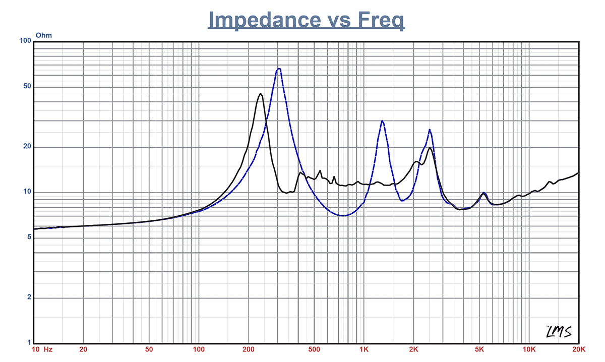

This is an issue that becomes more prominent when the reactive part of the acoustic impedance dominates the response.
The lack of resistance can lead to under-damped resonance. Depending on the measurement method, in the example, this appears to be as much as four times the decay time for the majority of the source's frequency range.
Now the question is whether this is much worse than the alternative cone driver... either way, there are other things to consider when choosing your crossover region (acoustic or electronic) than just magnitude response and directivity.

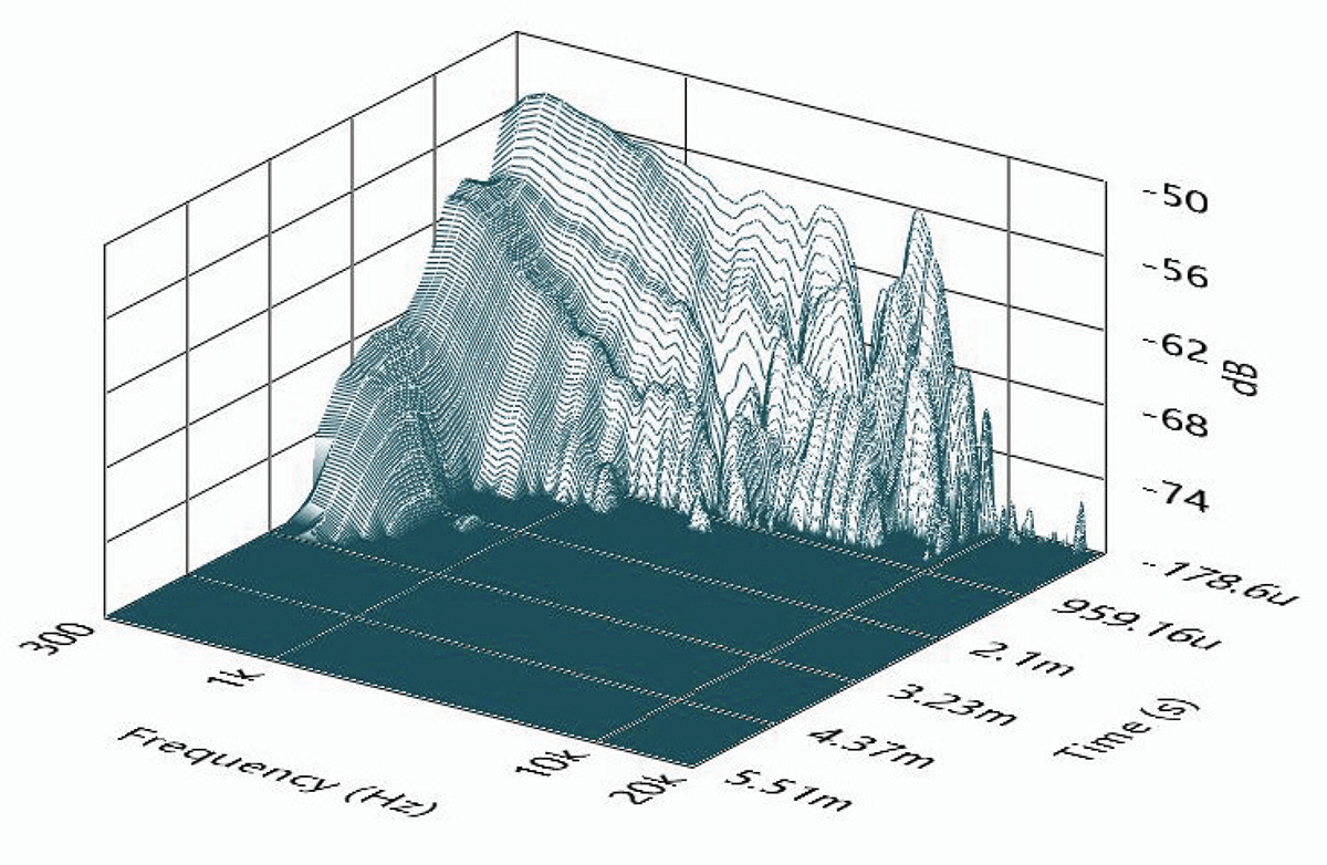

I'm not sure I would agree with the suggested conclusion about the "resonance". This would imply that the horn is not minimum phase which contradics all my experience. I've never seen a time issue that would not be directly related to an amplidude non-flatness (and then, it would not be a resonance anyway). So the suggestion that the amplitude response doesn't show it all is not correct, IMO. It may hide ("smooth") things if the measured time window is too short, that's true.
Now I wonder how strong may be the influence of the whole horn (implies the mentioned issues at low frequencies) at a synergy design. In contrast do a coaxial driver the mf/lf part is intruduced later in the horn and also has some interaction with back-reflections. Maybe I modifiy the st260 to simulate this within the next days.
I don't believe there's an issues at low frequencies with any horn, a one that would not be correctable simply by making the amplitude response flat with a minimum phase filter.
So you see the mentioned waterfall below 1kHz as another issue? Can also be the driver itself of course or the internal coupling or….
I think there's really no issue below 1 kHz. The measurement is not very telling in this regard either, it's quite hard to make an anechoic measurement in the 300 Hz - 1 kHz region - a one that would reveal the details. For example there's obviously quite a sharp HP knee above 300 Hz - see how smoothed it is in the rest of the measured data. This has also its decay in time that's to be expected to be shown in the CSD (again, here vastly "blured").
The plots in AudioXpress test bench reviews aren’t generated from a single sweep. Each measurement is done with a different method, and they’re all quite well documented in the text of the article for the sake of repeatability.I think there's really no issue below 1 kHz. The measurement is not very telling in this regard either, it's quite hard to make an anechoic measurement in the 300 Hz - 1 kHz region - a one that would reveal the details. For example there's obviously quite a sharp HP knee above 300 Hz - see how smoothed it is in the rest of the measured data. This has also its decay in time that's to be expected to be shown in the CSD (again, here vastly "blured").
The electrical impedance plots given show the driver with (black) and without (blue) horn, using 300-point stepped sine measurements. That’s useful to see the contribution of the horn’s acoustic impedance on the overall response:
The time-frequency plots in this particular case are done with a Listen Inc system with the mic at 10cm from the horn mouth, and an adjusted drive voltage to give 2.83 V / 1 m equivalent data. That’s a different set of equipment and software to the magnitude plots, which Vance Dickason typically does with LoudSOFT FINE and CLIO.
Since the maximum time periods shown on the waterfall plots are 5.49 ms, there’d need to be a reflective surface (other than the horn itself) closer than 2 metres for it to be seen in the data. I’ll give you that the anomaly at the edge of the STFT window around 1kHz could possibly be from the mic stand or body, but the Listen Inc SCM capsule is really thin and long:
