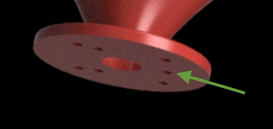

I am aware of the original intention. I just wanted to mention that with the bare driverd without the wavegotmer you have a driver with a ring instead of a hole source. Just curious if this might give more flexibility for wavegront shaping before entering the horn. Or you could get narrow vertikal beam avoiding floor/ceiling reflections. But no idea how we could get a non-round source simulated in ath.

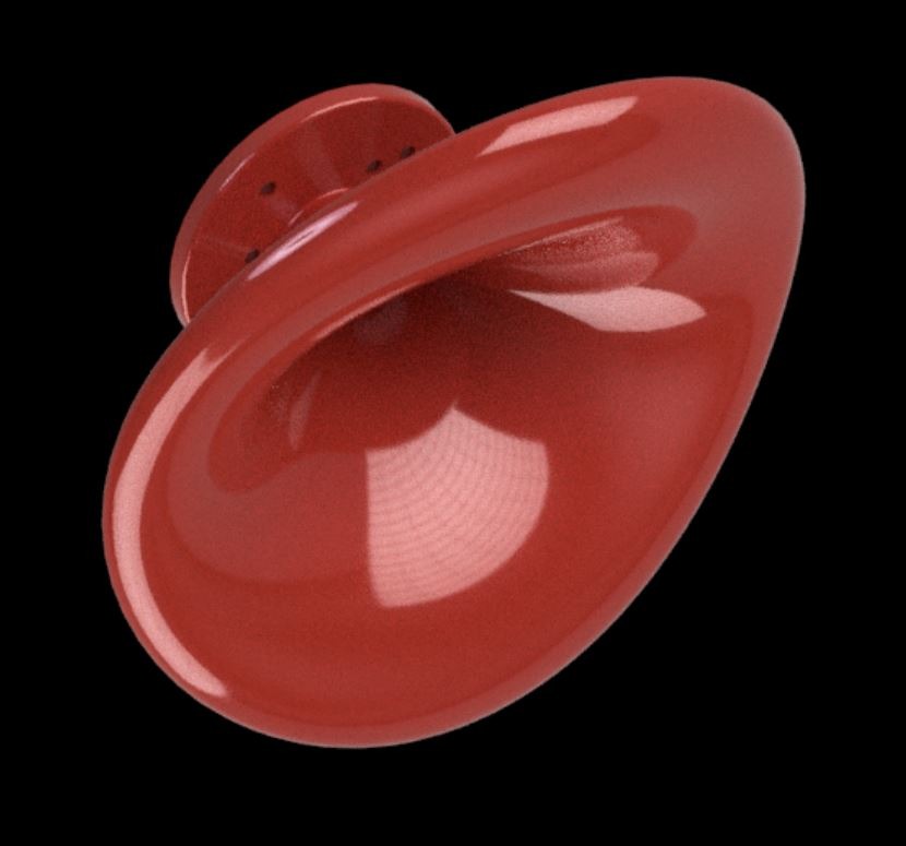

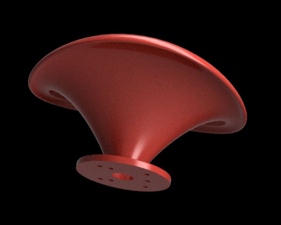

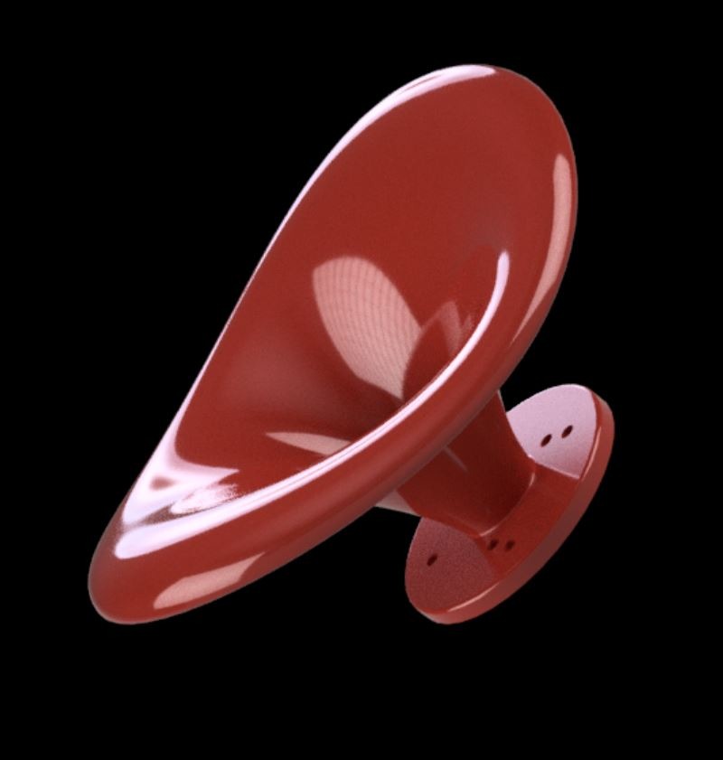

1" version for those brave enough to try it (STLs) - https://at-horns.eu/ext/ST260-KVAR-2022-4.zip
- From the right angle it looks like an ear. A coincidence? I don't think so (a joke).
When listening midfield, what is what one has to anyway, isn’t a more restricted pattern beneficiary to avoid ceiling reflections?Why this over the ST260?
If the beamwidth is not constant, there's no "restricted pattern" - the reflections simply contain more of low frequencies and less HF. That's generally not what we want, but with the latest iteration we do the following compromises:
Does it make sense? I don't know - that's to be tried and judged by subjective listeting, I guess.
- there's still very well controlled horizontal directivity (can be as "constant" as we want),
- naturally (?) downward-tilted power response is achieved without making the on-axis/LW response tilted down,
- efficiency is improved a little bit on the lower end,
- the above is achieved at the cost of some vertical beaming.

I hope soIs that one in the right place?
(it's 3x@57mm and 4x@76mm)
