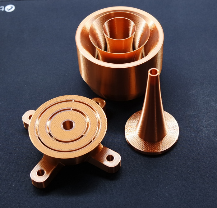

Well now it would be nice if it also worked 🙂

Indeed. This is the way of the future, but more importantly I'm excited to see the results.

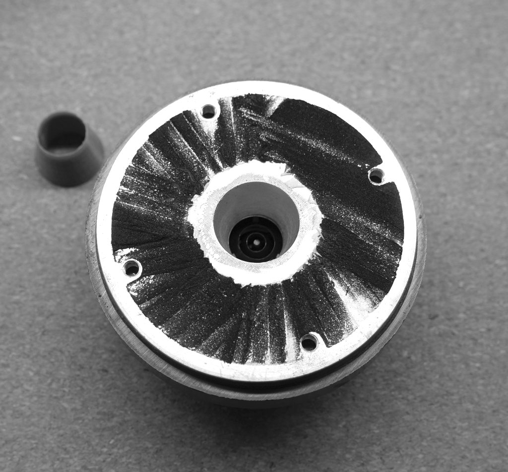

Not so long ago, the last external phase plug I made I cast the cone in polyester, which eased the surround due to the heat produced. Then inserted rods and used a dremel to work through it. I hadn't simmed it, just conventional design methods so I wasn't even sure what to expect. They took weeks to finish... now with simpler methods we are bound to improve by doing.

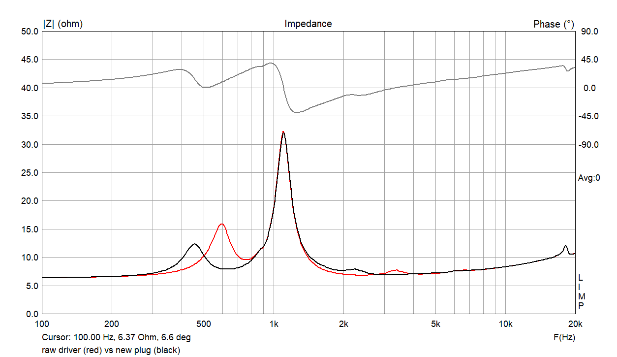

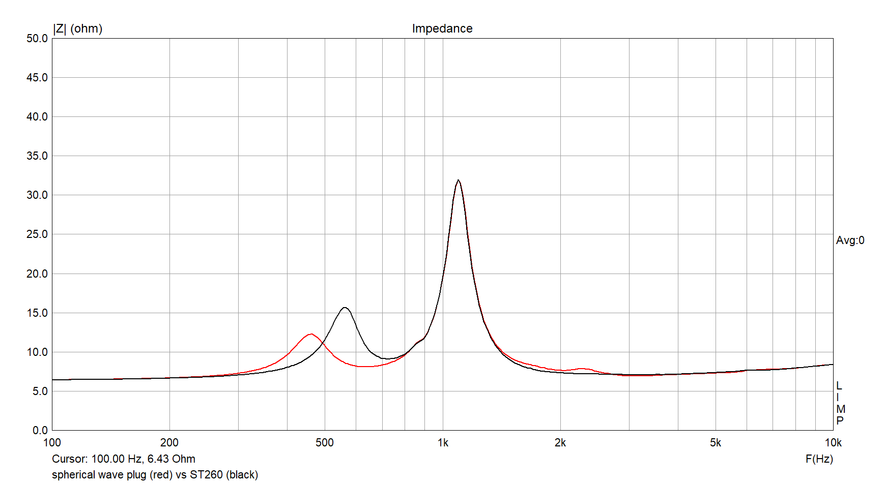

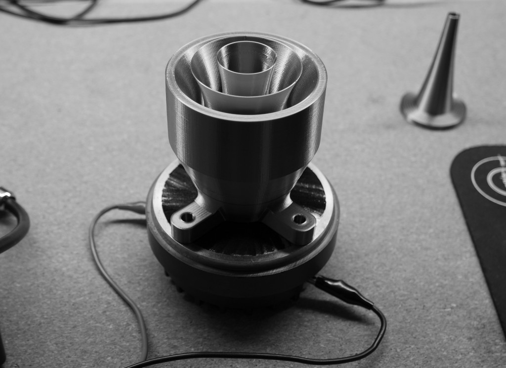

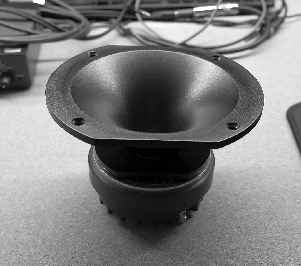

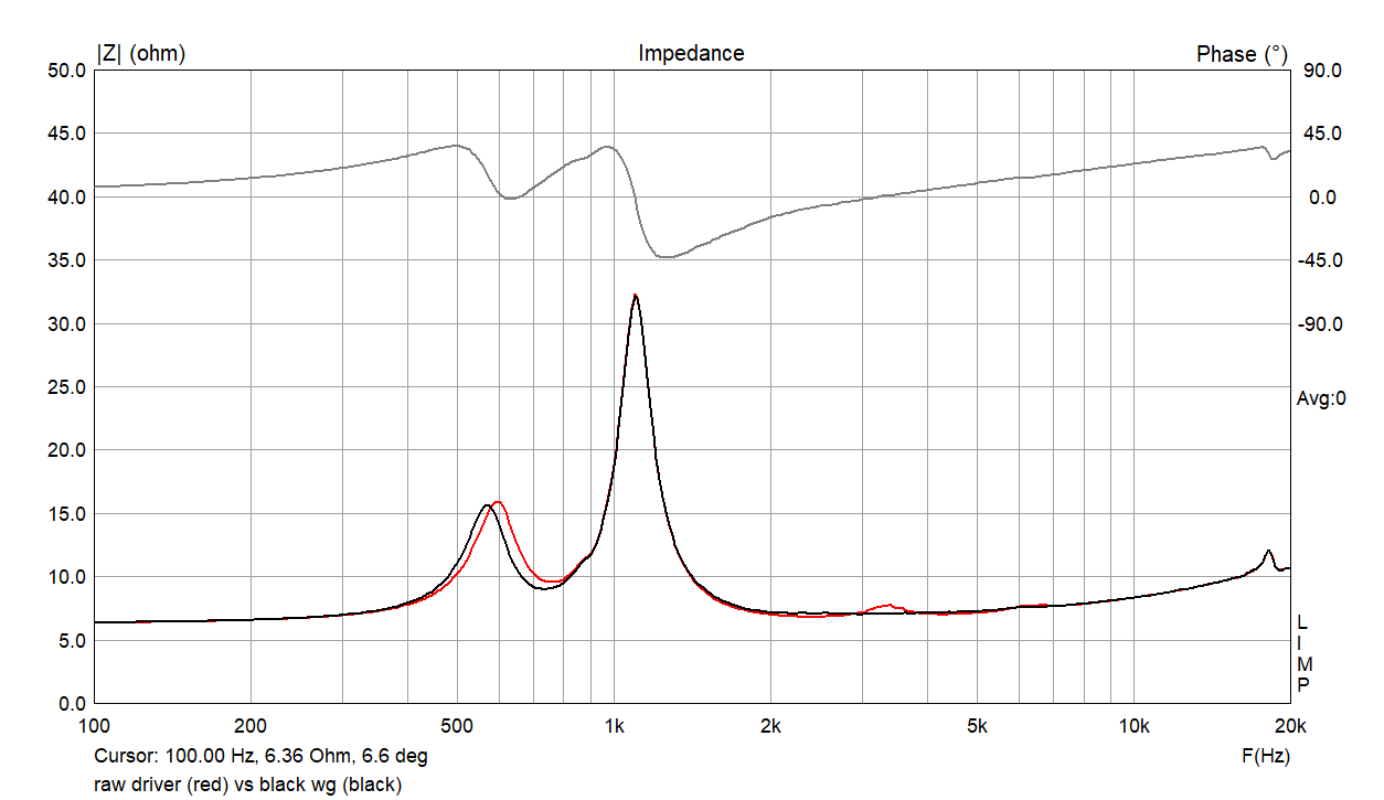

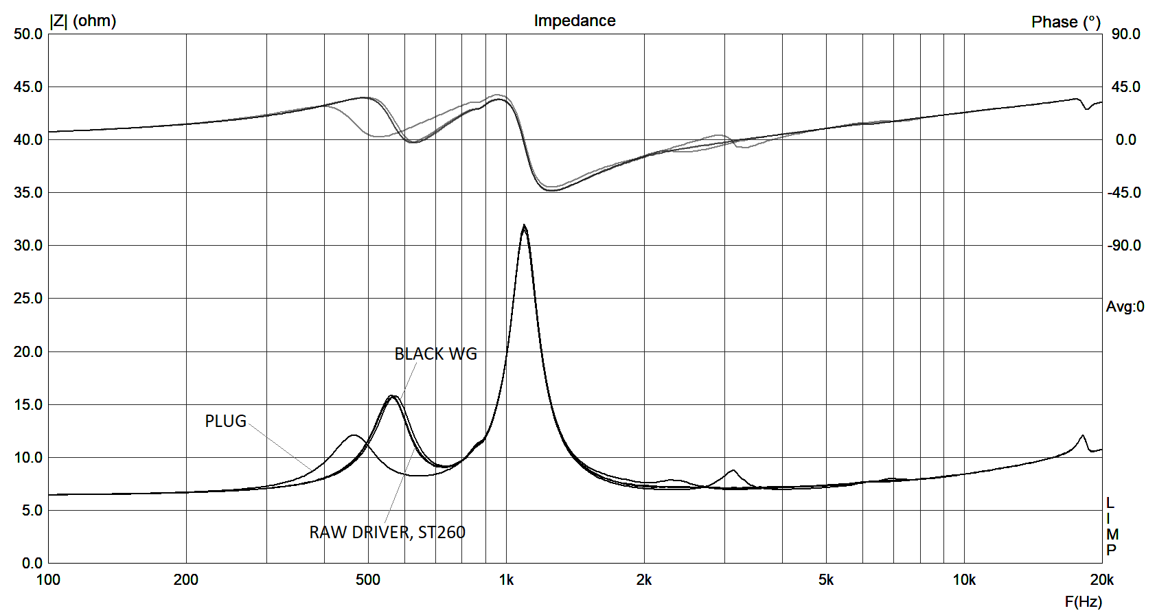

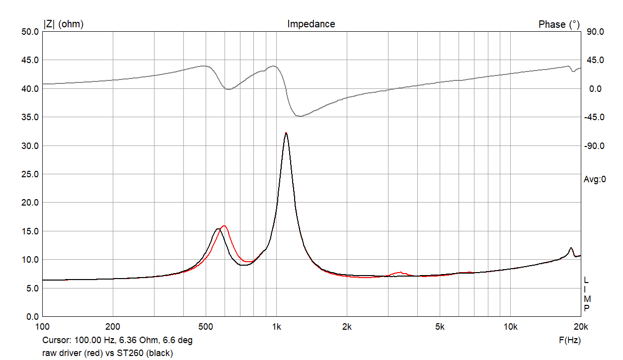

BTW, what can be said already (if anything), observing the lower impedance peak? This is a comparison of four different setups - raw driver, black wg, ST260, new plug.
- ST260 waveguide has virtually no effect
- the new plug shifts the peak lower and makes it more damped
- with the "black wg" (see the photo) the peak shifts a tiny bit higher (?!)
The driver is FANE CD131.
Disregard the previous graphs, I must have mixed it up.
I measured the impedances again, this time it should be correct -
There are two peaks because it is a coupled system, just like a ported enclosure. The null indicates the resonance of the coupled system (like the ported box resonance,) each peak represents the individual resonances - waveguide mass to gap compliance and diaphragm to gap compliance. The gap compliance is the coupling between the two masses. In your examples, the null lowers as does the waveguides resonance indicating that a significantly increased mass loading is presented to the system by the new design. The driver's peak does not change.
I don't know if this is a more intuitive description for you, but the mass loading is closely related to the radiation reactance of any radiator. If the reactance is positive, then it is said that it adds mass, if it is negative then it is said that it adds compliance. The greater radiation reactance is, the greater loading mass is.
The manifestation of radiation reactance itself is somehow related to the problem of spherical divergence of the acoustical wave.
Yes, probably it is the most intuitive difinition of of the added mass. Here is the picture from Kinsler et al. - Fundamentals of Acoustics that explains how reactance is related to the added mass in the case of flat piston radiation.
That is a good illustration, of what is going on Mabat!
I suppose that the impedances of the fanes are well matched, otherwise there would have been artefacts in the impedance response higher up in frequency where the air wouldn't be just moving back and forward with the source.
Honestly, I don't have a clue, maybe that's not even a requirement (and I would doubt they are matched). For example, changing the area ratios of the channels (i.e. moving the positions of the vanes) virtually doesn't change the acoustic impedance of the throat (so neither the electrical impedance, I assume).
