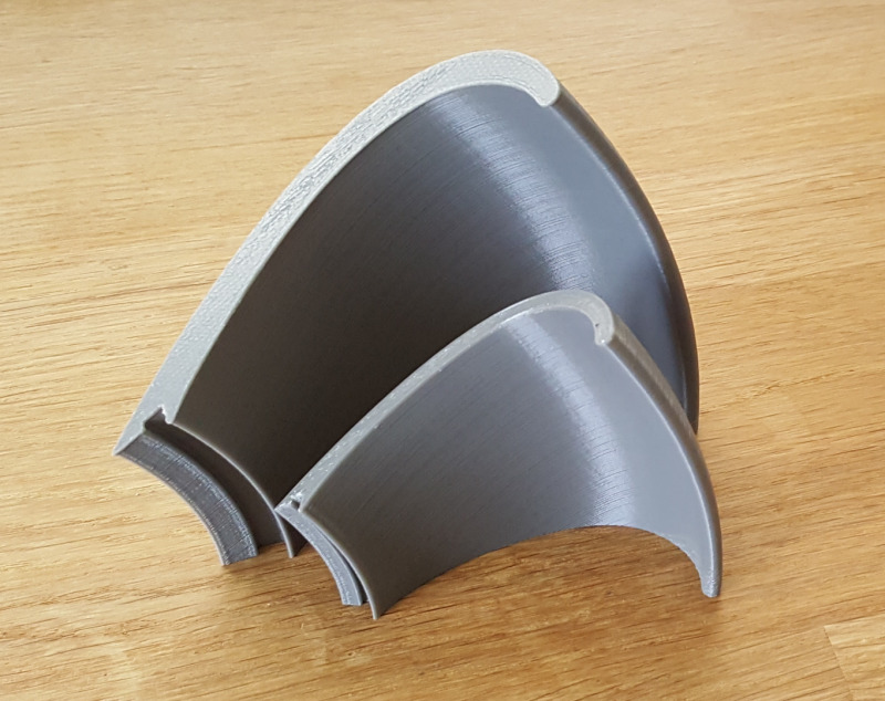

Suddenly it's funny how is the ST260 actually small - ST260 vs CE360 petals.
And I also already know the tolerance needed - the groove on the petal is 0.3 - 0.4 mm too narrow in my case. Shouldn't be problem to fix this.

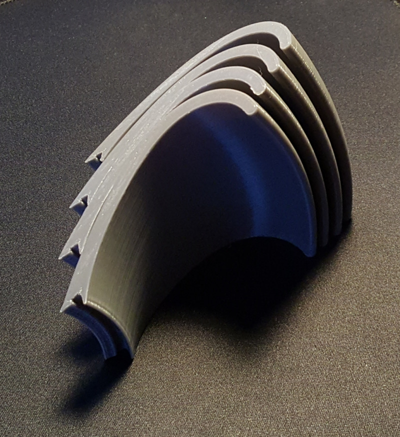

YES! 🙂
- No sanding yet, these are raw pieces as they left the printer, no glue yet.
I only wish the inner surface of the base was better but it seems I can't figure out how to do that in this case.
YES! 🙂

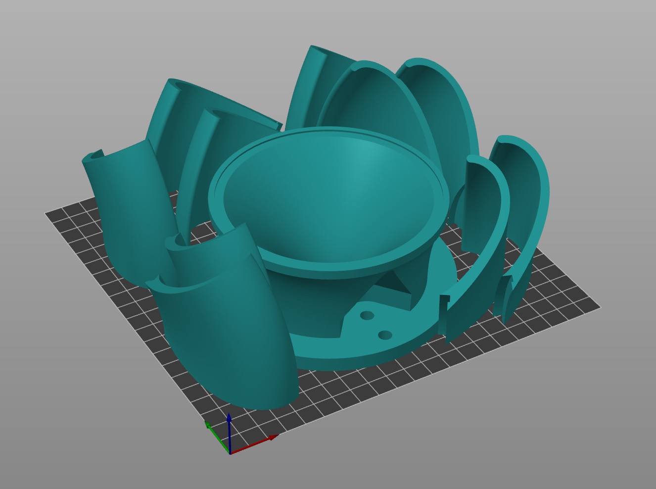

As I have it now, it would fit into 170 x 170 x 110 mm (x,y,z) build volume (e.g. Prusa MINI+ is fine).

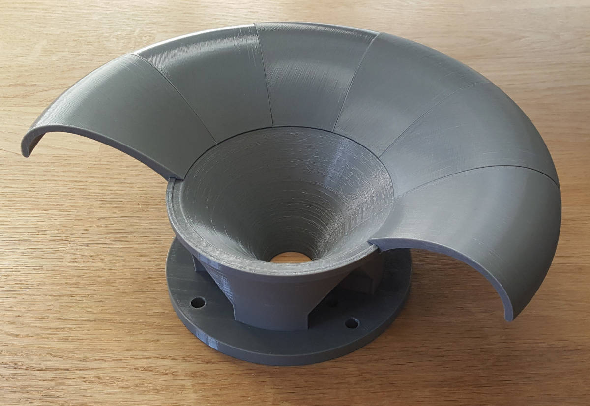

Continuing on the ST260 (no filler, no sanding, no glue yet) -
(Wonder what angle ajustment will require the last petal. So far it looks pretty accurate.)
