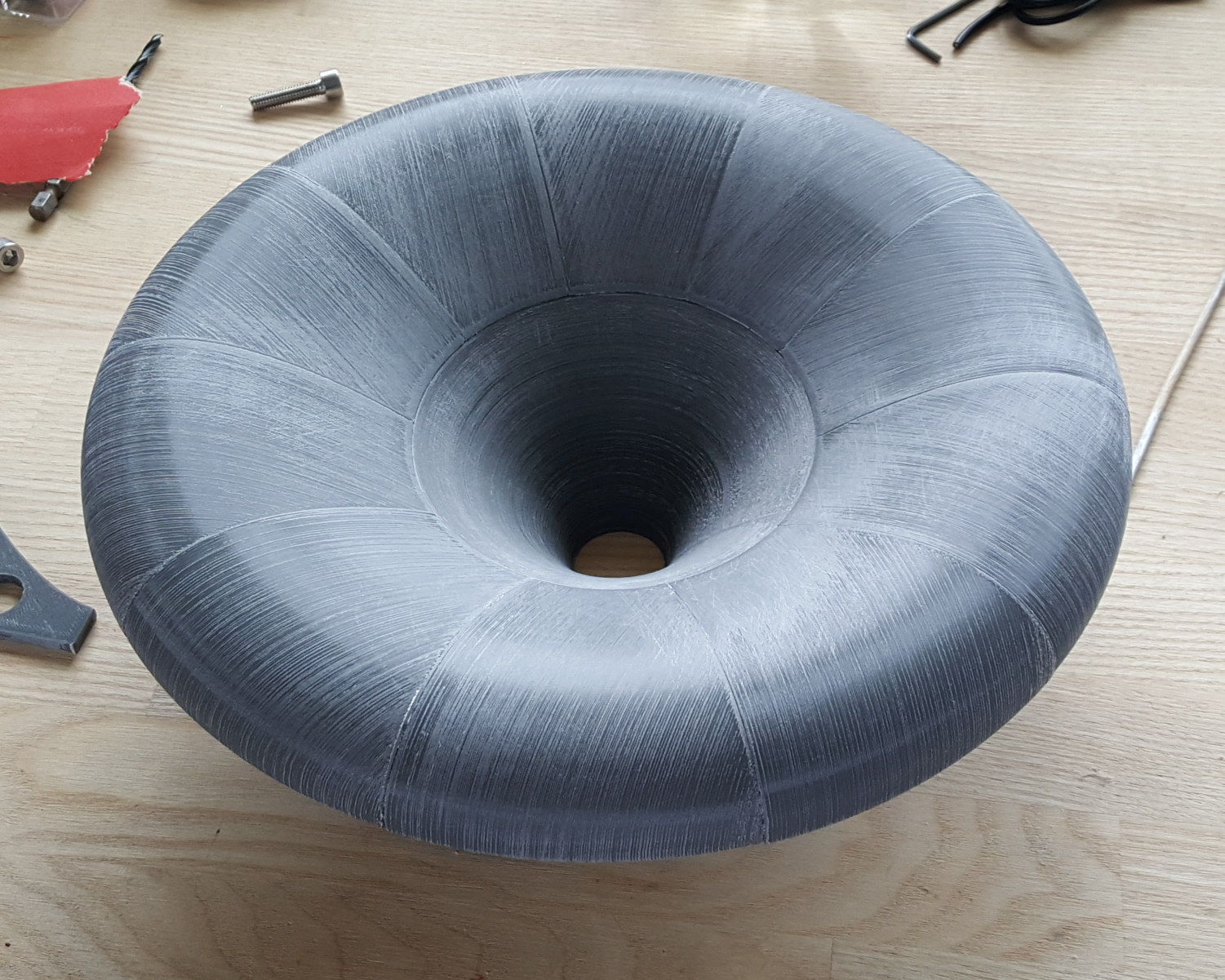

Mine is recycled PLA from EkoMB. Prusa Mini just prints this great with standard profiles out of the box. I have not tried PETG yet, since I do not have the textures plate. CA glue bond is stronger than the plastic itself. I used the liquid nails for filling the gaps. The gaps can be filled later of course.
Done. The last petal was tricky, I almost didn't manage to squeeze it in because of the speed of the glue, that will require a different method. No filler yet, just sanded a bit.

The thing is it's not warped, like at all. It would be much harder to make it from larger pieces (as virtually all ST260 prints so far were warped to a degree, it seems almost inevitable when doing it from halves).
The petals are still hollow. I will try to "cast" a polyurethane glue inside. It makes kind of a foam when wet. Or I will just leave them hollow...
I suppose you could fill them now when mounted if you drill two holes in each top and bottom. It might even be preferable for rigidity reasons. A none expanding low viscosity epoxy with a mix of fine sand could do the trick!?
