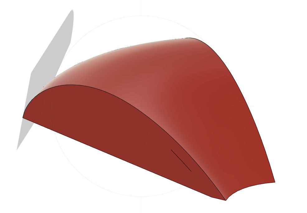

How and why?I wonder if the petals would print better with a flat back - and low or no infill.

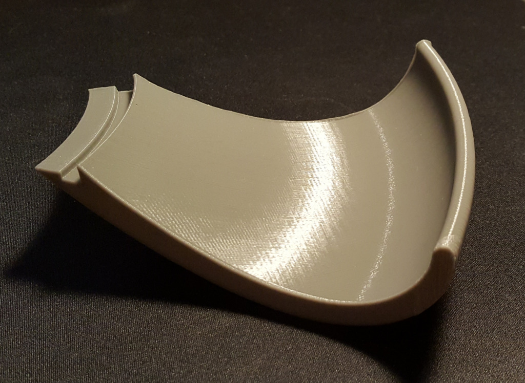

This is my current approach that seems to work very well (hollow, no supports) -

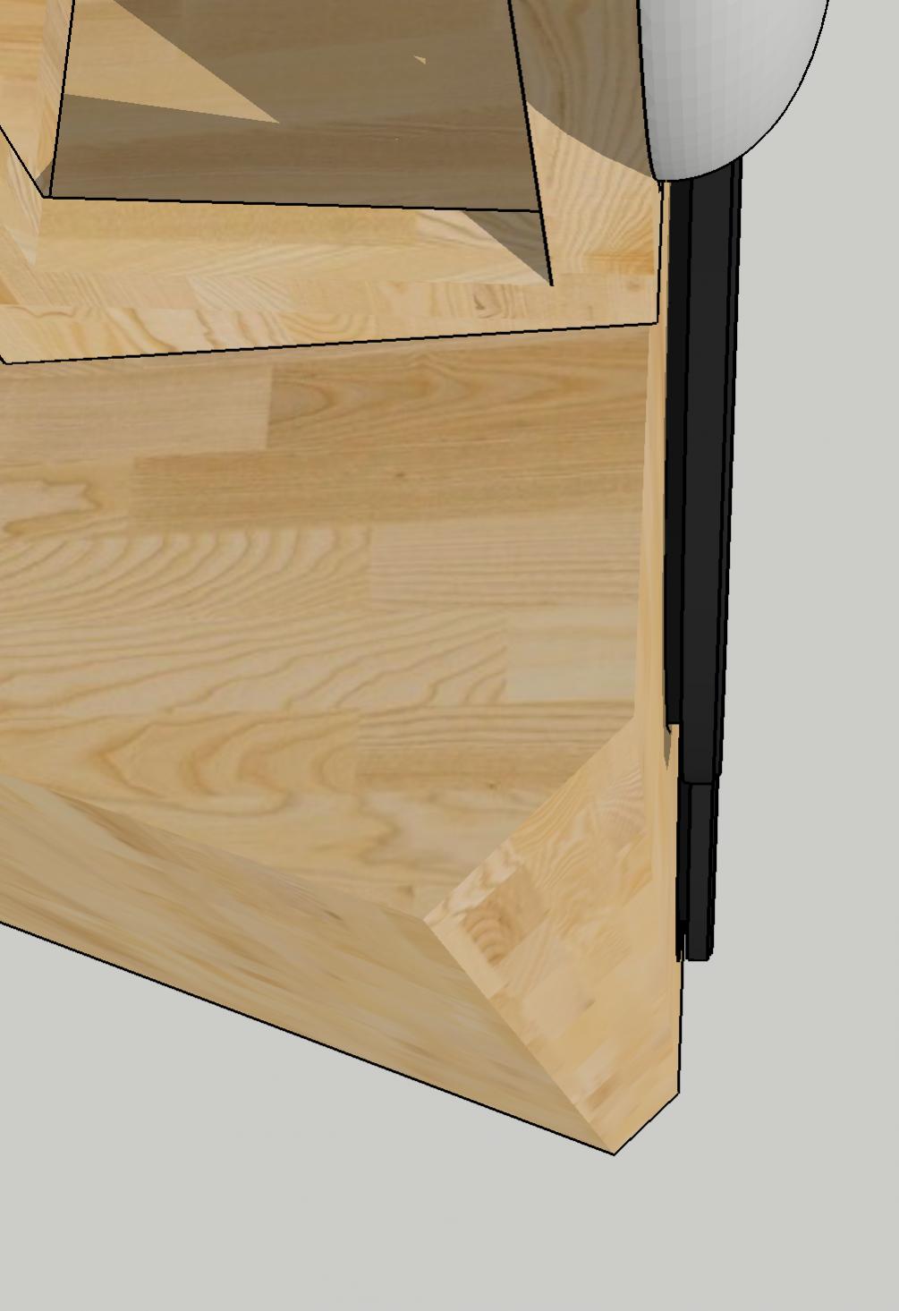

I mean like on the sand horn was IIRC. Curved front, straight back of the roundover. I think it would make it slightly easier to print - especially with 90 degree segments, there would be no overhangs if printed with the flat part on the bed. It might reduce the printing time and material consumption a bit and provide more volume for filling.Also there would be more area for gluing. Printed infill is not necessary if it will be filled later. The 45 degree segment should print fine as is. I was only playing a bit with PrusaSlicer. I think I will try that.

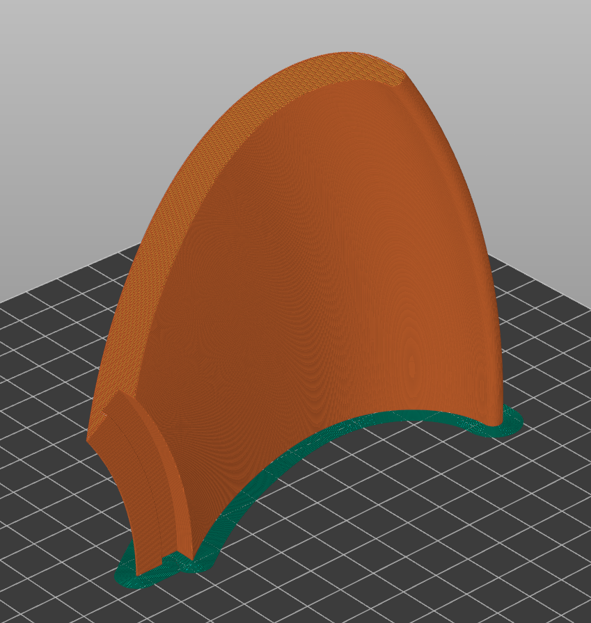

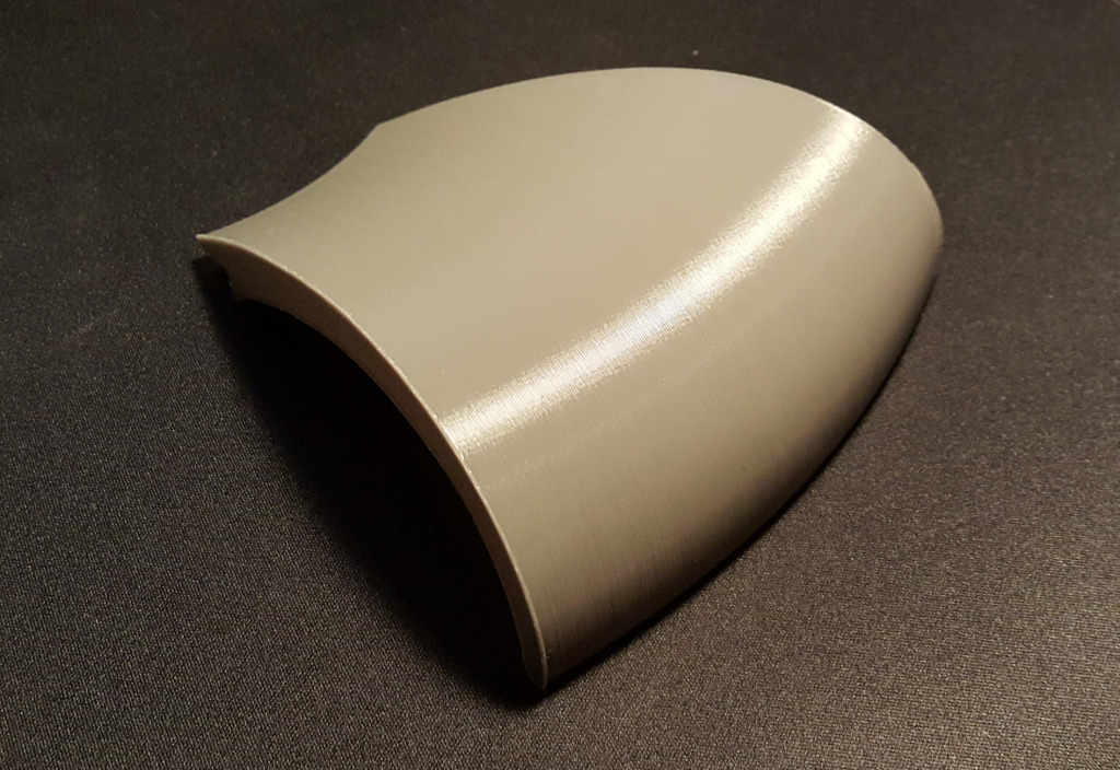

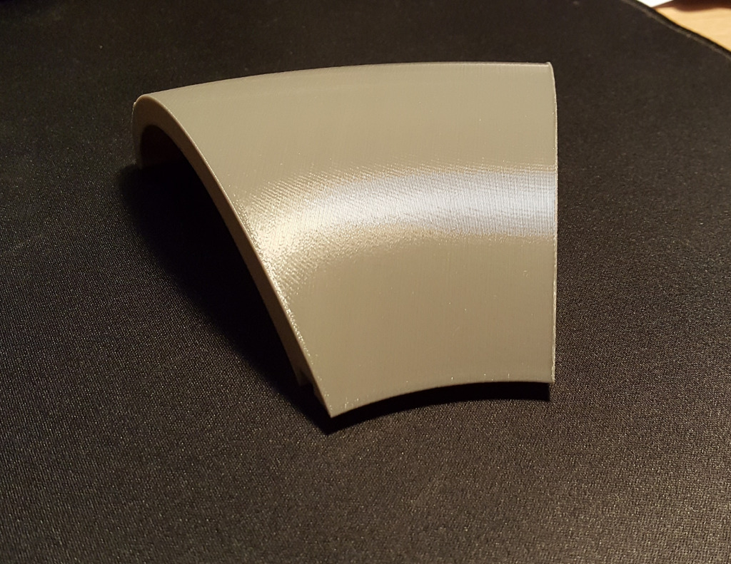

This is probably the cleanest I can make it (0.2 mm layer, 2 perimeters, completely hollow, thickness from 5 to 11 mm).
Now I need twenty of them for a pair...
Nice! What was the approximate print time? The side walls, how thick? It can be opened (how?) for filling?
Fill first, then assemble or assemble, then fill?
Something over an hour, 50 mm/s.
Probably assemble first - easier to correct for any residual warps. It seems pretty flat but still.

Two perimeters 0.4 mm each, so ~ 0.8 mm wall (seems strong enough). For filling it must be drilled at a suitable place.... The side walls, how thick? It can be opened (how?) for filling?

Sure, why not. When I simulated a flat back side like this, it wasn't as nice as the bent profile, but the difference will be probably negligible for any practical matter. Would be interesting to verify.
