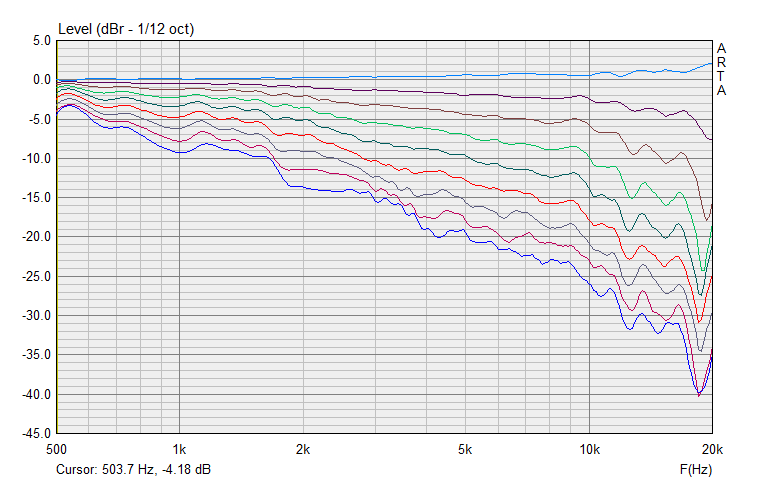

Mic distance ~ 1 m. I didn't measure the voltage. Don't look at the absolute SPL values, it's not calibrated (and probably even not comparable between the HF1440 and ND3T, as I probably I touched the level in the meantime).
- The Faital normalized to 10 deg (measured in the 7" test jig):

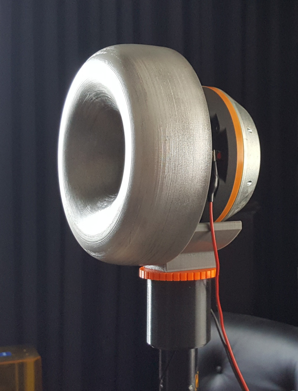

Here are the STL files for the test jig (WG + mounting set) for 1" drivers: https://at-horns.eu/ext/SWG25.zip
Mind you, the waveguide is design to be printed without any supports, in one piece as it is (some supports will be needed for the holder). I use it on a Hercules speaker stand. Any other mounting can be easily adapted and printed I guess.
I printed it all on Anycubic i3 Mega S without issues, both PLA and PETG.

My first measurement of Faital HF1440 on the test jig (#7299). I think it will shine in a large waveguide. Measured SPL for the both pieces I have.

Marcel, did you work out why the Faitals rung out so long at 800hz?
