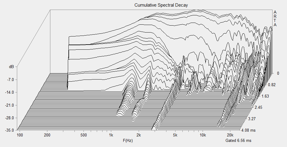

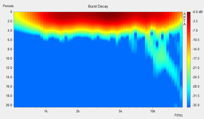

That's also the difference with a free standing device I see - the waveguide doesn't have to support/hold the driver, it can be the other way around, the driver can be clamped to something robust in the first place. I can imagine a free standing aluminum guide ringing like hell when hit with e.g. a steel rod, but would these resonances get excited during a regular playback to a perceptible level? A similar situation is with the sand printed (expoxy coated) waveguides - they are far from dead (this was a bit dissapointing at first to me) but I couldn't measure any resonances I could attribute to the waveguide when driven with the sound alone (looking at the decay trace). That makes me a little optimistic about that.I agree that waveguide vibrations is not going to be a factor with the kinds of drivers we use these days. But older TAD 2" drivers cantilevered out on a weak waveguide and that would concern me. A 1" neo - not at all.

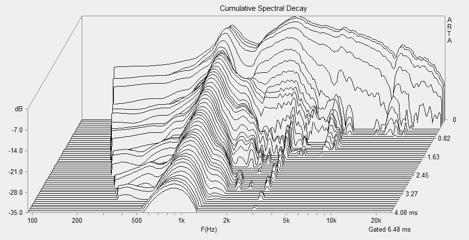

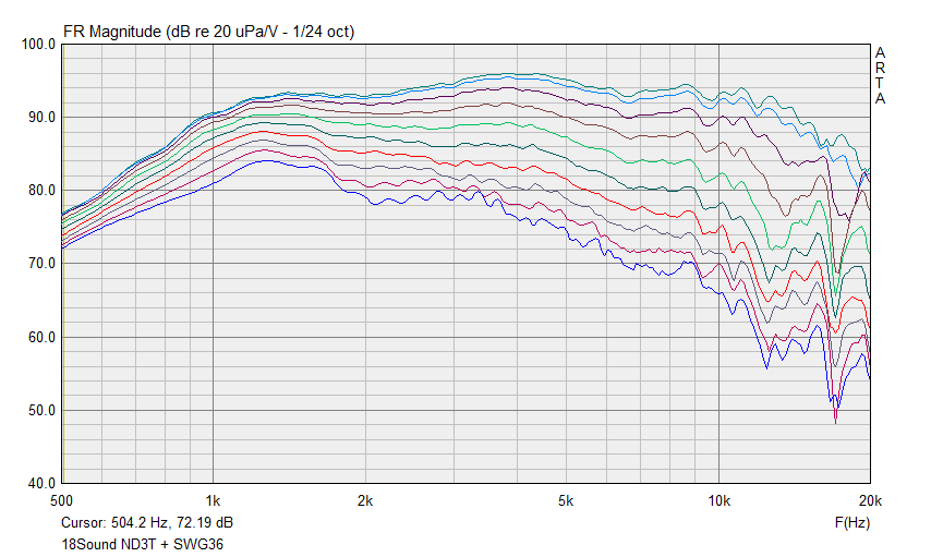

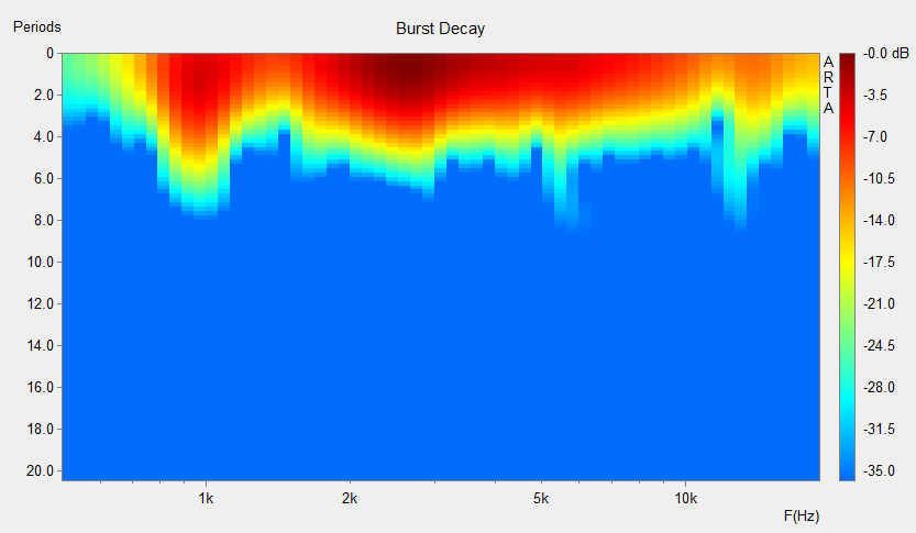

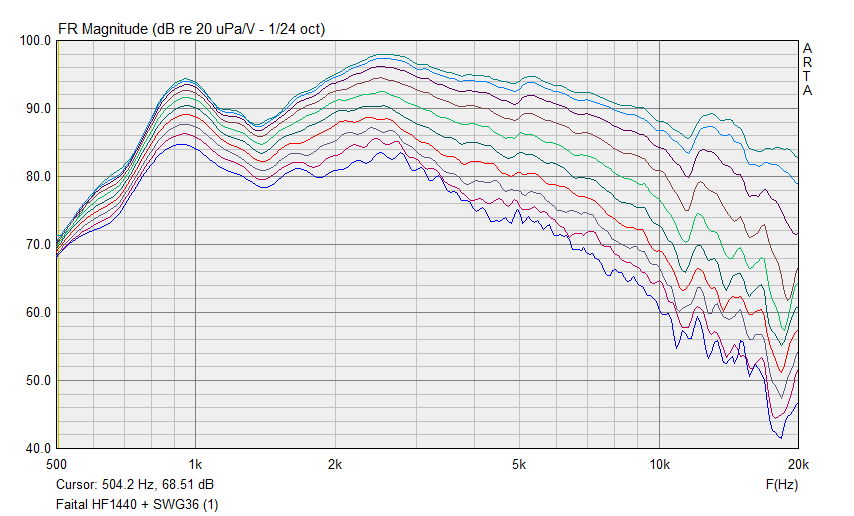

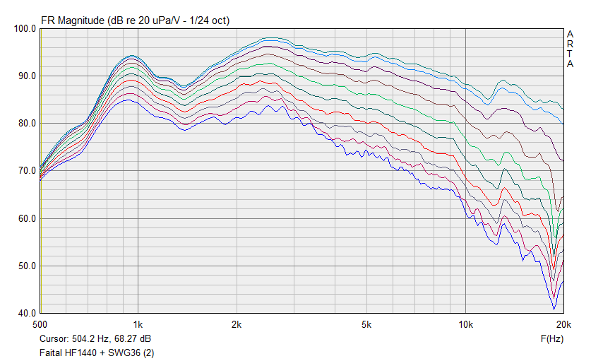

My first measurement of Faital HF1440 on the test jig (#7299). I think it will shine in a large waveguide. Measured SPL for the both pieces I have.
I agree about EQ but it's definitely not advertised - FaitalPRO | HF Drivers | HF1440 (8Ω)
At first I thought it may be the "waveguide" but obviously it isn't.
Otherwise I like the smoothness a lot, not typical for a big 1.4" driver.
At what distance and voltage are these measurements done?
