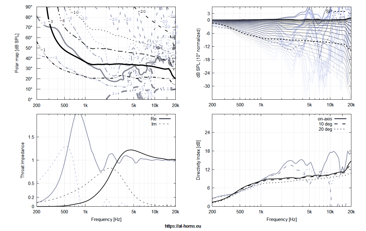

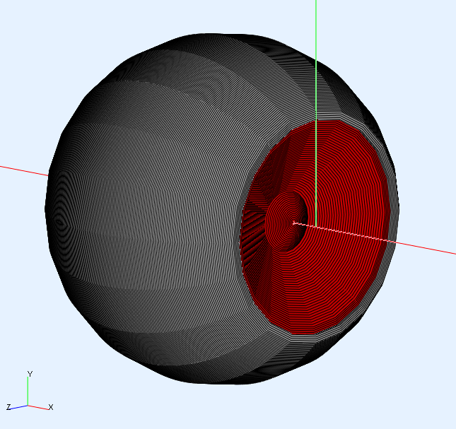

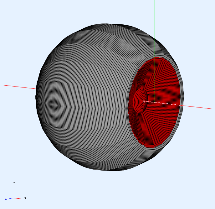

The CE360 should be actually pretty universal, usable with either 12" or 15" woofer. That's the main reason I would suggest it. This is a 12" woofer placed in a sphere (overlaid over the CE360 chart) - it matches the WG just below 1 kHz (it will be slightly different in a box).

+1 for CE360
