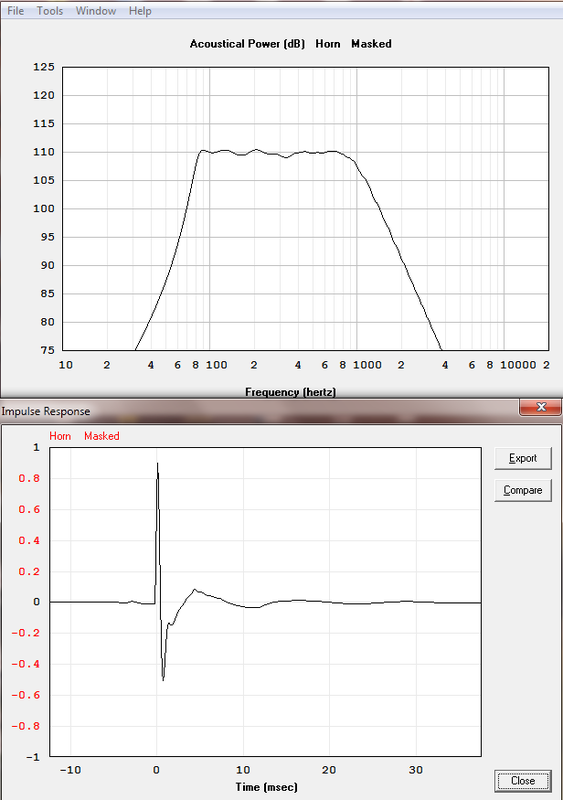

Can’t wait to see the results. My wife is planning on expanding her coffee roasting business and is talking about me constructing an incredible sound system for the planned cafe retail space. I showed her the plans for a meter-long midbass horn (see attached) and she has already given me the green light. Hopefully the ATH and midbass horn will be a happy marriage.

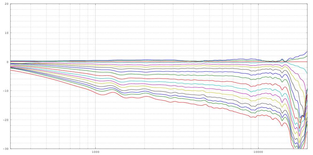

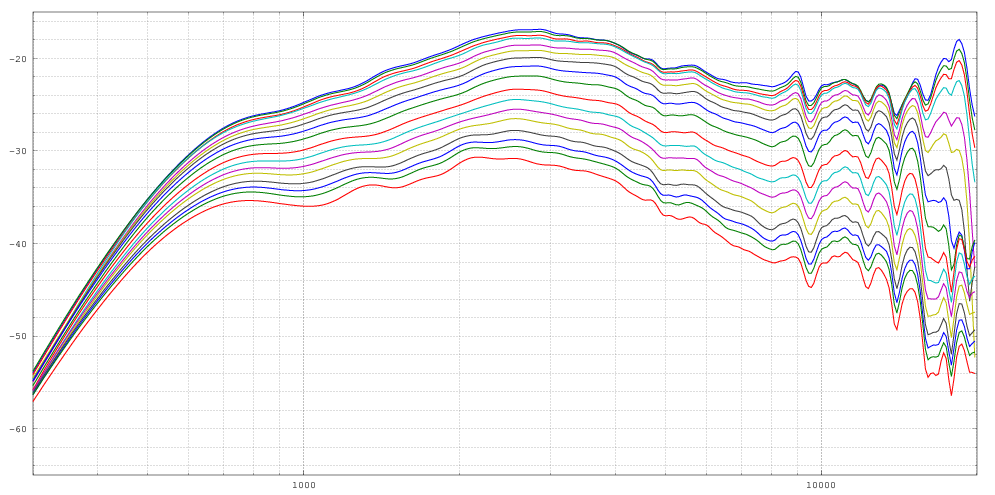

Looks great, very smooth response till almost 20kHz.
I think that the best bet is simply to make the throat angle large enough. The higher the exit angle then, the better. The worst thing that can happen is that it will require some slight additional EQ. After all, this is not meant to be easy, but at least available. People will never agree on something as a compression driver.
that is true, but you started this journey and all of us followed to get best possible WG for a given CD and to minimize use of EQs. And after all effort given (first of all yours, I am exhausted when see how many pages thread has ) I think that WG should be done with smallest amount of compromise.
Finally there is a lot of CDs with wide exit angles so you can pick what you like and make it for it, everybody else can use that CD or whatever he/she want.

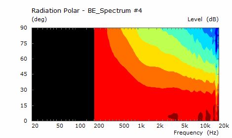

I attached list of CDs with exit angles. I did not do measurement, but I think they are correct. A least it is some guidance.
