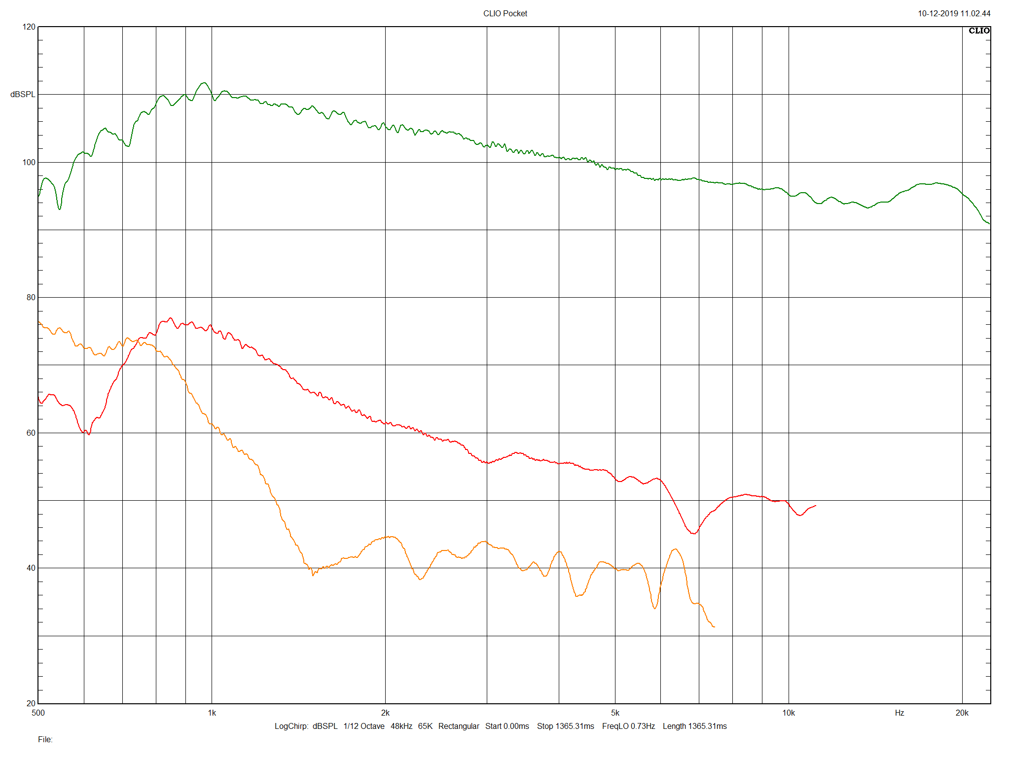

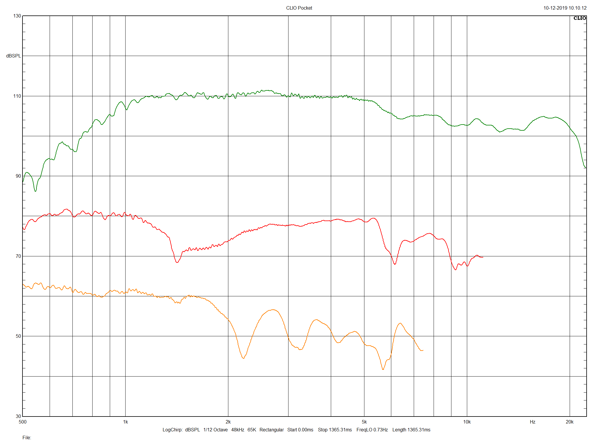

The SB26 is not suitable for waveguide use, but here are distortion plots for the SB19 and BMS4552. Only H2 and H3 are shown.
Here is the SB19:
attachment.php
And the BMS 4552:
attachment.php
Horn is the same as is measuring distance. The SB19 had slightly higher input drive voltage (5.5 Vs 3.7VRMS).

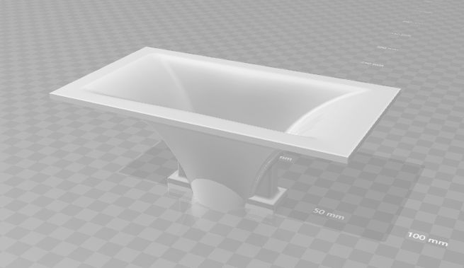

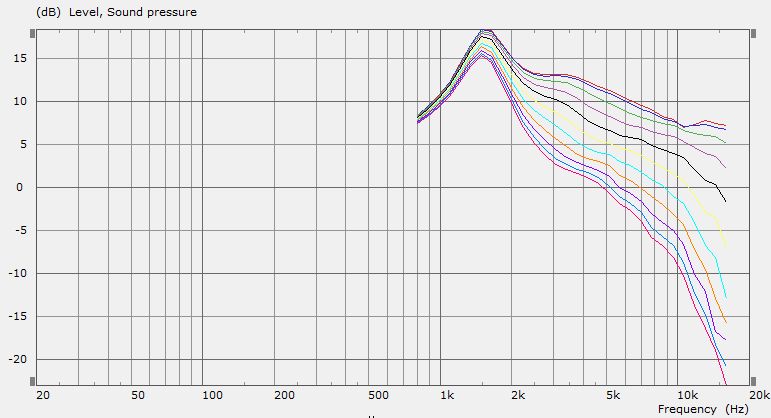

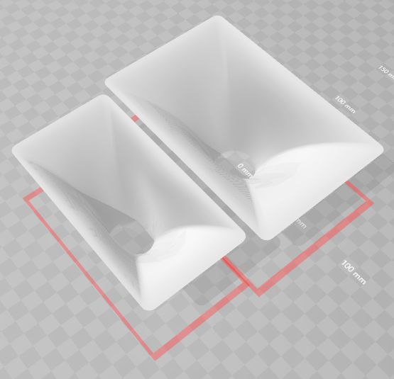

Today I designed my first waveguide/horn using this wonderful tool. It is a RCF N252 horn to replace the standard one, which was plain awful and had some nasty dips in the response. Thank you very much, Mabat, for sharing this great tool with us!
I know that this will not be the greatest waveguide on Earth, but I wanted to try out. I modified the "small.cfg" example, it was really easy.

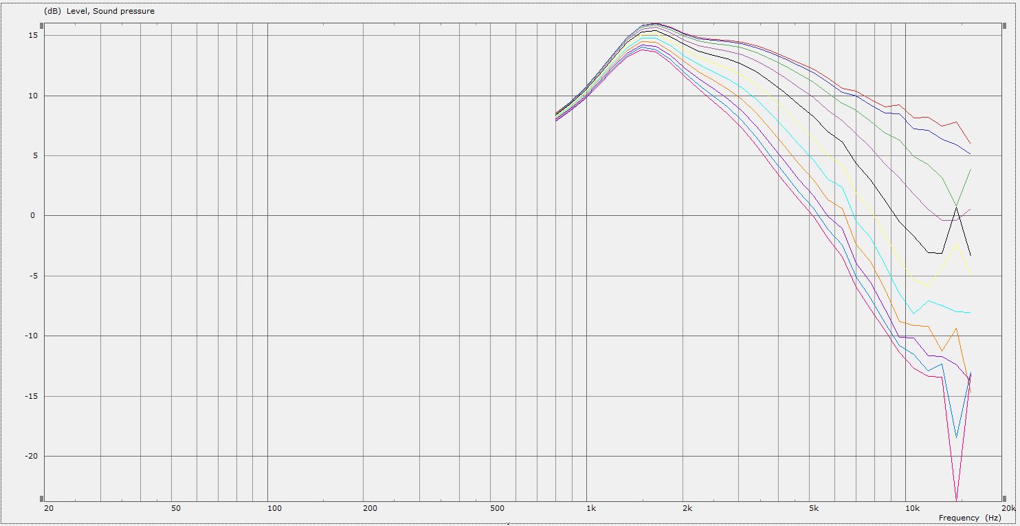

In this pic, here's the frequency response and the polar response of a Tymphany NE19VTS on an 18Sound XT1086. The XT1086 is WAY bigger than your waveguide - it's FIVE inches deep. It loads the tweeter all the way down to 675Hz. And look at that distortion measurement - it's impeccable.
What's happening here, is that even though your SB26 tweeter has more than double the displacement, the much larger waveguide loads the tweeter down way, WAY lower.
Also, let's do a quick segue into "how do horns work?" For the most part, horns raise the output of a driver by limiting the beamwidth. For instance, a tweeter on a 90 degree waveguide only needs 25% as much displacement, because the tweeter is radiating into a space that's 25% as much as if it was on a flat baffle. This is why the tiny 3/4" tweeter is such a giant killer on an XT1086 horn; it's radiating a small fraction of the space that it would be if it was on a flat baffle.
But this comes at a price: if you tinker with axidriver or hornresp, you'll find that it's really difficult to get a 25mm or 29mm tweeter to behave on a waveguide or a horn with a narrow angle. And the depth of the XT1086 is facilitated by a much narrower angle than your waveguide.
Naturally, all of this is subjective. Some will prefer the wide beamwidth and high displacement of the SB26. Some will prefer the narrower beamwidth and very low distortion of the NE19 on the XT1086. It's really just a matter of taste, but the bottom line is that 3/4" tweeters can perform shockingly well (IMHO) on conventional waveguides and horns.

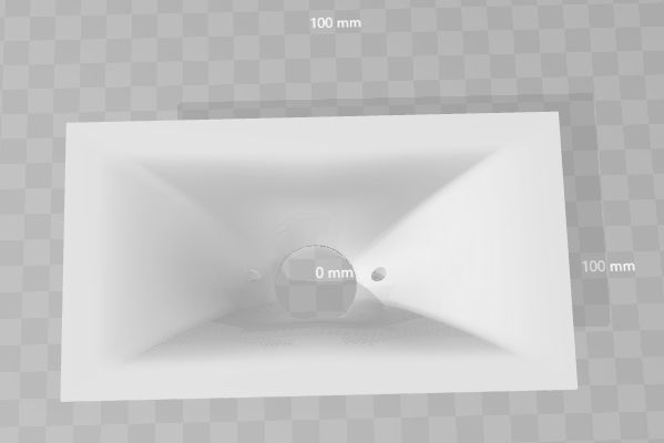

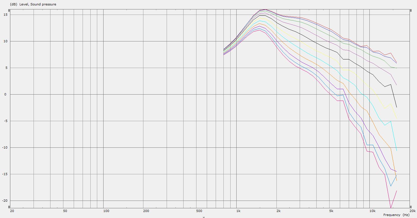

There is quite a difference, the ath4x waveguide is larger. For some reason, from the same CFG file, nothing is displayed in VACS after calculation. Edit: It is the problem with observation.txt file.

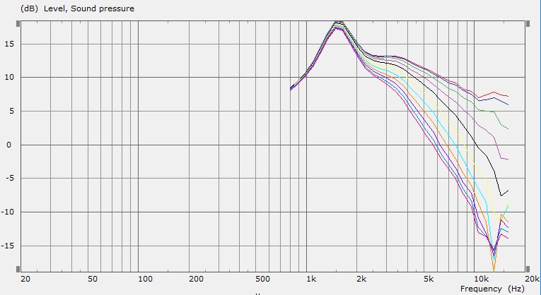

Do you mean the bold text? That is already there. I used observation.txt from V4 with results from V4x and it worked fine. Now it looks really nice🙂
