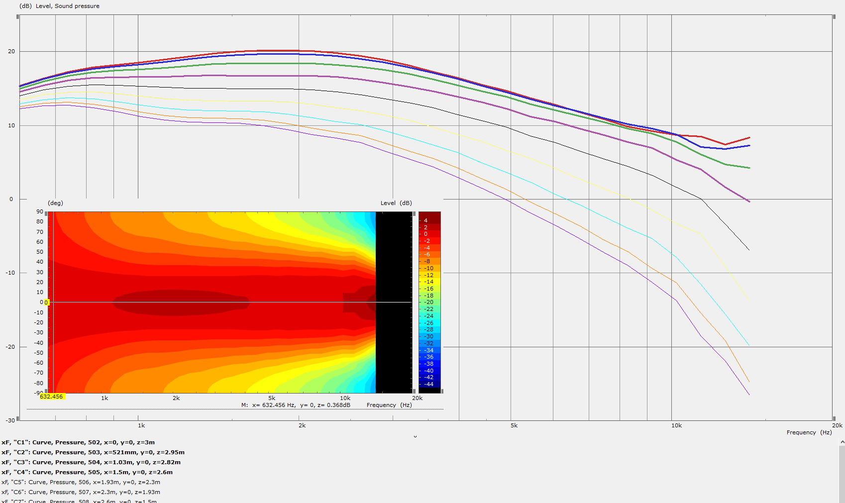

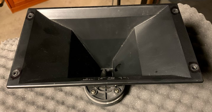

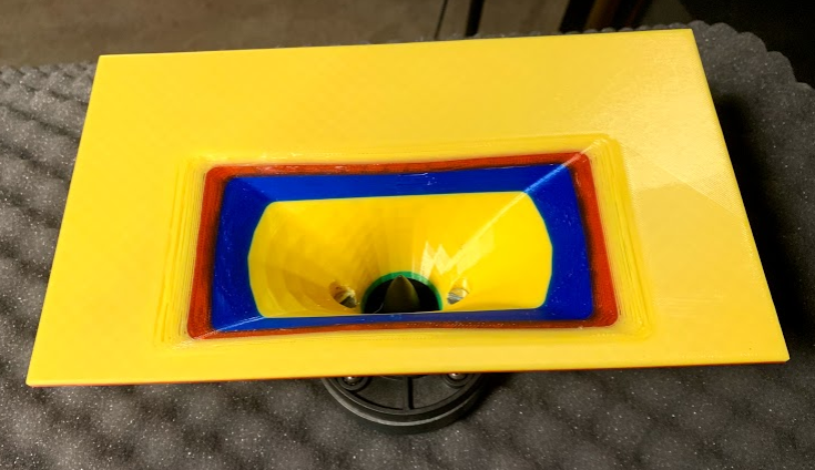

So the first horn is printed. It is meant as a replacement for the old horn in a cheap 15" + 1" box with around 3 kHz crossover. A wrong concept from the beginning, but I see definitely some improvement. The blue line is the old black horn, the green lines are the new horn and new horn some 25 deg off axis. All measured without a baffle. I definitely see improvement🙂
For the final print, the surface should be made much smoother by increasing the following items:
Mesh.AngularSegments
Mesh.DepthSegments
Mesh.CornerSegments
It is a pain to see these coarse walls...

Thanks, I will definitely do that. This was just a proof of concept draft print from leftover filament.
Yes, unfortunately, that is the way it is. In the final version, I plan to use smaller screws and some sort of semi-hard putty to make it removable if needed.
