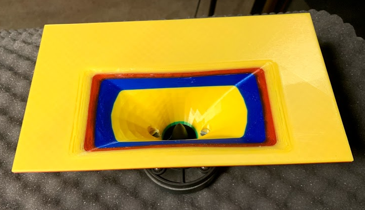

The colorful horn worked pretty well, but I decided to sell the FBT boxes in original shape, they needed just a small crossover fix in one box. I am setting up my own 3D printer to print larger horns for standard drivers. The RCF was not worth further experiments.
