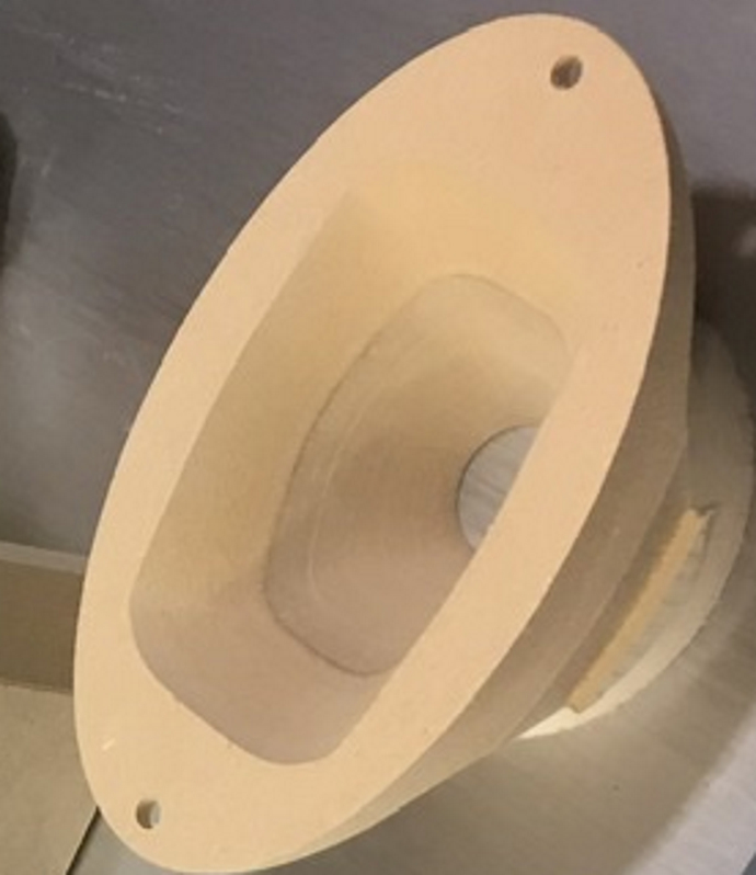

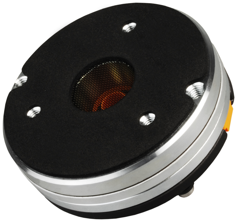

Modelled well - testing tomorrow! Thanks mabat for an amazing tool! Target : HF146 & 12P80ND
Awesome!
Would you mind showing the simulation results? Why two-part?
Sure. Not got around to physical testing yet.
Two parts? Just the thickness/stock issue. Baffle = 50mm. Throat addon positioned with the two 8mm pin holes you can see. Fits together perfectly and will probably glue in place later.
The addon = 73mm deep. Aiming for acoustic alignment of woofer and cd after a few design interations.
We’ll see. 🙂
I’ve put dowel pin holes on the back of the baffle so I can throw on some resin and recut throat shape if required.
It looks like a 3-part horn to me: baffle part + 2-part addon, or does it only seem that way?
HF146 + 12P80ND, nice driver combo.

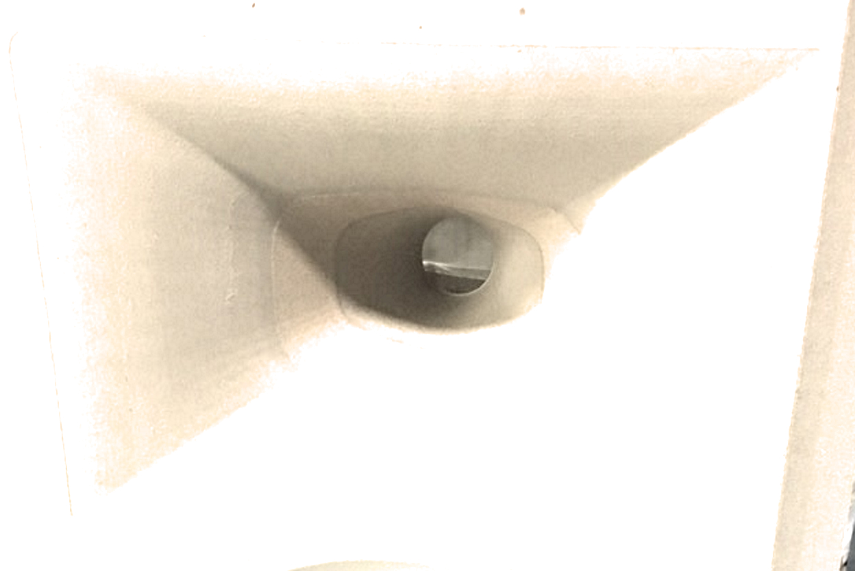

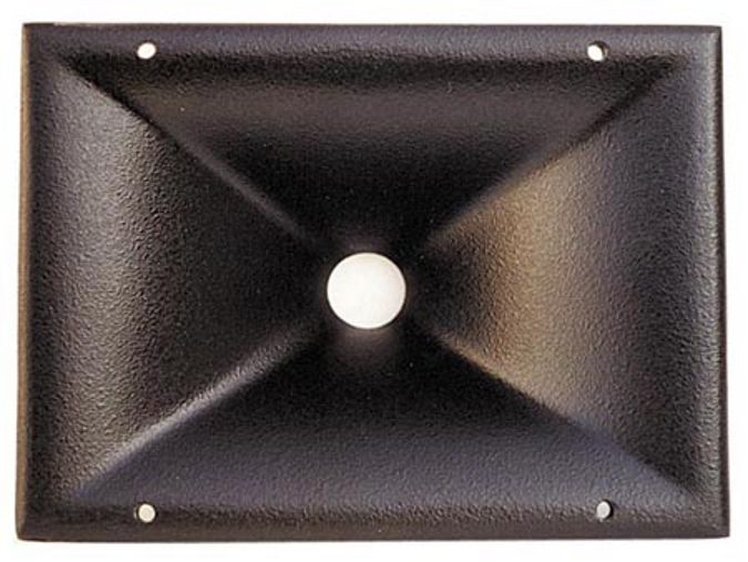

However, after some fiddling with illumination and contrast, the typical OS-contour becomes visible.
BTW, did you sand the throat?
From the photos it looks like if the OS contour has been smoothed.
No sanding. Just poor quality fluffy MDF. I used a 6mm ballnose over the surface.

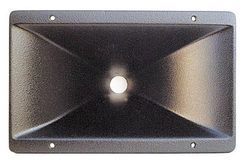

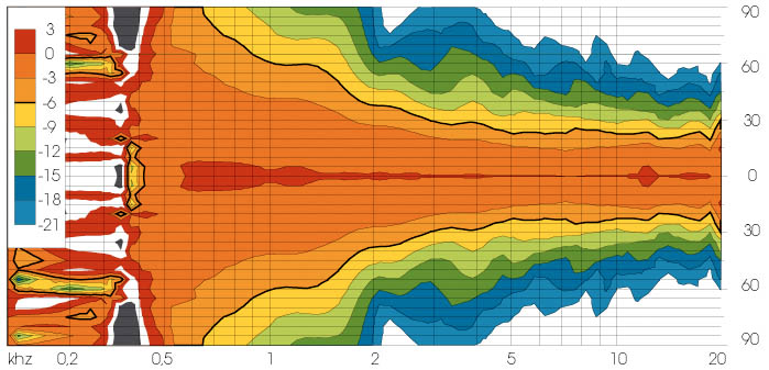

With a smooth throat to rectangular transistion (without OS contour), one could obtain decent polars. Still, Marcel's ATH is obviously better.
These are 15 year old examples from a respected German horn manufacturer.
(BTW, he didn't use the textured material for cosmetic reasons 😉)

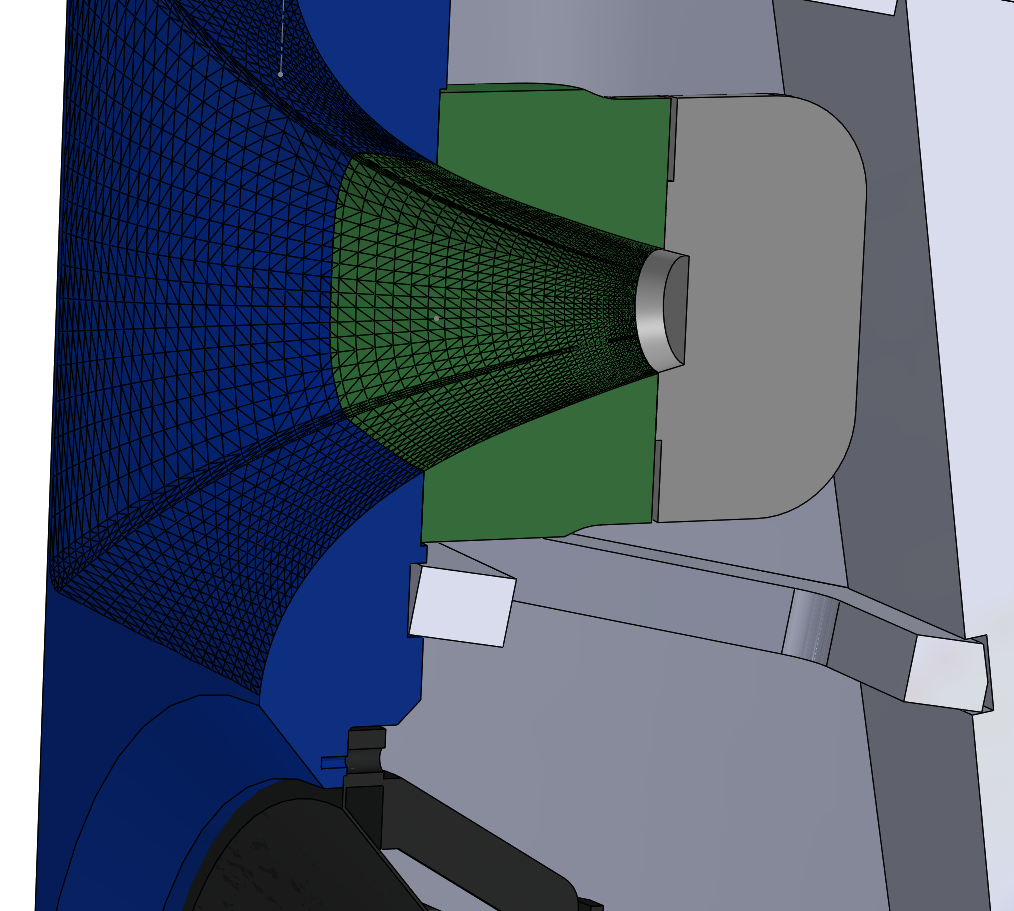

You did take the HF146's 29° exit angle into account, I presume?

It is not so often that someone uses an 1.4" exit driver with an OS waveguide.

Indeed, if you look at the above section you can see the HF146(grey) mating with the throat (green).

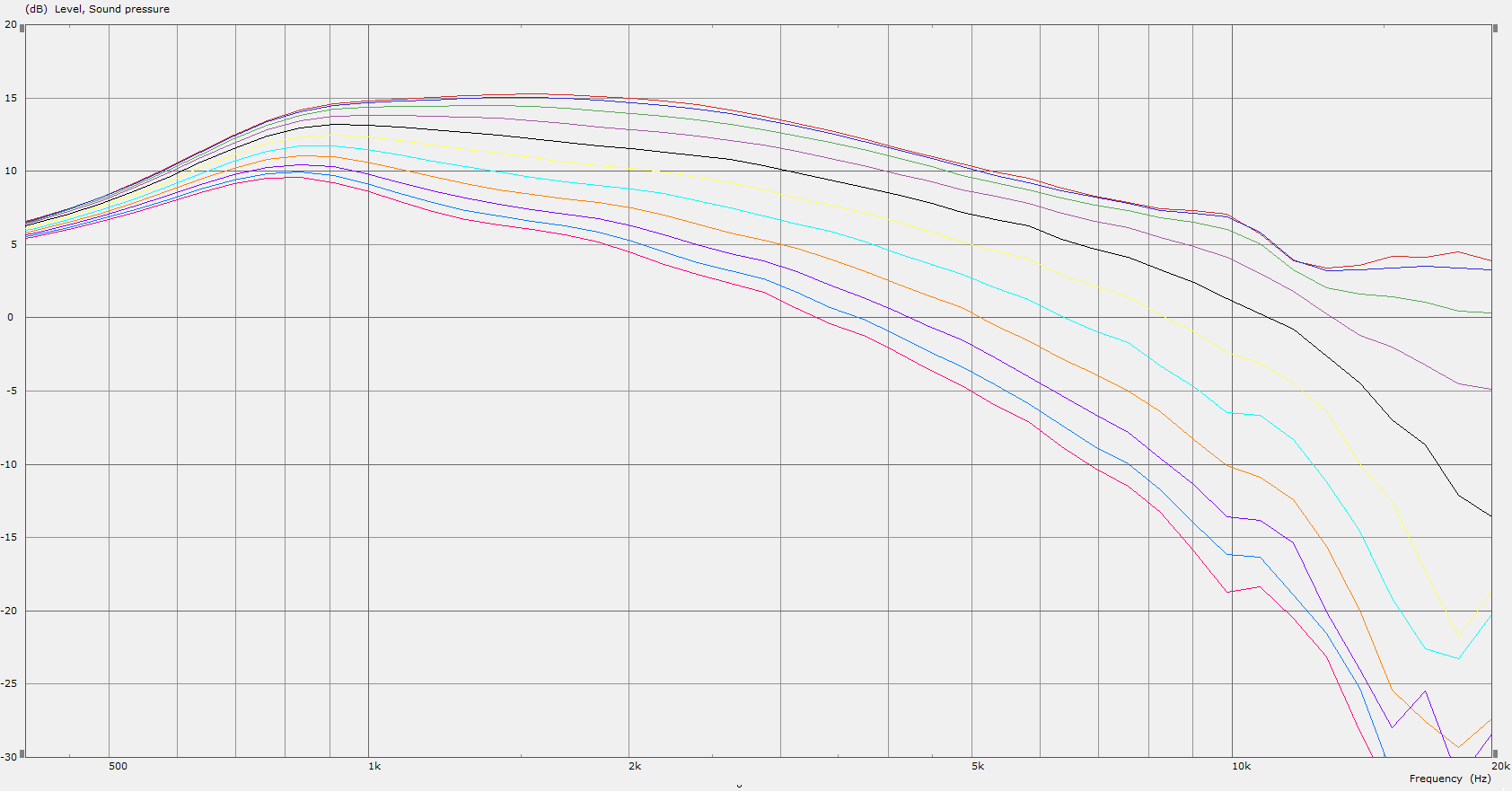

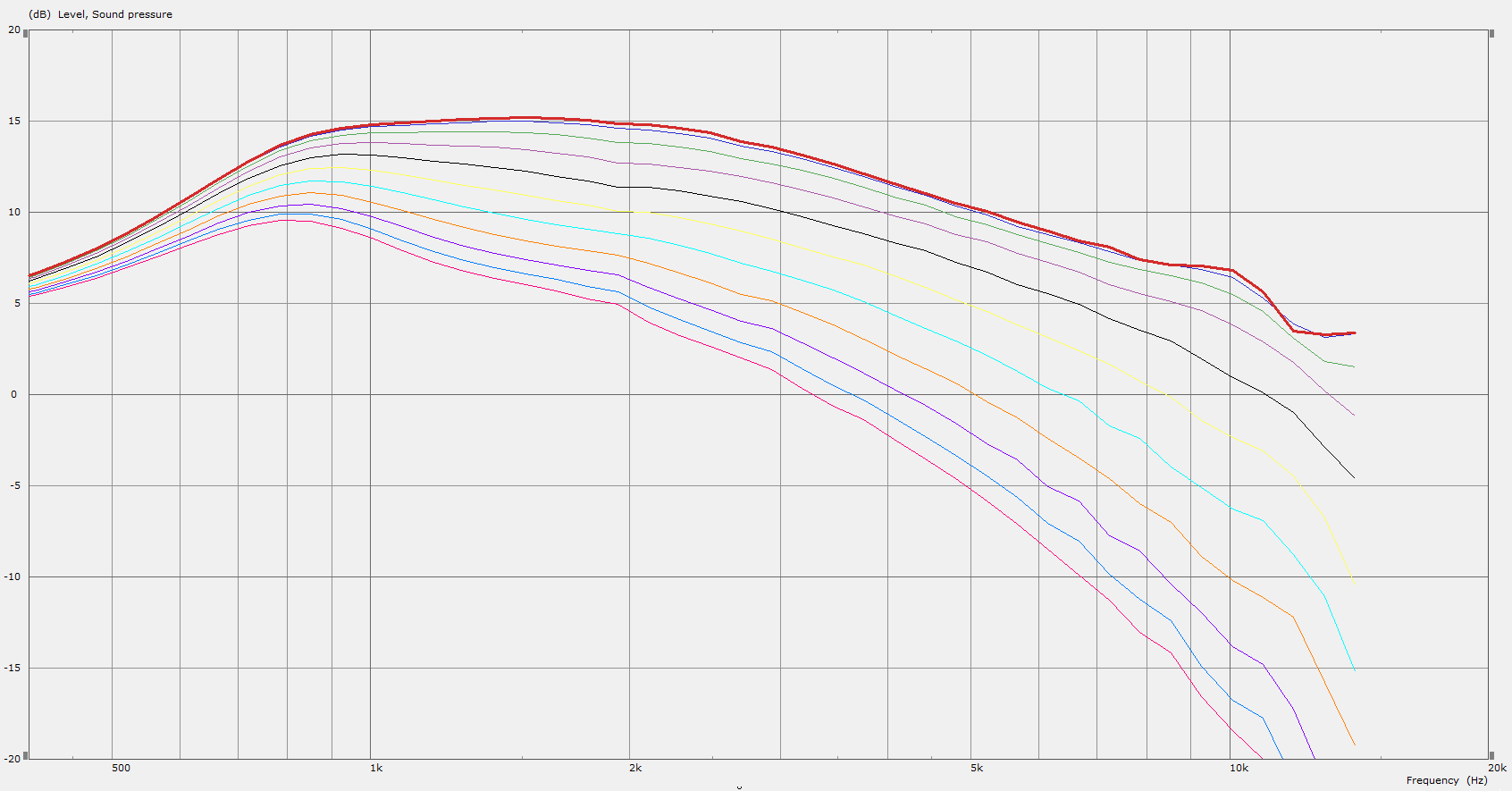

Preparing sim charts now. I can always switch over to a HF10AK if need arises.

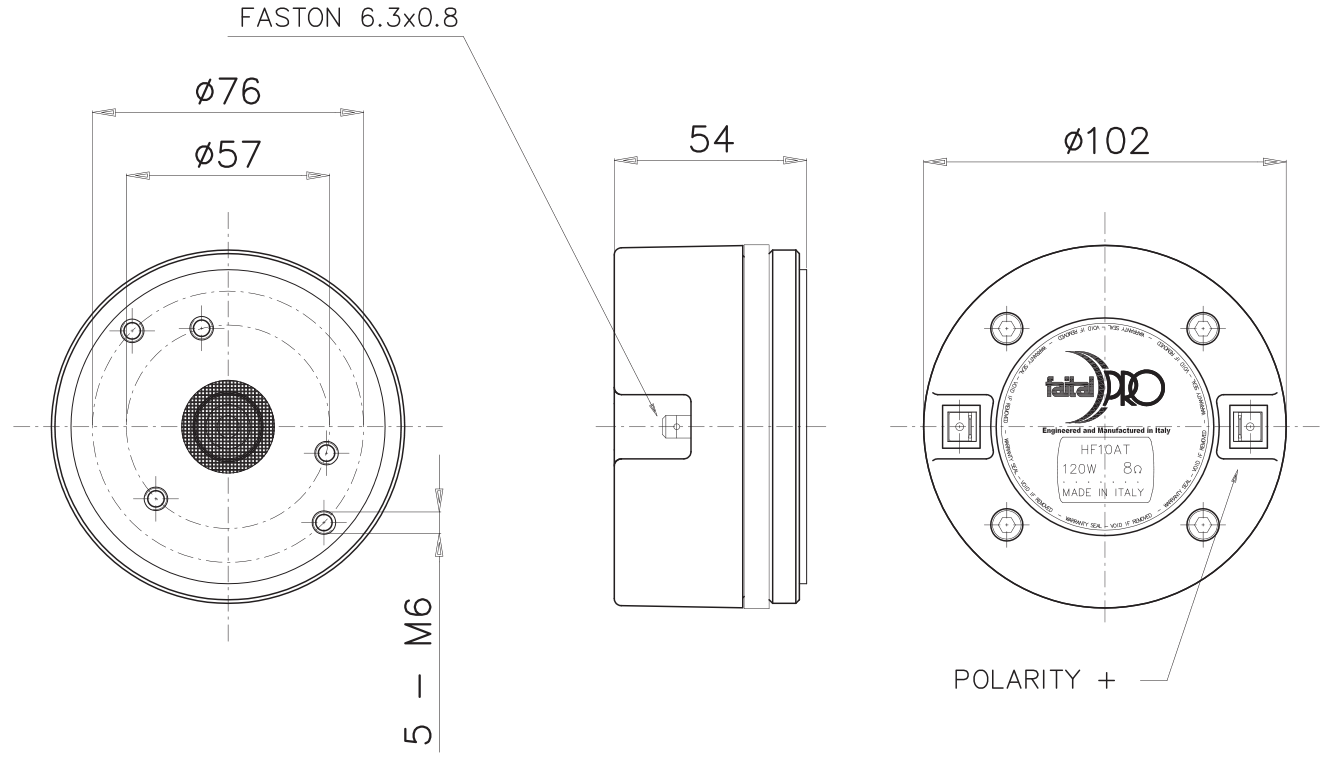

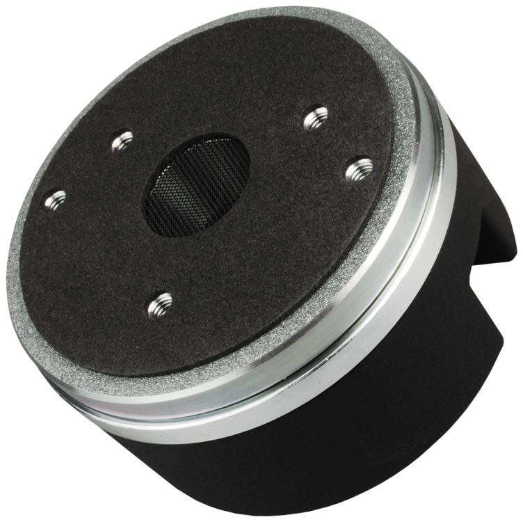

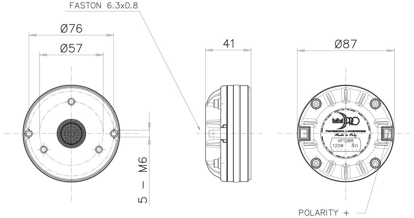

The HF10AK is a very nice 1" driver, a true substitute for the TAD TD-2001 (at a fraction of the price), but it's probably better suited to classic Salmon-type of horns. It's a first generation 1" FaitalPro driver with a deeper conical section, designed to work with Faital's own elliptical Tractrix horns.
That's not to say it won't work behind a OSWG, but in general "pancake style" drivers - like the HF108R - tend to perform better with modern, shallow waveguides.

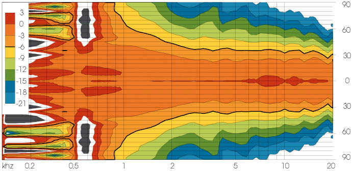

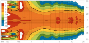

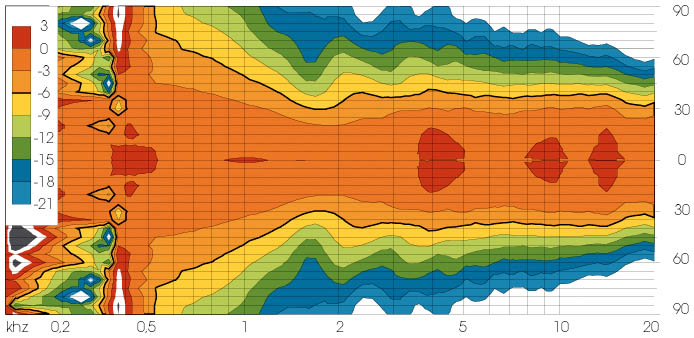

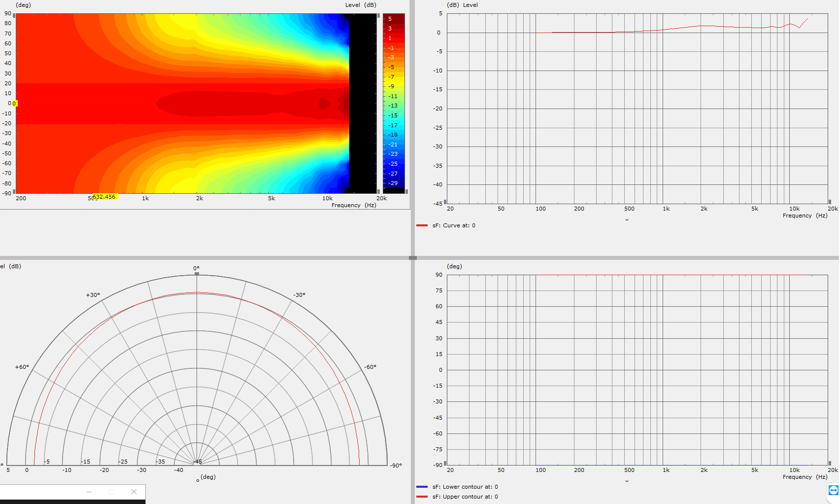

The polar looks pretty much like a textbook example.
That’s good, right? 86x53 design. Vertical and diagonal very similar. Took quite a few iterations to get it as smooth as that over 61 simulated bands no smoothing.

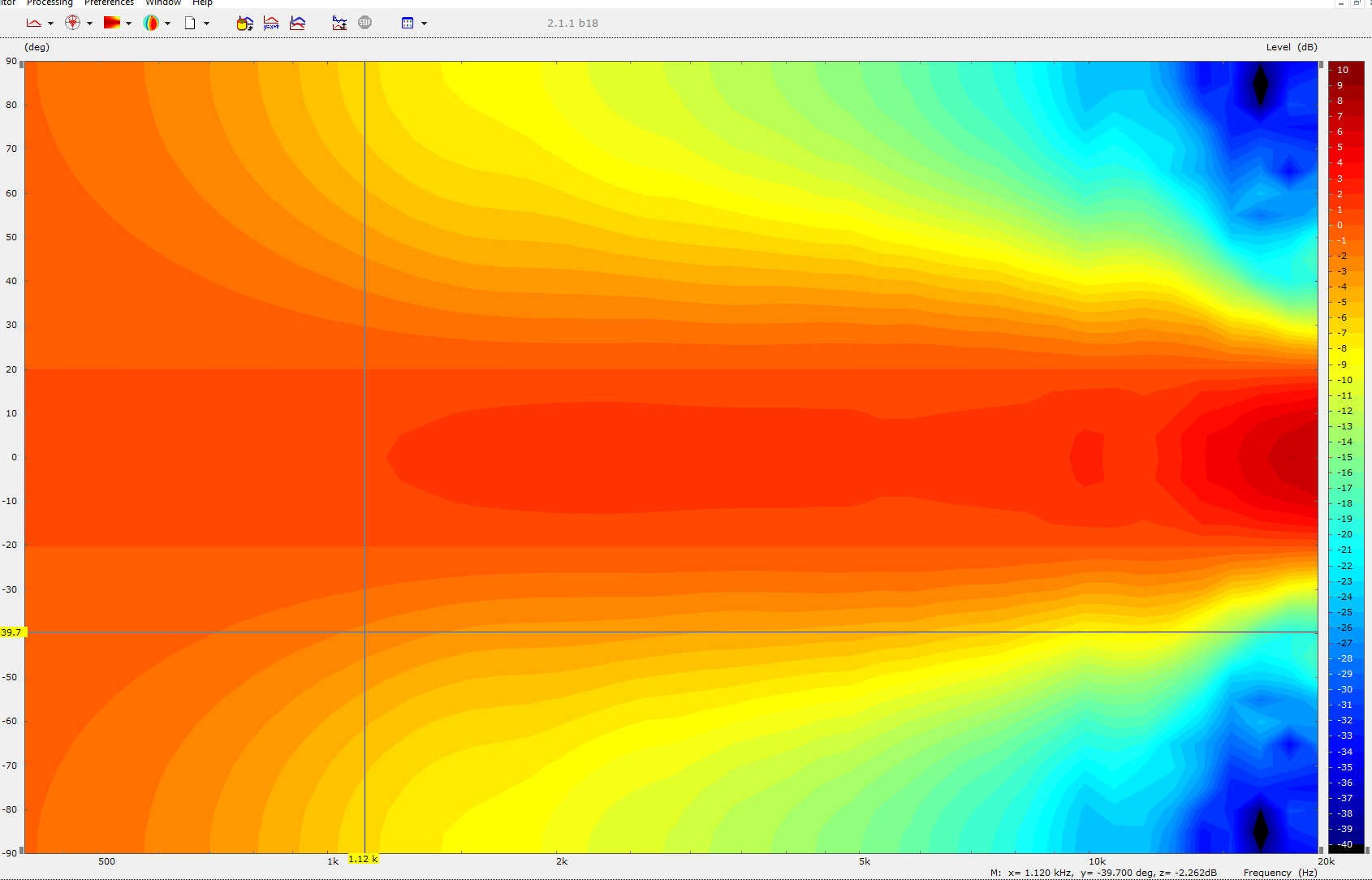

Extended the range out to 20K, no smoothing. Bit bumpy 12K upwards on axis but appears to smooth a little 20deg to 40deg off axis.
Actually, looking at my config, final design ended up as 87 x 53 x 120mm.
LineSource - "Measurements for the Beyma 12P80Nd_v2 from the AVSforum show -6db SPL around +/- 40 degree polar response ... "
