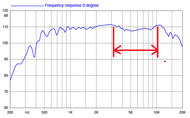

That was measured in some particular horn. Your case may be very different. It's not trivial to tell what is caused by the driver itself, i.e. what will always be there (more or less). With exceptions, that is usualy break-up related and not quite in this frequency range.
BTW, such equalization is easily done in crossover design (provided it is something that can be equalized in the first place). I can't imagine how would you try to achieve that by a horn shape optimization.

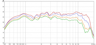

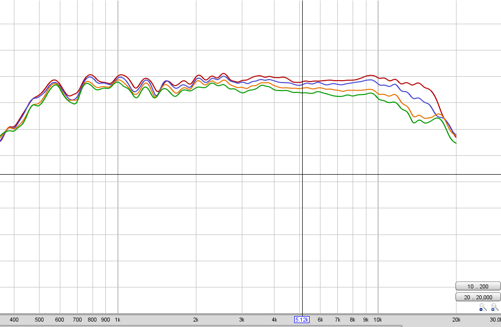

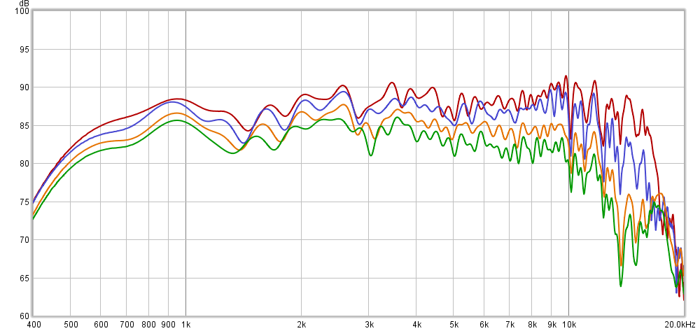

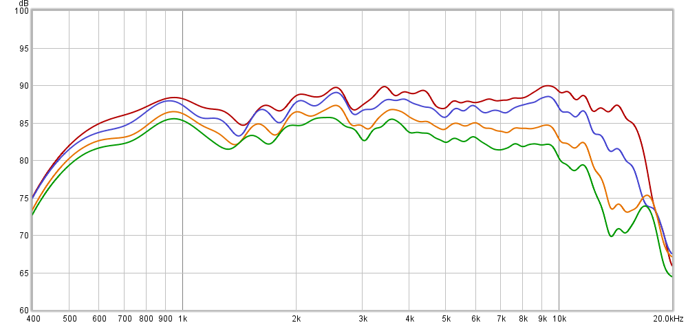

1/12th smoothing. On axis (red), and then approx every 15 deg. Will be more scientific about it tomorrow with better room treatment. I'm also making a foam covered MDF rig for the UMIK stand so I can set more precisely at 7.5 deg intervals.

Don't think that was gated either. Will check REW settings in the morning and run again with the new mic rig.

What charts and at what smoothing/gating settings would you like to see?

Room treatment is irrelevant once measured gated. For that you need to see impulse response and limit that to the time before the first reflection arrives. Usually then there is no need to smooth it further but 1/12 (or more) should make no harm either for the purpose of crossover design. I have no experience with REW. For all frequency response measurement I stil use HOLMImpulse, which is extremely intuitive in this regard.

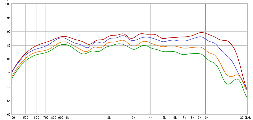

Thanks. I'll look into that. Added gating. 1/6 , 1/12 , 1/48 attached.
I've seen a few horns droop at 1K to 2K with the HF146. What part of the cd/horn/baffle geometry could this be related to? If any.

This is strange, doesn't look right to me. I doubt it represents the anechoic behaviour. I would expect it to be pretty smooth at least up to 3 kHz (and flat between 1 - 3 kHz), I see no reason for the responses shown.
- If this was a correct measurement, something would be wrong anyway.
Sure, you need plenty of free space to get sufficiently long reflection-free time, at least 4 to 5 ms in this case. Not only between the source and the mic, but also around both (it makes a reflection-free ellipsoid with the source and the mic as focal points).
Doesn't look much different from other measurements of the 1.4 Faital drivers with Ketone Polymer dia.
Nearly all of these show some variation in the response, often with a dip >2k.

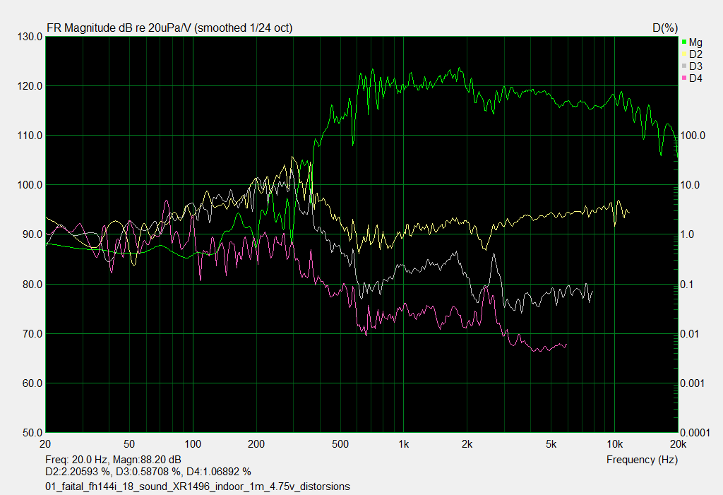

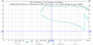

3 plots of a HF144 (16 Ohm) + 18Sound XR1496. The first is a quick and dirty (raw) response and the second and third with 6 PEQs applied.
01_faital_fh144_18_sound_XR1496_indoor_1m_4.75v_distorsions.png29 KB · Views: 408
00_faital-hf144-16ohms_18sounds-xr1496_1m_indoor_4v_4.2ms-gating_6-eq_no-filter_freq-response.png95.6 KB · Views: 410
01_faital-hf144-16ohms_18sounds-xr1496_1m_indoor_4v_4.2ms-gating_6-eq_no-filter_distorsions.png134 KB · Views: 172
The XT1464 wil most likely yield a slightly flatter response due to the Tractrix contour and subsequently better driver-horn interface.
We need reliable anechoic polar data masured at sufficient distance. The bumps in 1 - 3 kHz range are hardly caused by the driver which is too small to cause such phenomenon. There is obviously some diffracted or reflected sound coming along. Let's wait for another attempt for measurement. Maybe a photo of the measurement setup would help here. For all horns I ever measured this was the least problematic frequency range which really should go smoothly without a glitch (it may still need an equalization but that is not the issue - that's not even possible here).
