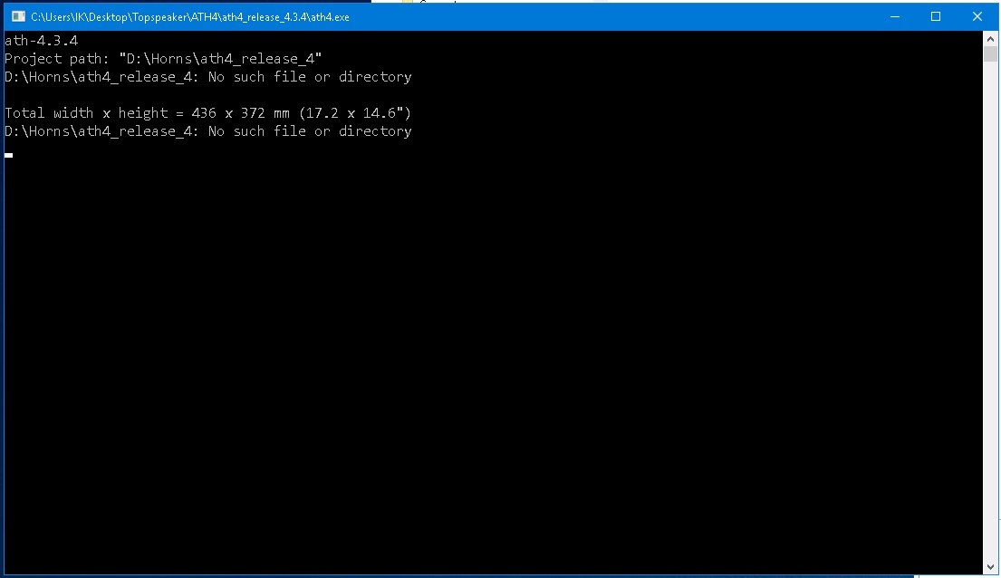

When running the ATH4 tool, I get the error "the application was unable to start correctly (0xc000007b)" I think its some dependency that could be missing. I'm running on windows 10-64bit. should it work on this version of windows?
Thanks MBAT, turns out if you are running 64bit windows you need the 64 bit gmsh dll

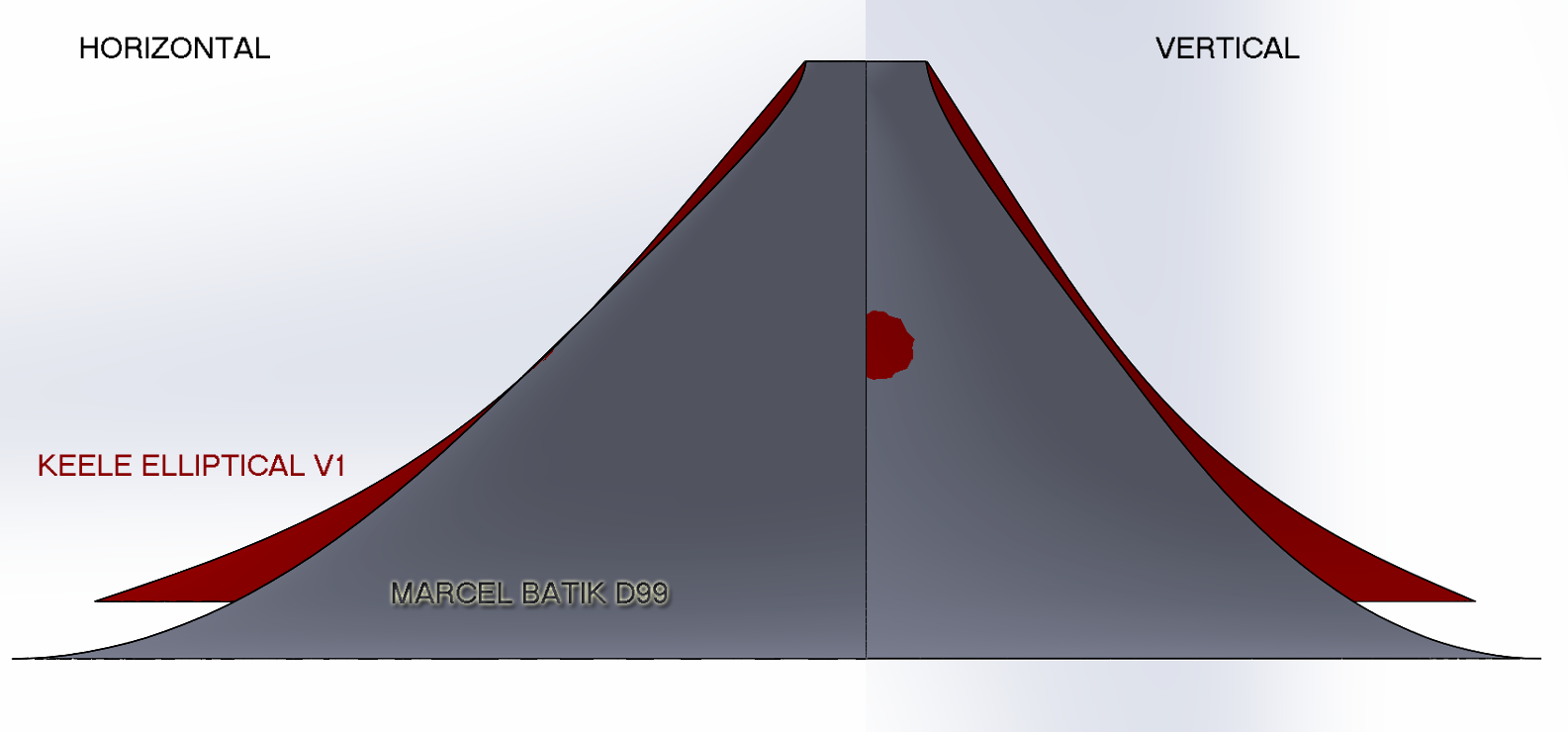

You see, after slight altering of some of the parameters, the two would almost match. The "only" thing different would be the throat.Dr. Keele was kind enough provide his elliptical waveguide 90x80. ...

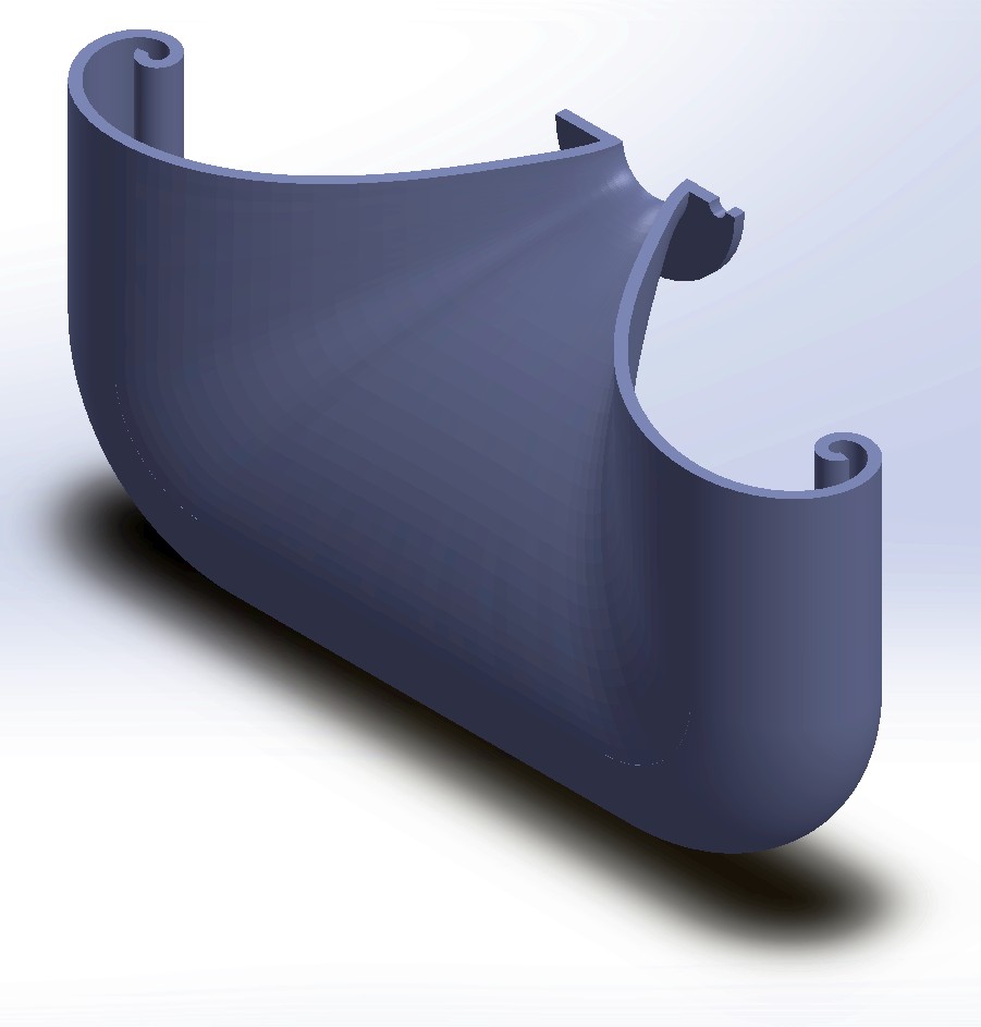

- I ran into some difficulties following Patrick Bateman's advice on using Meshmixer to translate the surface generated by ATH4 into a solid.
- Worked past that, then ran into issues with my 3D printer jamming now that it's been upgraded to use a fat nozzle. More debug and testing to do on that (slow - can take many hours into a print before it happens).
- Also running into uncertainties about concrete design parameters - how thick to make it, how best to chop up a 15 inch horn for a Geddes-like design into multiple pieces to enable printing.
I wonder if these are similar to issues other people are running into. Not complaining, this is cool stuff and further than I would have gotten into it. Just sharing that there are still challenges.
