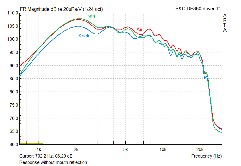

Now it would be interesting to see the horns measured in an (rounded) enclosure for how much of it is caused by the horn itself and how much by the improper termination. For example the slight widening between 2 - 5 kHz should not be there according to the infinite baffle simulation so I wonder if it is related to a particular termination.

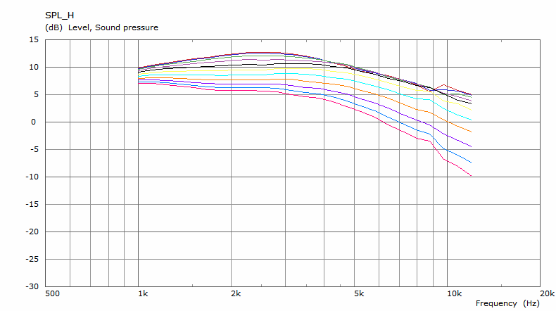

- From these plots it seems that the time window was quite short, wasn't it. I guess that data below ~3 kHz are not very reliable.

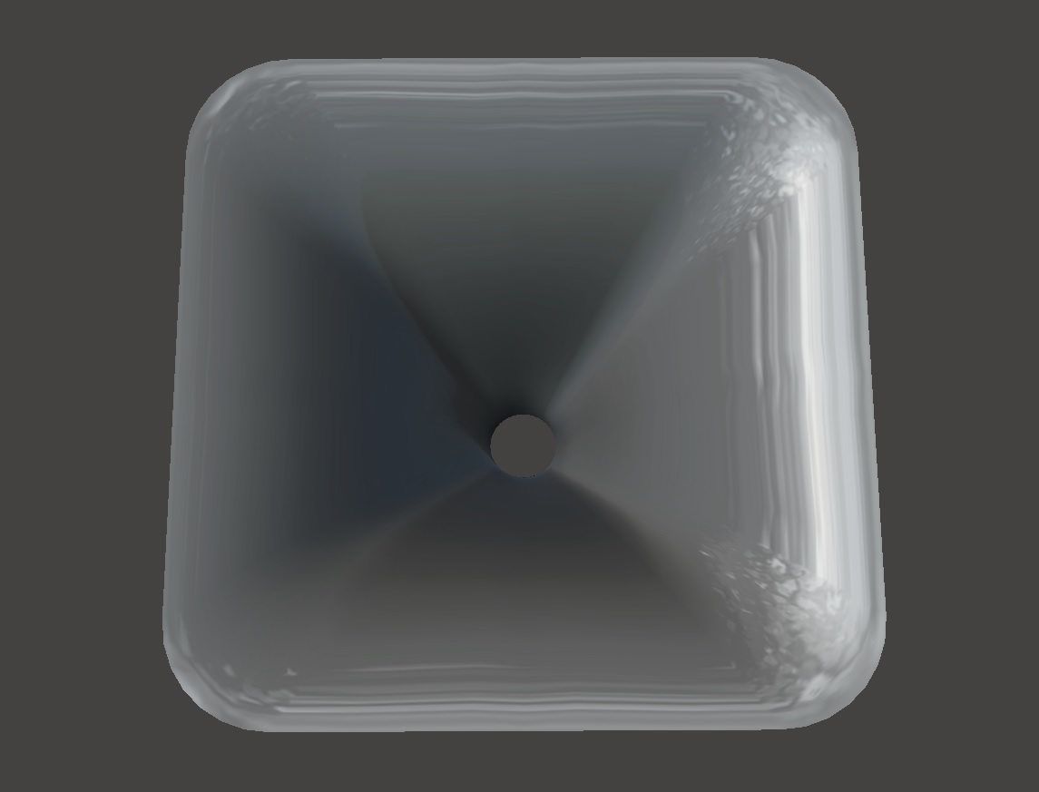

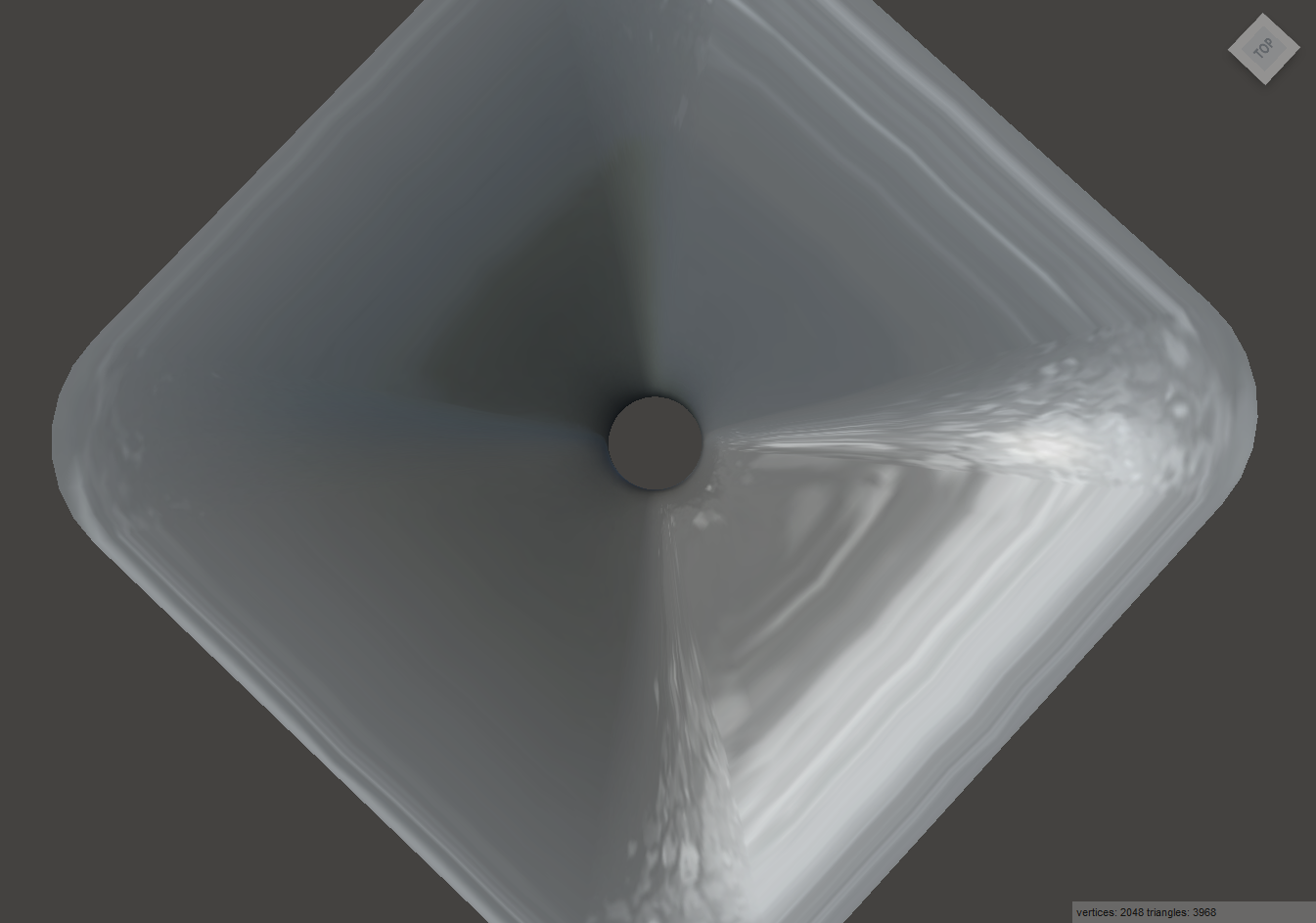

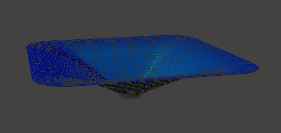

It was named d99: width 357mm, height 282mm, depth 125mm, coverage 90x80.
Can print rounded baffle. R= 5cm?
I've used 2ms gate for polars and 1.5ms for raw plots.
Qestion remains can we minimize second pulse in slot waveguide by using rounded slot end. Will make sketch.

Yeah, that's quite short. You can see that the truncation of the IR has still an obvious impact on FR below about 3 kHz, meaning it's not reliable there.I've used 2ms gate for polars and 1.5ms for raw plots.
That A9 seems very promising!Here you are. I requested elliptical design from Dr. Keele for direct comparison. Do you remember that black elliptical data?

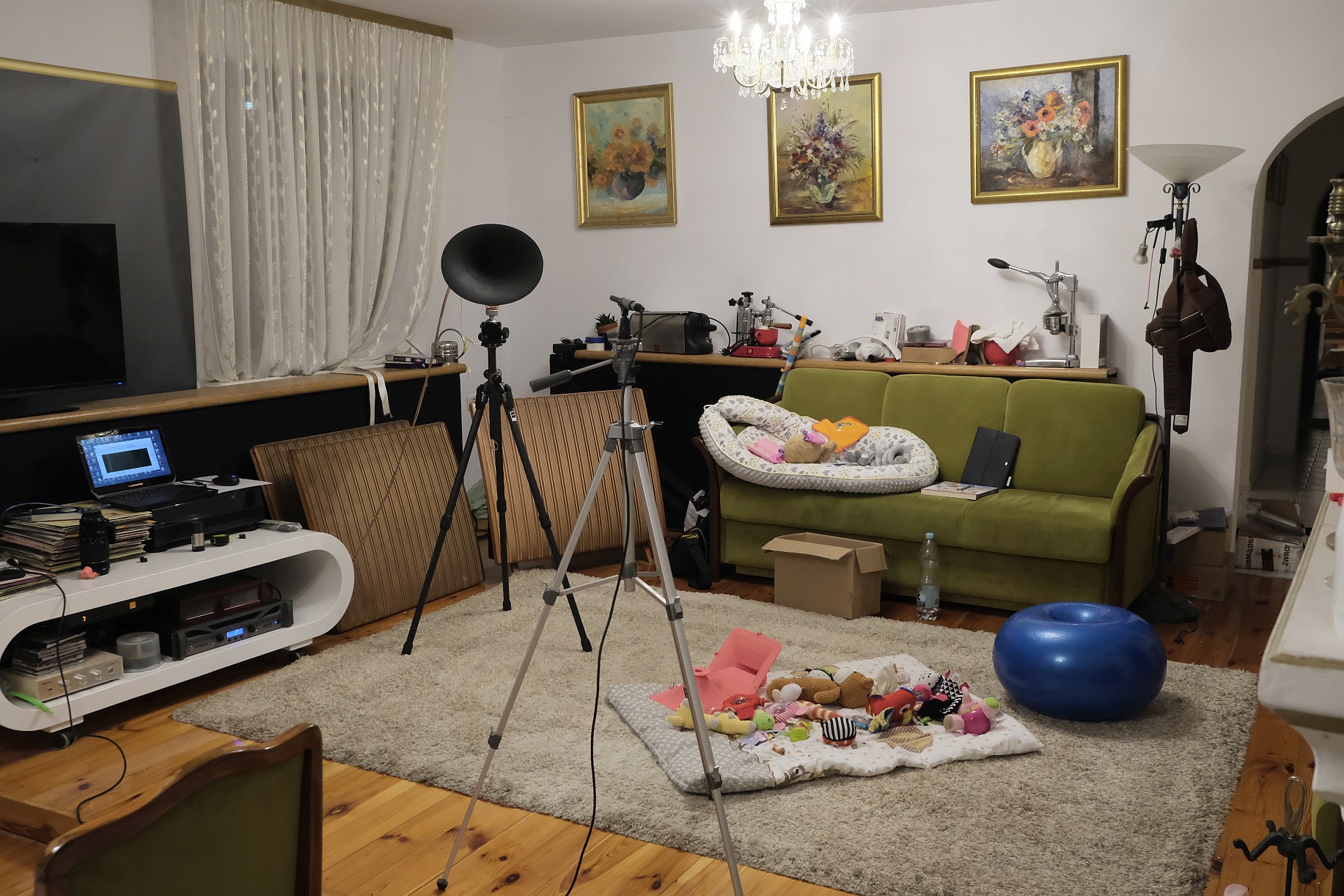

How far do you have to boundaries? 4 ms gate should be easy to achieve in almost any room.

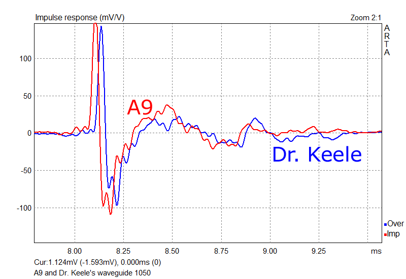

Could you also show (or upload) the IRs for the two horns, say the ones for 10 deg?

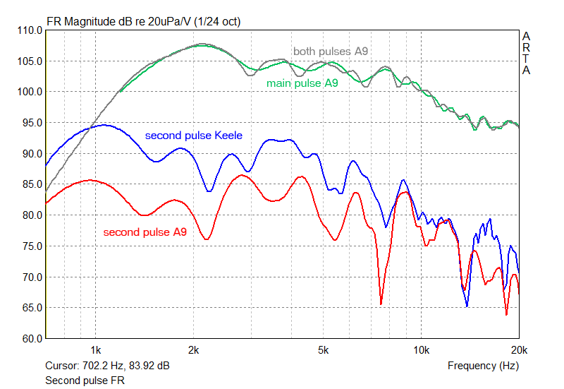

Below impulses and spectra. Second pulse in Dr. Keele's waveguide makes response with 6dB nulls, in A9 it is less pronounced.
So it's the mouth reflection and that is mainly caused by the abrupt termination in both cases. The reason why it is less pronounced on A9 might be the narrower beamwidth (i.e less energy reaching the edge).
- You would need to add some roll-back (or an enclosure) to get rid of this.

- If you want, you can try a shallow variant of A9 (120 x 120 deg, 50 mm deep). See what you get.

Almost, with small baby 🙂

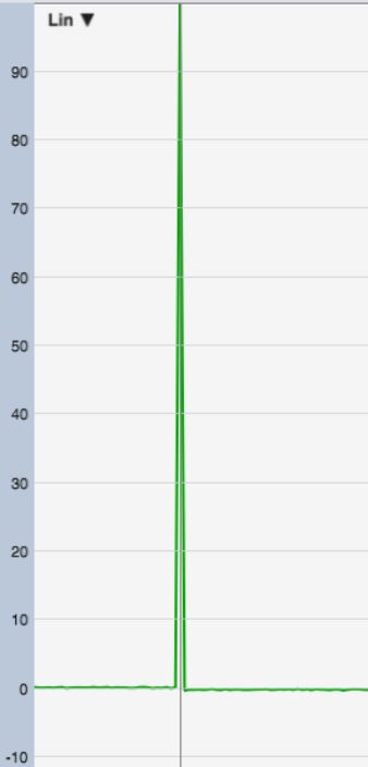

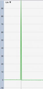

Impulse that goes up/down middle axis each measurement.
Aah, of course..duh 😱
I've never seen that float with the babyface pro, but i don't use Arta.
Here's the analog loopback impulse I get ..looks perfect to me..
