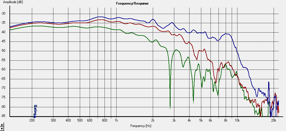

To show you what I mean - I found my older measurements of B2031 woofer.
Does anyone know about a now available driver of similar performance? It seems that a woofer of this size (8 - 9") is hard to find in present-day production. At least this is my impression. I found that it is easier to find a 15" behaving well to 1 kHz than an 8" to 2 kHz.

Satori WO24 would be my choice.

Behringer B2031 woofer
SB Acoustics 8", for $27 : SB Acoustics SB20PFC30-4 8" Paper Cone Woofer

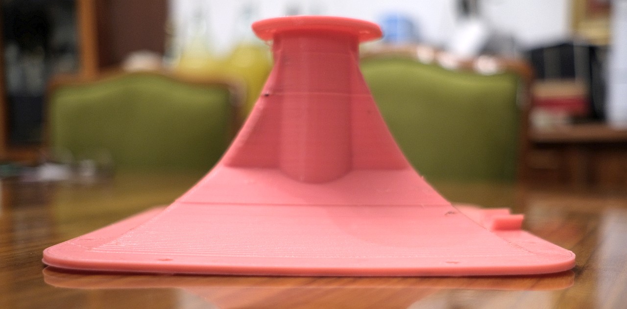

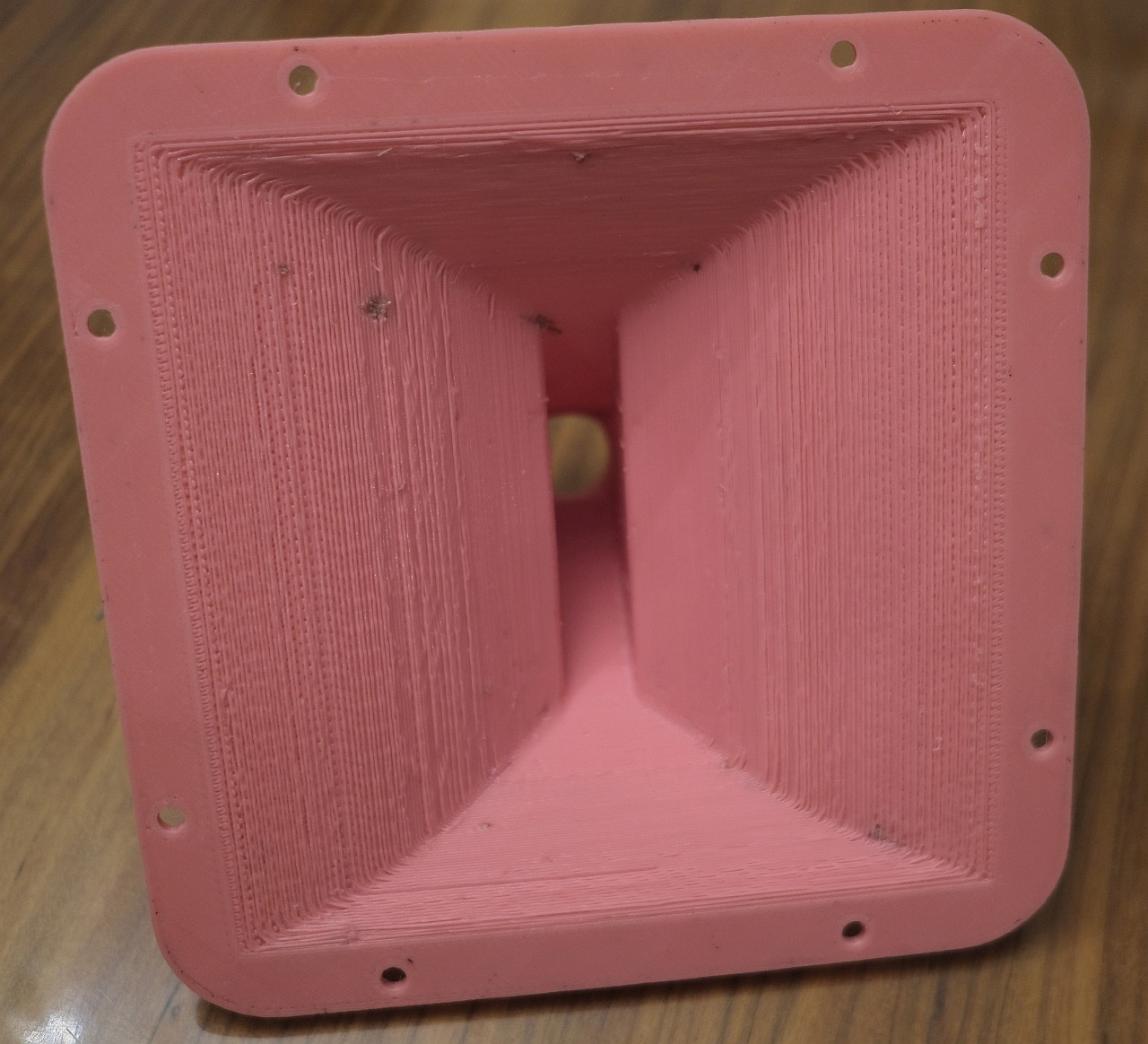

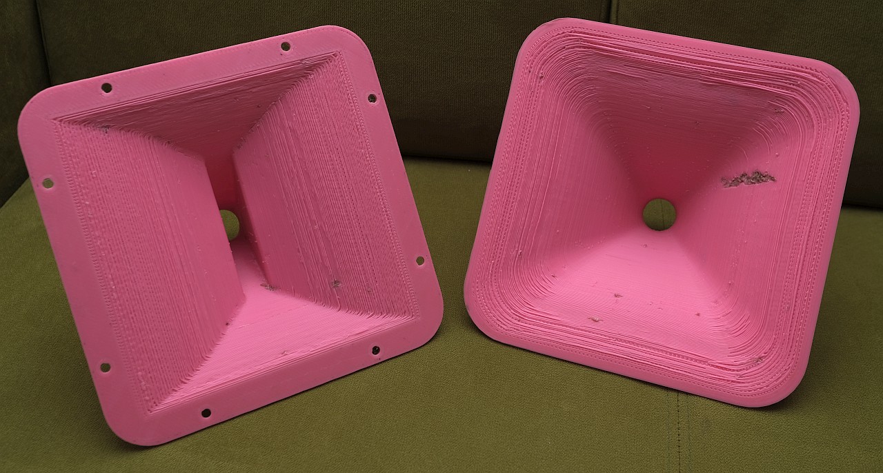

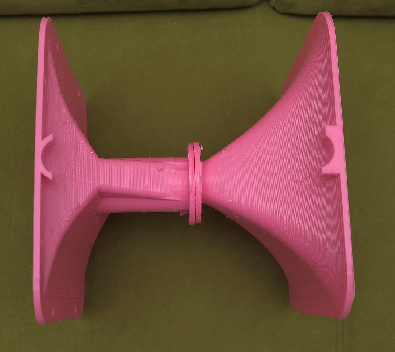

First printed with 0.8mm nozzle, 7 hours. Similar product Beyma TD-194 but 3cm shorter.
Nice. Do you sand only, or sand and fill to smooth it out.
What are you using for the 3D printer?
No time to do sanding/filling/finishing, for customers I outsource it to sprayer.
Printer is 7h7.pl Reprinter 600, reprap modified: Smoothieware, Volcano type hotend, Bowden extruder mounted close to hotend, PLA 3mm, glass bed 60 deg. Still getting substantial wrapping. Slicer is Simplify3D standard settings, brim no raft.

Try some blue painters tape on the heated glass bed. Adjust the height for the tape. The UV components in this tape will make it stick real well. That should be able to prevent warping for PLA.No time to do sanding/filling/finishing, for customers I outsource it to sprayer.
Better than 60deg glass bed and Dimafix?
With cold bed (17deg) I'm getting substantial deformation.

Keep the bed heated with the tape on it. We don't print without tape anymore. Just try it.Better than 60deg glass bed and Dimafix?
I don't know why people writes PLA can be printed on cold bed. This could save energy but is useless. Buildtak or similar is expensive. We will see on 60cm large part 😉
