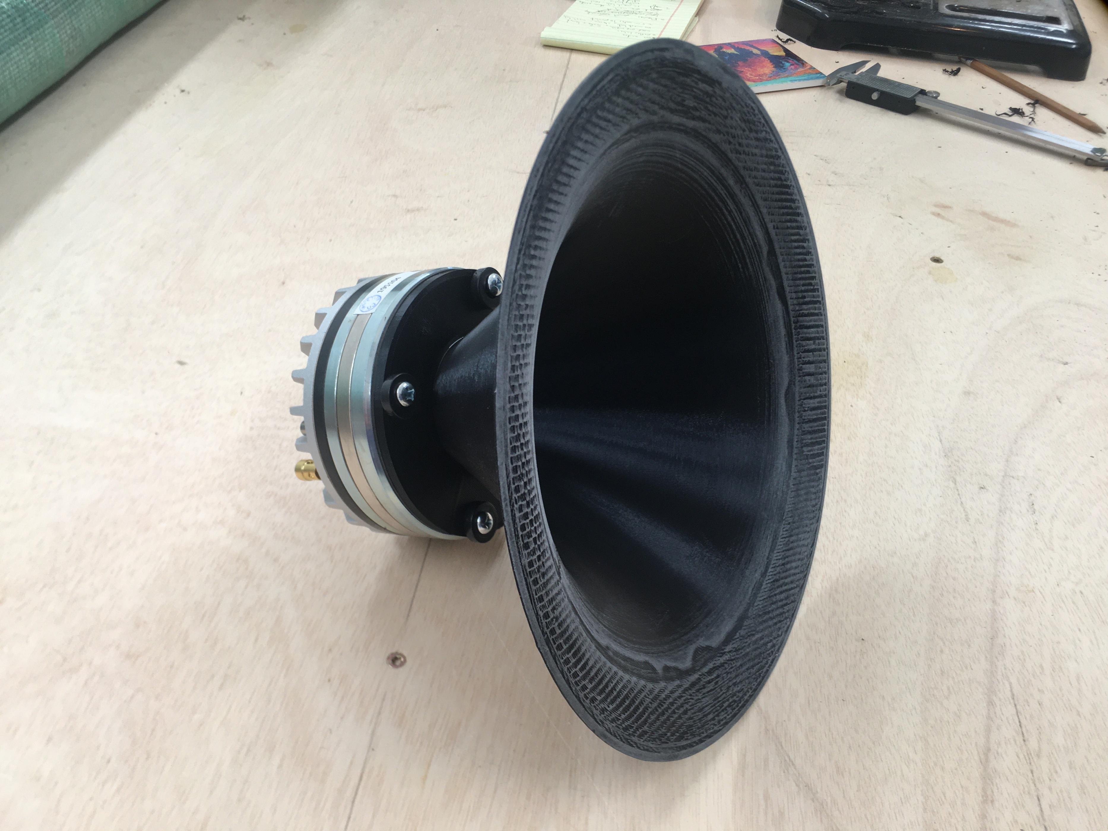

Below is my mockup of a 9.6" waveguide on my radian 760neo, fresh off the printer after I knocked down the support a little.

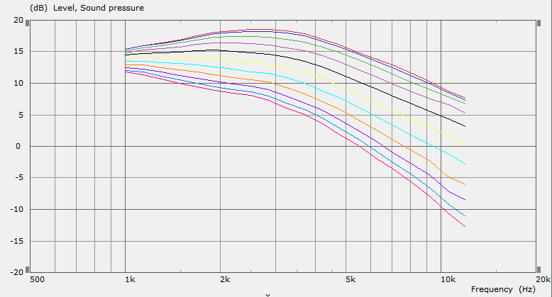

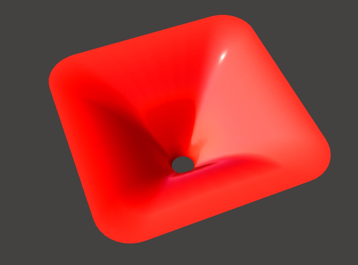

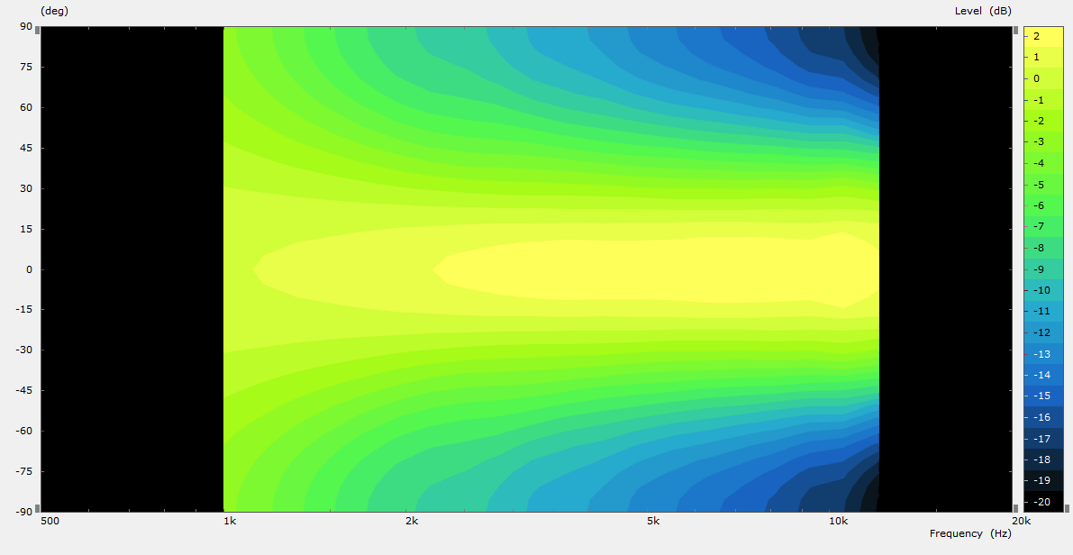

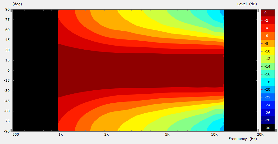

Anyone interested in comparison between slot loaded Keele's waveguide and STH?
Sure. Is the comparison between 2 sims or 2 real horns ?

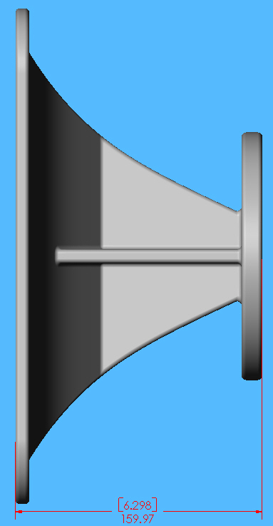

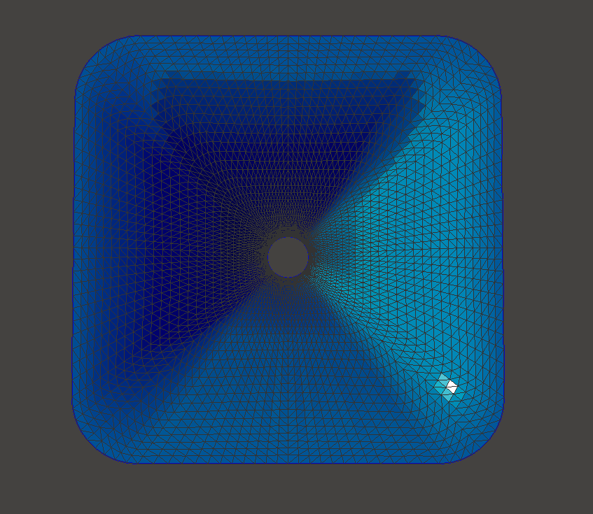

What is the corner radius, Jacek?

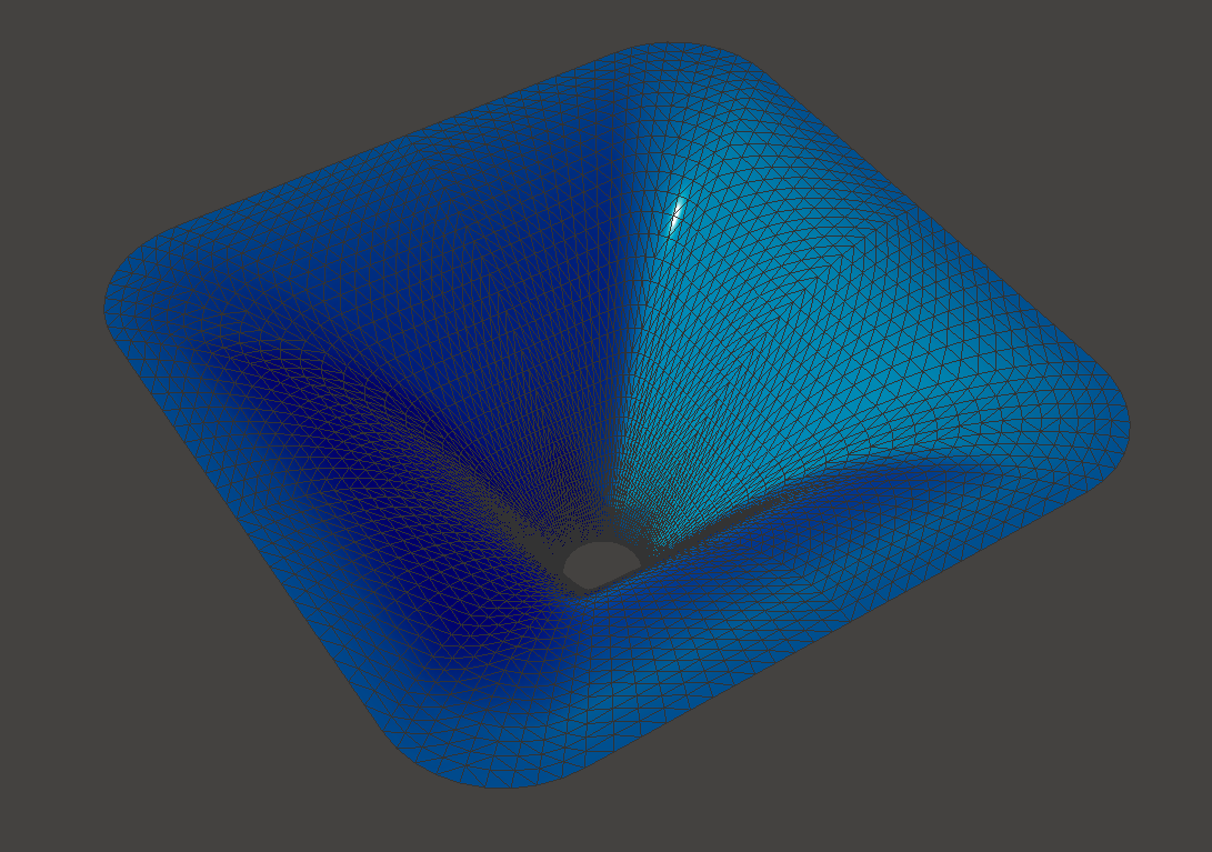

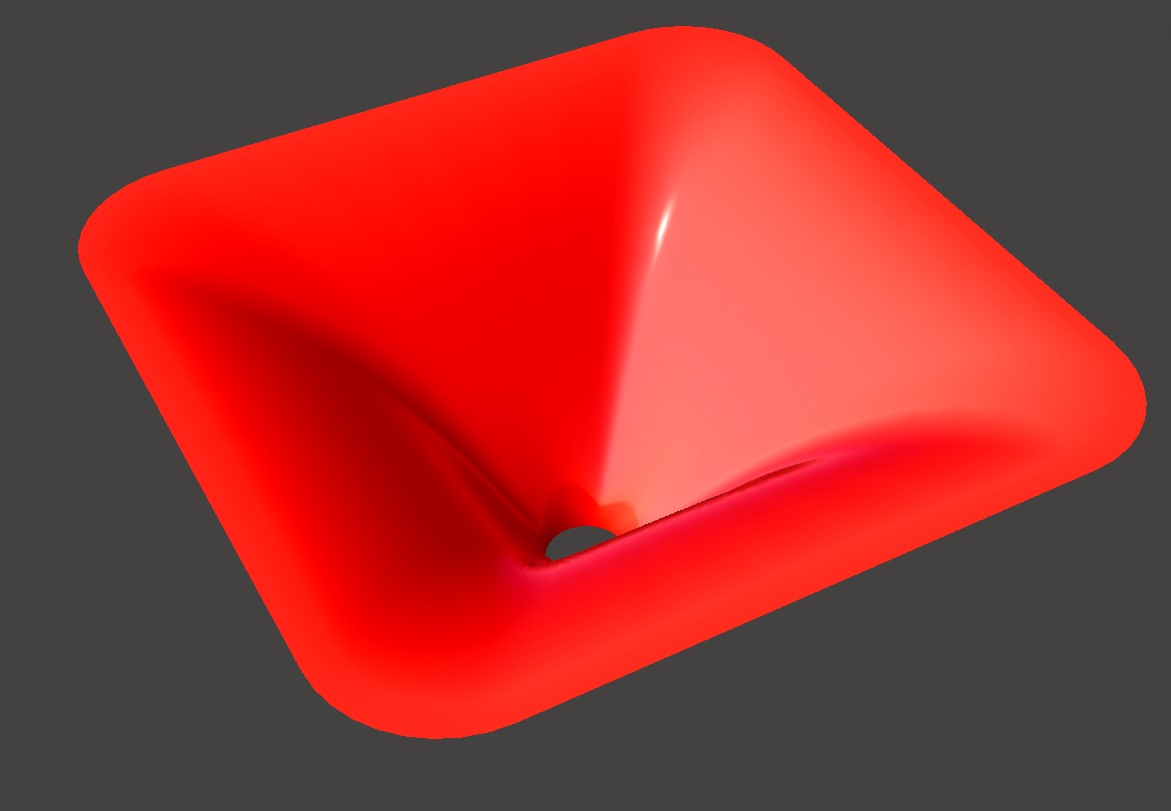

Anyway, you can modify it as you wish -
Code:
ThroatDiameter = 25.4 ; [mm]
ThroatAngle = 7 ; [deg]
Coverage_Horizontal = 73.5 ; [deg]
Coverage_Vertical = 73.5 ; [deg]
Depth = 100 ; [mm]
Depth.ConicSectionPart = 0.2 ; 0.5
Shape = raw2rect ; raw | raw2rect
Shape.FixedPart = 0.2 ; 0.2
Shape.CornerRadius = 35.0 ; [mm]
SEExp = 8 ; superellipse exponent
So please set the right entry angle for this driver. It should be easy enough to keep the current size. I sketched this one very quickly but now when I compare it to some other results it seems to be really good!

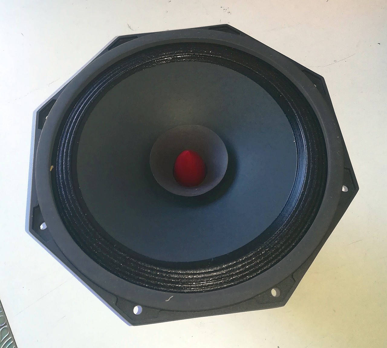

The challange now will be to find a good woofer. Because of the relatively small size it needs to be crossed quite high, like 1.5 - 1.8 kHz... There will be not many readily available drivers capable of that.
I would look for 8-9" woofers used in studio monitors, usually with polypropylene cones, typically smooth enough. Even the woofers from Behringer B2031 are quite good - they used to sell them as replacement parts. No problem to get these to 2 kHz.
