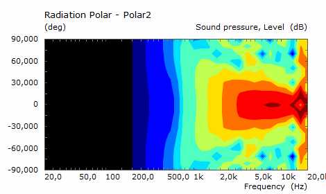

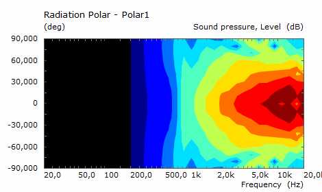

What do you guys think of biradial horns?
I've made a little experiment combining two of my favorite contours.
Horizontal is CD with wider coverage angle
Vertical is a more of an exponential with good loading.
In Fusion360, I just revolved the contours in their respective plains and truncated one curve by the other (ish) to get the final shape.
Has anybody else tried to combine contours in this fashion?

What are the dimensions of this biradial horn ? And how many dBs per shade have you used to plot the polars?

Experimenting is good, but this one maybe wasn't your best. Those are probably not the polars you would want in a waveguide.
