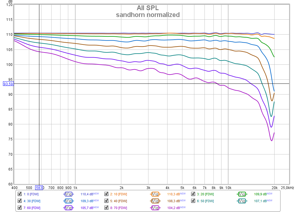

... I'm maybe picky, but claims are made so confidentially these are perfect and those are bad, but without substance.
Without substance? Are you serious?
- This may not be perfect (maybe still a bit small) but then I would like to see a better waveguide. And this is a real measurement of a real (axisymmetric) device - the one that makes the most sense to compare:
Are you also perfectly happy with the distance between the curves?
It's not a trick question - I really want to know.
