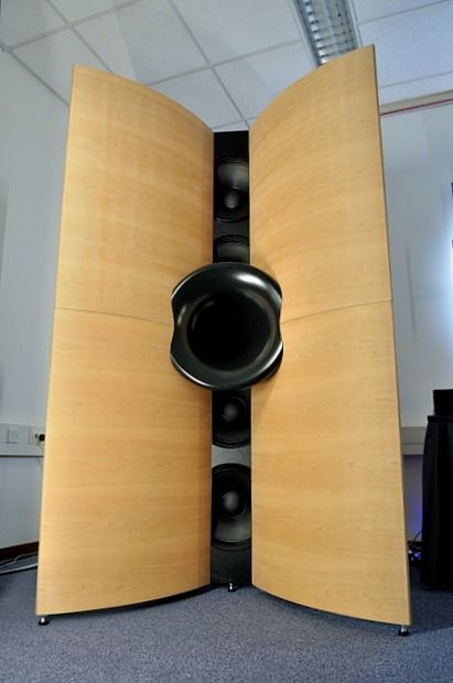

Here's a suggestion.
Clone the attached system by using 4x 12" or 15" + CD horn.
Determine the optimal slot width, depending on the XO frequency.
This is undoubtedly one of the best concepts for reproducing a "live" recording, such that neither the room nor a cabinet spoil the experience.
Or, simpler and SPL-limited:

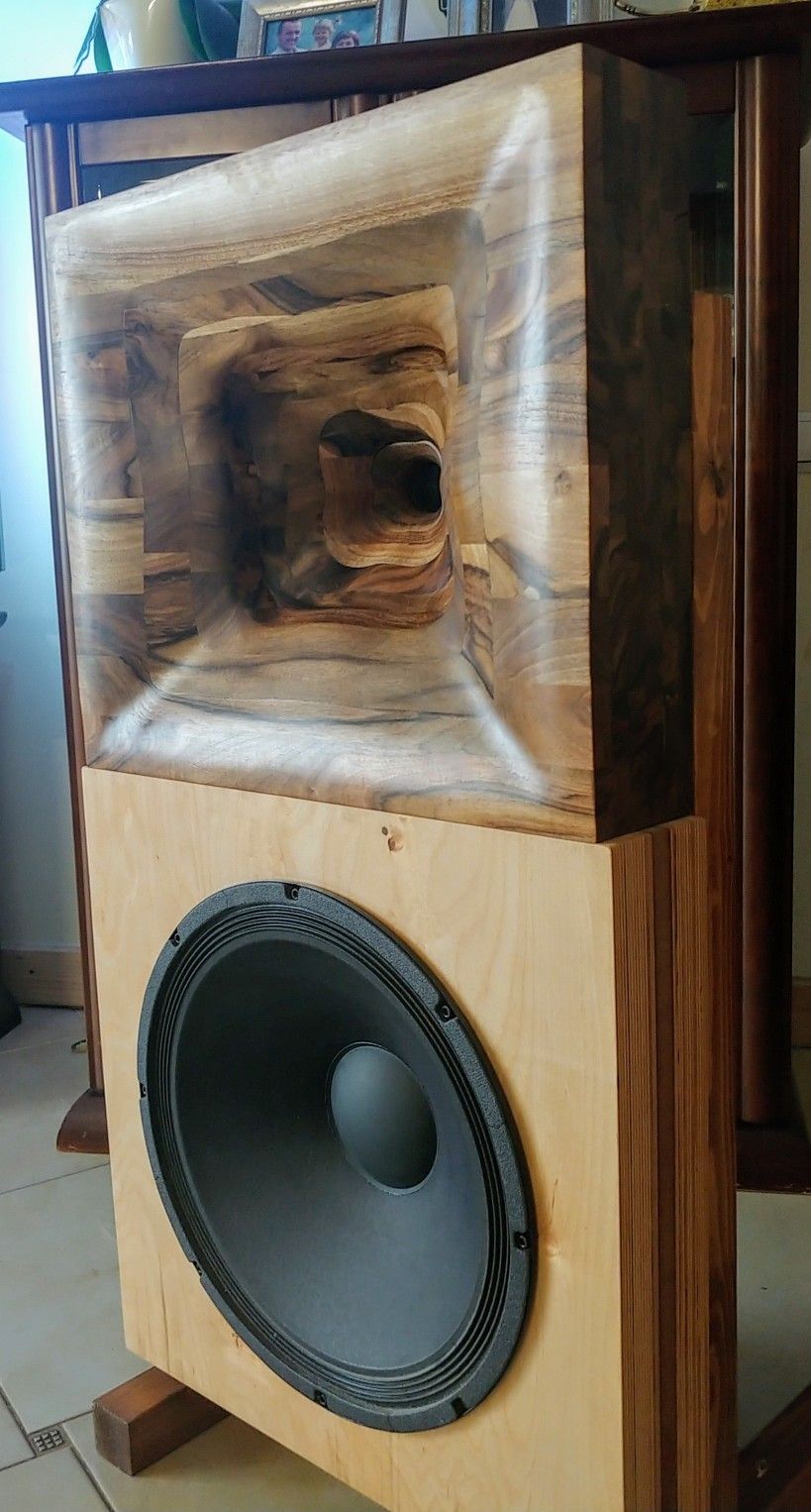

did anyone of you tried to generate a midrange horn contour with ath4?
I already asked here but there was no feedback. Does this mean nobody tried or does this mean ath4 is not designed doing this?

Midrange, the spectrum from roughly 250 to 4,000 Hz?
You'll need a cone driver in order to cover this with a waveguide.

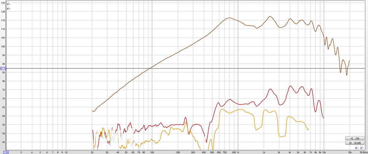

when searching for the the xlim that I never found I started getting close to loud enough at 215hz with no horn...I don't know exactly what a waveguide does outside of provide a rolloff....how it affects acoustical impedance is what I don't know I guess.
(measured at exit)
humm i wonder if you'll get a plain english explanation without some complex math introduced that muddies things....
It's fair to ask for a high level explanation, but realize the math actually makes it clearer for some. We wouldn't be here without it.
