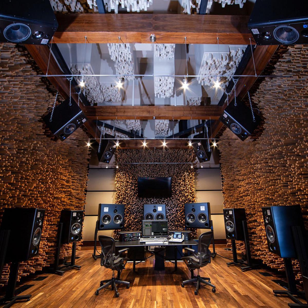

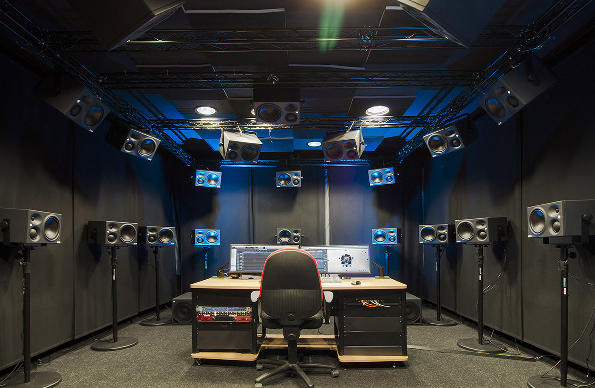

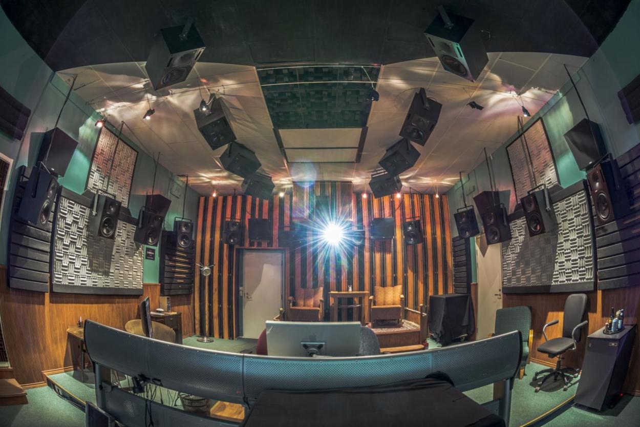

I am going out on a stretch and saying that likely, todays systems can recreate this experience?...If it does not exist narrowly with the sweet spot of a superbly accurate 2 way system ...may be within something like pictured below?This is my problem - todays systems cannot recreate reality i.e. a music event in a hall.

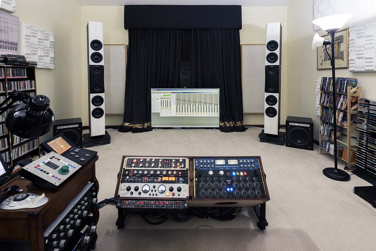

Yes, I of course understand this. But I'm sure with modern tech there are less obtrusive solutions. There are studios that do it. I see the massive analog console as almost a mark of status, like doctors wearing the stethoscope even if it could just as well sit in their office along with their other instruments.
Mindsource - I think you'll find that the desk are already trying to facilitate your view....its hard enough to convince people to start engineer ITB as they believe analog hardware has a certain magic to it...in certain cases they are correct...but the shapes of desk are meant to help be not acoustically seen...that doesn't stop one from setting up the rest of the room improperly...and there are plenty of people now (I think) who are going for the improvement had once everything is moved out of the the way
I don't know what the hold up is....I imagine a chair and a laptop....in my lap

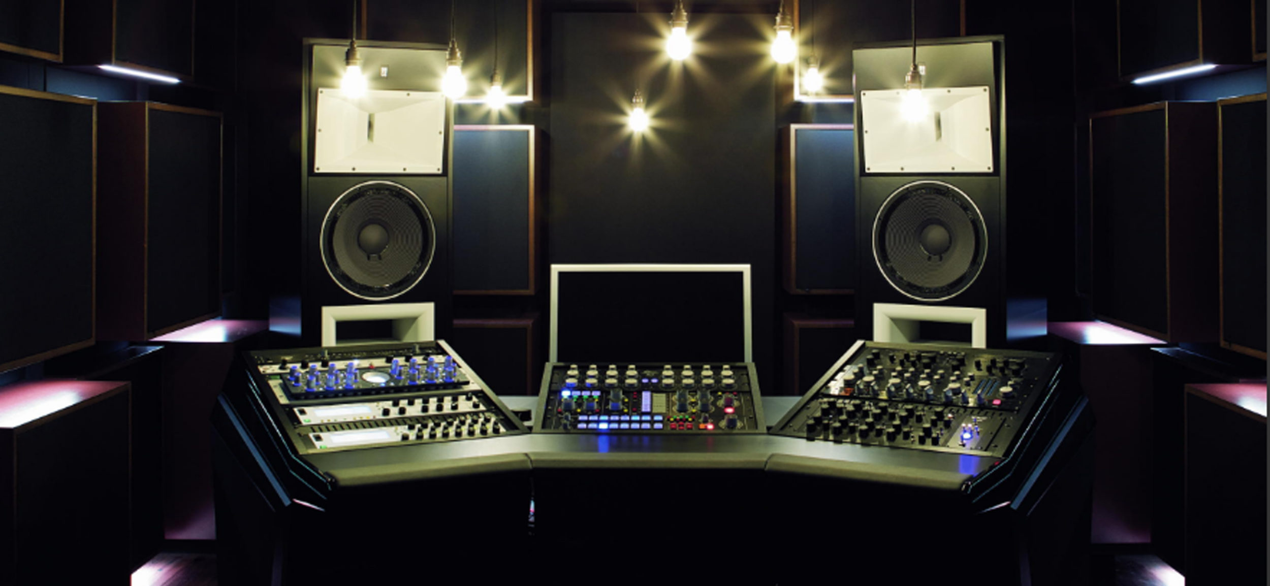

Read Newall & Holland' High Performnce Loudspeakers about (their!) in-wall mounted dedicated Studio Monitors (as opposed to the average Monkey Coffins for the deaf).
The horn:
The flush-mounted monitors:

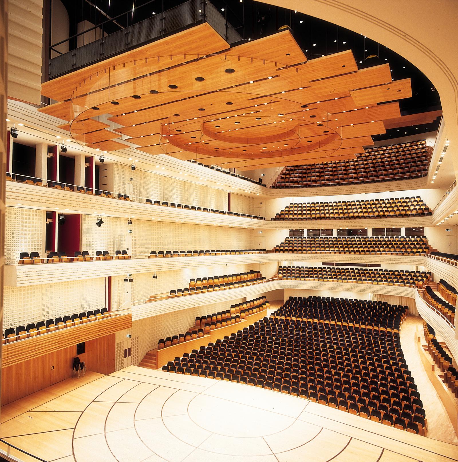

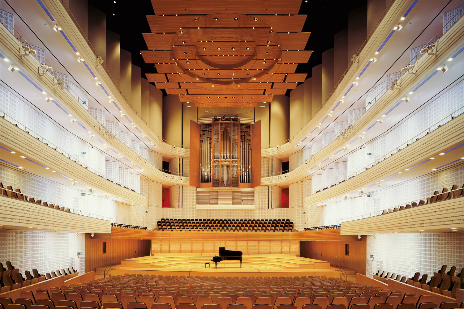

"Since no physically fixed concert hall can meet all the needs of musical acoustics, all that remains is the concept of a certain room acoustic variability. The following sound aesthetic aspects are to be combined, though the historical requirements should be taken into account: rest/silence/tranquility (purity), spatial impression (envelope), transparency (clarity and detail).
This procedure was exemplified in the Salle Blanche of the KKL Luzern: works of electroacoustic music, chamber music, symphony and sacred music can be performed here - variable absorption (fabrics), variable reflection (canopy over the stage) and a variable room volume (echo chambers) make it possible. For a structure of this size and considering the location (city center) the silence in the hall allows for undisturbed recordings of music from the piano-pianissimo area - such characteristics were, until now, only found in the best music studios.
The maximum acoustic variability available today facilitate the electroacoustic production and reproduction processes of surround sound, ambisonic and wave field synthesis. With these methods, all types of rooms - including those which cannot be physically implemented, can be constructed or mimicked acoustically.
However, the reproduction or production of these sound spaces continues to be bound to conditions that describe an acoustic non-location: free field, anechoic room or headphones. Music can be heard everywhere that has not been performed anywhere."
Not sure what the Salle Blanche is, if it's the same thing as I'm not aware of such a room, but the main concert hall at the KKL Luzern is indeed stunning.
