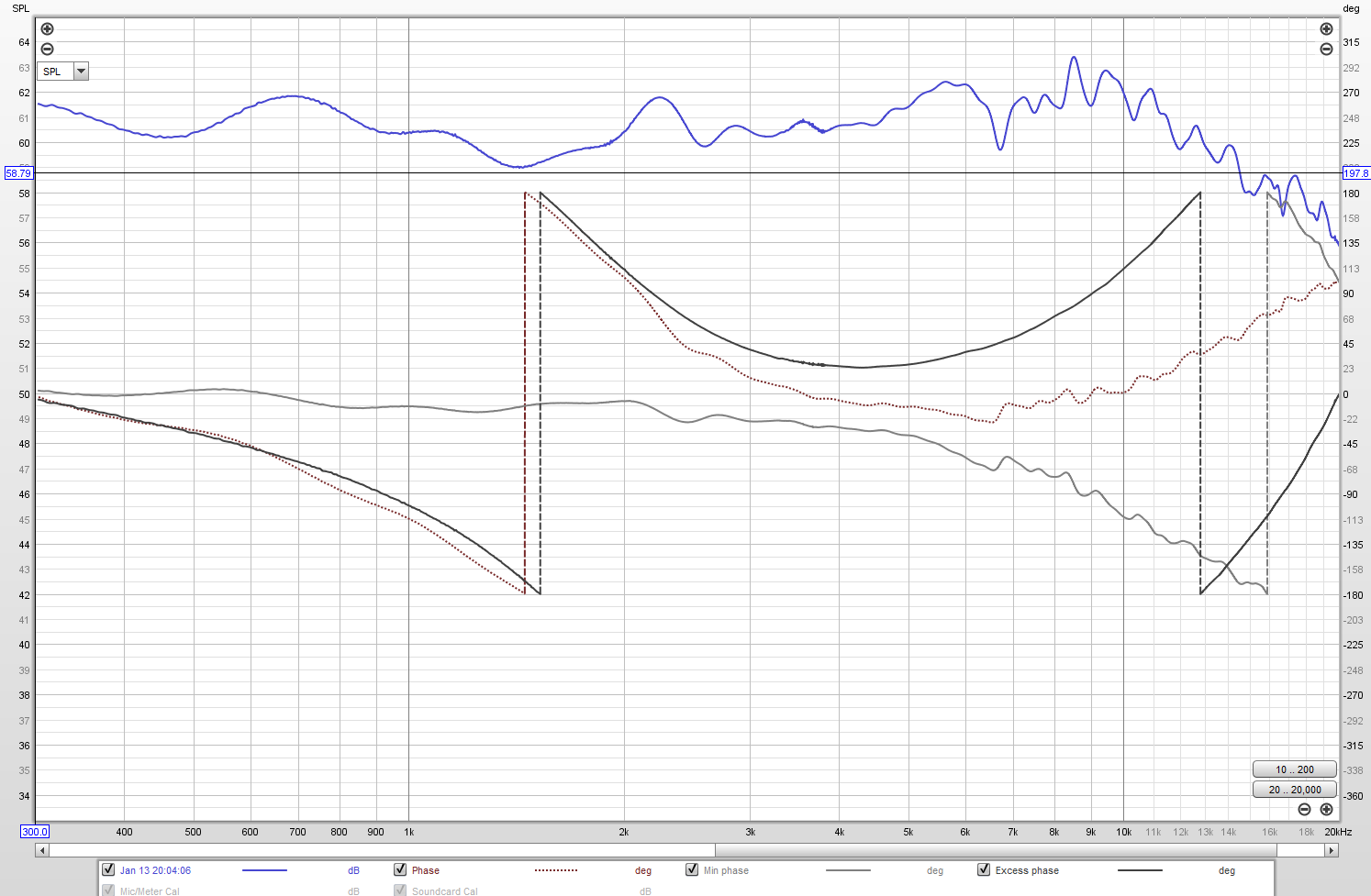

Could you show how does it look like in your case when you let some reflection(s) enter the IR window?
here is my truth 2031a with the IR window out too wide. you can see the ripples in the excess phase plot caused by me opening the window up. its much smoother (but not perfect ) if I window the measurement properly
Just because something is objectively true in isolation does not mean that you can extrapolate it out to determine that more of a good thing must be better. This is why it is an over simplification in the context of the perception of an entire audio system.its not over simplified its scientifically objective
Isn't the minimum phase more smoothed, compared to the measured phase? It seems odd to me that it should be that smooth, looking at the amplitude response. That would also cause all the small ripples in the excess phase.here is my truth 2031a with the IR window out too wide. you can see the ripples in the excess phase plot caused by me opening the window up. its much smoother (but not perfect ) if I window the measurement properly

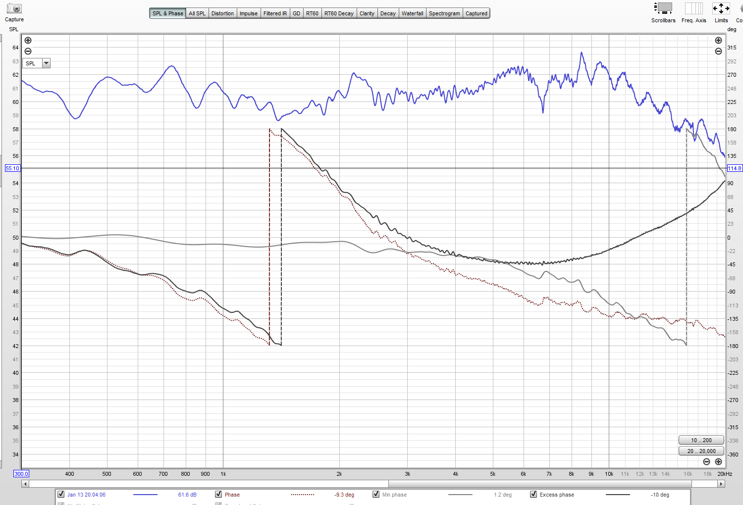

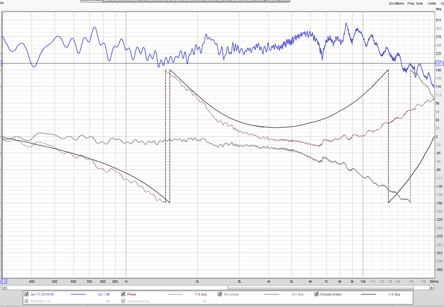

yeah sorry you're correct. didn't recalculate the min phase response
here are the before and after. 3ms gate and 20ms I suppose this means that everything pretty much in this measurement is minphase? If i do the same thing with a room measurement of the same speaker then the excess phase has MASSIVE wraps in it
There's the excess phase due to the crossover (what makes the central "wrap") but that's about all I can see.
BTW, in your measured phase the pure delay is over-compensated. The right amount of compensation should render the phase curve flat above the pass band of the device (i.e. group delay should approach zero for infinite frequency). If it's bending upward, it's clearly over-compensated. It doesn't really matter for much of the analysis but it looks a bit weird.
Maybe for a better readability it makes sense to show the excess group delay, i.e. taking group delay of the excess phase.
- Now I'll have to think more about this because obviously it shows nothing interesting. It's not intuitive to me but it seems this is how it is.

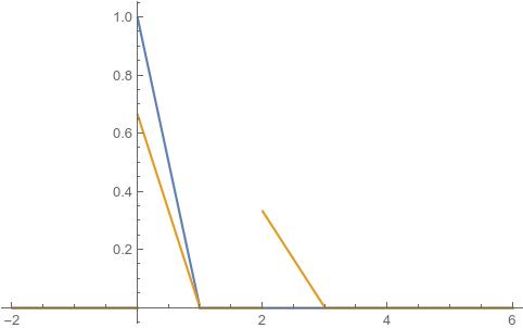

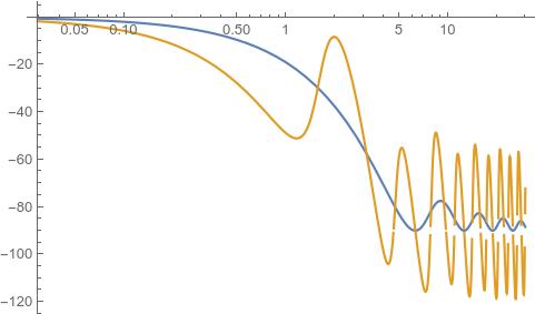

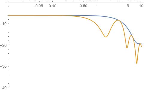

Maybe someone with a more fresh theoretical knowledge would know this - how is the frequency response supposed to change if we just repeat the impulse response and calculate the FR from that?
So it will be some comb filter but will it be minimum phase? It seems so.
What do you mean by "repeat"? You mean copy paste at different times?
Yes, good idea! These kind of software (Matlab, Octave, Mathematica, various Python packages, etc.) are just great when fiddling with physical concepts. A good option is Python + Numpy + Jupyter! That way I can share my horn code with somebody... 😛I think I have to install and finally start using Octave.
Yes, I meant to copy the (windowed) impulse response and paste it with some dalay after the first one, perhaps with a smaller amplitude.
It looks like that for the second peak of half the amplitude:
and phase:
with the impulses given by:
I haven't properly scaled the frequencies to anything but the behavior will be qualitatively the same.
Edit: Forgot to put the phase.
