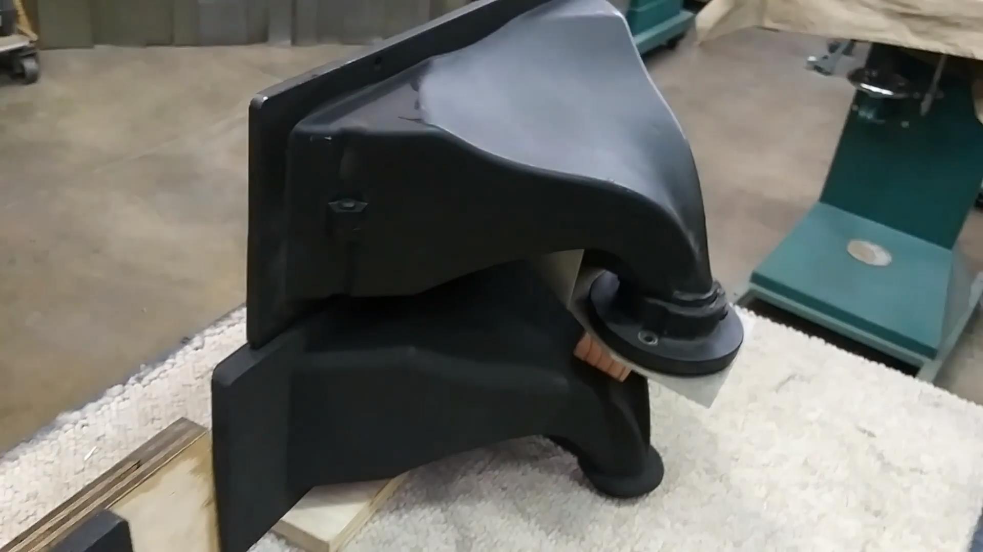

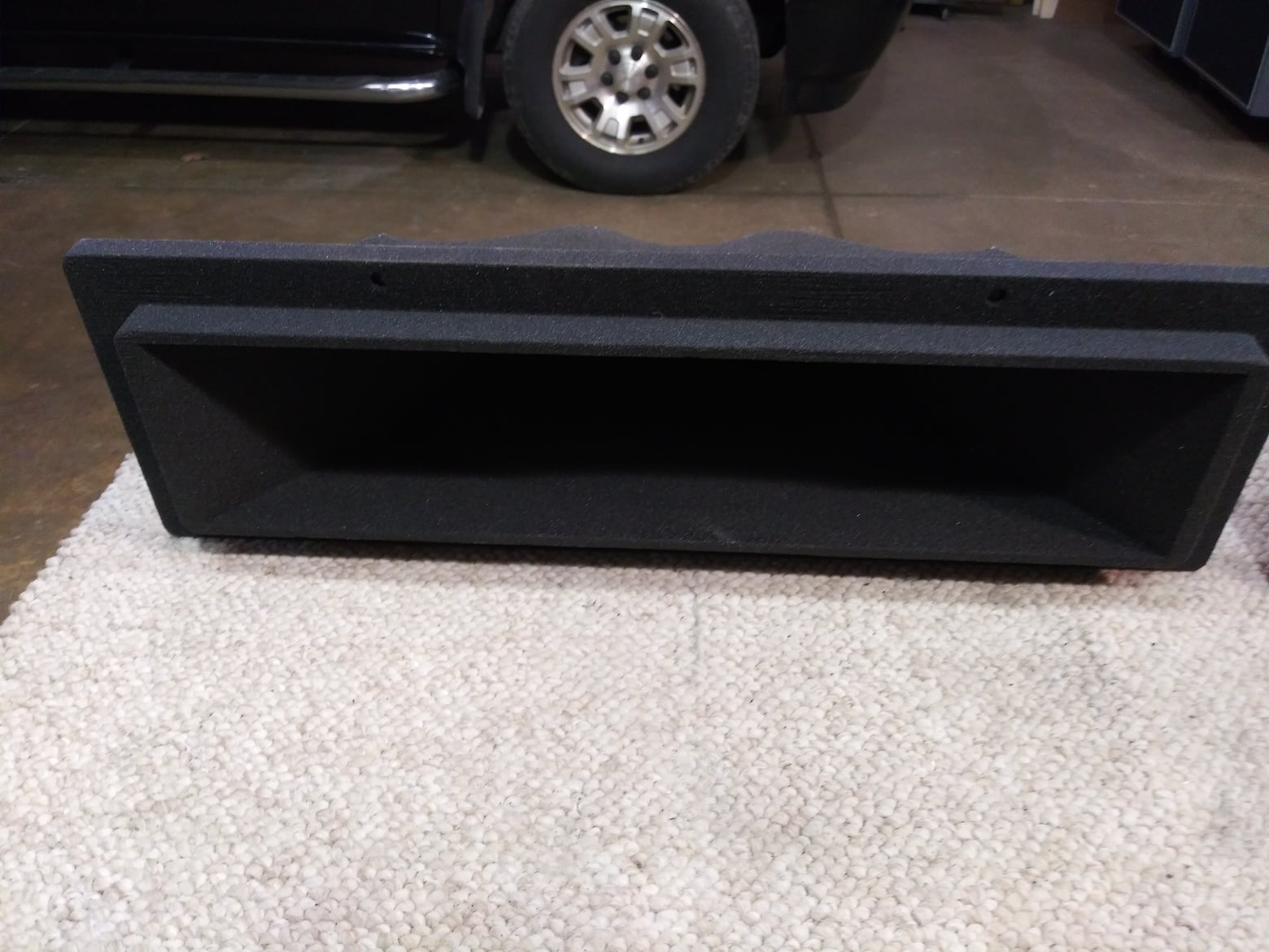

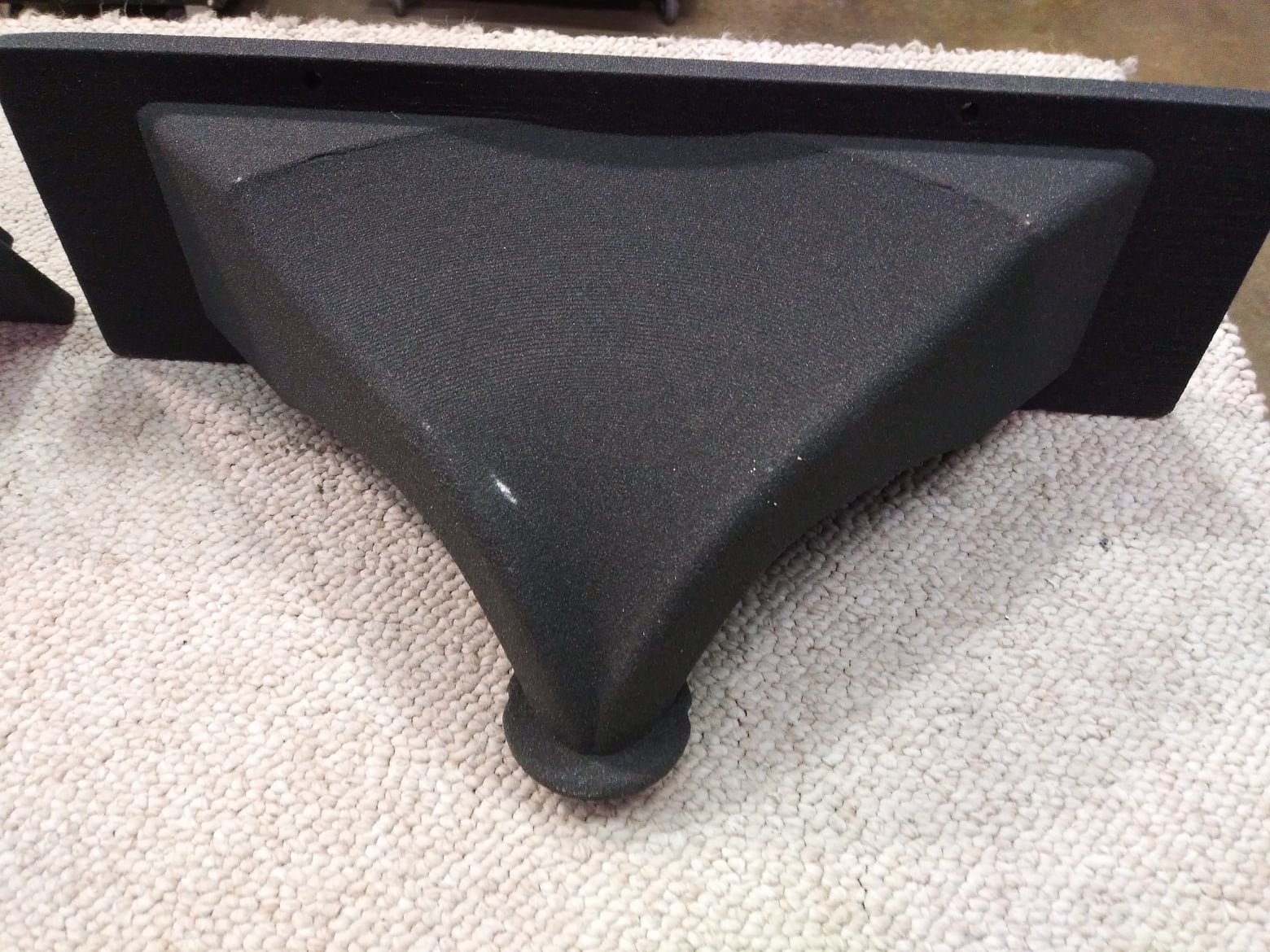

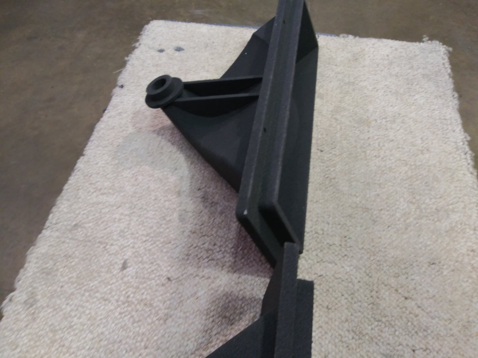

5. TD-2001 & HF10AK on RCF H3709...
The RCF H3709 is a straight throat clone of the Altec/WE 32 series.
The latter has been printed with another binder jetting 3D printing technology called AMClad, which is (also) sand-based.
Picture no. 4 shows the original on top of the printed horn.

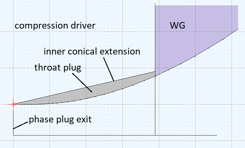

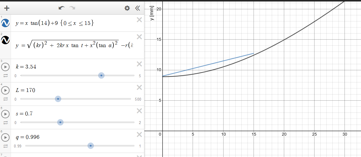

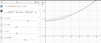

I think the idea is to build a horn that extends into the compression driver itself - essentially reducing the driver's throat length.
OK, yes, but nobody does that. That's why I looked for drivers with as short of a throat as possible - longer is a problem as we can see.
It would not be a problem to print such an insert into an existing driver. That was my point. When we make the whole waveguides, this is just one small detail more.
I'd love to see someone try it and post the results. It is a very good idea.
that insert seems like really good idea. It will be very easy to make it on lathe machine (and probably more precise than 3D printing).
It will make entry angle 0 for all CDs where is applicable so, as I understand, naturally better for the flat wavefront.
To not squeeze the exit to much maybe will be the best to take 1.4" CD and implement such insert
