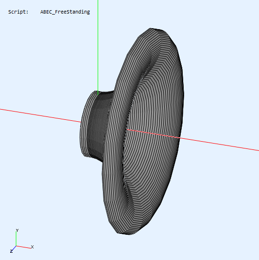

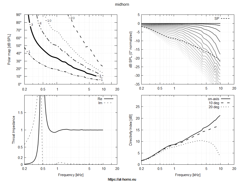

What about using a free standing midrange waveguide, instead of a direct radiating woofer of similar size? This is for a ⌀100 mm flat piston, ⌀380 x 100 mm overall. I'm only not sure it would reach low enough to overlap with the subs. Maybe with a bigger transducer. The advantage could be smoother response around the crossover frequency, I guess.

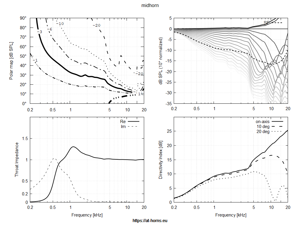

For the "midrange" game I think you need to show actual FR so we can understand the EQ need. It doesn't look like a 200 Hz horn in the charts - and I doubt a 38cm ever will be. 138... mm...
My sole motivation was to get the same (or better) directivity as that of a large woofer, without the issues of a big diaphragm. Probably it's not a very good idea overall, I don't know. It may need an additional woofer. Or not - depends on the SPL requirements.
No, it's about the same size a woofer would have - that was the aim. To replace a large woofer in a two-way loudspeaker by something with a similar DI but smoother frequency response.
(Made this way, it may require an additional woofer, i.e. it could be a three-way with a dedicated bass transducer - no DI requirement anymore, just a volume displacement).
As I imagine it - free standing "regular" WG with a CD, below that a box with this midrange WG (so not free standing) on the front and bass drivers on the sides.
Maybe both the waveguides could be free standing, one above the other. It only limits the space for a bass enclosure (which should not obstruct too much, IMO).

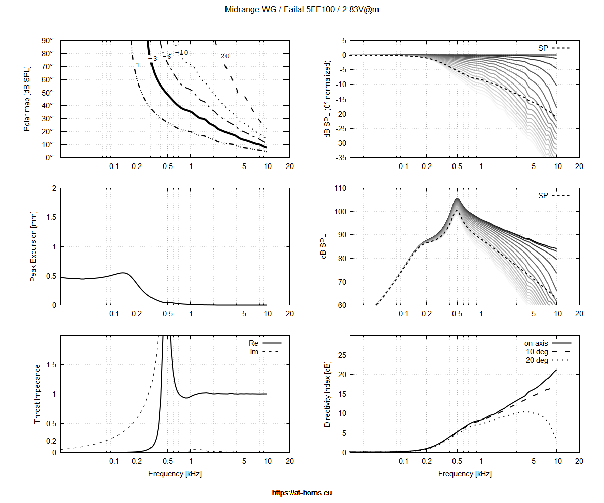

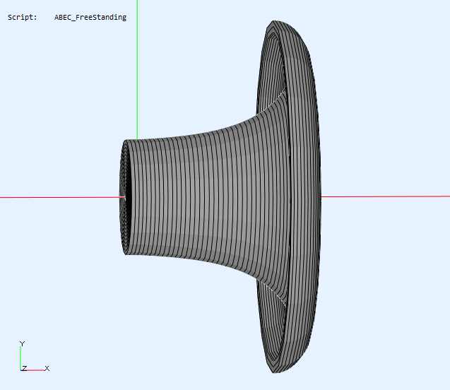

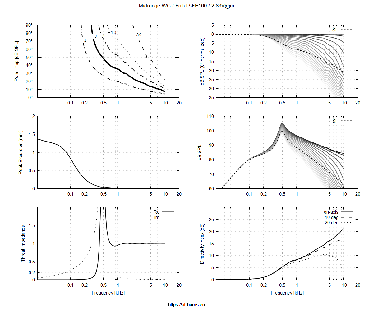

Here is the last one (free standing) with the Faital 5FE100 (5") - absolute SPL at 1m/2.83V. Of course first one would have to get rid of the resonance, this is totally non-optimized...
Maybe usable to 200 Hz (?). That's not bad, IMHO.
I like it! Seems like we would only need it to get down to our rooms' Schroeder frequency, then an adjacent woofer and multiple subs.

Would the roll-over in #5206/11 still have an impact in its intended frequency span?
200-1500?
