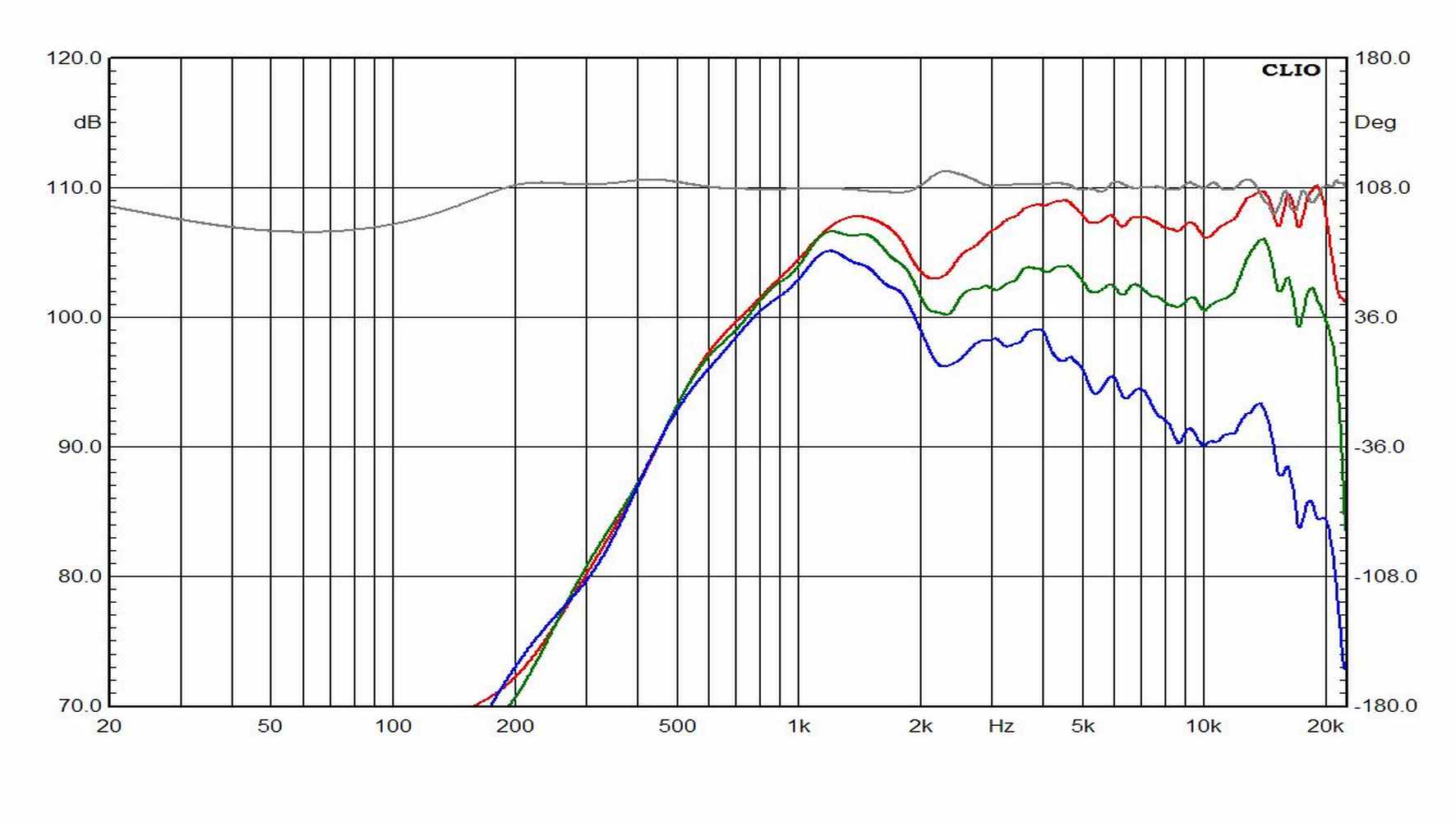

Faital pro hf10ak with 21 degree conical exit, that is what I have here so using it. I don't know exactly how long the conical exit is but estimating it by eye its about 1".
The HK10AK is a kind of 'poor man's TD-2001', but luckily with a much wider exit.
It does suffer from a similar dip > 1500 Hz, though.
Personally, I would sacrifice some DI for better throat impedance.
Some beaming (> 8000 Hz) isn't really annoying as long as DI is fairly constant in the midrange.

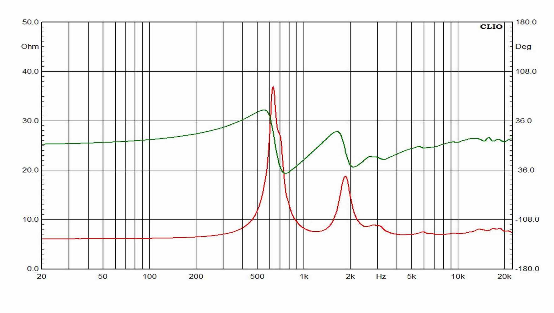

1. Driver only impedance

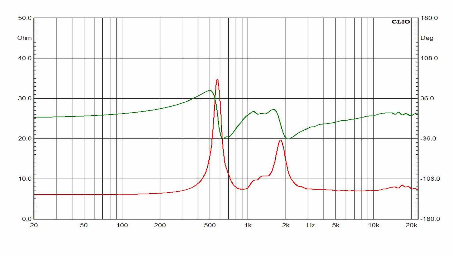

2. HF10AK + STH100 impedance
3. Half space, horizontal plane
4. Half space, vertical plane.

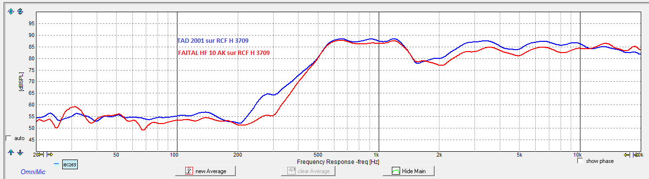

5. TD-2001 & HF10AK on RCF H3709 (speaking of loading).
