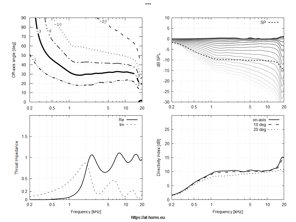

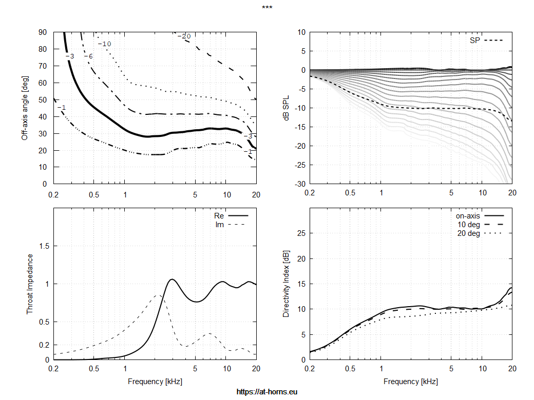

Speaking of throat wavefront shapes, here is an example - 15" waveguide, 1" throat.
1) Throat opening angle = 0°, directly driven by a flat wavefront:

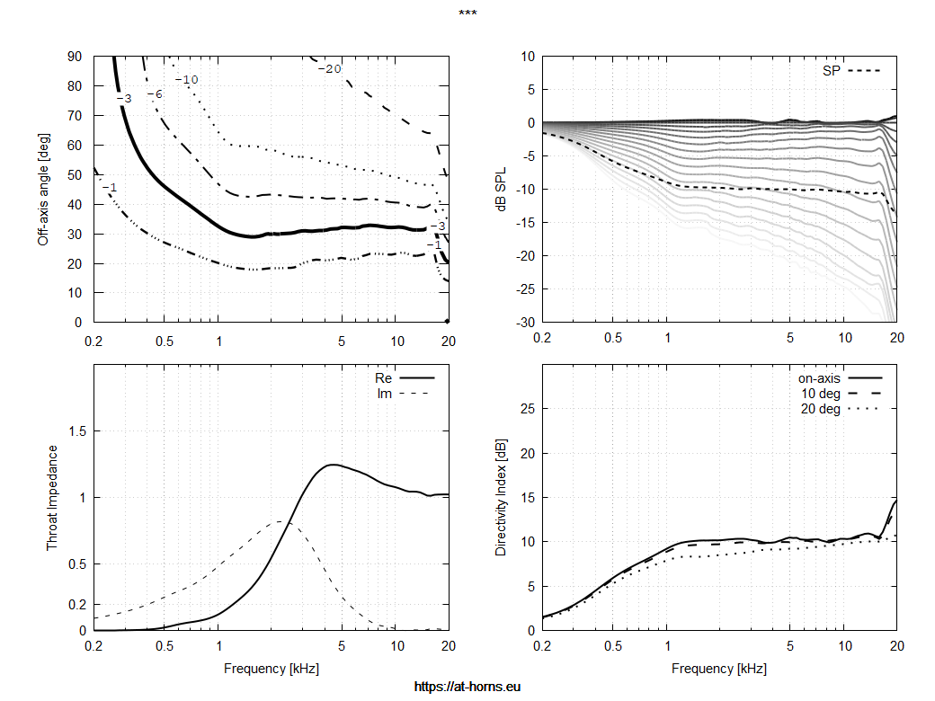

2) The same waveguide with the same throat but connected to a 30° conical section 20 mm long, emulating a compression driver's exit section (itself driven by a flat wavefront):
3) Connected to the same conical exit as before but now the throat opening angle is changed to match the connected conical section:
No, only alpha_0 was changed so the last waveguide was actually 1.2 mm shorter (i.e. not much). And that's only because of the rollback, otherwise the length (L) would stay the same.
strangely enough from looking at the response curves i would think that the third iteration would sound smoothest overall....it exhibits the least rise in on axis response above 18k and by and large rolls off gradually above 15k regardless of angle. the first iteration shows a small peak(about 17 k) before a step rolloff. (peaks are generally more audible )
the second iteration shows a subsequent rising of response after 18k that gets worse over angle, doesn't that go counter to the theory of "directivity" in that the response rolloff smoothly and consistently over angle?
