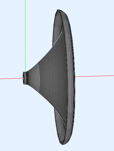

Working on Ath 4.7.0, I've finally put together a document summarizing the OS-SE waveguide formula: OS-SE Waveguide.pdf
I believe that with the OS-SE formula it's now possible to approximate almost anything - it is a "generalized OS".
I believe they can be very well approximated but I haven't tried though as I'm not really much interested in the other curves. I judge based on the throat impedance curves where there's possible to get almost anything with the OS-SE only. Is that "no"? Take it as no if you wish.

You were interested in what Ath does, correct? It simulates horns (generates the geometries, to be precise).
Not to mention that there are already many confirmations that the sims are very close to the real things.

Well I think that by now we very well understand the anomalies in OS waveguides and also know how to overcome them. There's really nothing wrong with the OS per se and it can sound extremely good.
But let's also add that a pure OS waveguide doesn't exist. It would have to be inifinite. So when you are talking about "OS waveguide" you just have to be aware of that you're always talking also about something else - its particular termination.
what would you say are the well known anomalies of OS waveguides, HOM's? truncating it to a finite horn?
well for me it's both ends if the throat input doesn't see perfectly plane waves or the mouth termination produces diffraction the reflected energy the driver see's is bad news fast.
it is an elegant mathematical solution that has a hard to deal with real world caveat.
Actually, it seems from the simulations (and measurements seem to confirm) that there's quite a tolerance in the throat wavefront shape, i.e. the impact is not as strong as one would think. I'd say that there's quite a long way from perfect to a point where it goes really bad. At least for compression drivers.
