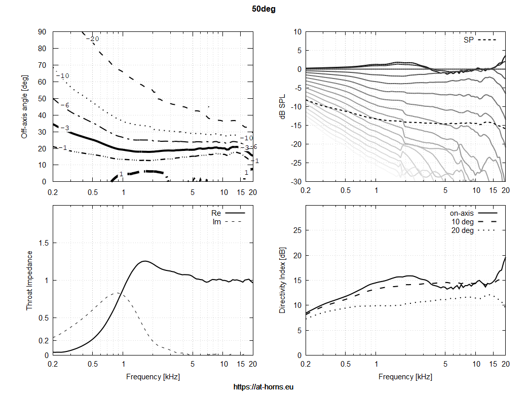

In all the following cases there's a flat wavefront at the throat (1").
Polar maps (top left) are normalized to 10 deg. The polars on top right are not normalized.

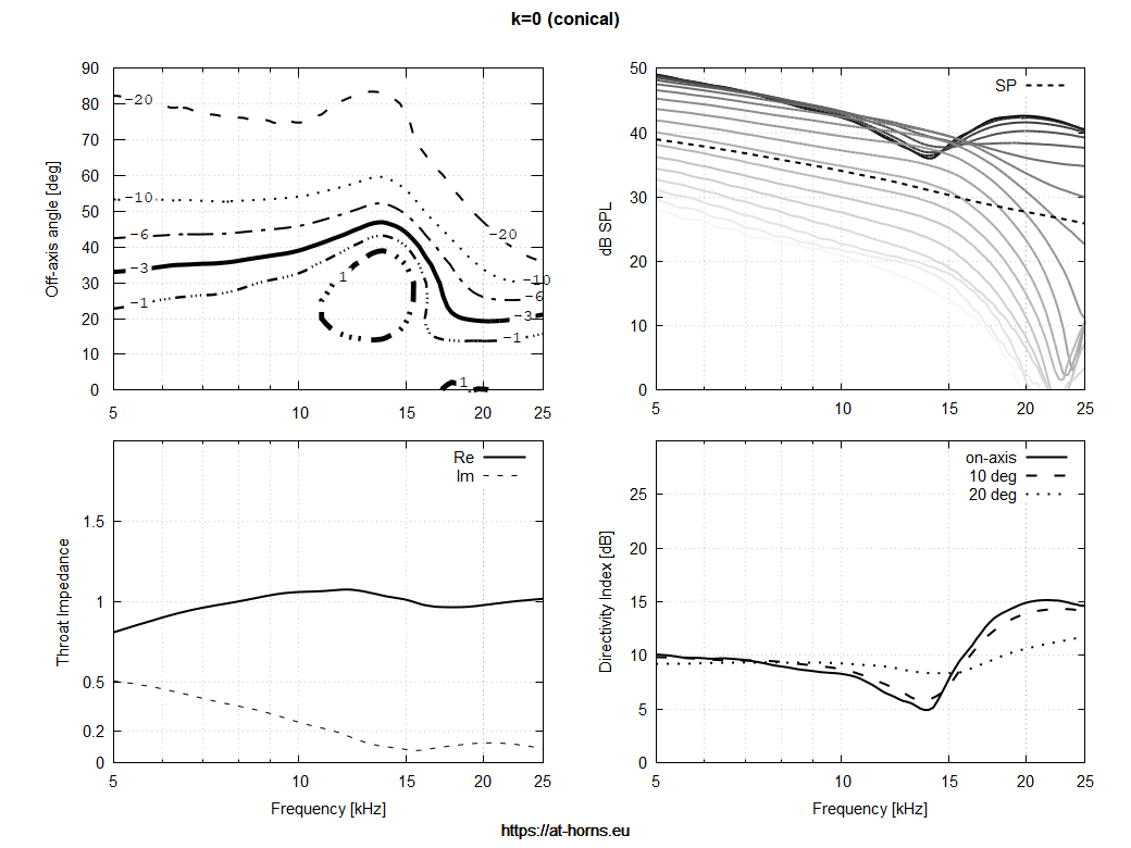

1) k = 0 (i.e. conical waveguide):
attachment.php

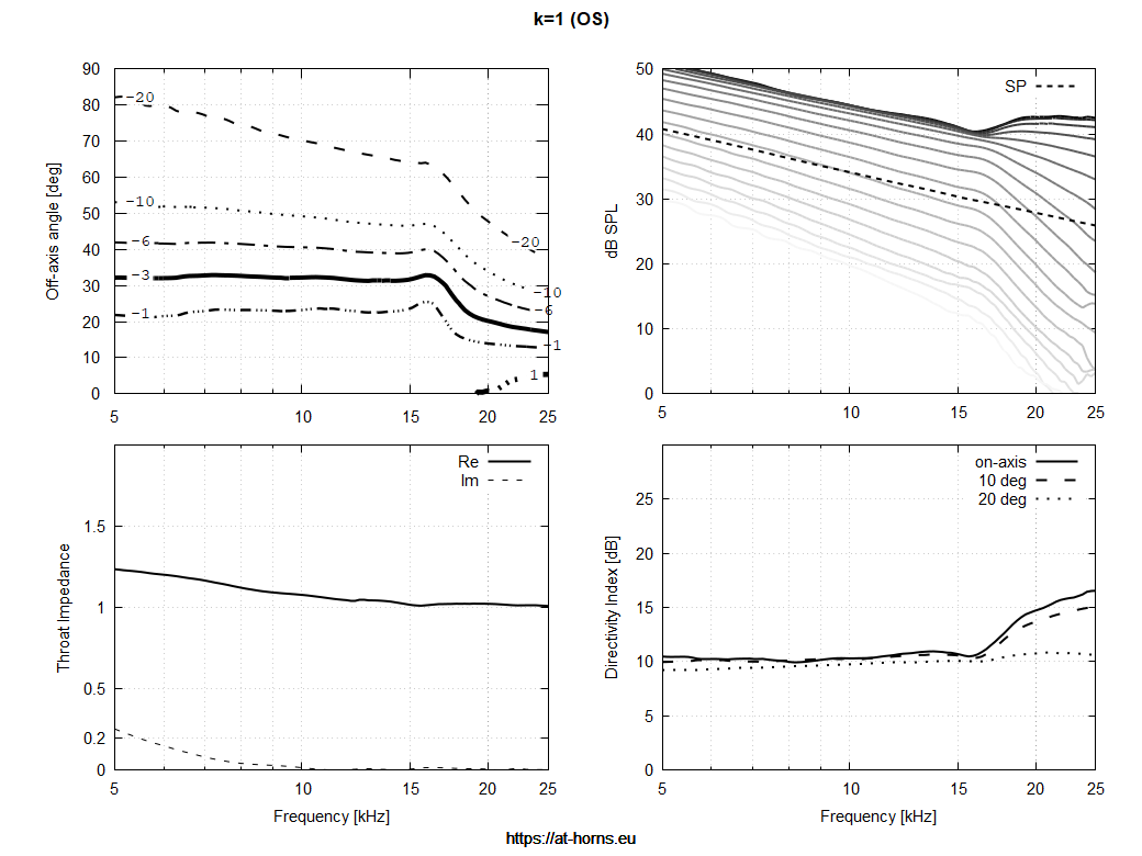

2) k = 1 (OS)
attachment.php

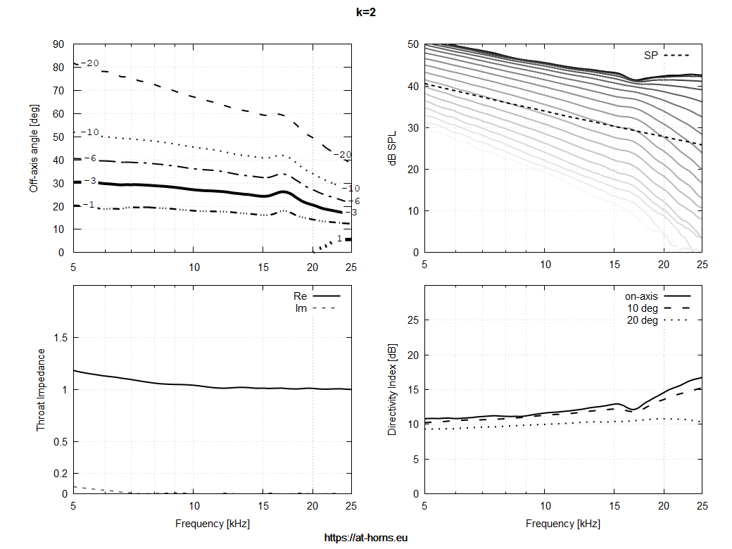

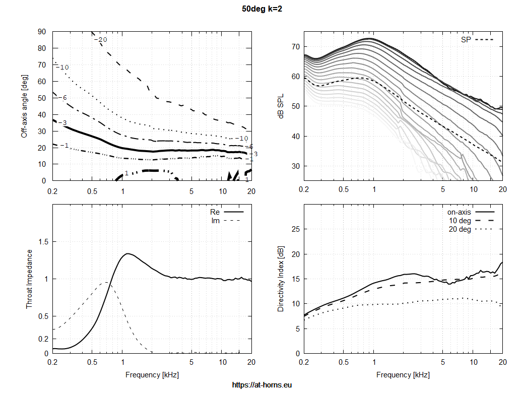

3) k = 2 (OS profile corresponding to 2" throat)
attachment.php

is there other trade offs using k value over 1 than the narrowing of the polar pattern? It looks like that "slower change" near the throat pushes the wiggle up higher. Does this mean that if a certain nominal polar pattern is the target one could decide on a bit deeper waveguide with a larger mouth that would provide better highs and maybe lows (if loading was a thing) by using k > 1 and adjusting the other parameters to get the desired polar pattern?

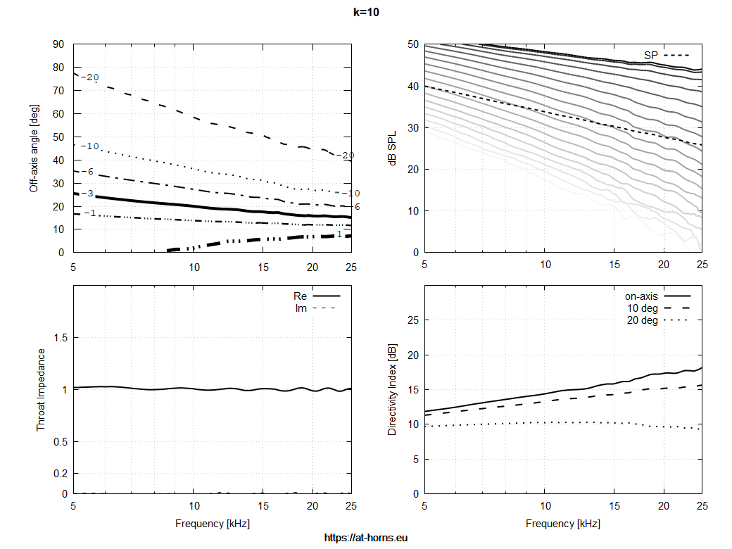

What happens if the k is 10, push the wiggle above 20kHz?😀 Amazing how the throat profile widens the wavefront in higher frequencies than the 1" / 13.5kHz.
ps. what the "k = 2 (OS profile corresponding to 2" throat)" means?
The narrowing (rise of DI with frequency) is the only drawback of k > 1 I'm aware of. The benefit is that it pushes the higher throat impedance lower in frequency, i.e. increases the loading. It also seems to kind of smoothen the DI curve in the top octave. Pick your poison.
k = X means that an OS profile otherwise corresponding to a X times larger throat is used. If you play with the OS-SE formula you will notice that the OS profile depends on the throat radius - the larger the radius, the less curved is the profile near the throat, i.e. the slower it expands.
