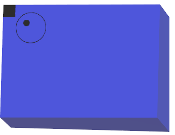

What I have in mind is something like this sketch (if it attached). A shallow rectangular-ish box with the tweeter in one corner and a MEH style woofer. The tweeter needs to be flush with the corner. If we choose the direction it is facing as 0 degrees then the HF horizontal polars should approximate a tweeter twice as long and high (with the walls removed).Getting close to walls makes the way you do it more critical.
The opposite edges of the box could be blended into the ceiling/floor to minimise diffraction. That would be the compromise to get enough volume in the box for the woofer.
Lots of 90 degree angles so not so much in common with the build of other waveguides - but based on the same principle of minimising diffraction, I would argue.

I don't think I understand. Certainly a round shape isn't going to blend onto the room.
Is it possible you are suggesting that a wall extension would somehow increase output? I can see you mentioned boundary reinforcement. The result of this depends entirely on the way it is done.

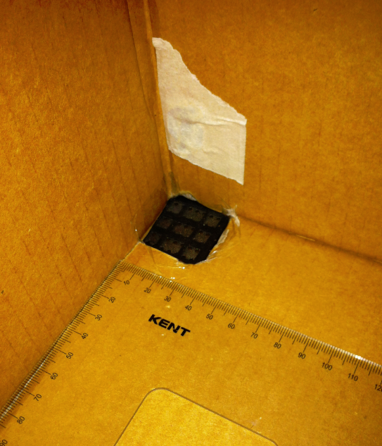

This picture of a test with a cardboard box might be better illustration.
If the tweeter is flush with the corner then its acoustic mirrors from the walls constraining its radiation will extend its effective size. I'm more interested in the effect that this has on the radiation pattern than the gain - so I was a little sloppy in referring to that as reinforcement.
In practice you won't be able to get it completely flush, so the tweeter's acoustic mirrors will behave more like an array. You need the tweeter to be small if you don't want a narrow radiation pattern. Said another way, you want the acoustic mirrors to be within a quarter wavelength through the operating range.
A false wall would be ideal for this, but a compromise is to make the dimensions of the speaker on the face containing the drivers large enough that the baffle step/taper to the wall is relatively small. This is the equivalent of the mouth of this when considered as a waveguide.
Unsure if that makes more sense. Pictures are probably better than words in this case.
Much clearer, thanks. Ideally, if you can manage to do it right, this radiation would be heading for a quarter of a hemisphere. As it stands I might guess that the higher frequencies would be more reluctant to travel over your set square.I'm more interested in the effect that this has on the radiation pattern than the gain
I'd question comparing these methods as they are probably quite different. The upfiring philosophy has been more omni, with diffusion, or a diverse mix of reflections wanted.My first inclination is to mount it vertically so that the horizontal polars are absolutely consistent. I currently use upward firing full range drivers in my living room with EQ with pleasing results for causal listening.
