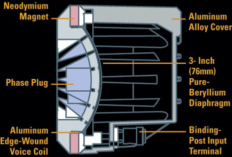

Here's some detailed information on the JBL 2341H. 3 inch aluminum diaphragm with (I'm guessing) a Kapton/Polyimide surround (photo of the diaphragm here). Bl=8N/A; Mmd=1.6g; Xmax=0.5mm.
JBL 435Be:
"Total moving mass was only 1 gram, with the diaphragm less than 0.5 grams.
This was less than a third the weight of previous materials."
And:
Density of Beryllium: 1,850 kg/m3, Titanium: 4,500 kg/m3 and Aluminium: 2,700 kg/m3.
According to Art Welter it's a Mylar surround.
