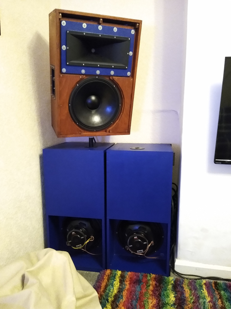

I can easily change them over to normal corner horns (pointing at the 45 degree line) but as I sit quite far back, I would be about 2m behind the crossing point of the on axis line (if that makes sense?)
If I remember right from geddes talk on YouTube, this is preferable for some CD horns line the ones in the summa. I don't know enough to know how this translates into what horn is ideal for my senario though.
Don't think of the major axis of the horn as being 45 degrees, it could be 30 and still have a 90 degree coverage - asymmetric. but then you do still want the major axis to cross somewhere in front of you. Just draw it out.

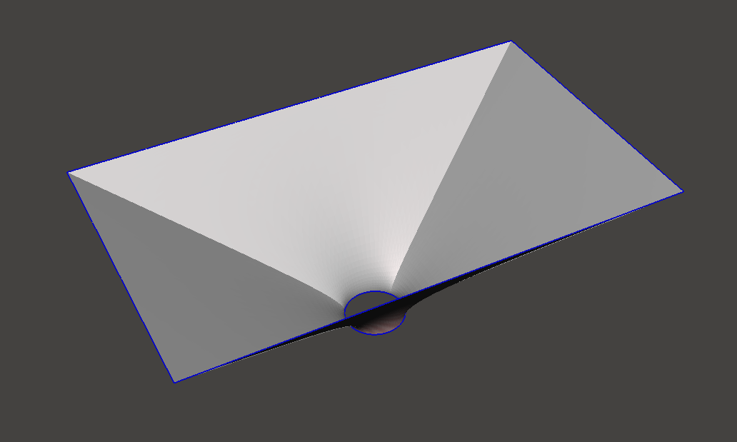

In thinking about it, I would be inclined to make the throat a rectangle, then the waveguide is more like a Prolate Spheroidal (PS) coordinate. It's not impossible. Just takes a lot of commitment.
Somebody clever enough with geometry could surely morph an OS into a 3-D corner then surely the walls are just extensions of the waveguide.
OS would match a 3-D corner best while PS matches the 2-D best.

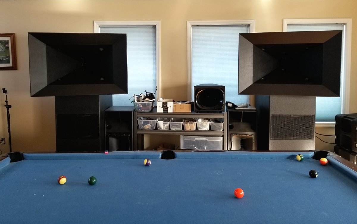

Yes, I was thinking straight sided conical with a 90 deg (or less) horizontal pattern. (why i mentioned ala synergy & walls as straight secondary flares )
Conical as per my current project below.

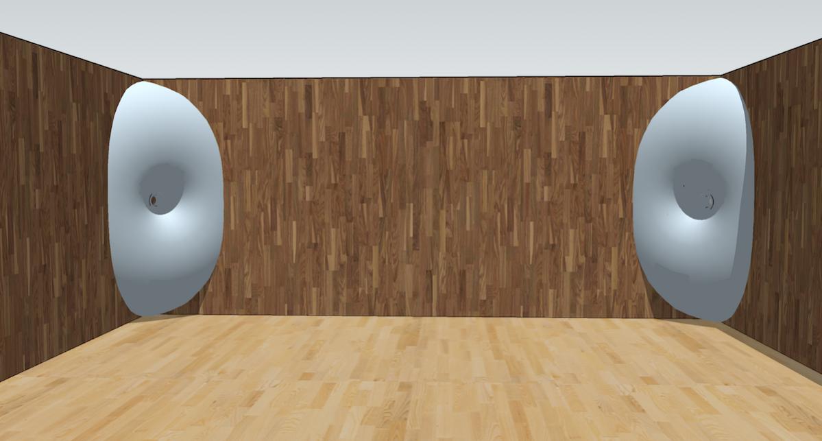

Lots of good discussion. I already have a setup similar to PB with MEH in the corners , wide spaced, imaging is excellent once equalized (attached). One of the 'different' aspects of my setup is that the horns are closer to standing height than sitting and are angled down. This cuts down on ceiling reflections and means I can stand or sit, still getting highs.
One of the ideas I had was a horn pushed back into the corner with asymmetrical vertical coverage as angling down would no longer be needed. The horn would be located at head height and would have something like 90h -40/+10V. This seems similar to a tri corner so could something with done with OS profile for this?

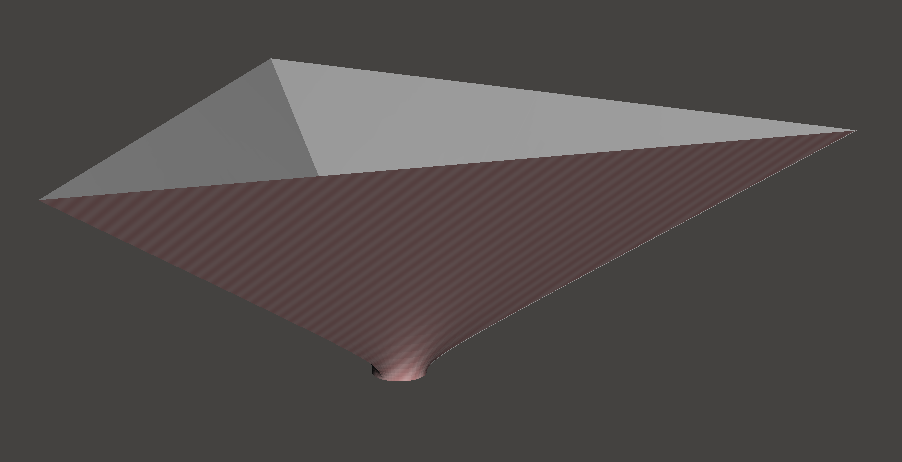

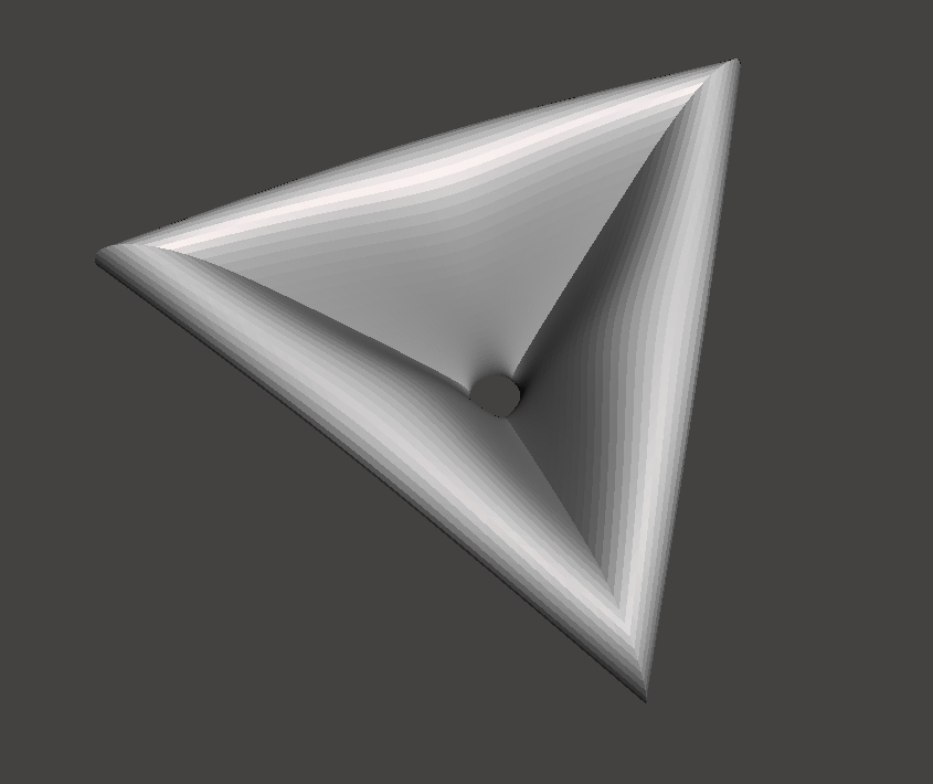

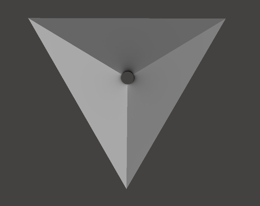

I'm not sure I understand the "3-corner" thing - is it supposed to be this?
(I've just implemented a guiding curve defined as a polygon set by user defined vertices - triangle in this case.)
Yes, I think this is what earl was meaning. An OS profile version.
It wouldn't apply to my situation, but it's interesting as assuming each of the walls are sufficiently long, it should make for the most predictable and repeatable results 'in home'.
When you say the 4 sided option has been shown not to work so well, can you give more details?
And of course a throat adapter for a big 4-sided horn could be made. I only think we saw earlier that such a waveguide would not have a particularly stellar performance.

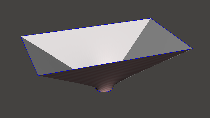

Is there a possibility to try and simulate a mouth flare? I'm thinking making such horn out of plywood with the straight section as in the model but the side panels would be cut a bit longer and then bent (google kerf bending) to form some sort of mouth flare /rollback. It would save many hours of trial and error if it was possible to try with ABEC first 🙂 thanks a lot!

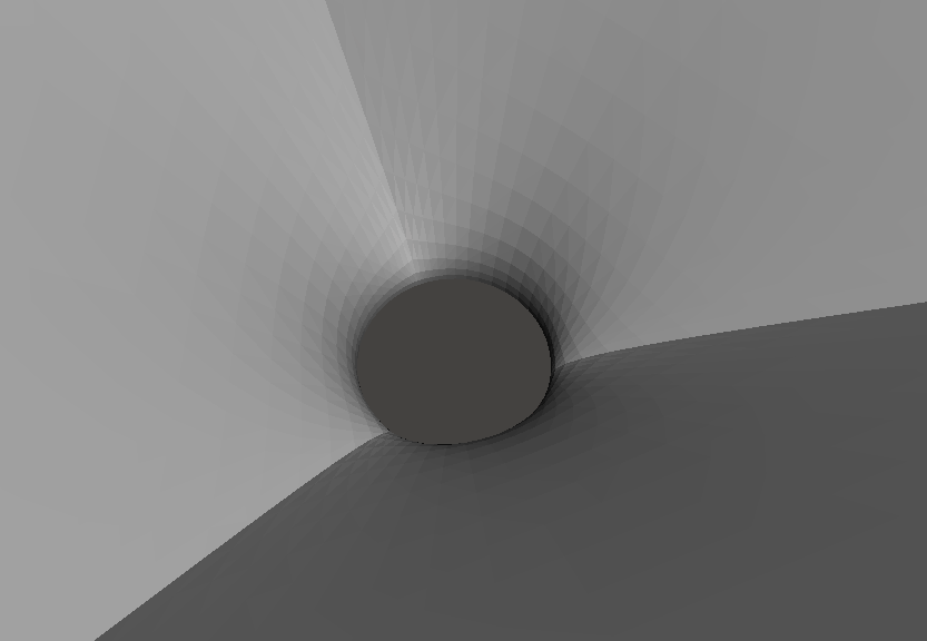

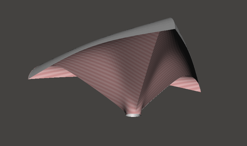

Yep that kind of thing, a small driver like a BMS 5530nd could help get as close into the corner: Overview
Unless we are prepared to cut into the wall to locate the driver, then getting closer to the corner creates a headache at the mouth transition. At least at these higher frequencies..Not that it make any sense, but anyway - rolled-back 🙂
