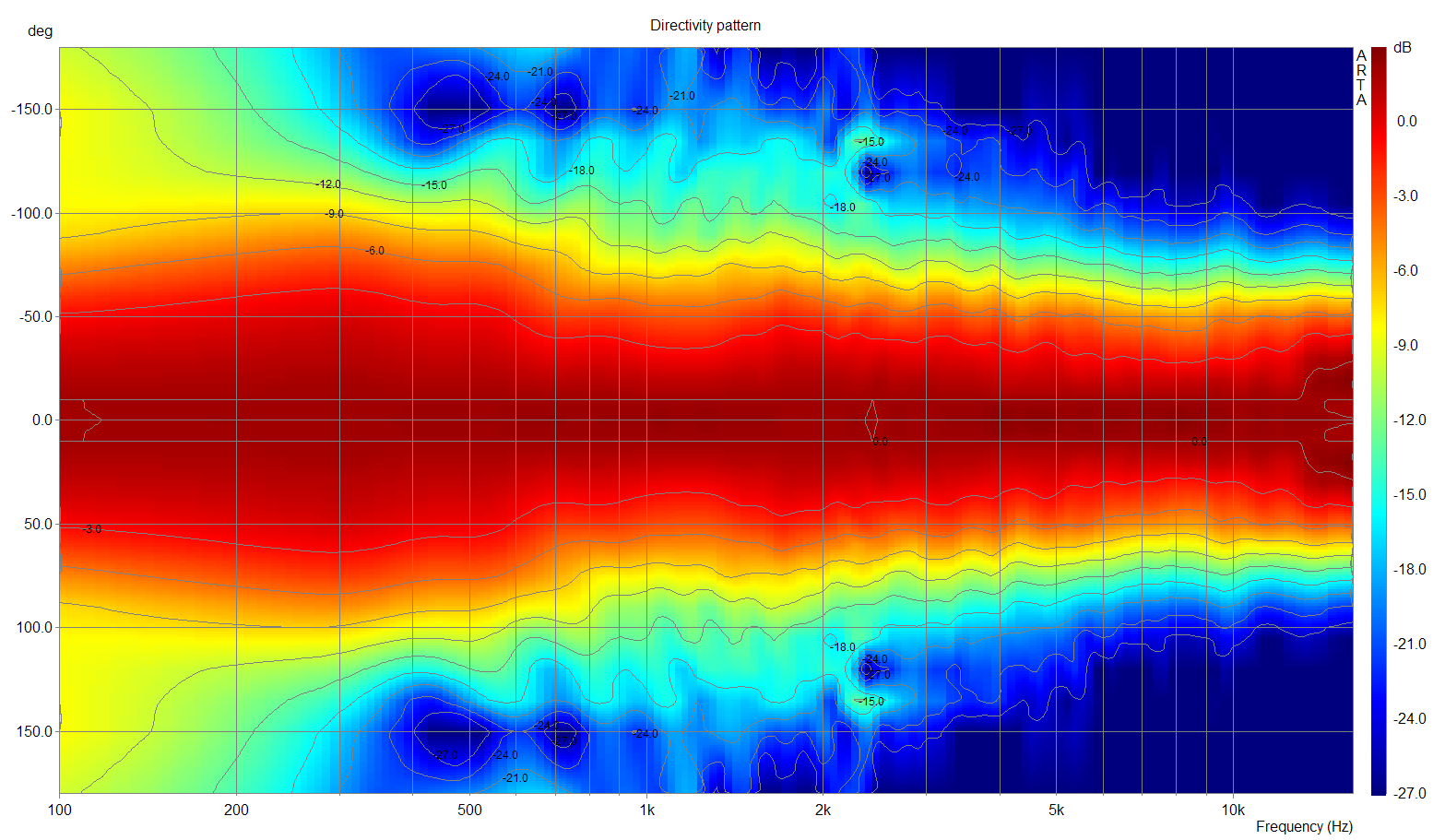

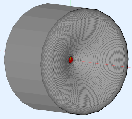

Back in July, I posted a graph showing measured data vs simulated infinite baffle data. Today I did another simulation with the cabinet modeled as a cylinder (so I could use the CircSym mode) with the same depth as the real cabinet:
The grey curves are simulated, 0° to 80° in 10° intervals while the colorful curves are the real measurements at the same angles.

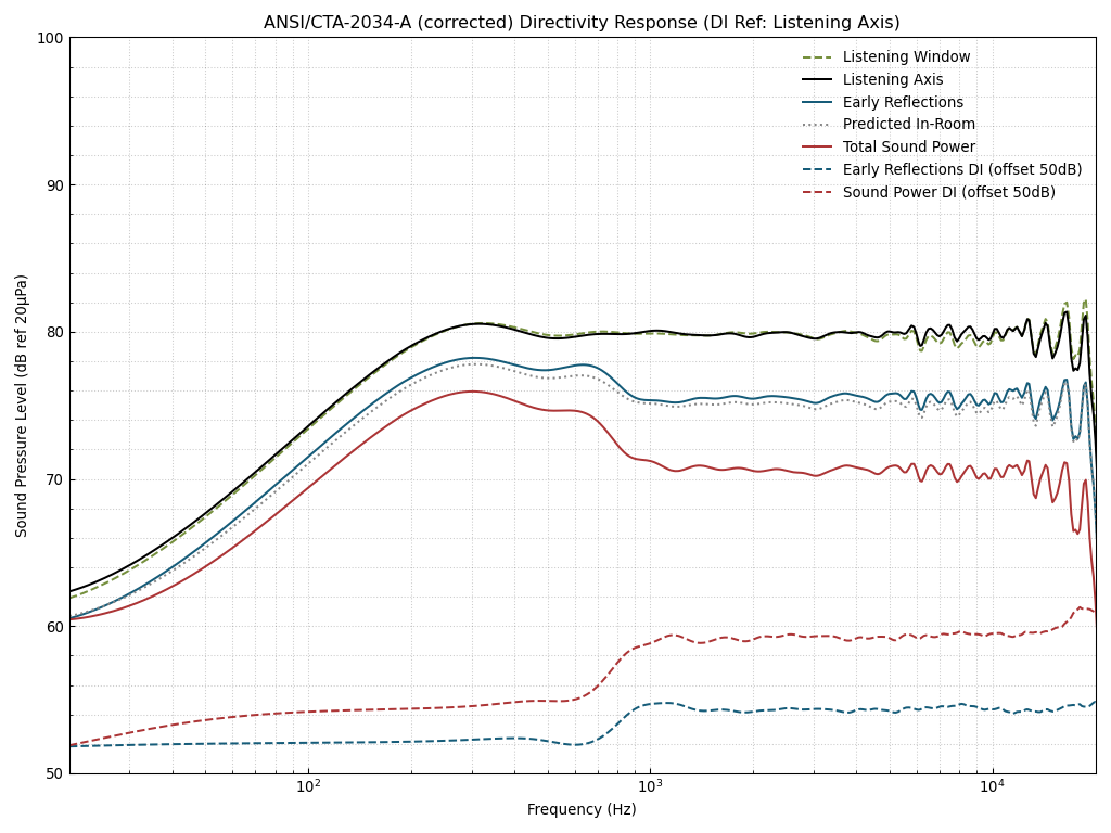

Edit: Oh, and here's a ANSI/CTA-2034-A plot (short gate, so ignore the low frequencies):

bmc0, the throat isn't true OS, is it?
From the throat entrance to 40% of the total depth, the profile is pure OS. The remaining 60% is a section of a clothoid (Euler spiral). Curvature is matched at the junction.

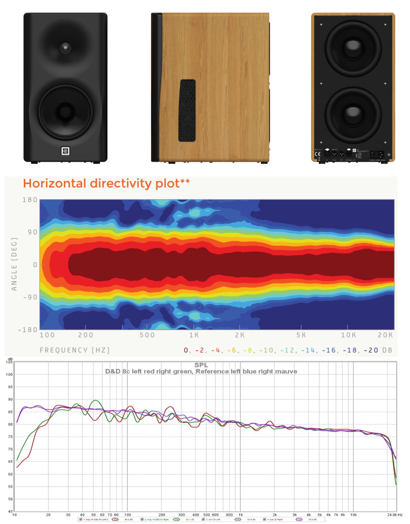

Thanks for the articles. The next time I do a big speaker project (which is not going to happen for a while), I think I might try to do a cardioid or supercardioid midbass section.
The cardioid concept is very interesting indeed.

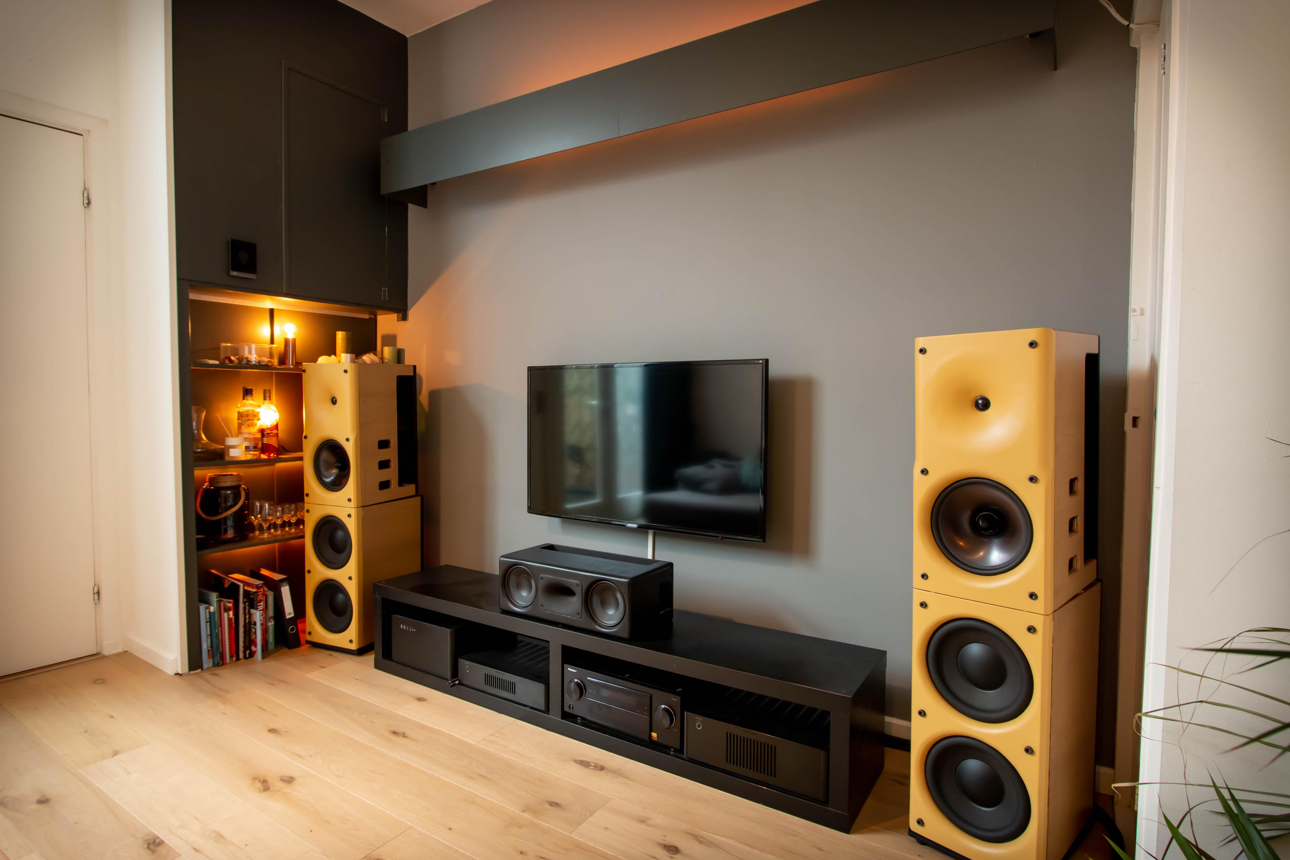

Martijn (Mensink, of Dutch&Dutch) has definitely put one of the best loudspeaker systems onto the market.
Mitch Barnett's review of the 8C is worth reading.
Here's the thread of the project shown above.
My intuitive caveat with such cardioid systems concerns the number of drivers required for the concept to work properly and the loss of sensitivity.

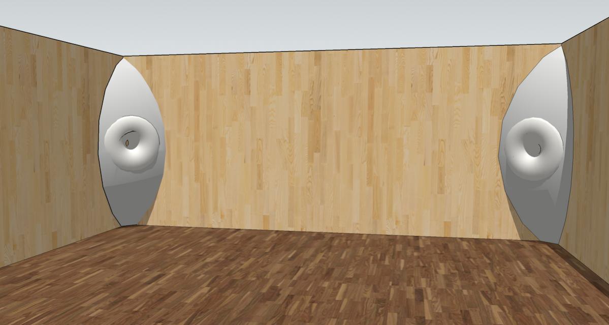

It seems more effective and easier to tackle the backwave by integrating the complete system into the room. This is difficult to realize in the room above (attached pic.), due to the cavity in the front wall.
A quote:
"Proper flush mounting means no front wall reflection… and that means no speaker boundary interference from your front wall!
Your speakers and wall sing in harmony. Also, flush mounting increases acoustical loading which helps drive your monitors, making them more efficient at low frequencies. It really is that awesome."
Going one step further means turning the room into a horn (system).
A quote:

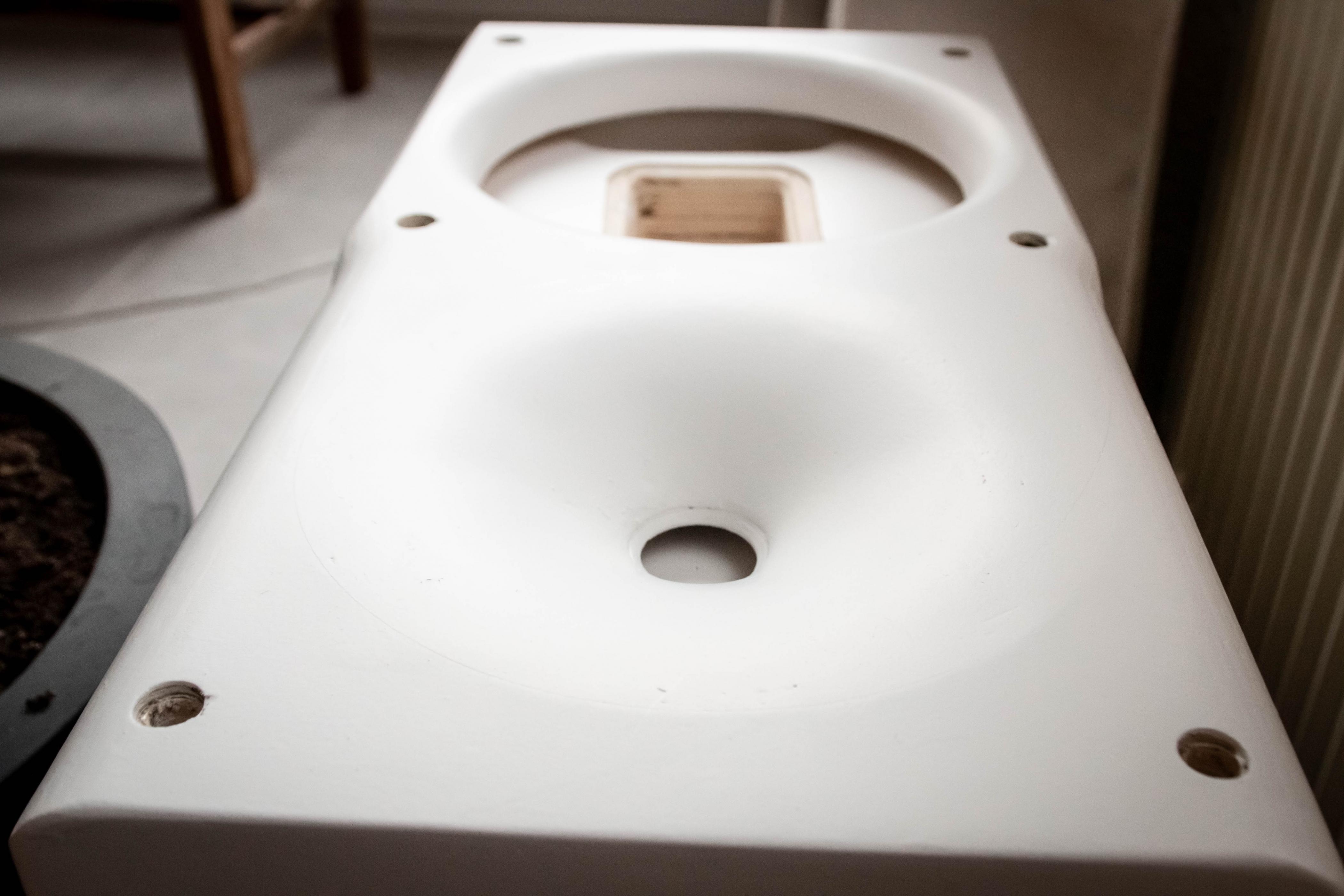

Jag768's project is actually one of the things that convinced me that using plaster for the waveguide was a reasonable idea.

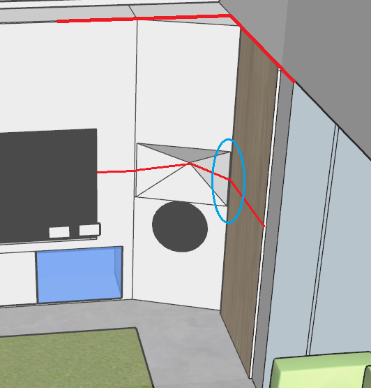

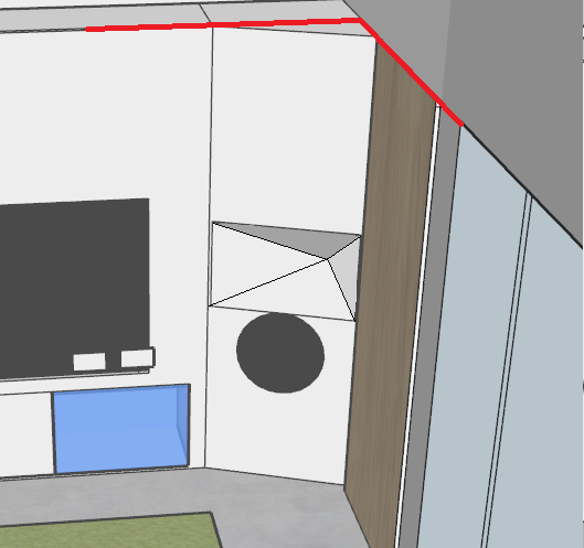

I think this can be tricky to get right. My concern would be the mismatch of the side wall angle:
What I can imagine as a remedy would be this but I have no idea what other consequences it could have:
Of course the top and the bottom mouth edge would have to be rounded as much as feasible, but I'm afraid it's not possible to generate a waveguide like this with Ath at the moment, at least not directly. Or is it? Honestly I'm not sure.
