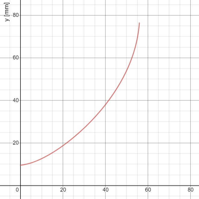

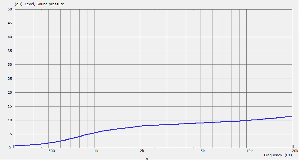

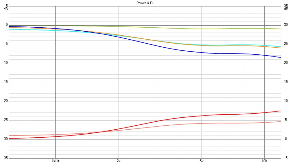

I've made a Vituix DI calculation from an IB ABEC sim of an axisymmetric guide (based on my attempt at reverse engineering a curve similar to the one mabat showed in the DE7 guide). It's not as well optimised but the general smoothness is there. The early reflections DI is really quite flat but not particularly high, standard DI is gradually rising.

I've made a Vituix DI calculation from an IB ABEC sim of an axisymmetric guide (based on my attempt at reverse engineering a curve similar to the one mabat showed in the DE7 guide). ...
This should be done for free field conditions because this is what the waveguide was really designed for - it will have a higher DI at lower frequencies when free standing than in the infinite baffle, so the rise will be even more gradual (I would say considerably).
I'll try to implement the DI calculation directly into the sims/VACS and show you.
Yes of course, I was aiming for a freestanding guide but the rollback didn't work the way I thought it would so it made getting a similar curve via Ath much less predictable (which you mention in the instructions). The above solved in 13 seconds and I thought still looked pretty good for a 6" guide.
That would be great, I find the translation of Nils document to English through Google difficult to understand.

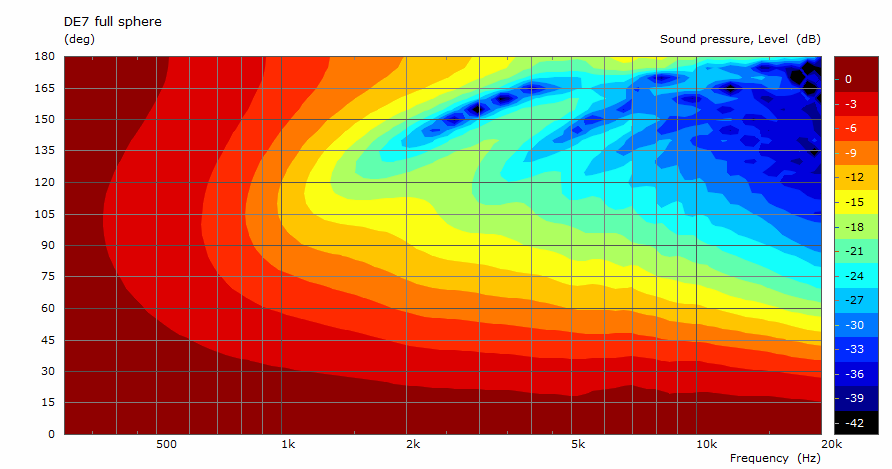

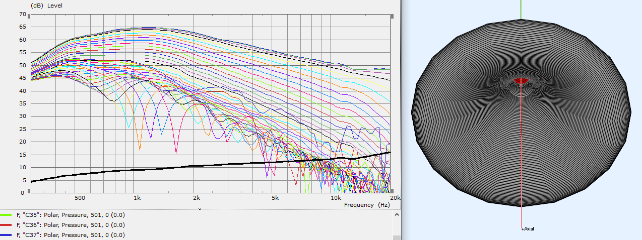

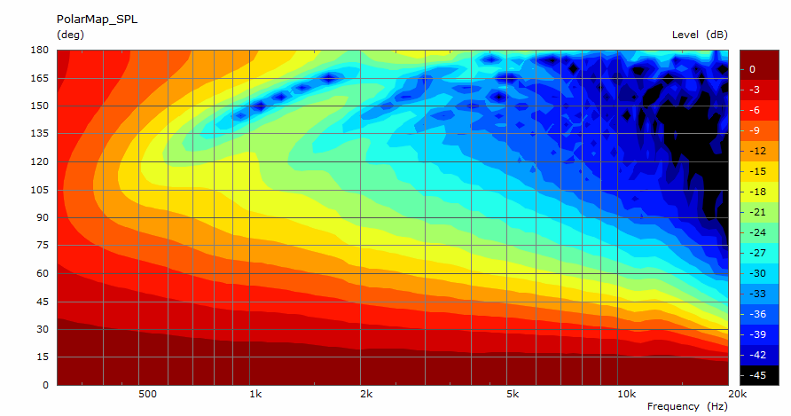

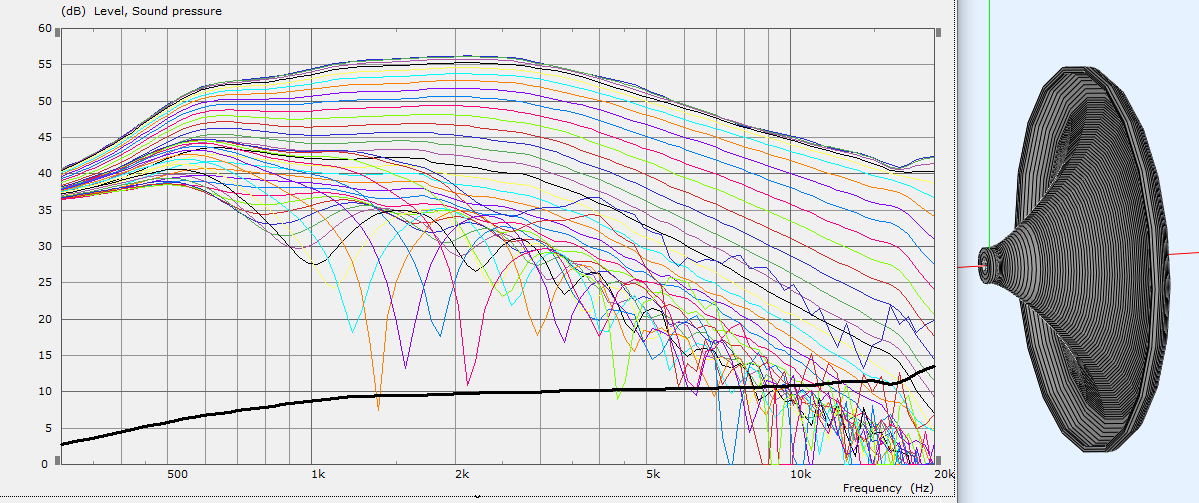

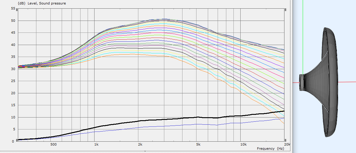

Here we go - the small "DE7" waveguide (7.7"), DI for the axial response. The black DI curve is full space (i.e. the real DI), the blue curve for the front hemisphere only (just for comparison). In the bode plot only polars up to 90 deg are shown.
attachment.php
Polar map normalized to 0 deg.
attachment.php

Mabat, I just want to tell you that i agree that the development of some target/evaluation criteria is really the frontier of the field as the waveguide modelling software has now become sufficiently advanced. It is important that the underlying theortical discussion does not get lost among the practical implimentation challenges, such as direct DI curve integration.
A point to the subject of slightly increasing DI versus flat flat DI; is there any wheighting of angular measurements as they represent an increasinly larger area on the "measuremt hemisphere"? That is a factor that really accelerates the importance of what might seem like subtle response curve differences in the plots. Especially with the quite axisymmetric fairly wide beamwidth devices (90 ish degree) most if us are interested in.
I belive mr Geddes has done some work on this.
The more i think about this topic the more significant it seems.
#4093 does the whole sphere - right? Now if you are bored and have nothing to do 🙂 - could you just keep the rollover rolling to close the "ball"? That would I think be interesting to see. I would assume that the driver would fit inside such an extension... but I can really see why you wouldn't bother.
