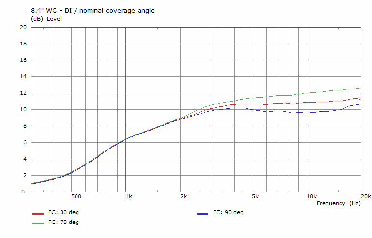

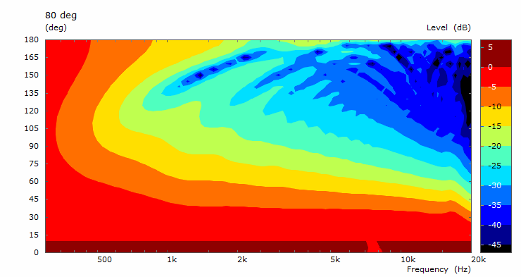

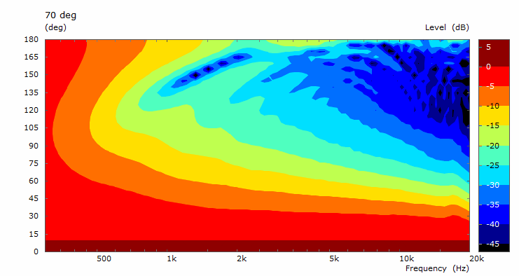

I thought about the error function criteria for the optimization algorithm a bit. Maybe I would define a target DI curve and evaluate the error function as the residual sum of squares between the target and an average DI curve calculated for a selected listening window (not necessarily containing the on-axis response). Maybe this all weighted with frequency somehow.
What i really notet was the "selected listening window". Perhaps you could elaborate?
Some thoughts: Clearly one wants the optimization to be weighted towards the listening window (in terms of smoothness i supose) but a hard limit can't be good can it? I worry if the optimization might just push response problems outside of this window if made too narrow.
I might be out of my depth on this topic, but i think the optimization is a powerfull tool with many interesting variables and just wanted to incourage further investigation.
- could you just keep the rollover rolling to close the "ball"? That would I think be interesting to see.

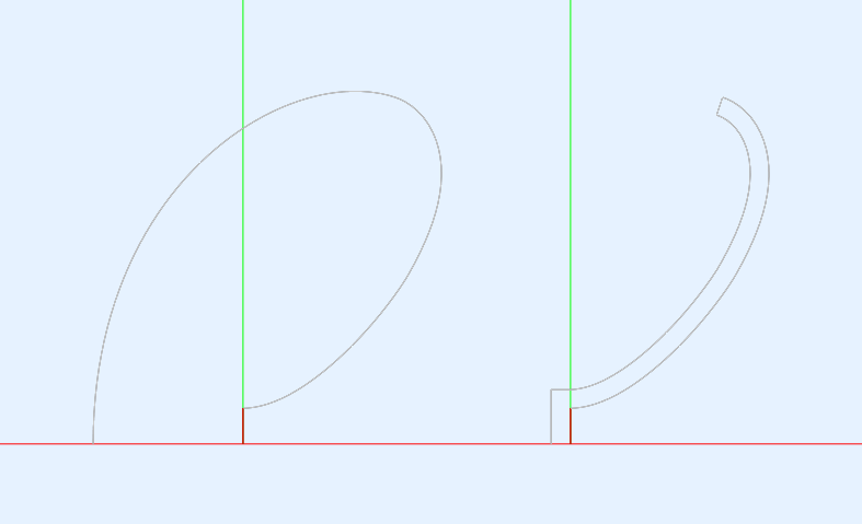

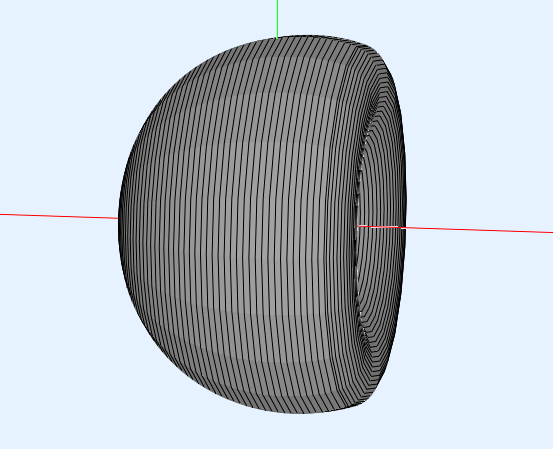

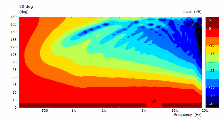

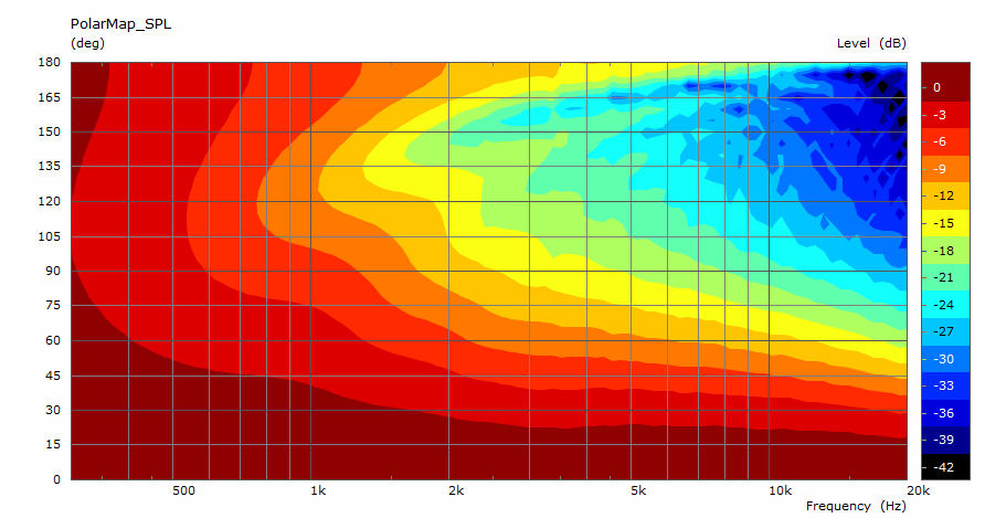

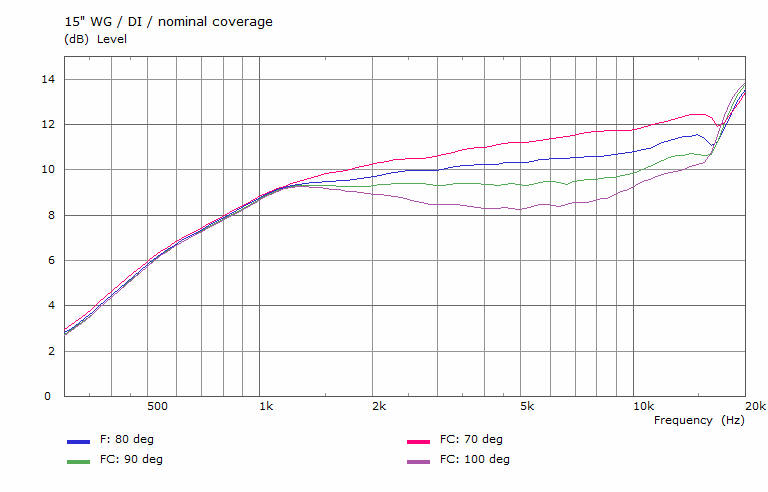

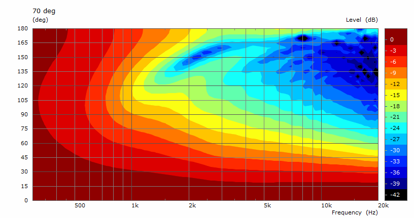

The raw shape "DE7" (just added thickness):
attachment.php

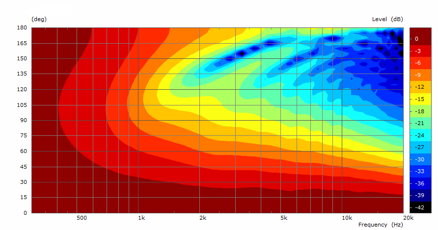

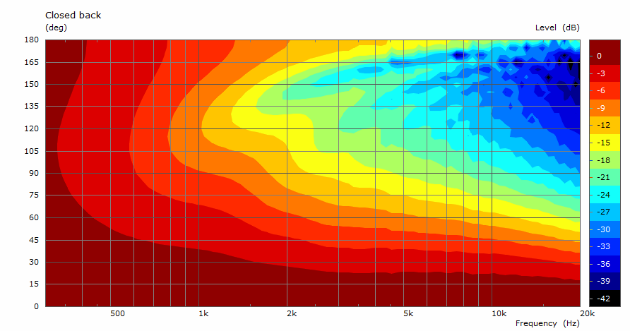

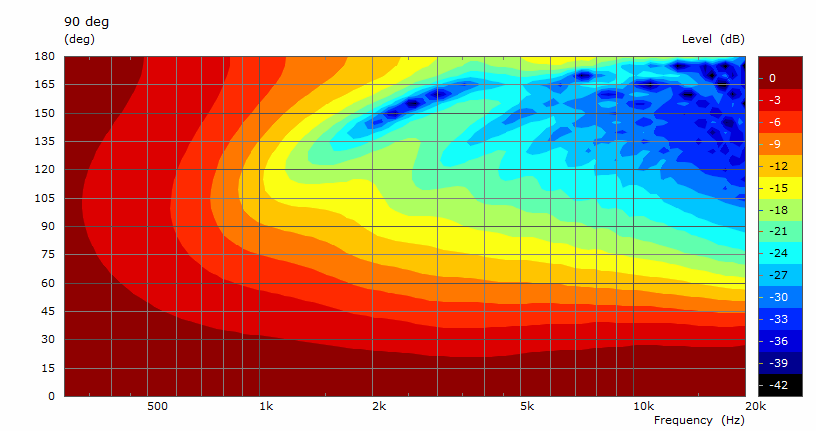

Closed-back:
attachment.php

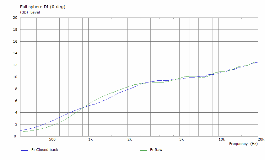

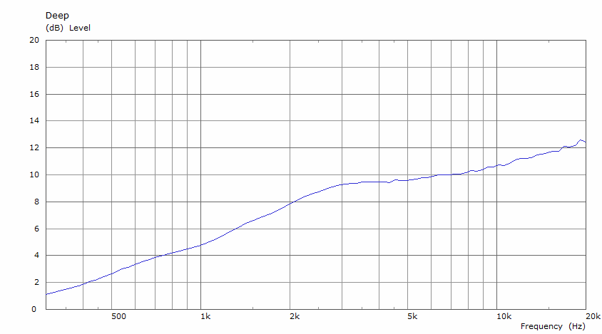

Differences between the axial DIs:
attachment.php
It's hard to foresee all that could happen but once you reach a target of a flat and smooth DI, you can be sure that the direct sound (being it a selected angle or some average over a listening window) will track the power response closely, i.e. it will be possible to EQ for a flat and smooth overall response in the end. That's the rationale behind that.
