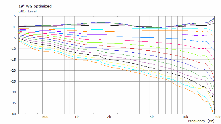

That was to illustrate my point that you really have to start curving the profile to improve the results, with which you seemed to not agree. Then when I do optimize, for any situation, you don't like it...
The 19" optimized (a bit) -

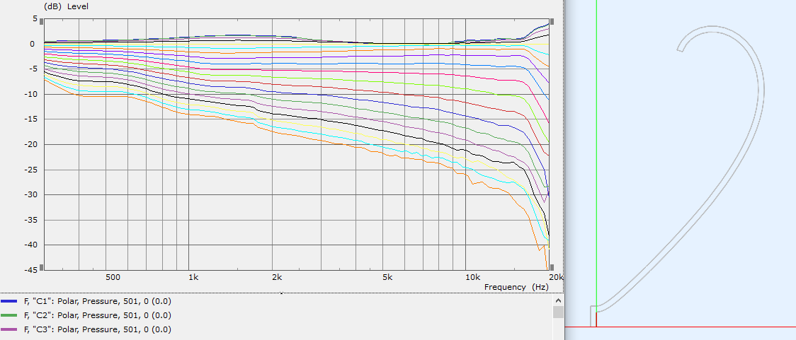

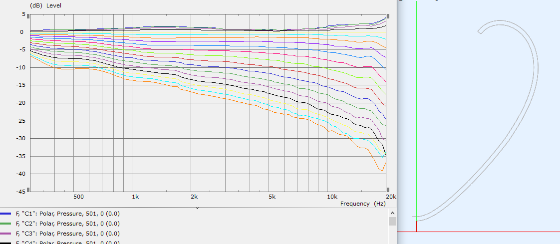

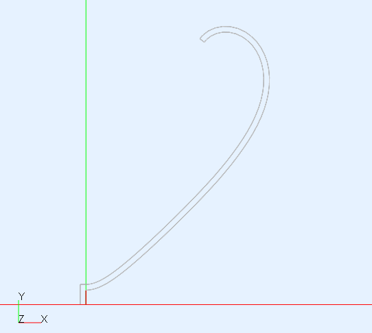

The 19" optimized a little further. Is this good enough? Probably yes.
attachment.php
A slight touch correcting the widening centered around 6 kHz and making the highest octave a bit more even. Is is worth it? I don't know but I would take this one.
(It has also a somewhat better loading ;) )
attachment.php

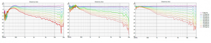

Could you point out the differences in the attached picture? I'm really failing to see them. Maybe 15 kHz is too high, so lets say it is 12 kHz - that's still pretty good, IMHO.
- Or maybe there's a misconception here as I'm not sure what you meant by these differences. To clear that up - the simulations predict radiation patterns, i.e. what is on the attached picture. Absolute value of radiated power as a function of frequency is really not relevant for the analysis. Different drivers can differ a lot in that respect but the radiation pattern stays virtually the same, as you can see. That's what we are interested in here.
The reason why the driver doesn't really matter for the radiation pattern is of course because it is too small to have an effect - the exit wavefronts are too simple to drive the waveguide in a more complicated manner. It will have an effect as the wavelengths get comparable with the throat diameter as the higher order modes come into play but below that it's basically all the same.
You seem to misunderstand me. I have always known that a more gradual transition to the mouth flare would reduce axial diffraction issues - it's clearly obvious. Your software has proven that to be the case, so I am in complete agreement on this point.
But you seem to be saying that a rising DI is an unavoidable consequence of doing the above and I don't see why that would be nor do I believe that you have proven this point. I also think that people discount the importance of a higher and flatter DI, which, if it is an inevitable tradeoff to mouth diffraction reduction, should be compromised for the flatter axial response. This is my point of contention NOT that smoother mouth flare curves are not effective.
This is indeed what I say because this is what I find out every time I try - I have yet to see a device you speak of. I don't know if or how that could be proved but definitely it would be disproved by finding a counter-example. Do you know of any? If you drew a profile I could easily test it. So what would be your best bet? I'm out of luck.

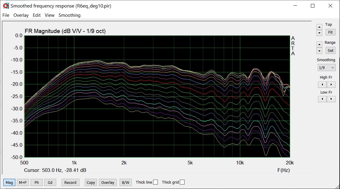

I'm not sure ARTA can do it directly but if you export the polars to text files you could import them e.g. to VituixCad - there you can normalize them to any angle you want (I think). The mic response is irrelevant - both the frequency response of the driver and mic response are put out of picture by normalization - what remains is really the "response" of the waveguide alone.
It looks pretty good, BTW! I don't think it is even necessary to compare it with the simulation. And it's obvious the DI will rise slightly.
With some DSP you could make virtually a flat response out of this. What a marvelous loudspeaker this would (will?) be.
I've just asked in the ARTA thread how to do this. Thanks for the tip about VituixCad. I'll have a go.
