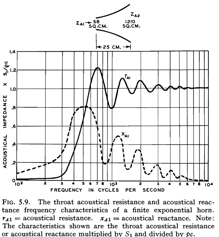

Here's an example of a truncated expo horn of 25cm length.
This ao. explains why some people have used the JBL 2380 from <500Hz.
We're going in circles, I guess. Did you see the throat impedance of JBL 2380?This explains why some people have used the JBL 2380 from <500Hz.
You can use any finite horn how low you want, provided the driver can handle it in the particular conditions. You don't even have to think about "loading" at all...

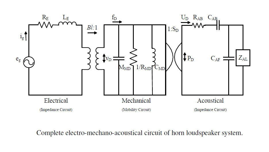

Found this. I read it and liked that it was not only math... wanted to understand a bit more of the impedance aspects...
https://www.grc.com/acoustics/an-introduction-to-horn-theory.pdf

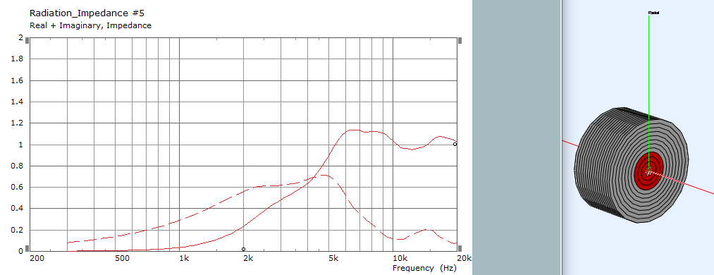

This is the impedance of the HF1440 mounted on FaitalPRO's LTH142 Horn:
Considering the LTH142 is a fairly small Tractrix horn, the naked driver can probably used from around 1000Hz. This is consistent with Legis' findings.

FYI, this could be the "throat impedance" in this case. Maybe you would like to adjust your estimate based on that now 😉...Considering the LTH142 is a fairly small Tractrix horn, the naked driver can probably used from around 1000Hz.
I mean, this curve alone is not really telling you much.
The radiation impedance doesn't matter much in the end.
Look at your typical direct radiating woofer. They're making all their spl through sheer brute force displacement and very low efficiency at the bottom of their range. This is the reality of small radiators vs. relatively large wavelengths.
Wouldn't get hung up on that unless you plan to do the same for the rest of the system. Luckily prosound drivers in home settings can make you deaf without any effort.
