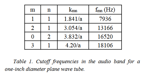

So, if I understand it right, for a 1" PWT there are only four higher order modes that propagate down the tube in the 20 kHz audio band: mn = 11, 21, 02, 31 (and only one of them, 02, being axisymmetric). That means if we don't capture also some of the evanescent modes, all we have for reconstructing the shape of the source wavefront are only those four mode shapes. Hmm, that would be a somewhat crude approximation, wouldn't it.
I tried to calculate the actual decay rate for the first evanescent axi-mode (m=0, n=3) and if I have it correct it would be -45 dBSPL each 10 mm at 10 kHz (-36 dB/10 mm at 20 kHz). Could that be? That's undetectable even at the closest mic position, I'm afraid...
Actually there are three modes (0,0), (0,1), and (0,2). These should certainly be enough to get a description of the shape that is relevant below 20 kHz. The evanescent modes do decay very fast at HFs, but yet in many applications these evanescent modes have been used to give useful information, but perhaps not in this case.
The cut-off of (0,2) (i.e. for kr*a = 7; they start counting n from 1 in the above article) is around 30 kHz, so there is only the planar mode and one non-planar that propagate reasonably far enough (the higher the frequency, the slower the decay). I will definitely try it but based on these number I'm starting to be a bit sceptical.

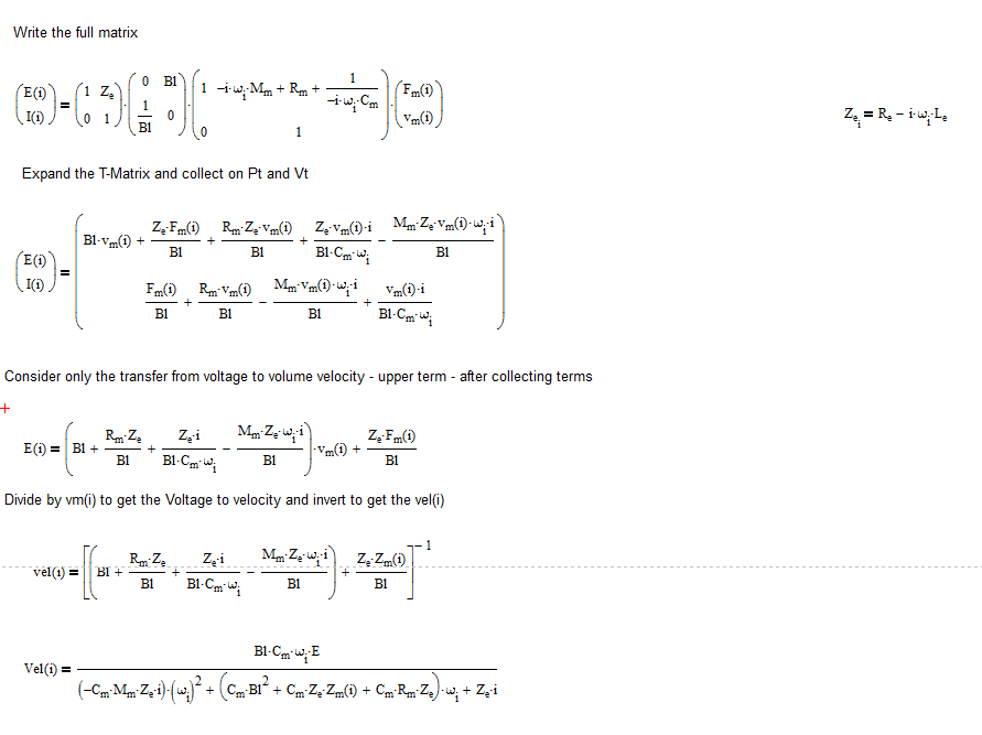

In the simulations I'd like to incorporate a very basic model of a compression driver driven by voltage instead of the constant acceleration boundary elements used so far. Would be someone willing to help me to assemble a lumped element model for this purpose? Basically all I'm interested in is the diaphragm excursion.
This is precisely the work that I am doing right now for a client. I have an accurate model in MathCad if you can use that, or I can show you with equations how it's done. Your choice.

- As for the mode indices, I think there's a typo in that article. Anyway, only two axisymmetric modes propagate: (0,0) and (0,1). The mode (0,2) decays already very fast.

See if this helps:
The attached will yield the displacement in a vacuum. If you want a loaded diaphragm then you need to add in the matrices on the right that represent the acoustics. It's not too hard to assume that the load Za is simply Rho-C which is pretty accurate. The real displacement will be 10-20% lower than the vacuum values.
Zm is the total mechanical Z as shown as the upper right element of the diaphragm matrix. "i" is just an index that equates to frequency.
PS. This portion of the model does not contain the compression ratio. That appears as a transformer from the acoustical device to the mechanical diaphragm and increases the Z of the acoustic waveguide device as seen by the diaphragm. I can show you how to do that if you need it.
Thanks, I'll have to go through this very slowly... 😱 Right now I don't have a clue what does that all mean. I admire this.

The basic premise of those equations is that every domain, electric (on left), mechanical (middle) and then acoustical (not shown) all have two conjugate variables that are linked via transform matrices. So we have Voltage (E), current (I) in the electric domain, then a Bl transform to the mechanical where we have force (F) and Velocity (v). If the acoustical domain were present then it would be Pressure (P) and Volume Velocity (U) and the coupling would be a matrix of area ratios. My book shows all this in detail.
