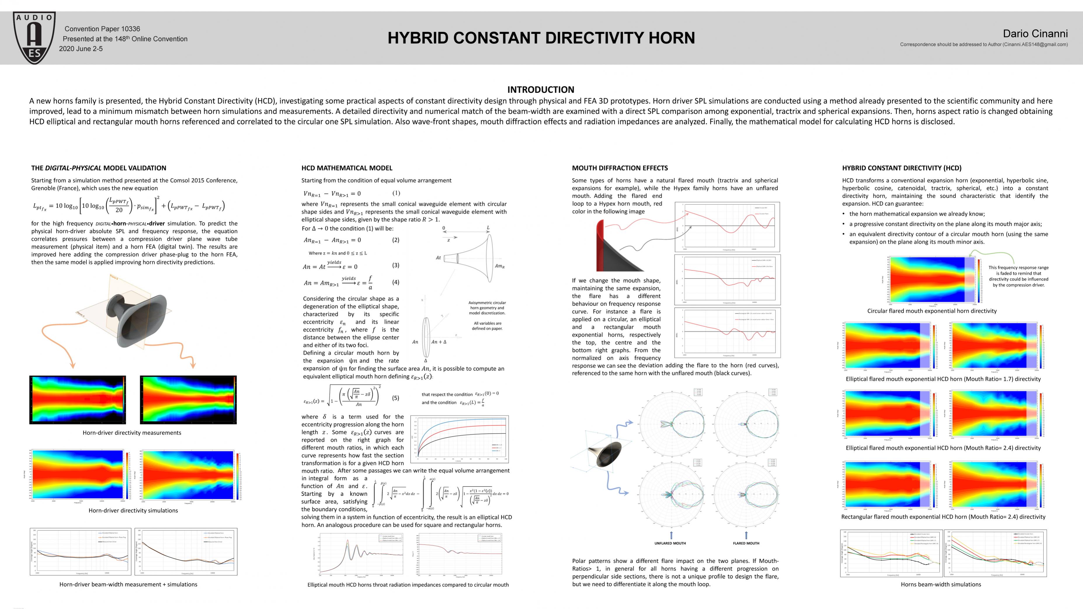

Far more interesting than B&C's ME464 imo, is this horn concept.
Although it's not better than what's possible with ATH4.
Is he the same guy behind this horn?
Ciare PR614 - Ciare PR614 is a 1.4 inch cast aluminum horn. Ciare PR614 has a 60 x 40 dispersion. Ciare PR614 is a new generation v-shaped horn
Seems like the same few people design for all the Italian brands.
Indeed, it is Dario Cinanni.
Just as handsome as yours truly, but in addition also blessed with beta talent.
AudioExpress article:
