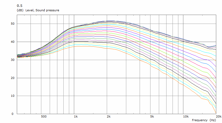

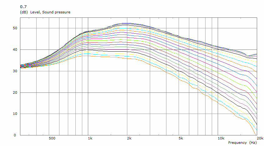

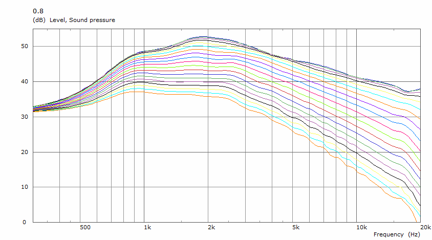

OK, this is fun.

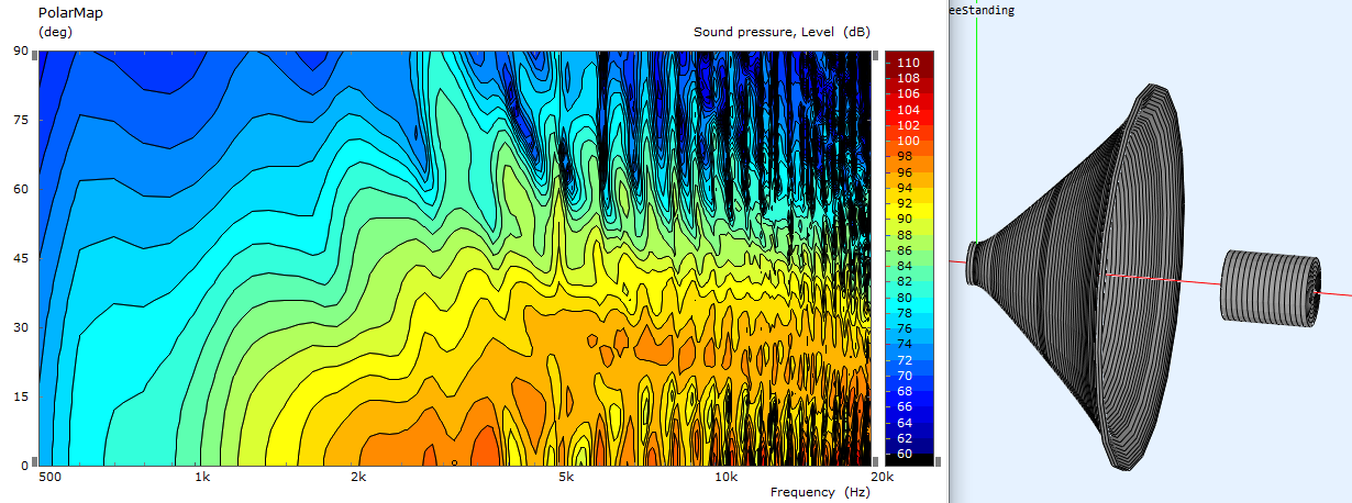

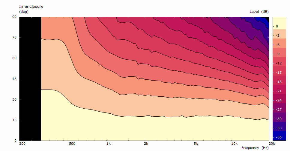

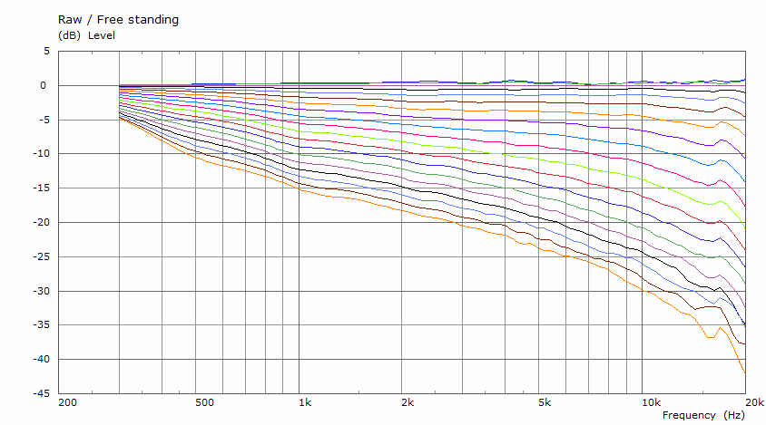

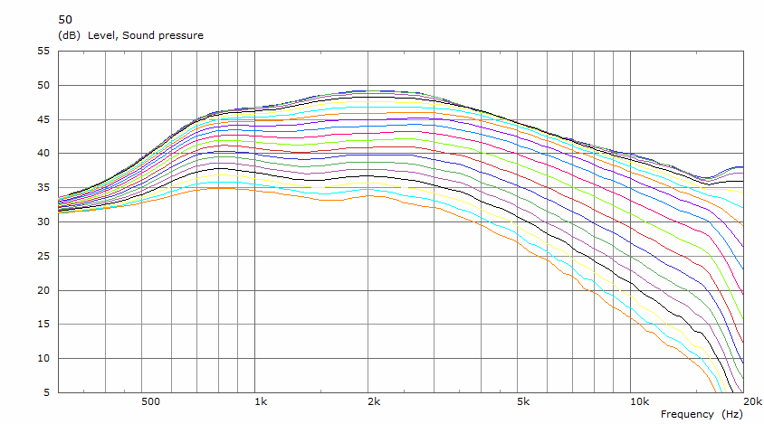

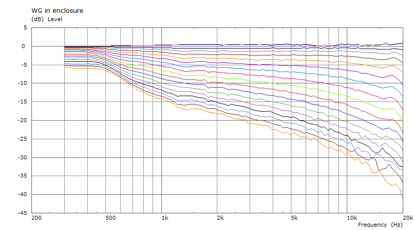

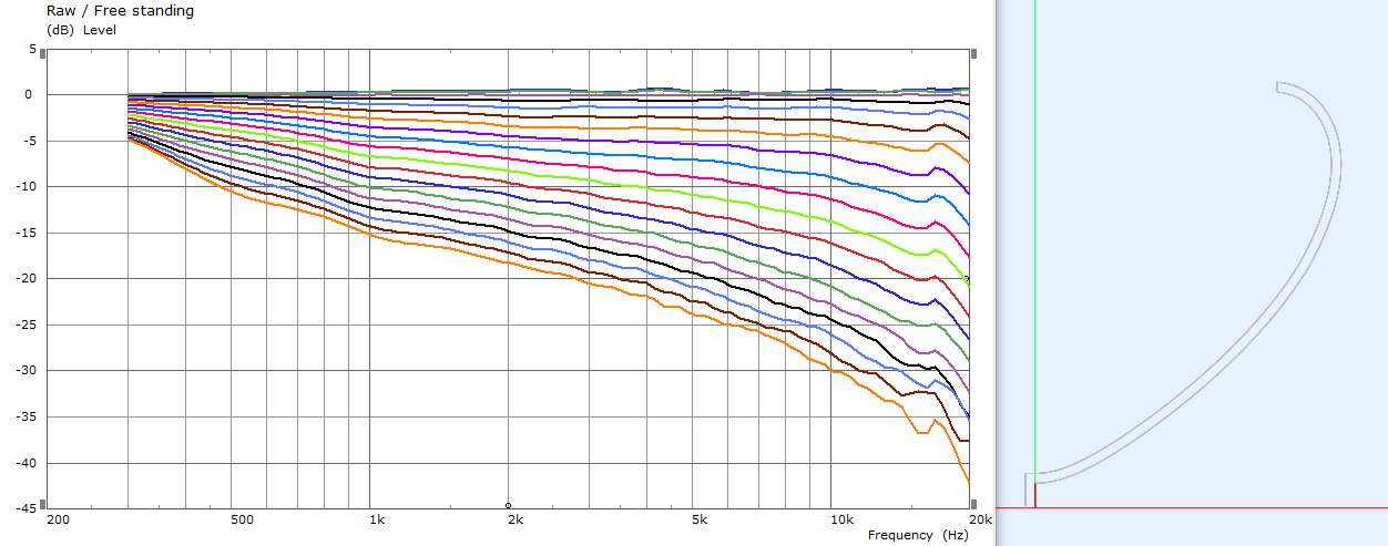

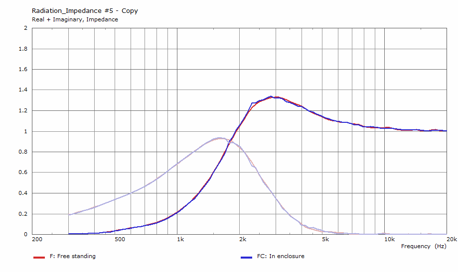

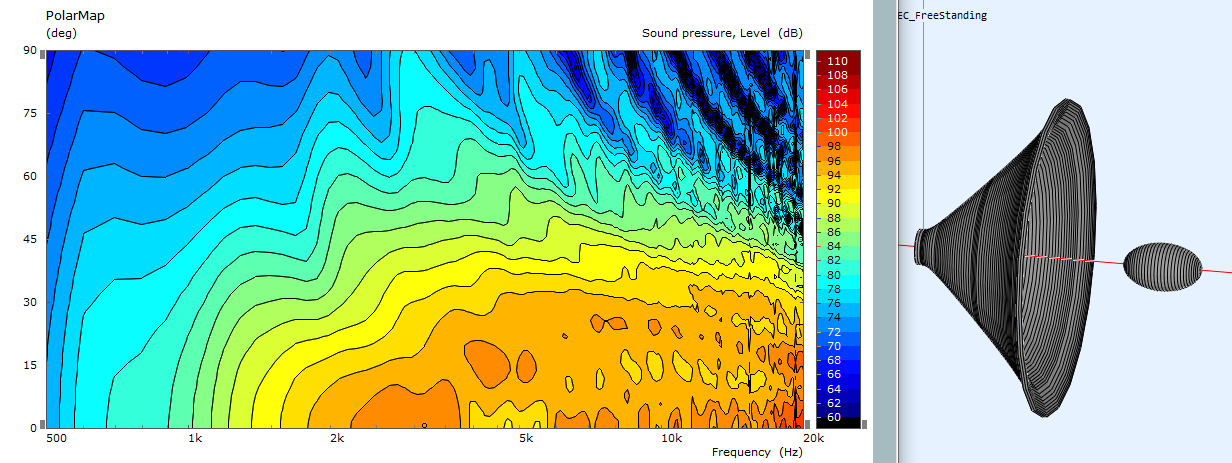

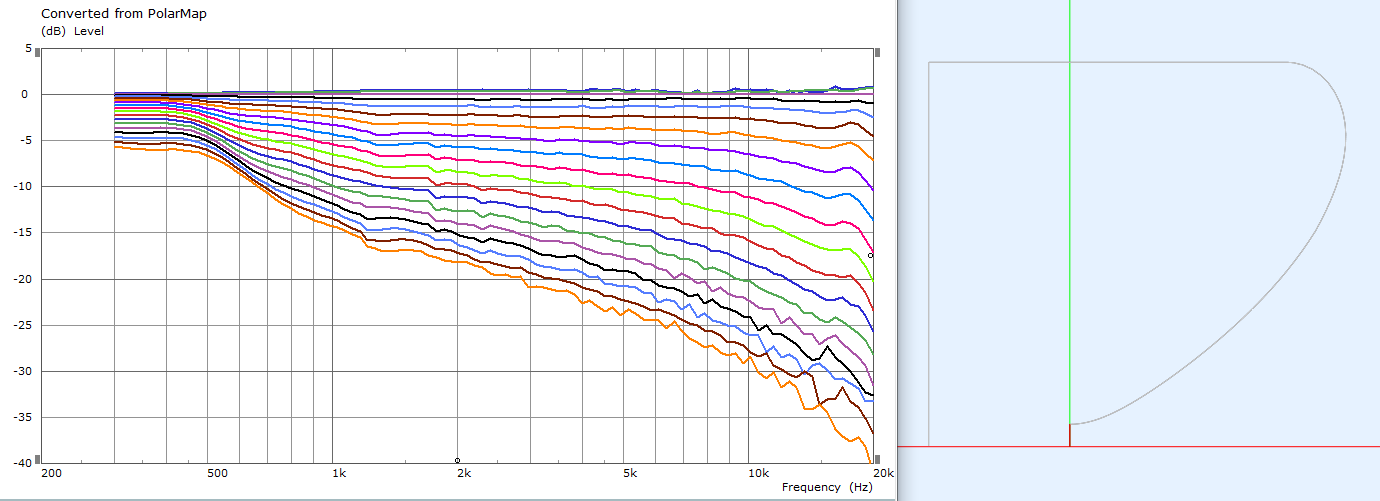

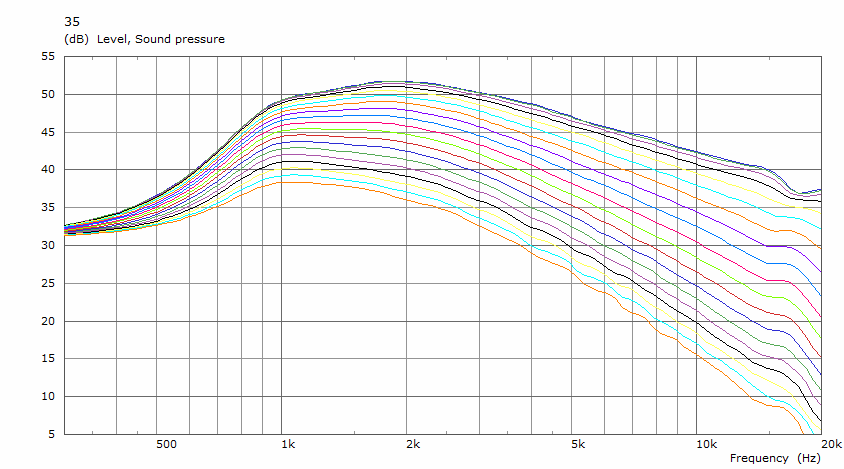

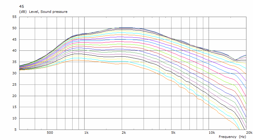

This also might interest some of you - the influence of an enclosure on the polar response:
Axisymmetric free standing waveguide, ⌀436 x 170 mm, 1" throat:
attachment.php
The same waveguide in a cylindrical enclosure:
attachment.php

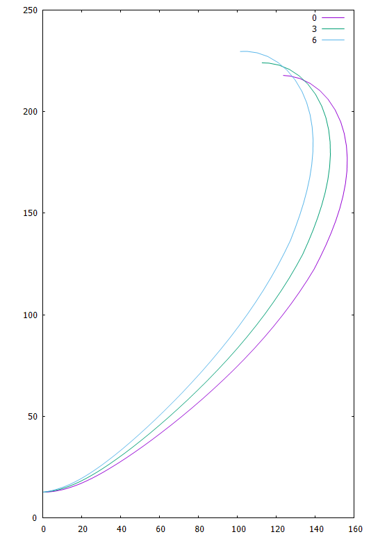

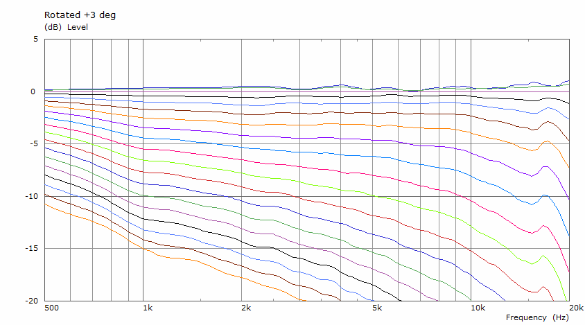

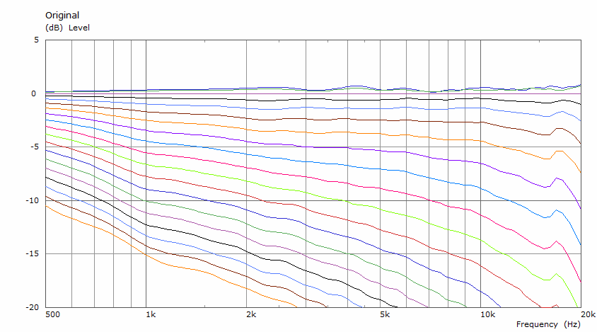

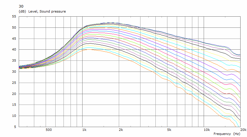

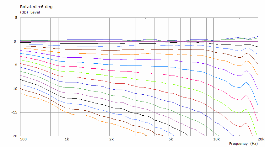

What is interesting is that the last tiny bit of perfection is possible to add by rotating the whole profile a little (this was done without changing the source, i.e. this is still for a flat wavefront). I wonder if this would be the better way of setting the throat opening angle after all.
Original waveguide:
attachment.php
Profile rotated +3 deg:
attachment.php
Profile rorated +6 deg:
attachment.php
I don't quite follow what you did above.

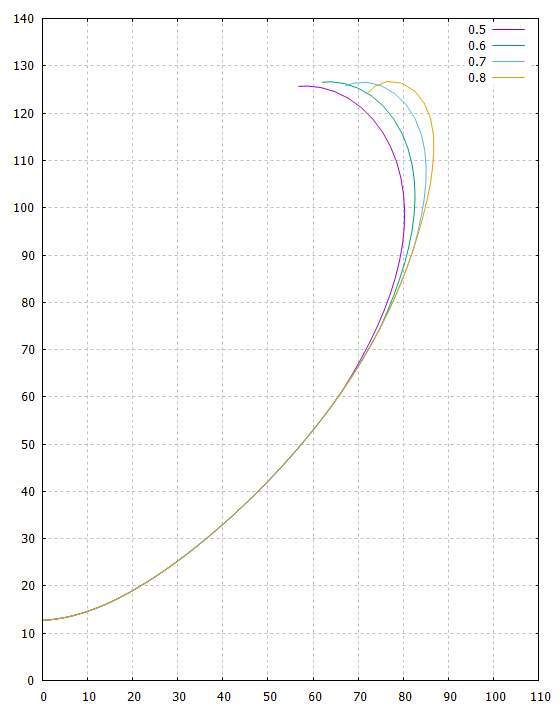

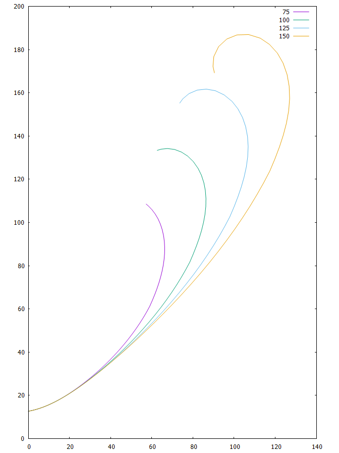

Another problem that has always interested me is how much a radius on the rear "can" makes.
I was surprised with the wiggles in the FR and impedance as well with the extended roundover - I would have thought the opposite i.e. even smoother transition. But there was some gains in the top (also a bit surprising). Seems to earn some more attention.

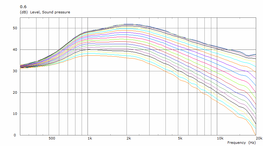

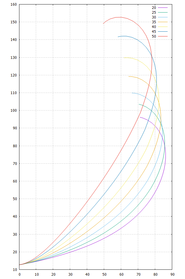

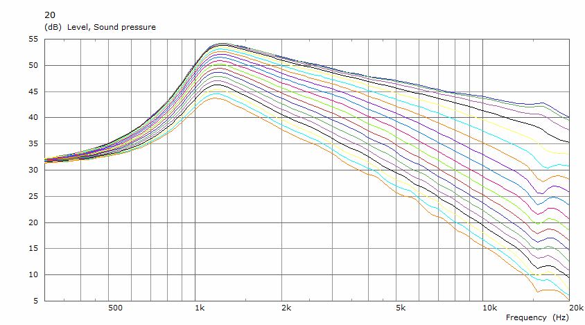

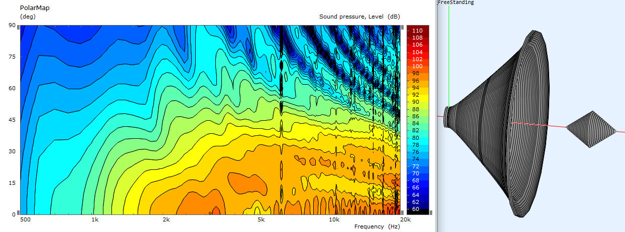

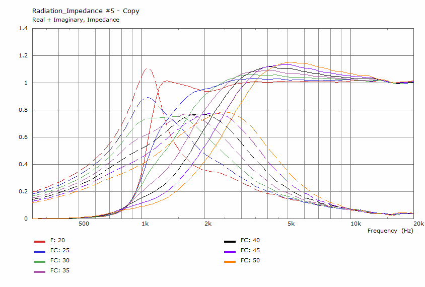

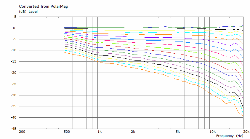

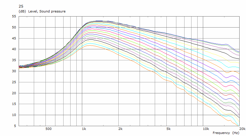

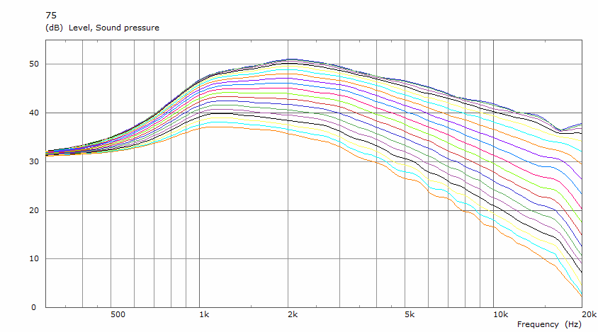

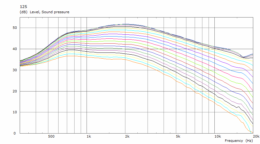

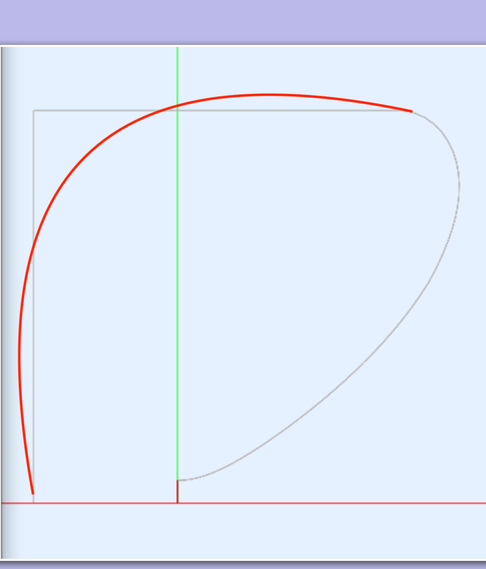

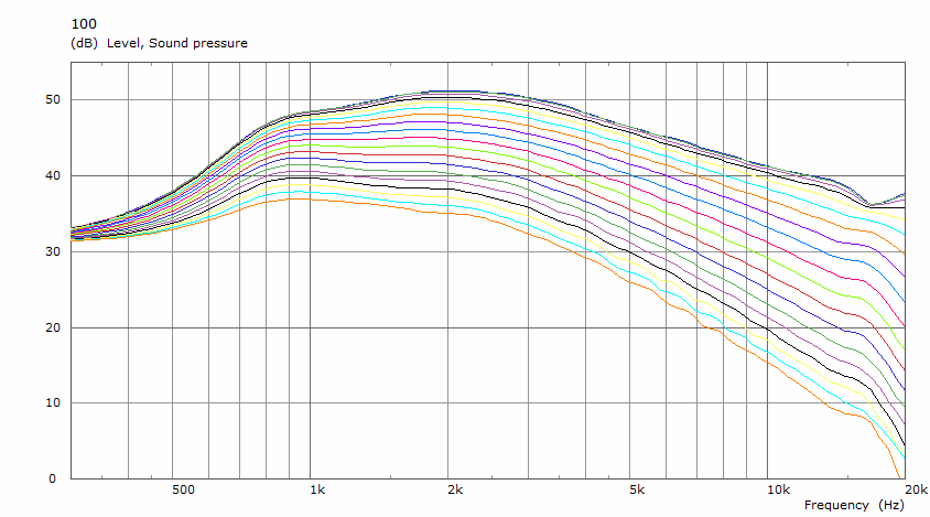

A short study of different coverage angles. A took a small horn and changed the coverage angle parameter (no other).
The profiles tested (25 - 50 half coverage angle / 5 deg):
attachment.php

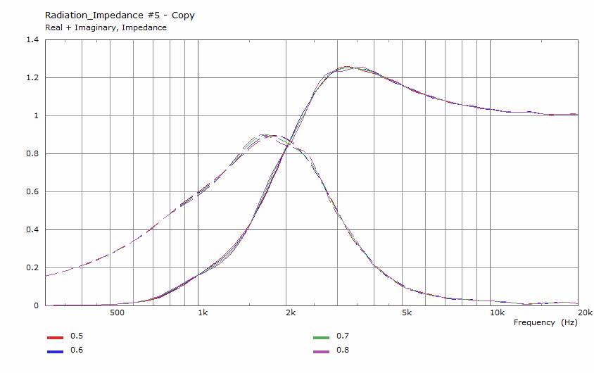

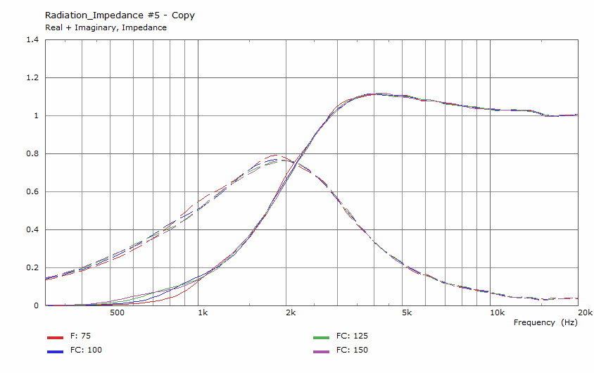

Throat impedances:
attachment.php
SPL polars attached.
