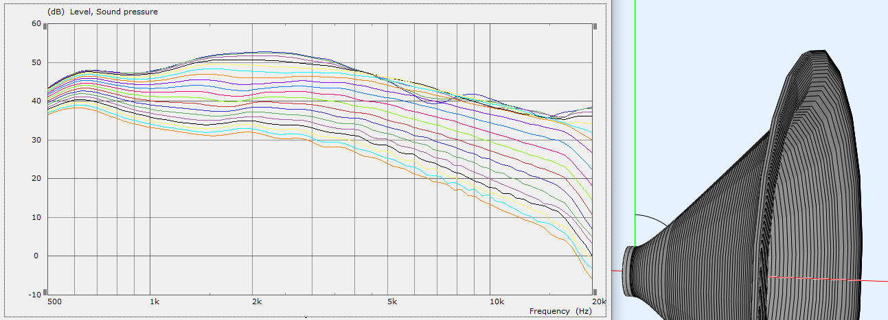

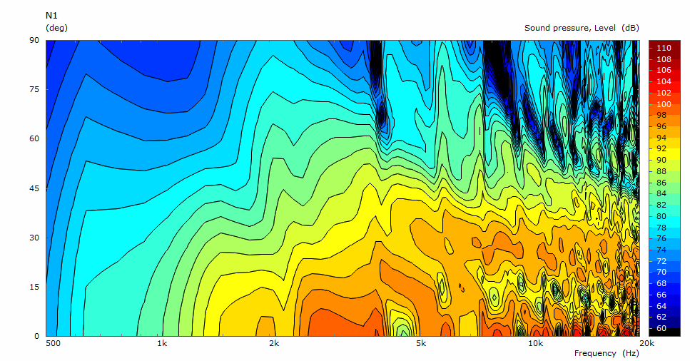

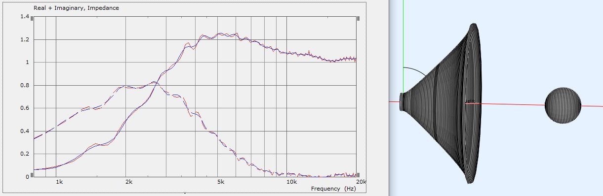

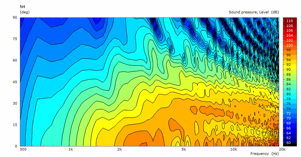

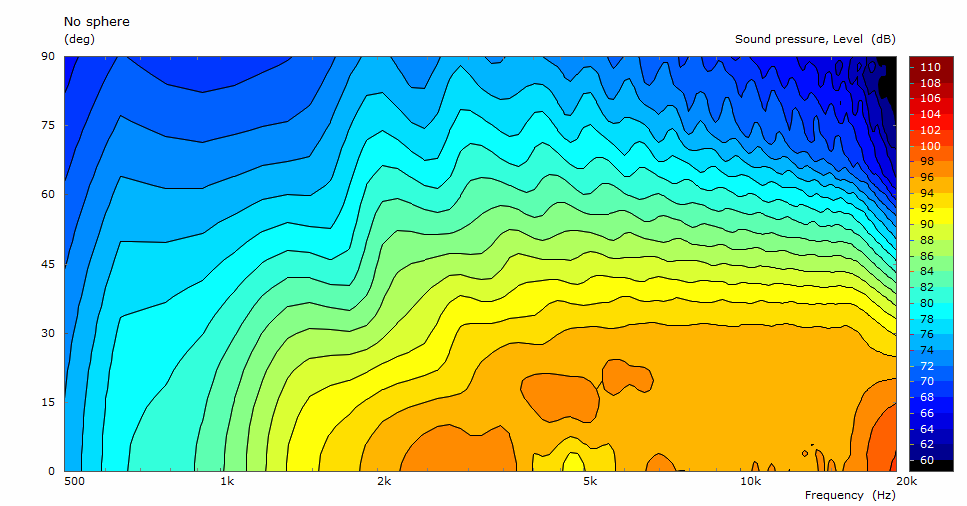

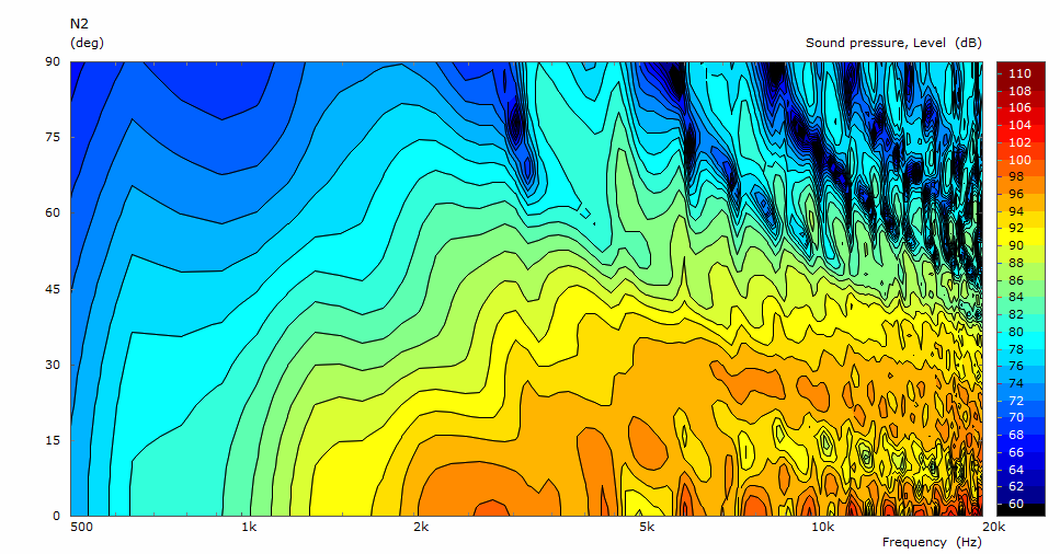

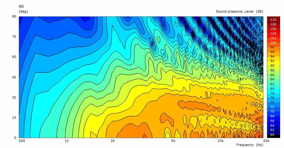

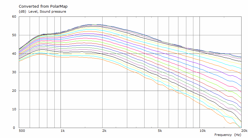

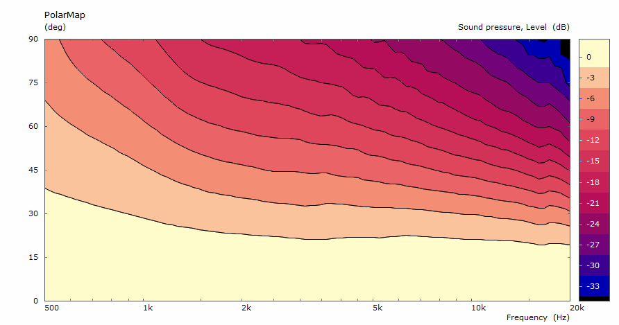

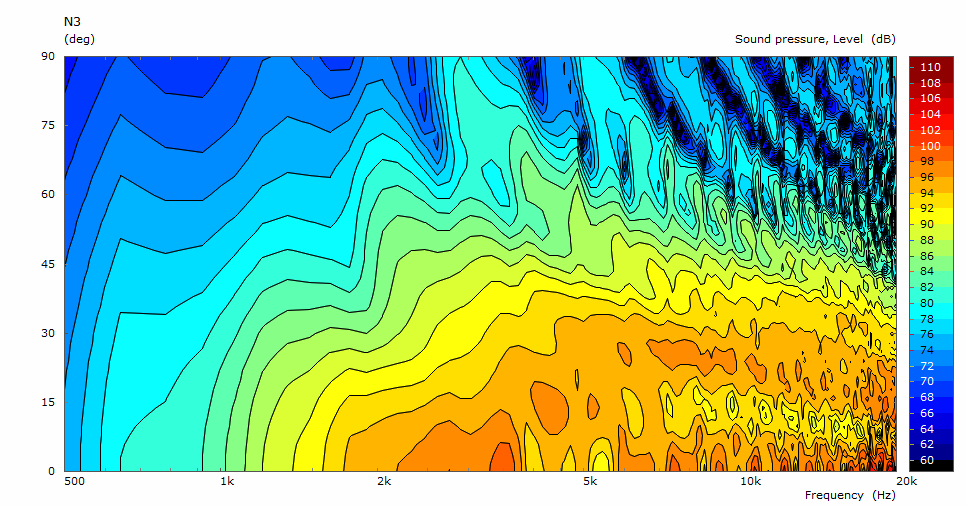

No problem. Polar maps taken at 5m for sphere distances N1 - N5 (1x - 5x half wavelength from mouth):

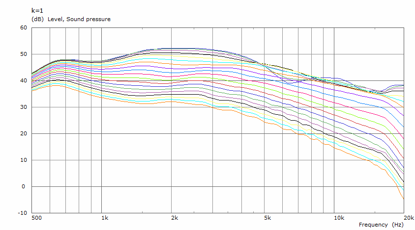

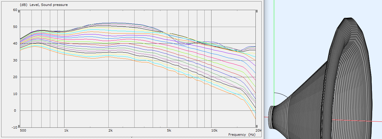

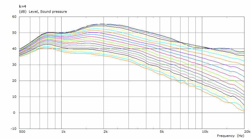

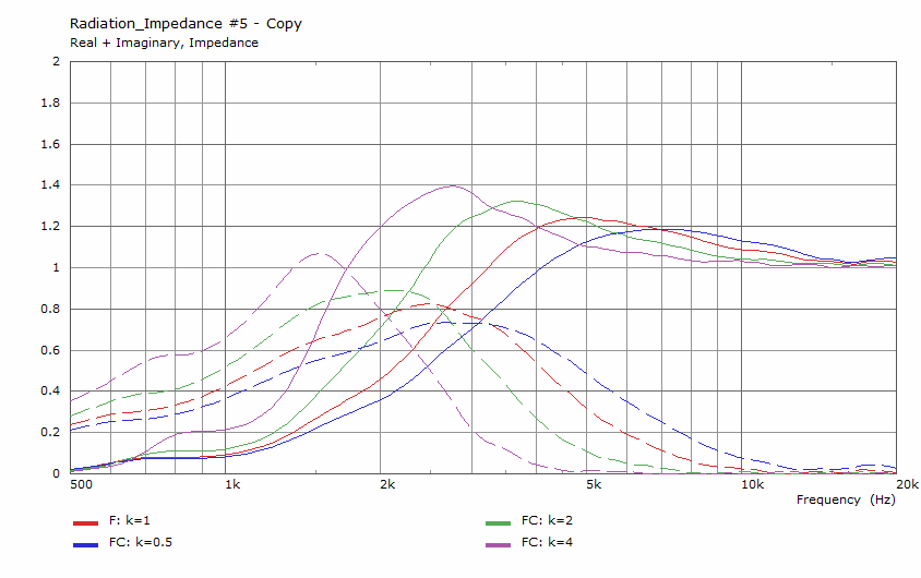

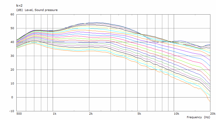

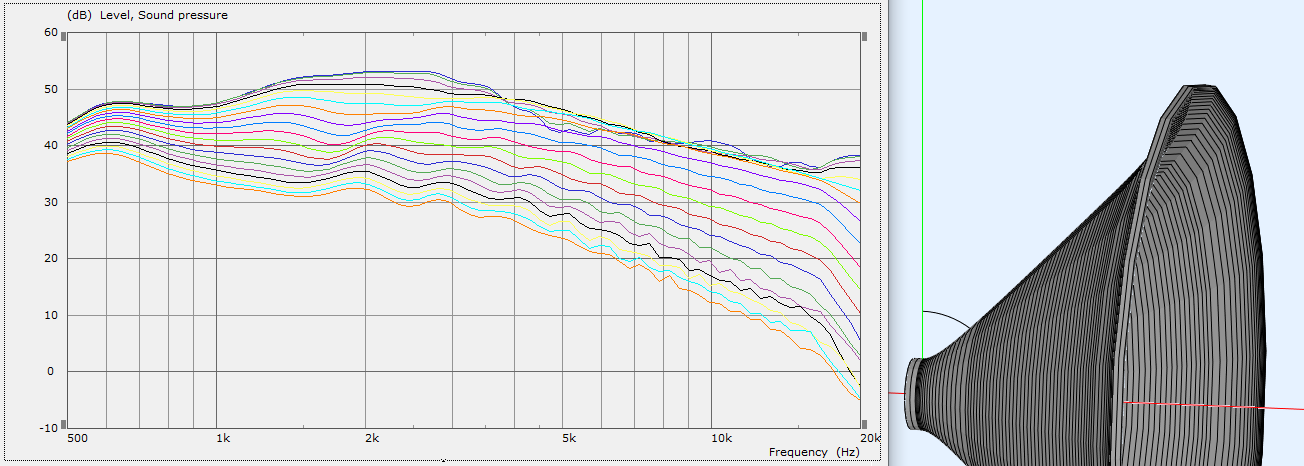

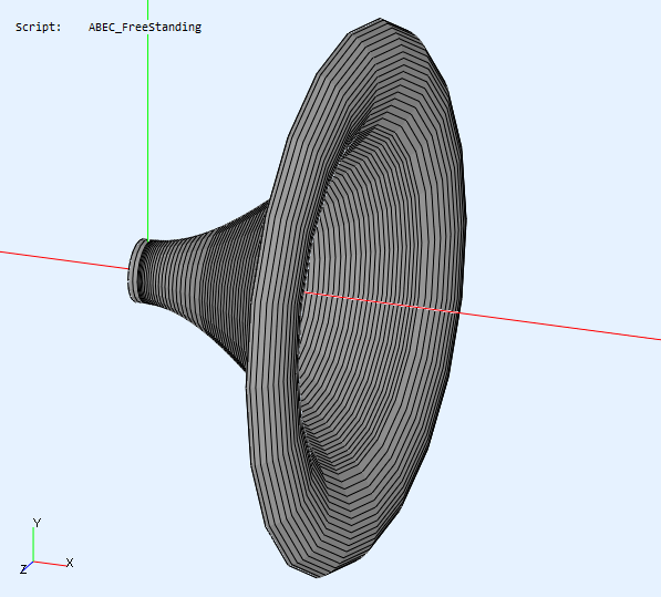

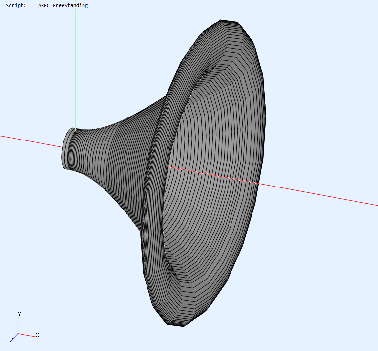

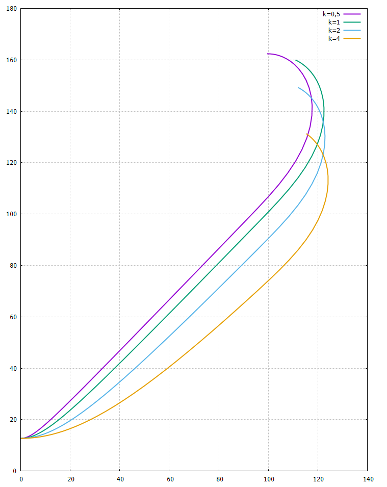

Now I have an interesting comparison - different values of 'k' (all other OS-SE parameters equal).
See particularly the polars for k=4. I think this almost deserves to be called a new waveguide type 🙂
Pure OS throat (k=1):
attachment.php
k=2:
attachment.php
k=4:
attachment.php

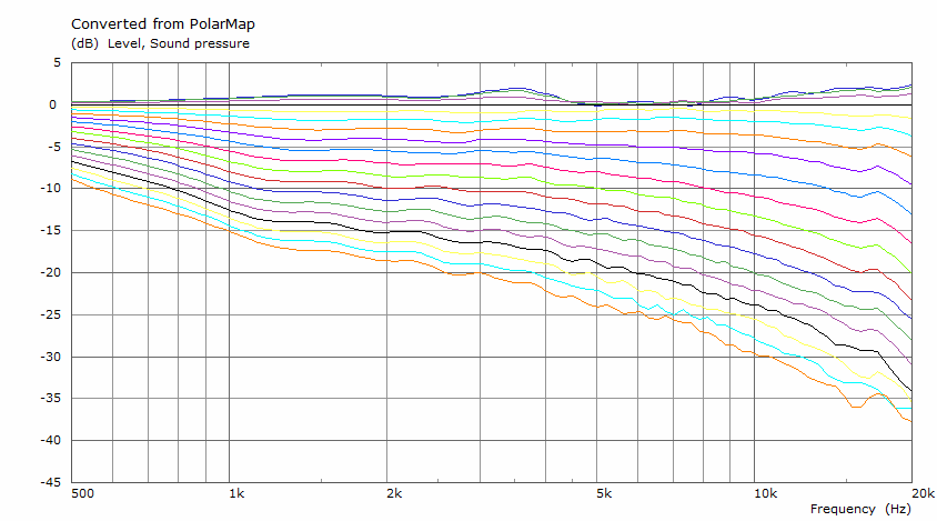

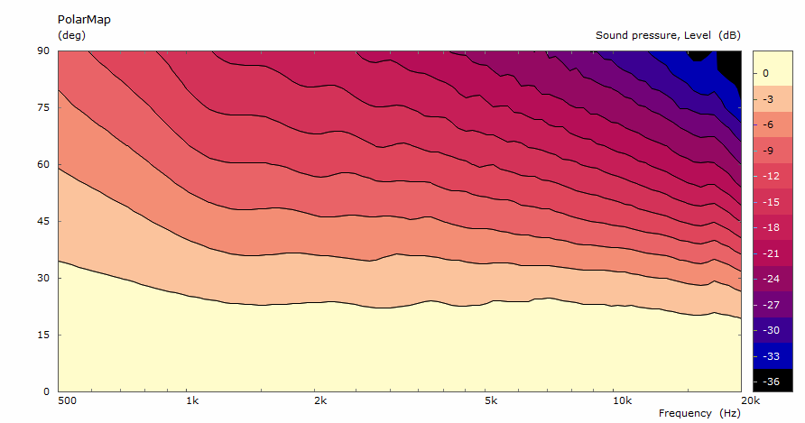

Thanks so much for that! I guess I'll have to put that down as another bad idea - like most of them!!
I always wanted to find some way to trip-up the axial hole with maybe some small perturbations of the rim. But your designs don't have that problem so I guess it's a moot point.
