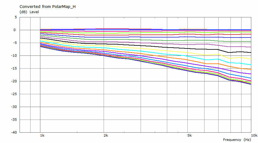

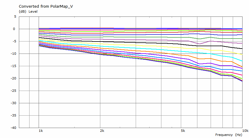

Elliptical...dimensions 740 x 550 x 300 (W x H x D) ~ 29.1" x 21.5" x 11.8", throat 36 mm (1.4").
There will be a pattern flip around 1 kHz.
Thank you for that, it will make an excellent benchmark to compare with my own efforts.
Nice to have more realistic data to confirm my rule of thumb estimate that a horn that size would have pattern flip around 1 kHz.
The idea is that 1kHz is about where the woofer would start to cut in.
So the broader combined vertical source would then help to maintain pattern control down to the crossover frequency of around 650 or 700 Hz.

Earl, having made and measured both a 18" and a 12" waveguide in the same baffle, can you elaborate on the tradeoffs involved? How much off an issue is the diffraction of the Na12 really? How much is gained in terms of directivity? Looking at the polars, it doesn't have the waistbanding one might expect..
The 18" holds its control to a lower frequency which allows for a lower crossover point and a higher DI across the board. (You may see this as "waistbanding".) This is not readily apparent in the plots (unless you compare the DI directly.) Diffraction at the mouth is negligible in the 18" but is more significant in the 12". This is mostly due to the 18" having a larger radius flare at the mouth.

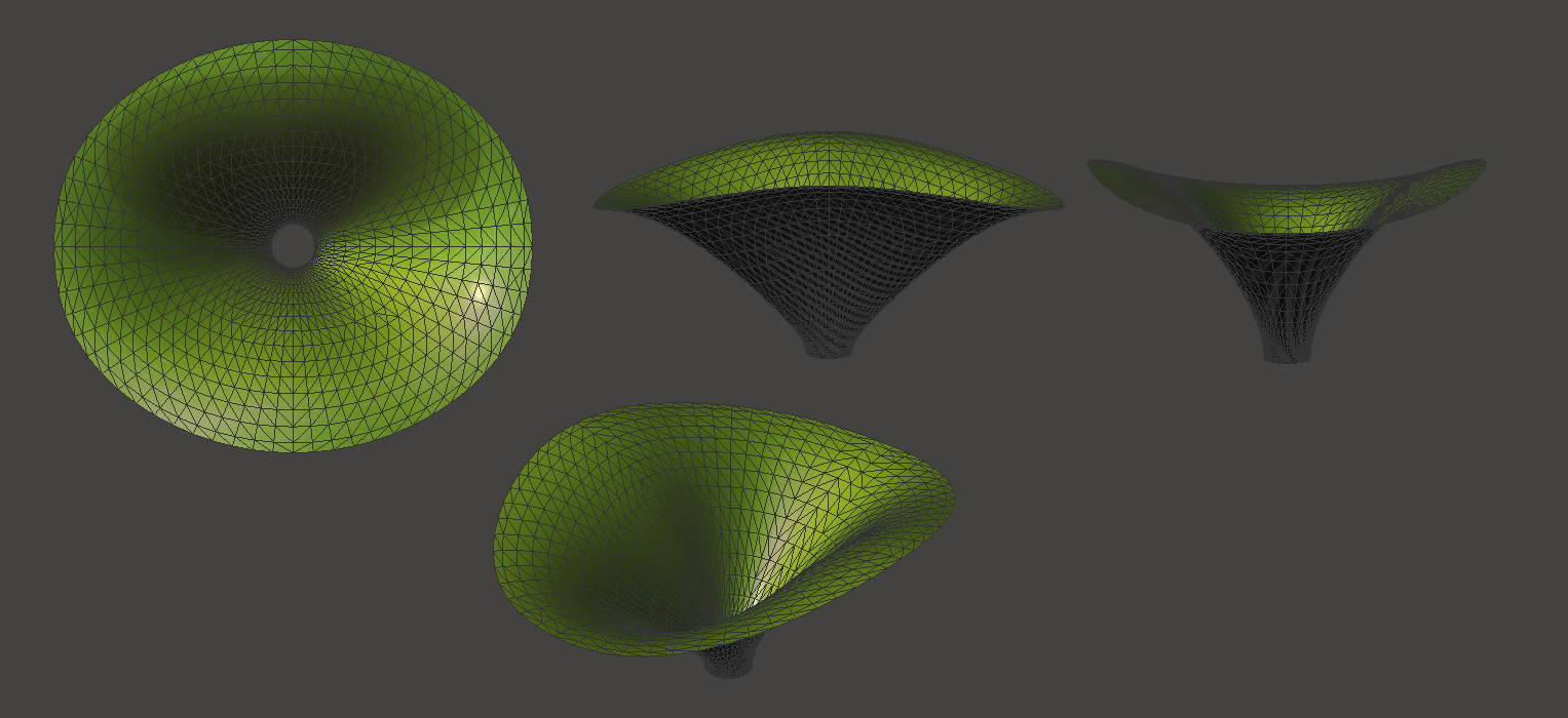

You want it, you got it - 🙂
Length = 100+30*sin(2*p) ; [mm]

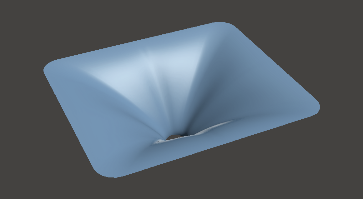

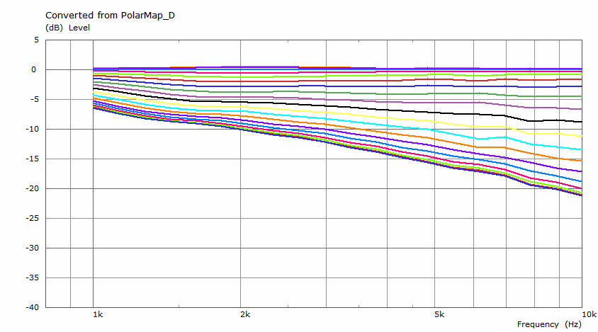

The latest iteration of my best rectangular design -
Dimensions: 374 x 324 x 120 mm
Throat: 1,4"
(Angular step is 5°, so the black line in the middle corresponds to 45° off-axis)
Throat: 1,4"
Marcel, will you share it slightly bigger approx. 49x45cm? I currently run test print of that big using 0.8mm nozzle, 0.6mm layer: 35 hours.
