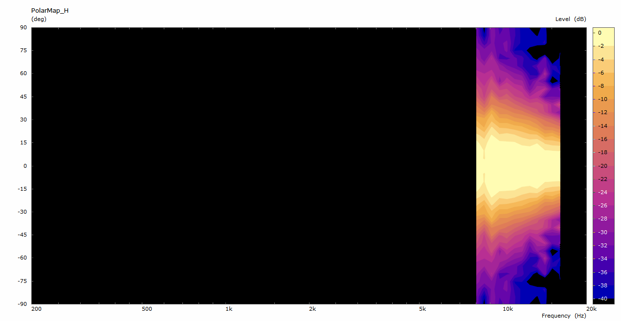

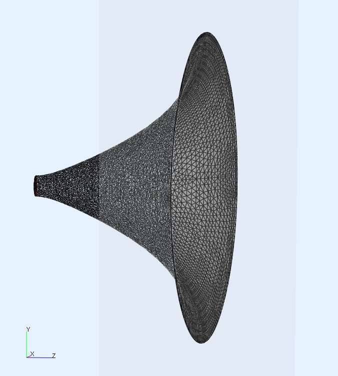

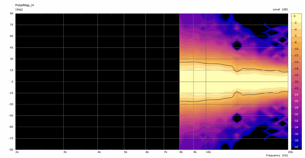

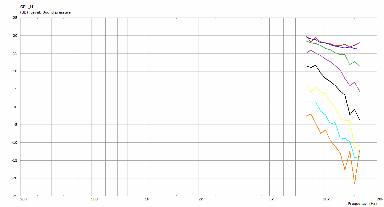

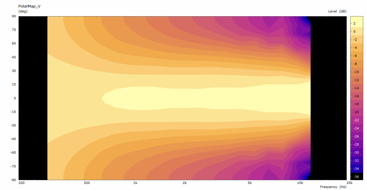

I re-run the sim for 8k - 16k, just kept the coarse mesh. It just narrows... Only a spherical wavefront phase plug would help here 🙂...I wonder what the response in the upper octave looks like, since the throat is no longer visible about 30° off-axis.

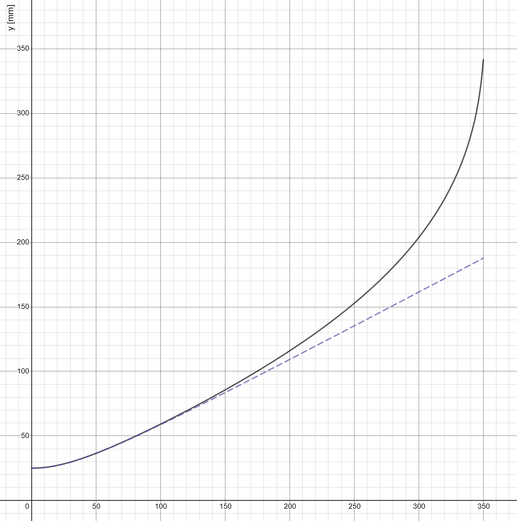

This is the actual (horizontal) profile, along with the OS apart: OS-SE Waveguide... How much is OS, how much mouth transition?

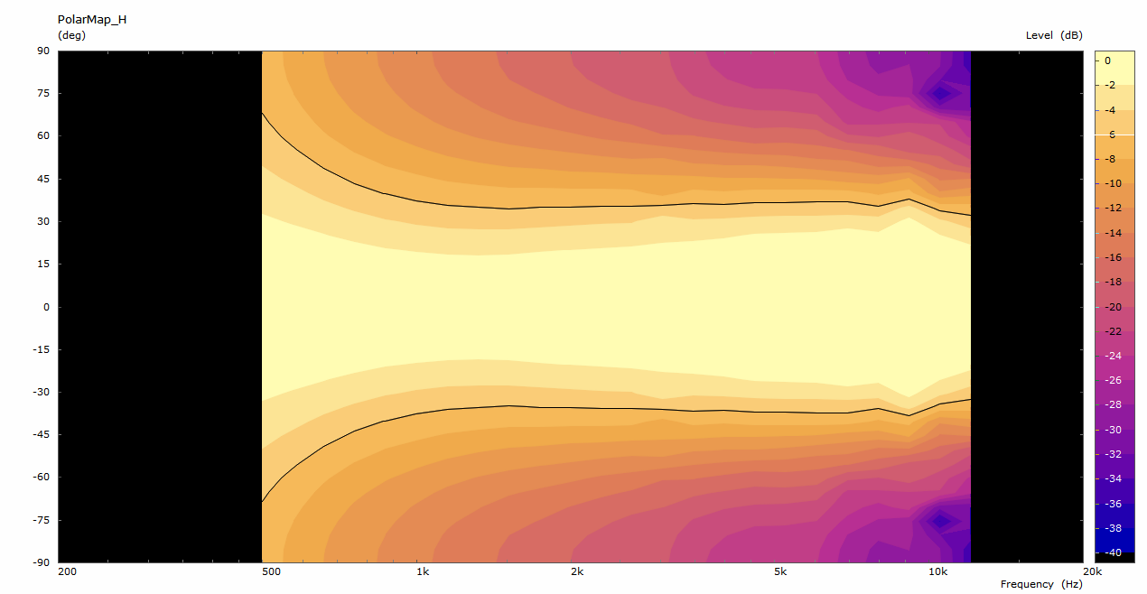

The highest octave again for the 2-inch throat. Not that it is so important, I just have the picture (-6 dB contour lines marked on the map).
- I like this color scheme ("Otto" selection in VACS), it gives much better feeling for where it is actually "hot" and where it is not. Thanks bmc for a hint.
If I were ever to use a large format 2-inch driver as a wide-range source, it would probably be with something like this (27" x 14") -
(There are some numerical defects above 3 kHz, probably still due to mesh coarseness, otherwise it should be pretty smooth.)
Thank you very much, I find visuals really help to develop some intuition for the numbers.
I was unfamiliar with the Desmos calculator, it looks excellent.
Much better than my old, simplistic, radius transitions.

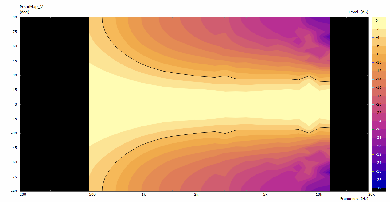

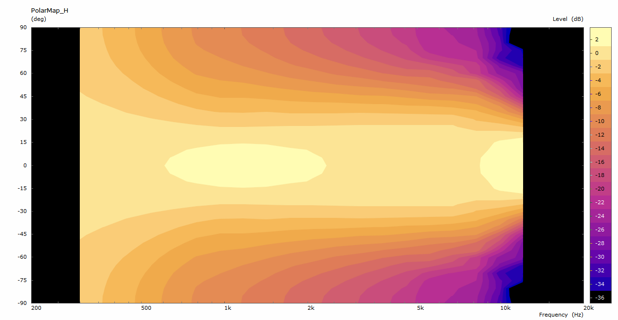

I did some analysis and found that this doesn't work as expected. What I found is that the radiation patterns really should match at the crossover frequency, horizontally AND vertically, otherwise you won't achieve smooth power response transition. I would not make the waveguide narrower vertically, if the only motivation was reduction of the spacing. Moreover, it is not necessarily true that the closer the spacing, the better the power response smoothness. It took me some time to realize that. So in the end it's all about pushing the lobes out of direct sound as much as possible. But take this only as my observation as I don't claim this to be universally true - it's still only a somewhat "random" observation, really....The idea is that the narrower vertical will blend better with the inevitable lobe created by the separation of the two sources active at/near crossover.

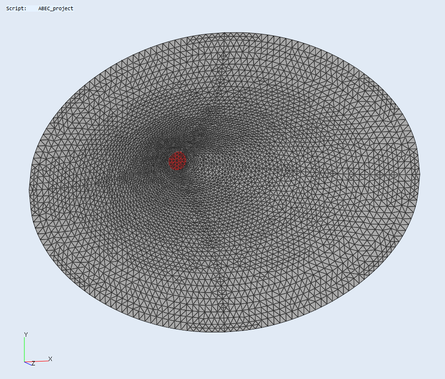

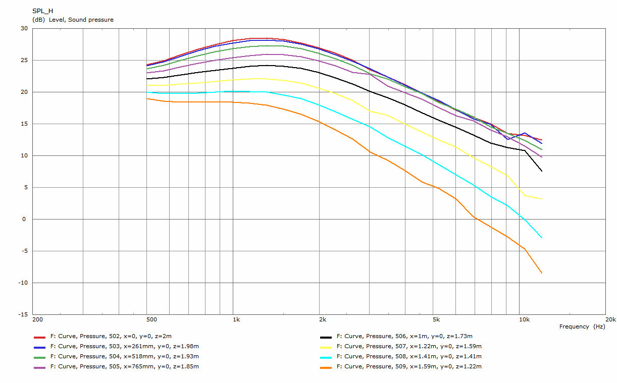

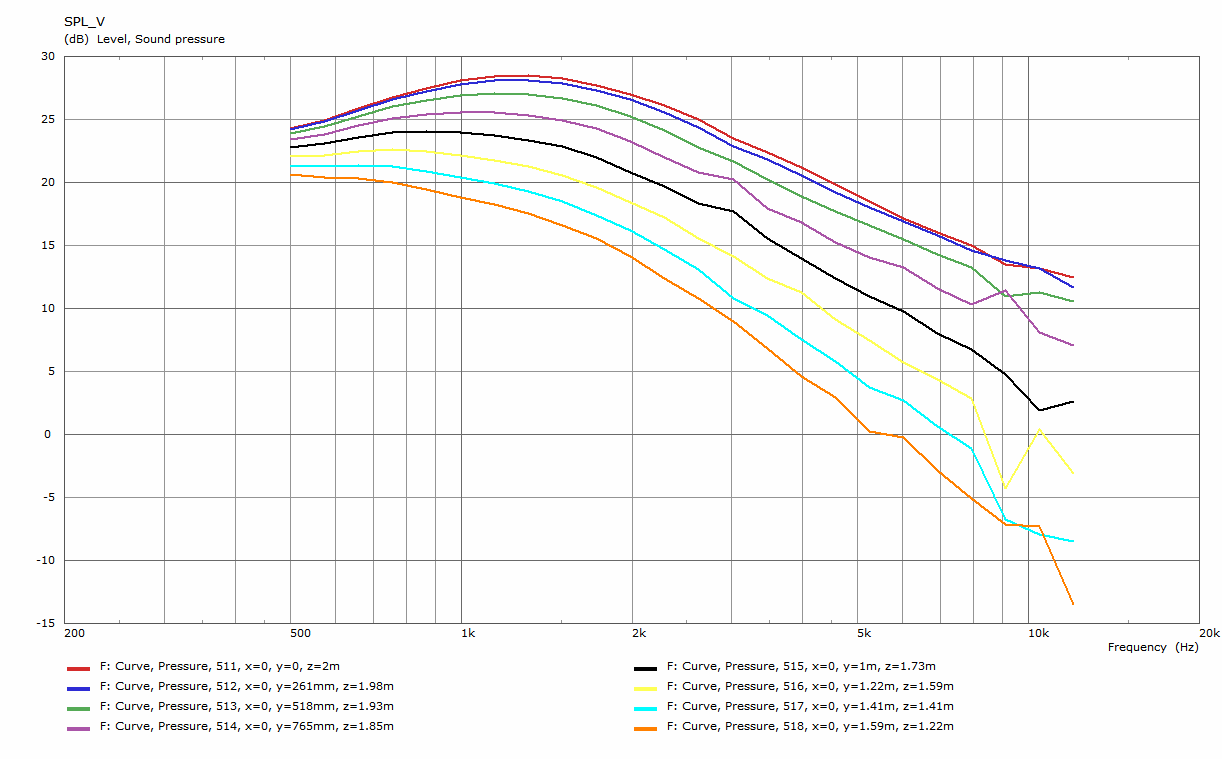

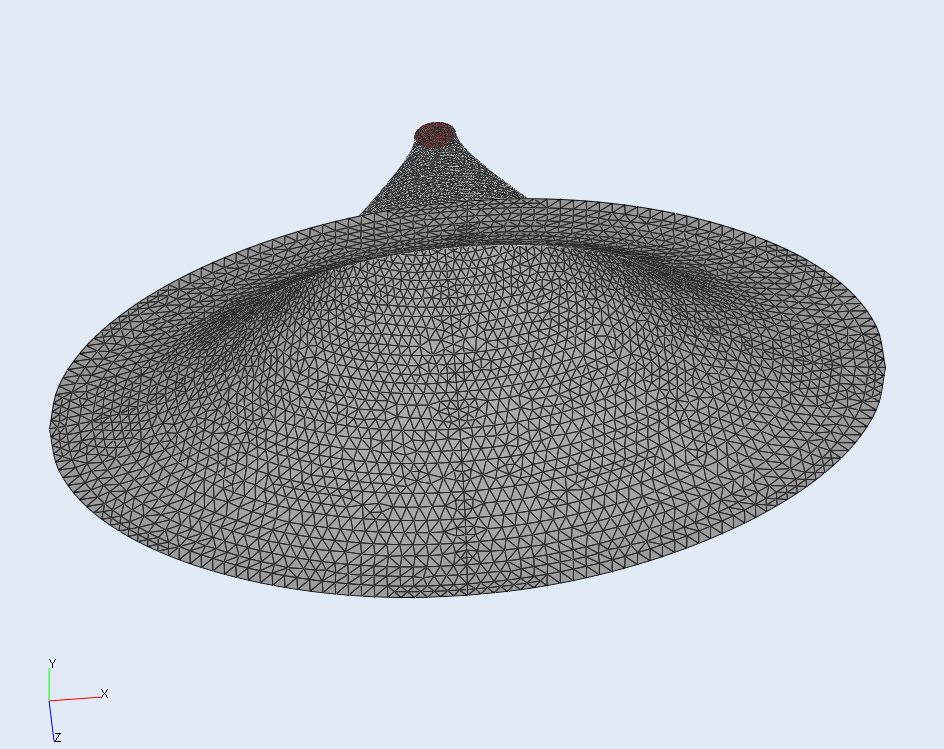

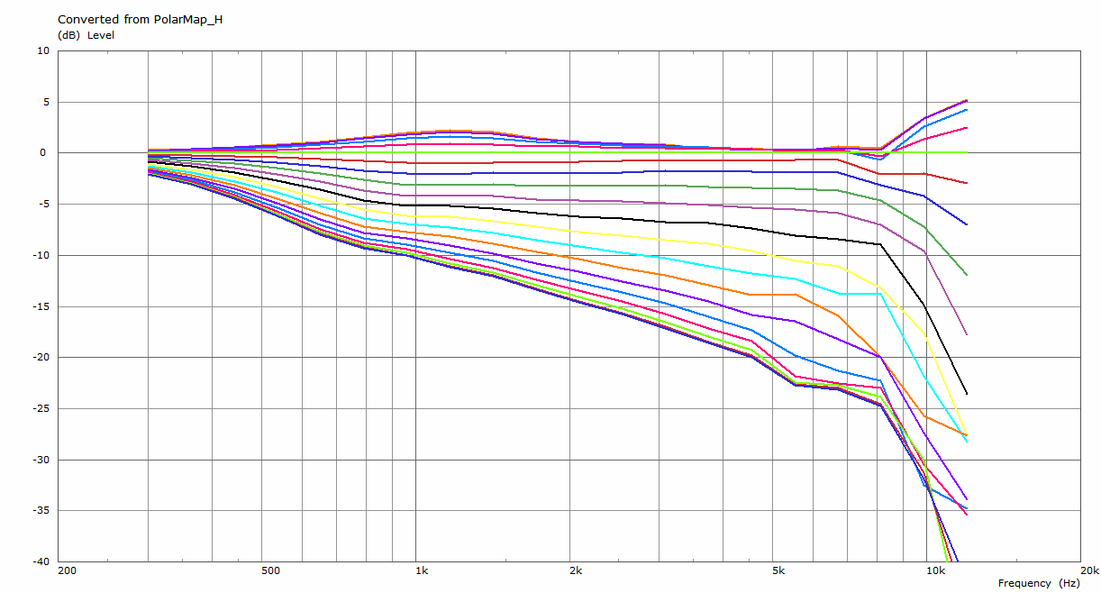

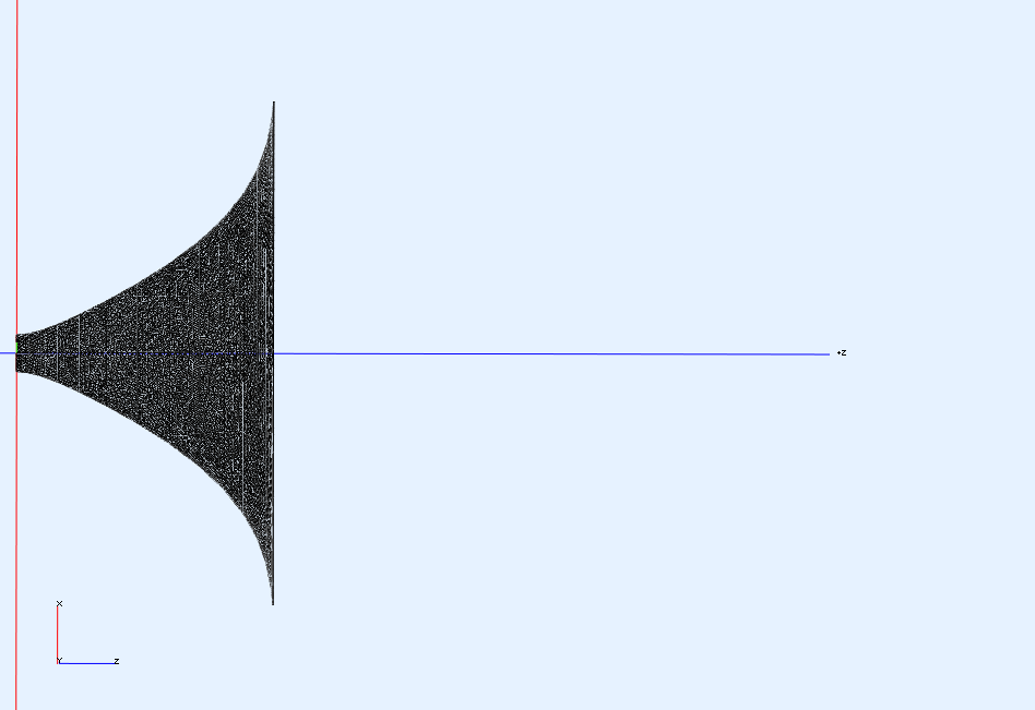

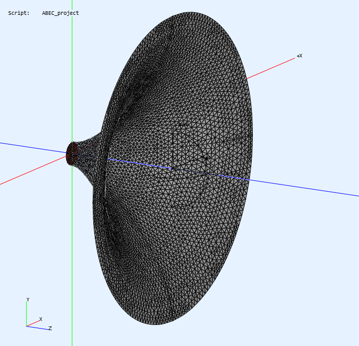

Elliptical waveguide 80x50°, dimensions 740 x 550 x 300 (W x H x D) ~ 29.1" x 21.5" x 11.8", throat 36 mm (1.4").
There will be a pattern flip around 1 kHz.
That scheme is indeed much clearer.
If it's not too much to ask, it would be interesting to compare the plots of the same waveguide with an 1.4" throat.
The differences above ~12 kHz (the default limit that I don't change often) will be so dependent on actual driver that I find spending calculation time on that of little value. I just try to cut it down as much as reasonable, including the mesh density, which is the reason you may see some spurious noise now and then in the data.
This is what I found as well. One gains some things with an elliptical pattern but losses on others. In the end it is not really an improvement, just harder to impliment. Which is why I never went any further with my elliptical device.

If you're curious, the colorscheme I used is "magma" from matplotlib (the python library I used to generate the plots I posted). Rainbow colorschemes ("Jet" from MATLAB is the classic one) have lots of contrast, but are not perceptually uniform so tend to create "false" features in the data and make it more difficult to discern relative levels.
Here's an interesting talk about how the perceptually uniform colormaps in matplotlib were created.
Thanks for the interesting talk. I think Earl mentioned this quite some time ago and that's also the reason why he used the colors he used in his app. It makes a lot of sense.
What I would also like to change in the polar maps (for a long time) is the scaling of the angular axis from linear to something more representative of the corresponding spherical surface area. The linear scale puts too much emphasis on the axial response, IMHO.
