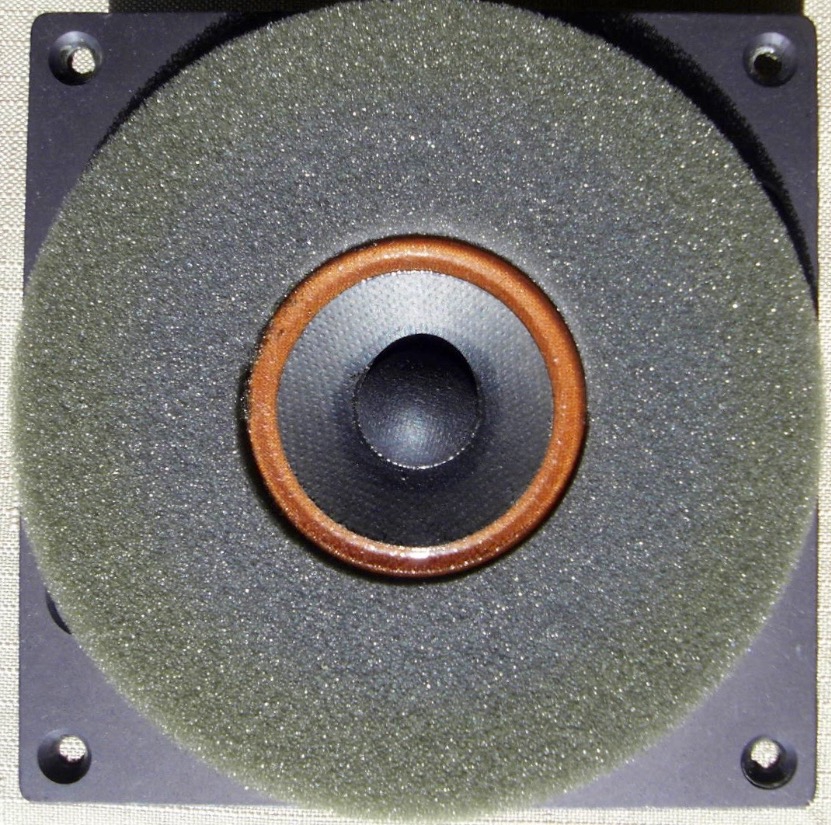

For the suspension ring I think it could be closed cell foam as well. I even may have some at hand, now when I think about it.
Maybe it is not so small after all. In the example above it makes about 22% of the entire projected area.Your data shows that this small area accounts for a lot of problems. With the right density of foam, I'll bet you could make a substantial difference. ...

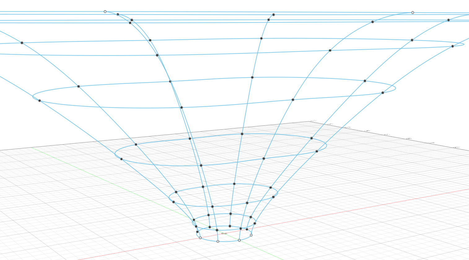

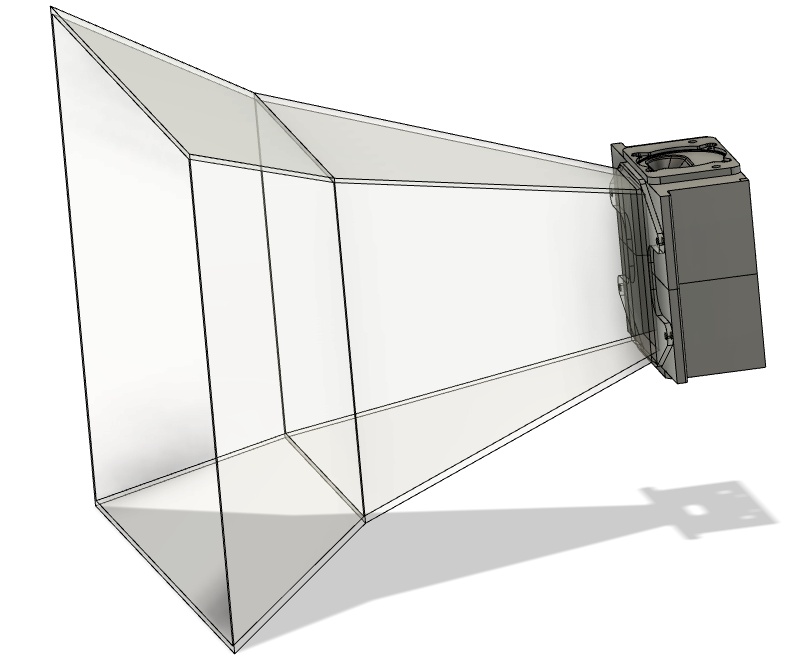

I might have asked already, but could ATH4 be used for creating horn profiles with rectangular throat? I would like to generate some smooth profile for the AMT horn, which starts with a 50x30° rectangular throat.
If it is not possible in the software directly (I think it is not), how would one select the parameters to blend the two horns together in Fusion 360? The throat is roughly 140 x 75 mm and I have around 450 mm printable height from the flange. My idea would be to create a horn that has the same length, height and mouth area with the correct entry angle and then merge it somehow with the rectangular part.
Any better ideas? Thanks!
I would just create some circular throat waveguide(s) of the desired profile, import the curves and move them around for a rectangular throat. Then loft the surface into a solid manually.

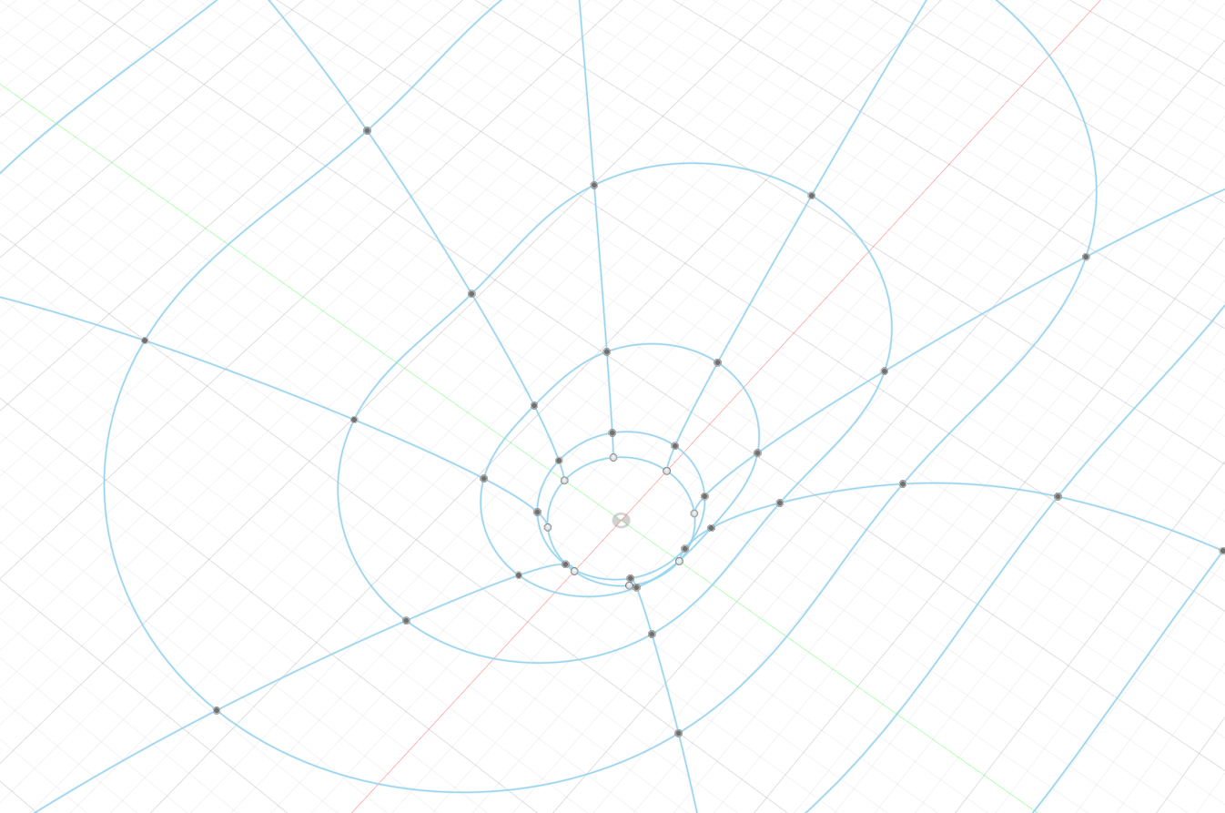

The instructions that I published here can be used to make a throat that's rectangular:
3D Modeling Tips and Tricks
You simply start with a rectangle instead of an ellipse.
Depending on how well behaved your software is, you could actually have a throat of any shape.
You can also have a throat that's circular with a mouth that's rectangular. That's accomplished by starting with rectangle and smoothing the curve. (The smoothing turns the square into a circle.)

This can easily be done in cad software such as Inventor, with a true matched entry angle OS equation, but the equation curve feature in Fusion is just not powerful enough to do handle these equations in my experience.
If you dont have access to Inventor, i might be able to run your parameters, and you can import the model into Fusion.
You can also use spline functions with tangency to get a result that is very close (within tenths of a millimeter) to OS.
This is what I used. I found that I could get a near perfect match with just three points, two end points and one in the middle. I fit this to a list of generated points from the exact equation.
I use a tangency (control vertex spline) as the mouth round-over curve too: very flexible, and doesn't tend to distort the diagonals when "lofting" a circular throat to a non-circular mouth cross section. I believe this is quite close to the variable N-value as a function of angle in the SE termination, that Mabat considered implementing. It makes sense, since splines are litterally just a minimum-energy way of joining two displaced curves.

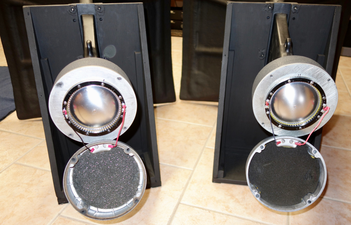

While considering suitable materials (leaning towards soft plywood), I came to the conclusion that a throat adapter could be useful for switching drivers.
This adapter would allow exchanging drivers with the same exit size, but with different throat angles.
